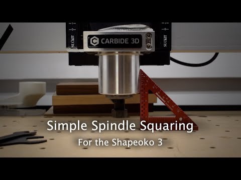

Hi Terry,
As there is no mention of it in your initial post, have you checked your tramming? If this is out then you would expect to see cuts like this especially with the wider diameter cutters people use for flattening washboards. If the cutter is not parallel to the machine base or washboard, then either the leading or trailing edge of the cut will be deeper. Definitely worth the time to check tramming and nothing a few bits of tin foil as shims won’t sort out.
Lot of good into on the forum with regards to tramming if you need more info.
I had a similar issue when I just rebuilt by XXL… Tram lines running front to back. So certainly look at the post above for squaring the spindle. I used a slight different process using one of these… Digital Angle Gauge.
I put it on the gantry and zeroed it. Then put it on the spindle mount and found I had a .7 degree deviation. It then depends on the style of z-axis you have. I have the original one, so for me it was a matter of loosening the 2 spindle mounting screws and adjusting until I read to as close to 0 degree’s as possible.
Produced a perfectly smooth waste board with no tram lines in any direction…
Just to add one more bit to this…
If you have tram lines running front to back, your spindle is tilted left or right of center.
If you have tram lines running left to right, your spindle is tilted front or rear of center.
The trick is to then figure out why
If you are seeing visible lines after surfacing your wasteboard then you router needs to be leveled. Your fingers are incredibly sensitive instruments. So look across your wasteboard and see which the lines are running to determine which way your router needs to be adjusted. If the lines run from back to front your router needs to be adjusted side to side. Feel the lines and if the high side is on the left your router needs to move to the right. If the high side is on the right the router needs to move to the left. The pattern is whichever way the high side is you move the opposite way to level the router. If the lines are running are running across the waste board your router needs to be tilted in the front or back direction. Again determine which you the high side is and your router needs to move the opposite direction. So if your ridges are higher in the front the top rear of the router mount needs to be shimmed with folder up aluminum foil or brass shims. If the ridges are higher in the back then you need to shim the bottom of your router mount to level out the ridges.
Now getting the router level on both directions can be tricky. One aide is to remove your router from the Z carriage. Use the 1 2 3 Set Up Blocks machinists use for set up. You can buy them on Amazon and other places relatively inexpensive. You can use two of the blocks to level your router mount in relationship to the wasteboard of both directions at once. You still may need to shim the router mount front to back with shims and the left to right can be done by loosening your mounting bolts and/or the HD eccentrics present on some newer mounts.
After you get your router square to the wasteboard you will need to resurface again to remove the ridges. If you can faintly see and feel ridges you can just run a sander across the wasteboard to remove them. But if you are seeing and feeling major cliffs you need to tram your router mount.
