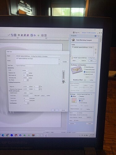

I need some help. I have been trying to work some lines that my Shapeoko Pro is leaving behind. I have reduced Stepover as low as 5%. Worked with my Feeds and Speeds you name it I have tried it. Yet I continue to see these lines after the work is complete. The pictured attached is a 3d relief
The Latest Geometry and feeds and speeds are as follows.
Roughing 1/4 Endmill
18000 Speed
.125 Pass D
30% Stepover
Feed 80
Plunge 40
Finish
Amana #46286 Tapered Ballnose 1/8
5% Stepover
15,000K
90 Feed
40 Plunge
Someone told me it could be my Tram. Any advise onto what could possibly be wrong with it.
The machine runs and moves like it suppose to, so I dont know what could possibly be wrong with it.
Attached are 3 pics ran at different feeds and speeds and stepover with the same results.
Any help would be greatly appreciated.
Thank You Retired Veteran trying not to loose my mind over this machine!

I’m seeing 3 different results, just all with witness marks.
#1 has concentric circles around the center of the part
#2 has concentric circles, with the centers outside of the part, and only on the outer edges
#3 has nearly parallel marks across the whole part.
This would indicate that it’s not a problem with the model, but with the toolpaths or the mechanics of the machine.
Were the 3 tests performed with the same type of toolpath? Same cut pattern?

Thank You for your reply. Yes I tried different ways of cutting it some raster some offset. With the same result. Yes I did use vetric. The model came directly from the vetric clipart. I am using the real version of vetric not the bootleg version… I cut some projects prior with no problem and lately its consistent with these lines. These are only a few pictures of the jobs I have done and all have these same marks.

Best way to check the machine mechanically is to install a 1/4" probing pin and then power up the machine so as to lock the motors and grab the tip of it and trying to push/pull — it should not move — investigate each aspect of the machine which allows the tip to move and address it.

Tram should not make a difference with this particular issue. Only if you are cutting flat surfaces with a flat endmill, or using several tools with different tool lengths.
If you want to share the toolpaths (G-Code), I can simulate them in a higher resolution to see if the witness marks are apparent in the toolpath.

I use vetric as well, amd from what i can tell set up my 3D files the same as you, with the same bits, specifically the 3.6 deg tapered ball nose finishing pass. In my experience the raster cut with 0 or 45degree works good also if i am wanting super clean i will run another finish pass at -45degree to hvae the bit pass another direction. When this has been happened to me i have had to verify belt tension and most importantly found my eccentric nuts on the z axis slipping and worn to where i replaced them. After doing those 2 things i have had no issues. Hope this helps.

I see yeah the pro has linear rails so my next thing would still be the belts. Lots of info on here about belt tensions as well as making indicator marks on your motor to verify slippage. Even though I have a different machine I still feel as something is slipping and that is causing the marks based on you saying you verified stepover and have a level cutting surface.
Also check that the setscrews holding the pulleys on the stepper motor shafts are tight and that one setscrew is on the flat of the stepper shaft. It’s not unknown for them to work loose and slip, especially under load. Check them all, but definitely check the z-axis ones.
