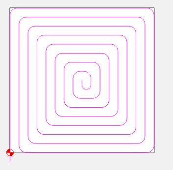

I really don’t like the plunge in center / conventional cut pocket pattern, so I will create a single spiral vector and use a contour path with no offset.

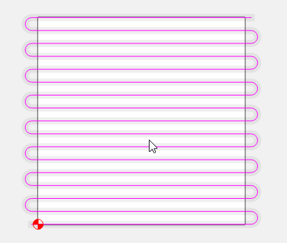

Or a zig-zag, lace-cut pattern and cut with the grain
Ah, okay it’s a contour cut, so I would need to create the zig-zag pattern, based on the width of the McFly, so there is sufficient overlap with each pass and also runoff at each end to get clean edges.

To create the zig-zag pattern, I create a polyline along one edge of the part
Then I use the Array tool to copy it
Then to connect the ends I create a circle & chop it in half
Line it up with the first 2 polylines, then use array again to copy to all the lines
Now copy/paste or dupicate those, rotate 180 or mirror horizontally, and move to the bottom
Delete the extra arc, and the join all the vectors.
