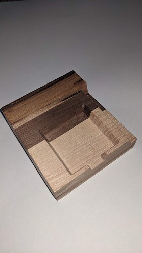

I have a Shapeoko 3xxl, and i am using Carbide Create v764.
last year i was Use Vectric VCarve to do some Inlays and everything worked out great, perfect values for glue gap, saw gap and there was no gap in my inlay. I no longer have Vectric VCarve and i am working with Carbide Create. i have searched through many tutorials and tried everything, but nothing seems to work out properly.
I have been using some scrap hardwood and a simple shape for my tests and I have the female part cut using Advanced VCarve, a30 degree vbit, and a Max depth of .25".

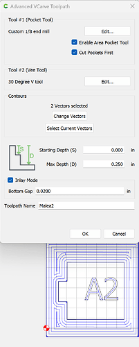

After that i cut 5 different Male parts all using Advanced VCarve, the 30 degree bit, and changing the start depth, max depth, and Inlay Mode based on tutorials un the forums i have been trying to follow.
First i tried the simple Start depth 0, Max Depth .25 and checked “inlay mode” with a .02" bottom gap.
this resulted in a loose fit, with no glue or saw gap.
Then I tried another test using the inlay mode with a bottom gap of .02", but i changed the start depth to .02" as well
Again loose fit, Small saw gap, no glue gap.
Then i tried some numbers i saw in another post, no inlay mode, Starting Depth .22" Max depth .25"
VERY Loose fit with no saw gap or gue gap.
then i started playing around on my own and i got some numbers that almost work, but the glue gap is larger than i want, but i cant seem to make it smaller.

Have you trammed and levelled your spoil board? I have done a fair amount of inlays and have had really good results using the inlay mode. Start Depth 0.00. Max depth 0.2. Glue gap on the plug: 0.01

sometimes I hate myself… all of my inlays last year with with my 60 degree bit and Vectric VCarve were fine, but i wanted to get some more detail so i bought a 30 degree bit and and I am now using Carbide Create. I assumed the problem was carbide create… but i think its my VBit. I spent all morning running tests and making sure my machine was accurate and level and it is… then i did another test with the inlay and it didn’t work again. But… then i tried with my old trusty 60 degree vbit and everything matched up properly… then I looked at my new 30 degree vbit and even though it says on it 30 degrees. i measured it and it is 40 degrees…

After getting a bit that had the right angle. everything worked out perfectly for me, probably one of the tightest inlays i have done… I used an Amana Tool 45771-K 30 degree vcarve bit. i set my start depth to 0, and my max depth to .25", for the male side i had a start depth of 0, a max depth of .25" and enabled inlay mode with a bottom gap of .02". Even simply putting the 2 pieces together by hand they stuck together nicely, you could just feel that it was a good fit. FYI.
