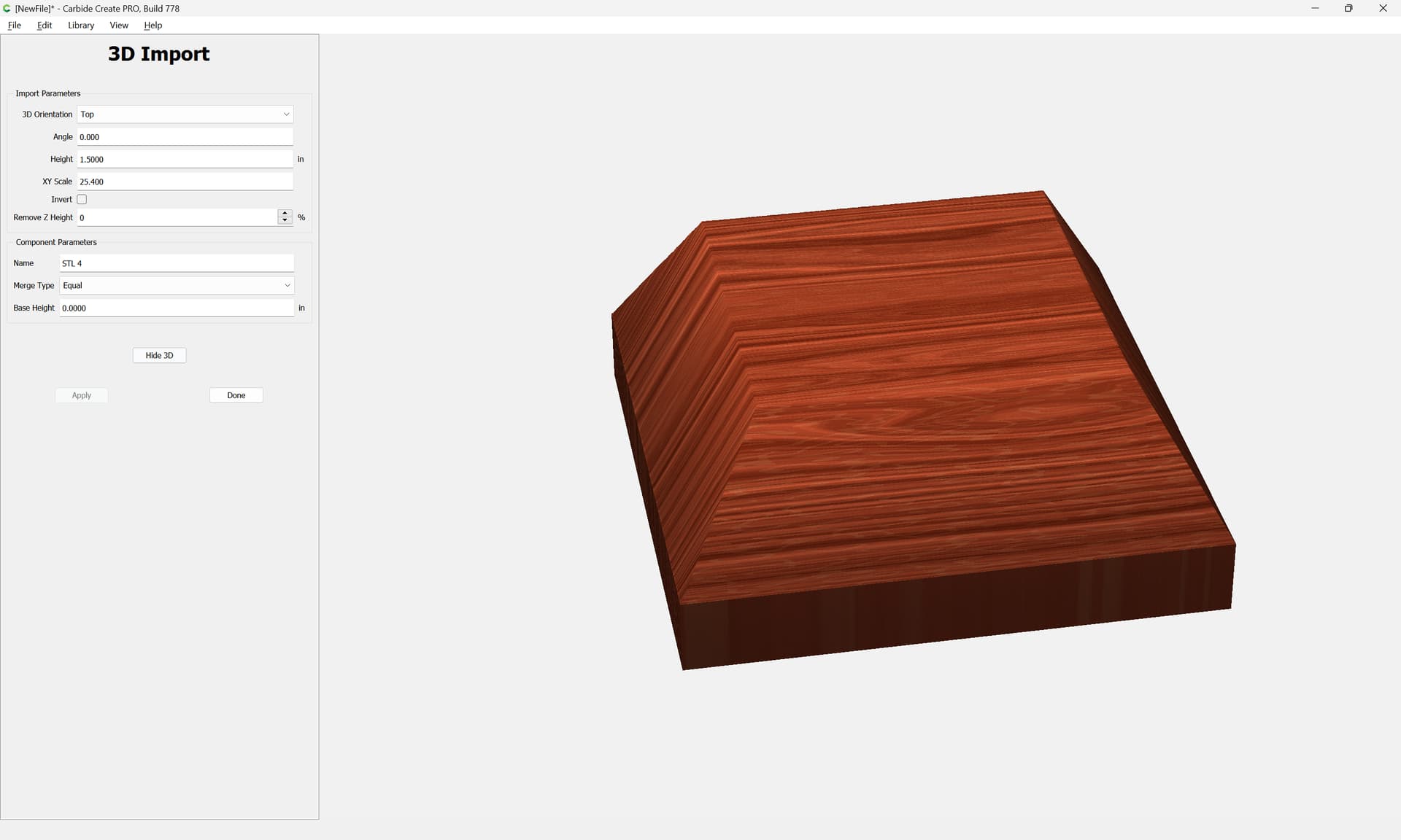

I just got the trial version of CCPro and have a question.
I have a cube about 3 1/2" square and 1 1/2" thick.
I want to put a 30 degree angle from all four sides of the top perimeter down to 1/2" from the bottom. Can CCPro do this?

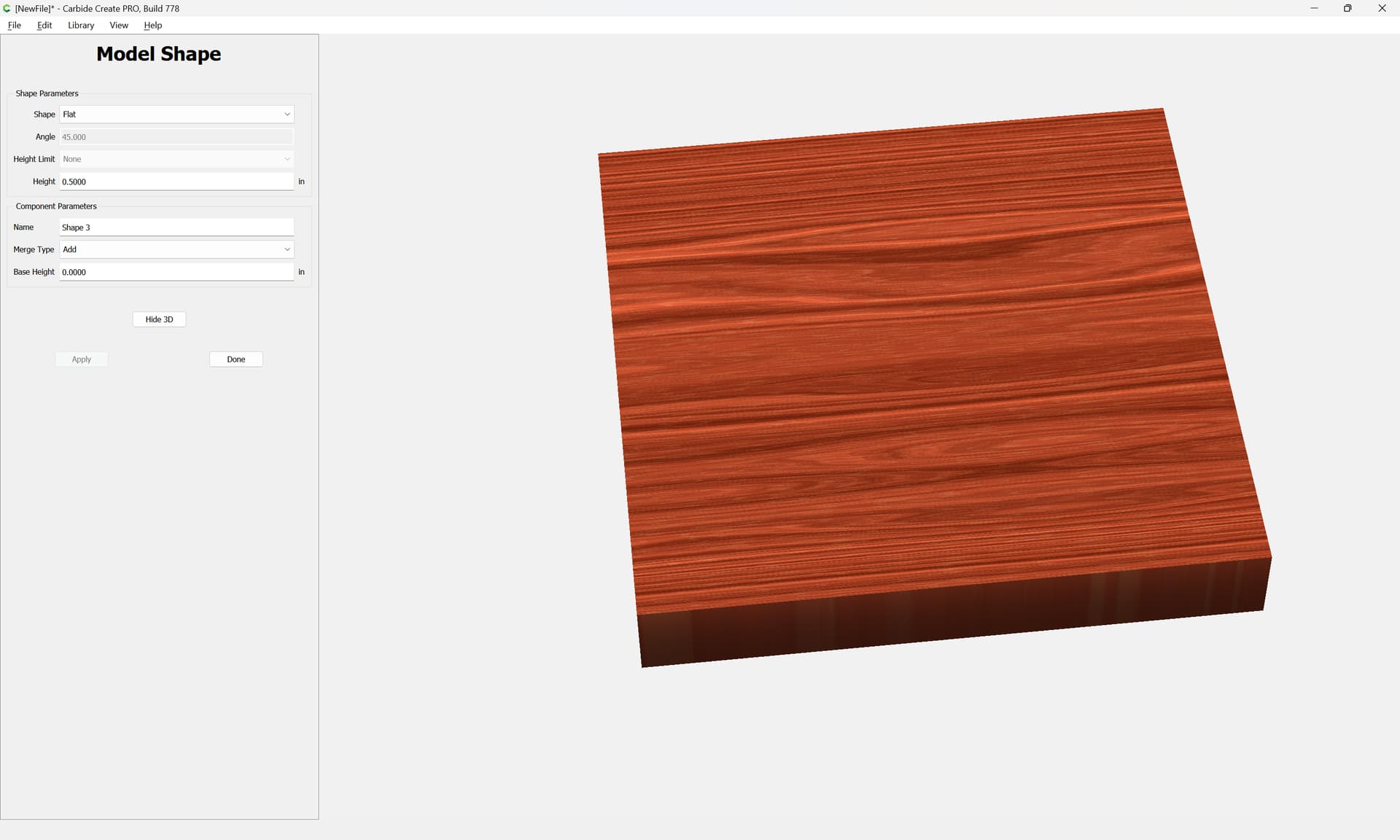

Two ways to go about this:
We’ll do both here, and use the twain to verify.

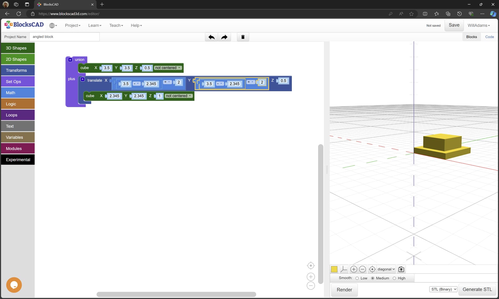

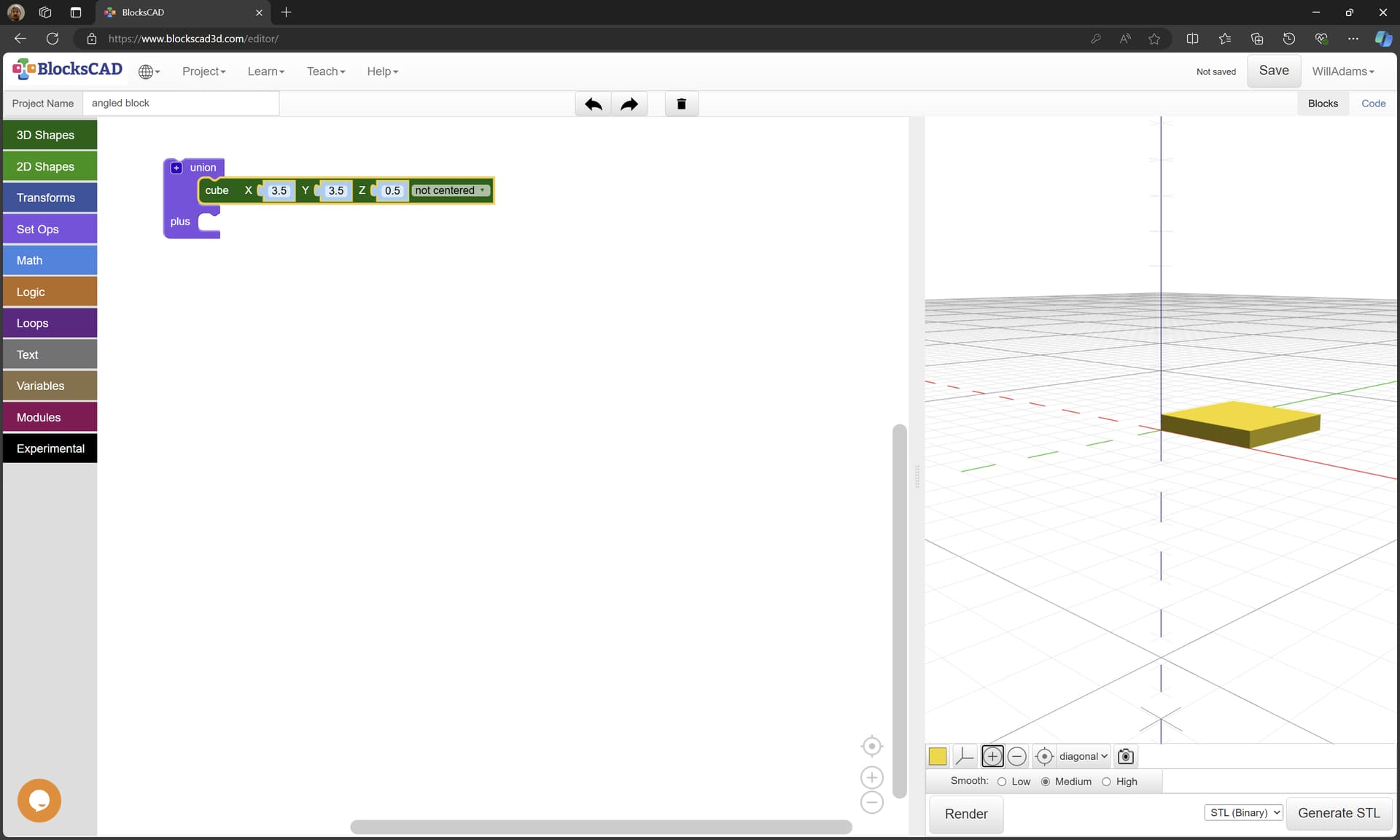

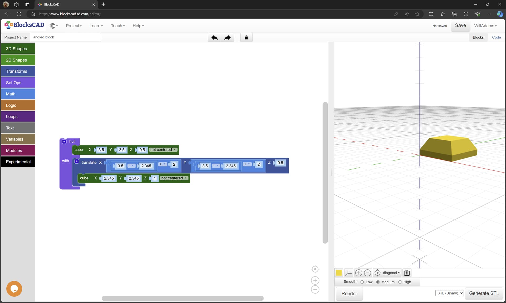

First is a 3D CAD — a free/opensource/online option is BlockSCAD:
https://www.blockscad3d.com/editor/

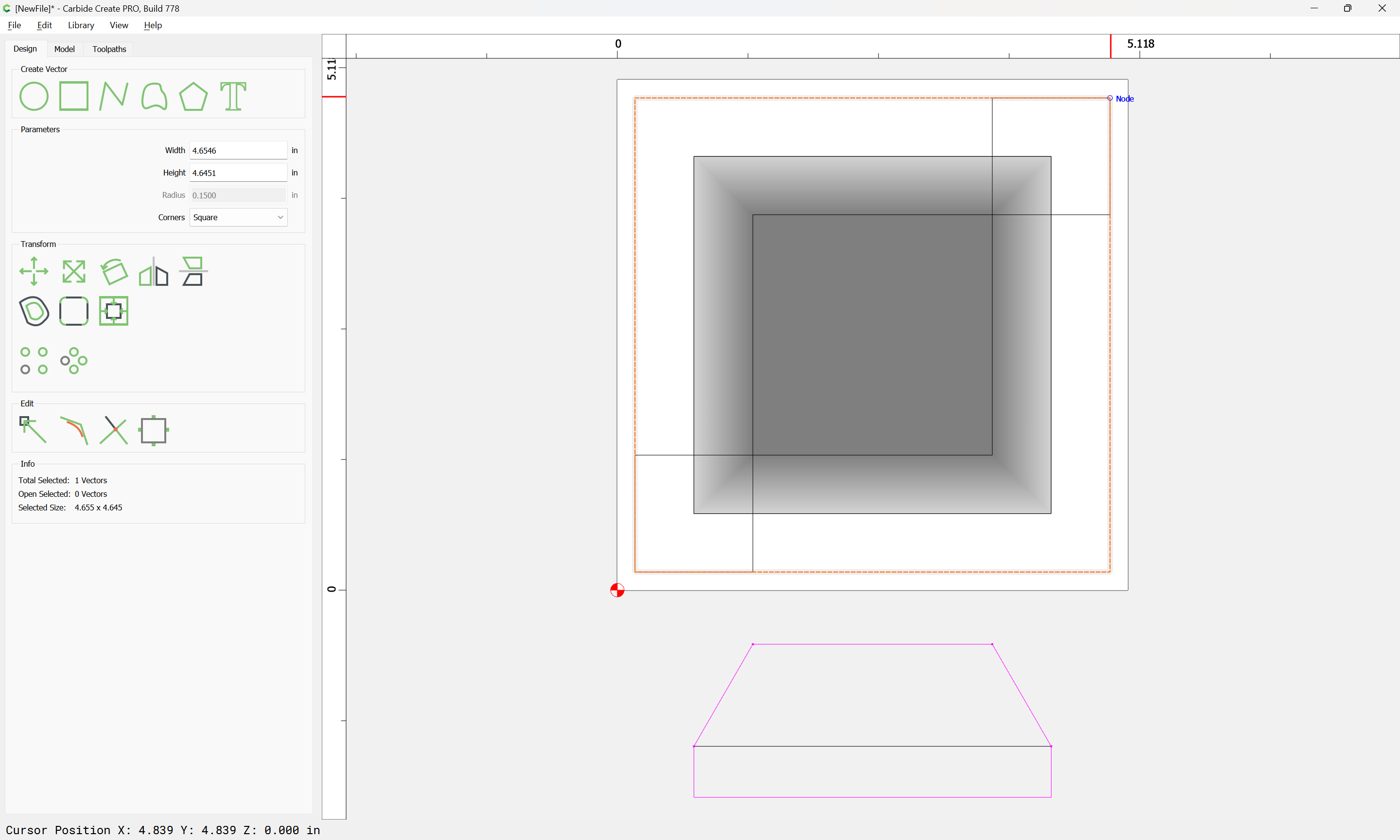

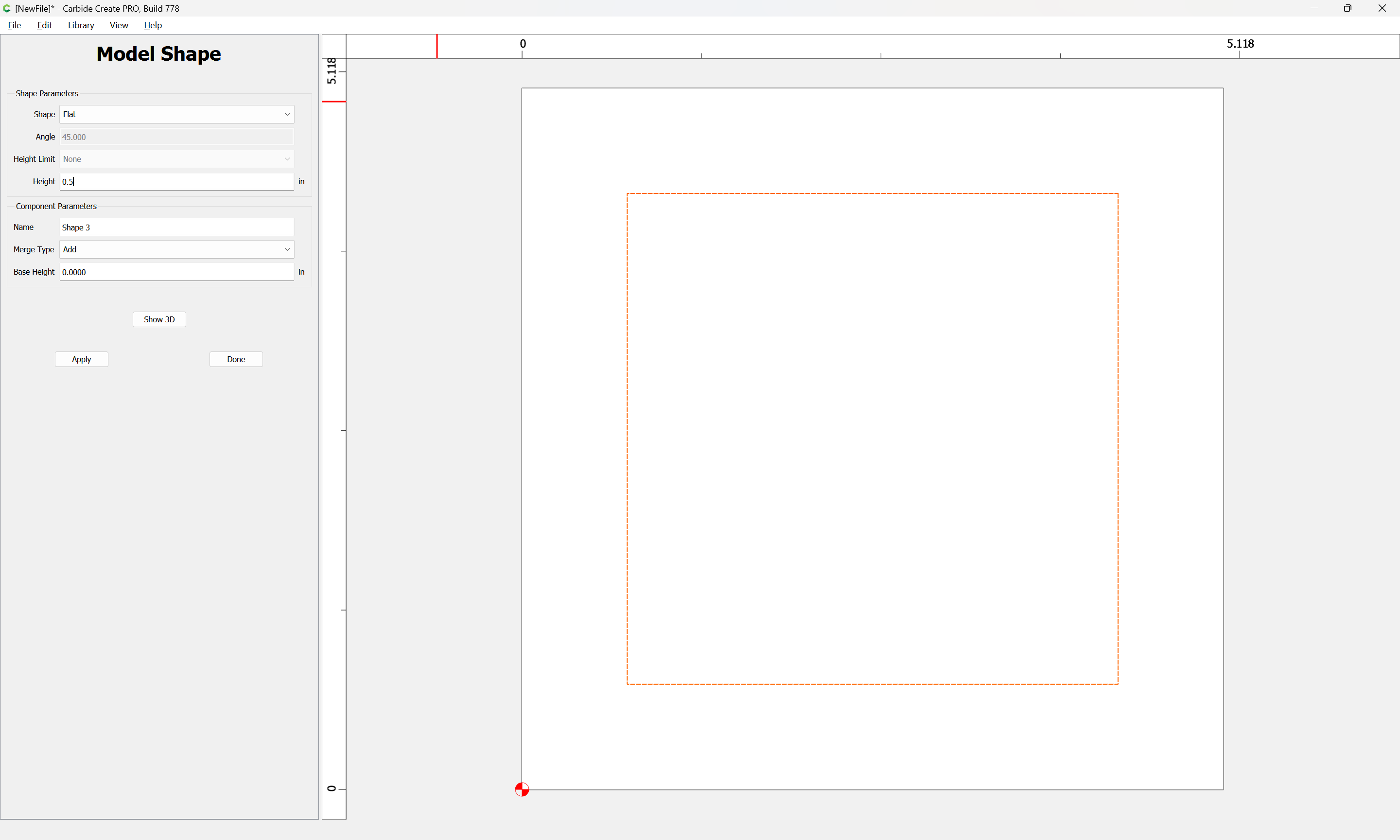

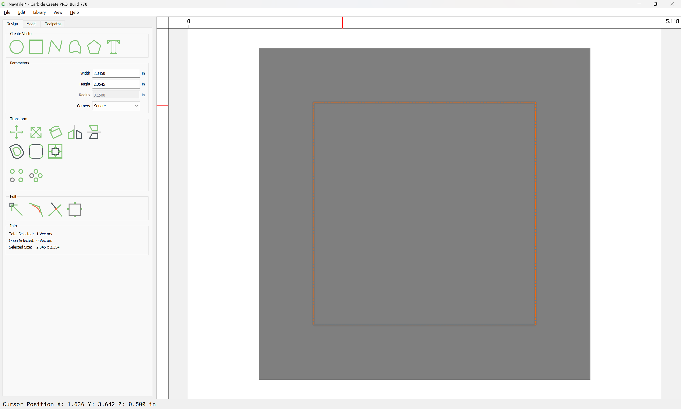

The base is quite simple:

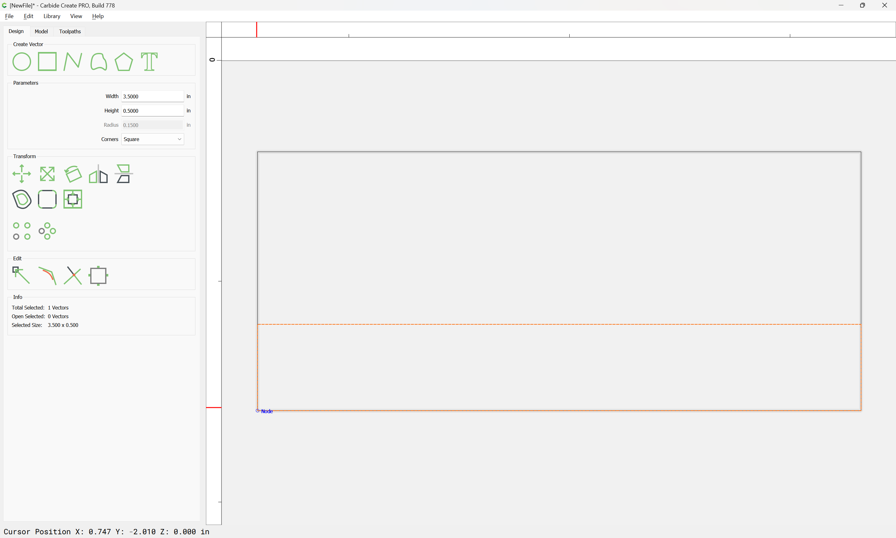

and making the same thing in Carbide Create is likewise quick/simple:

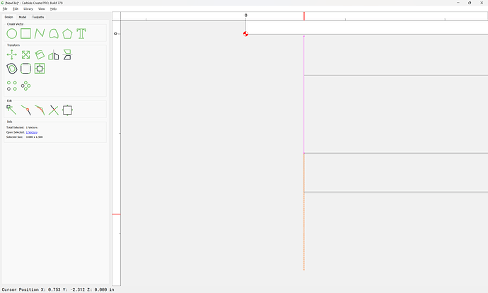

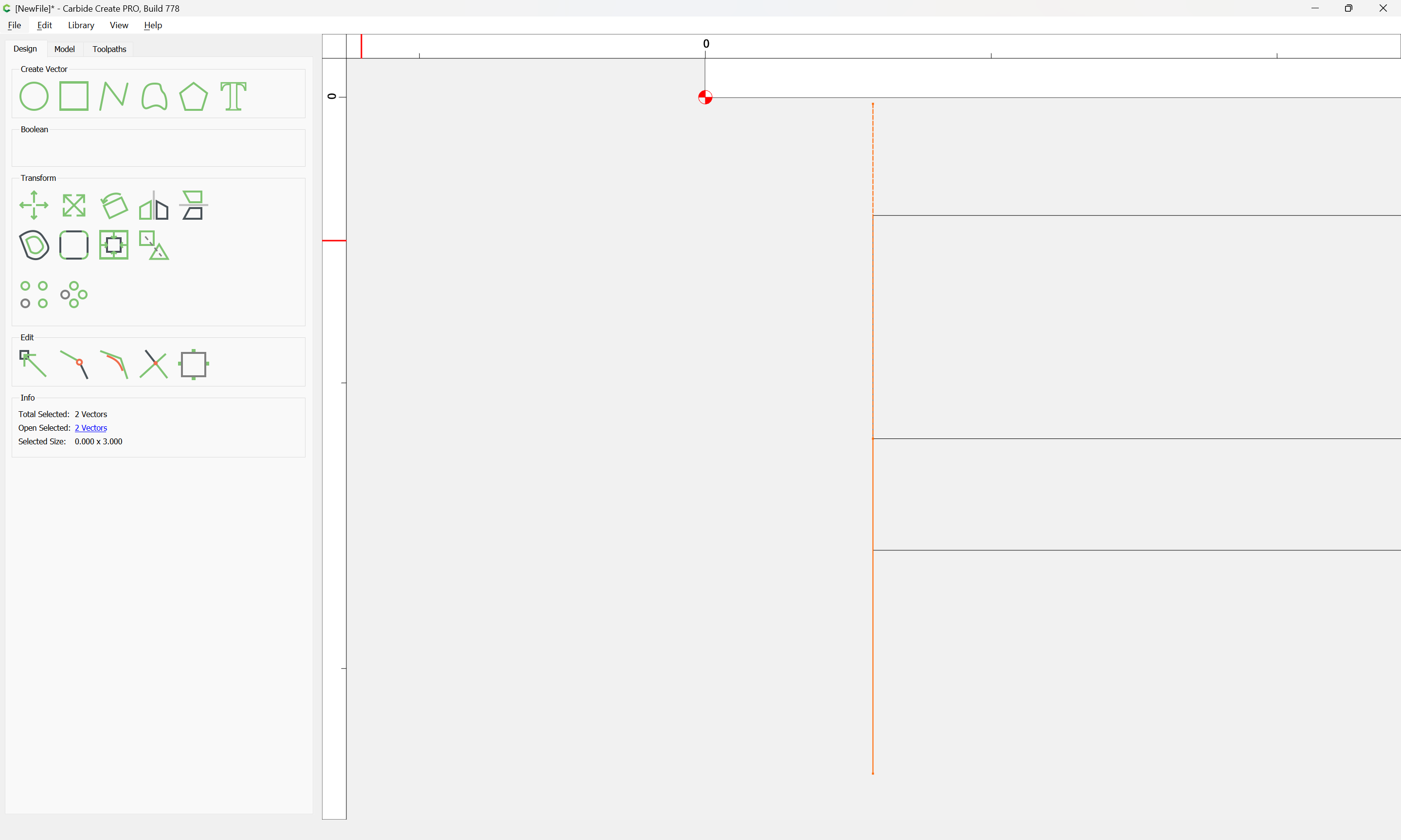

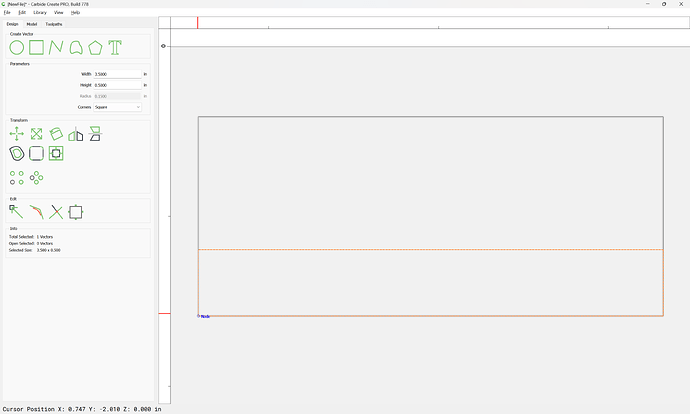

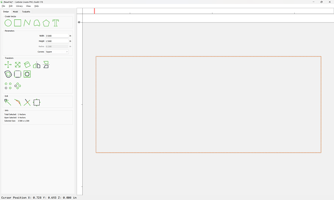

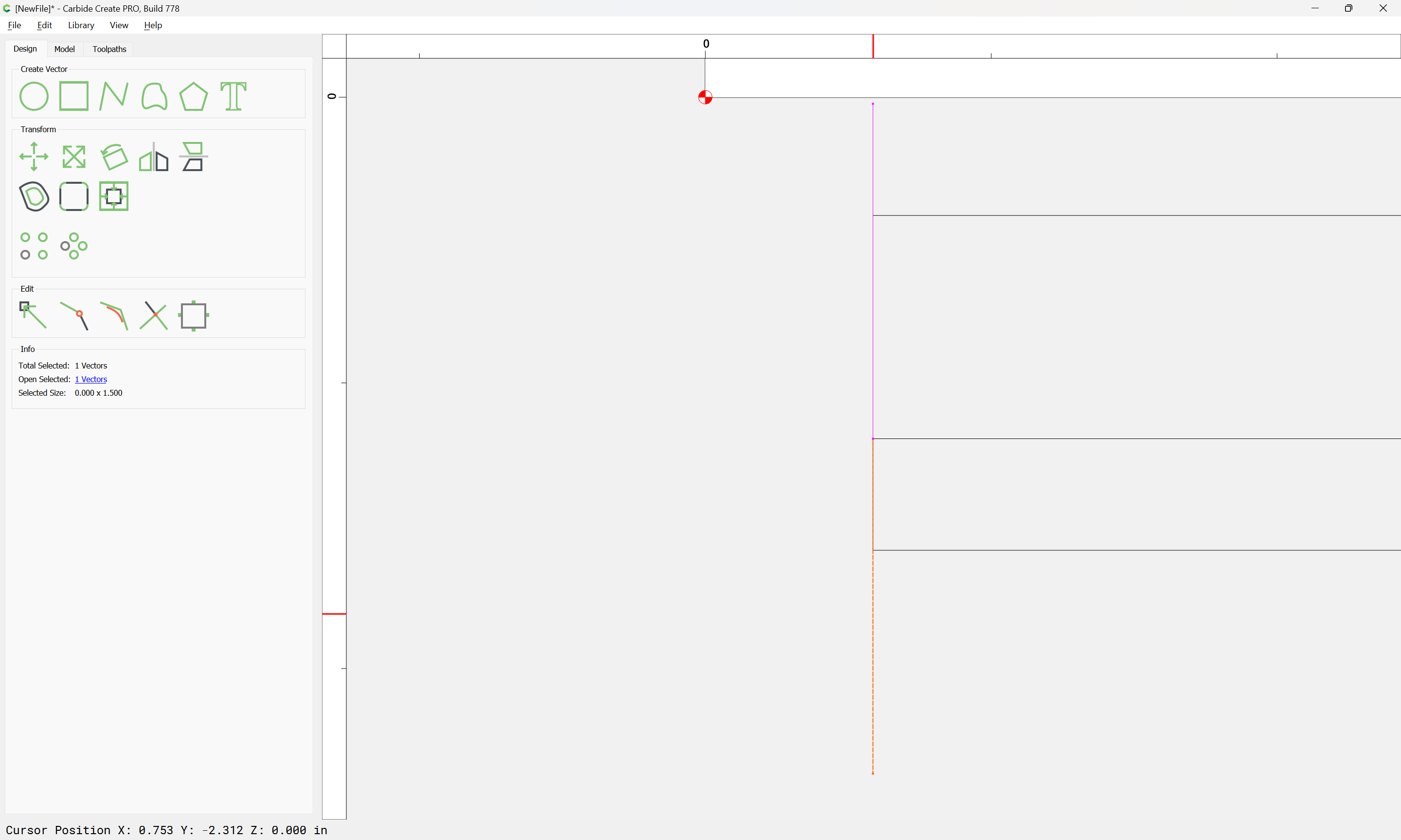

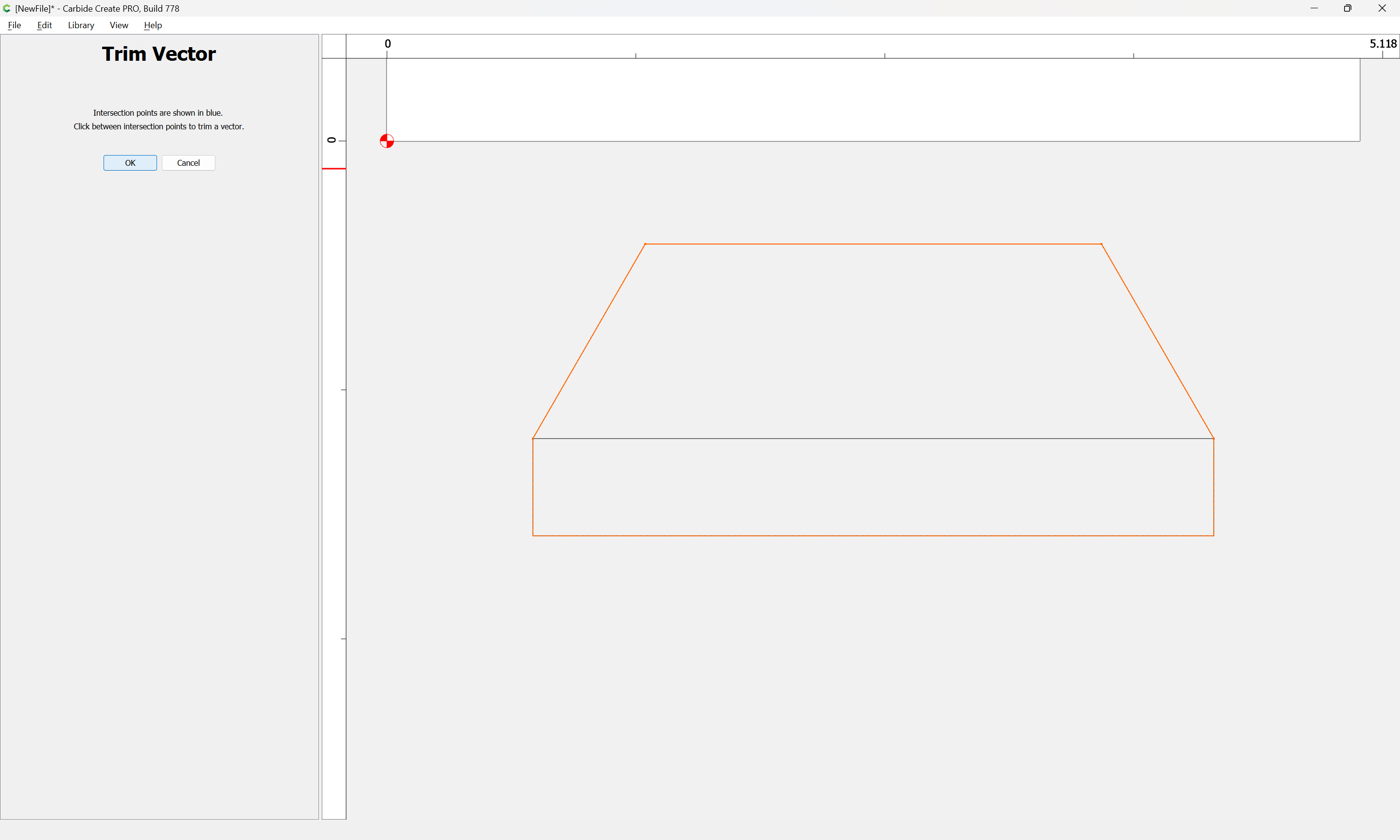

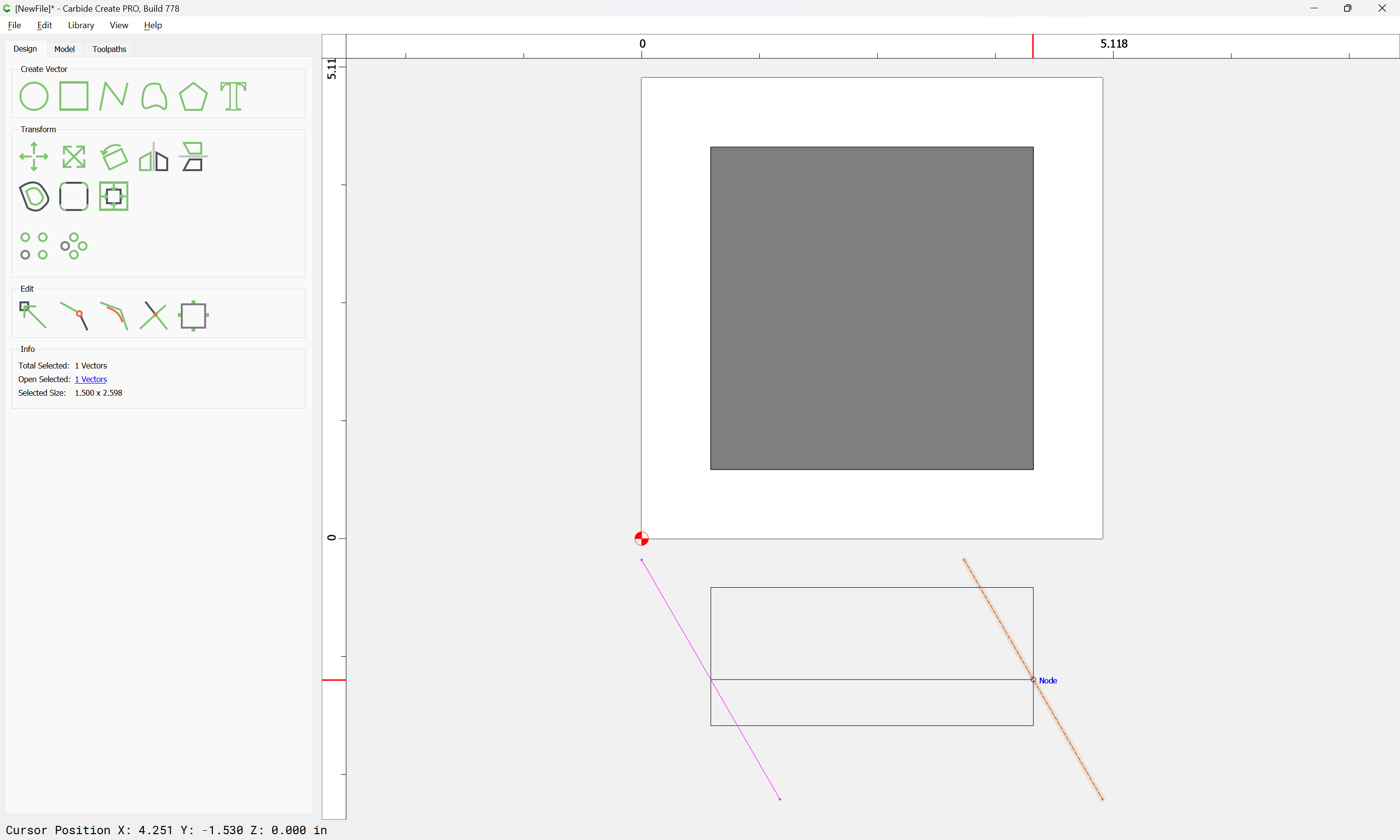

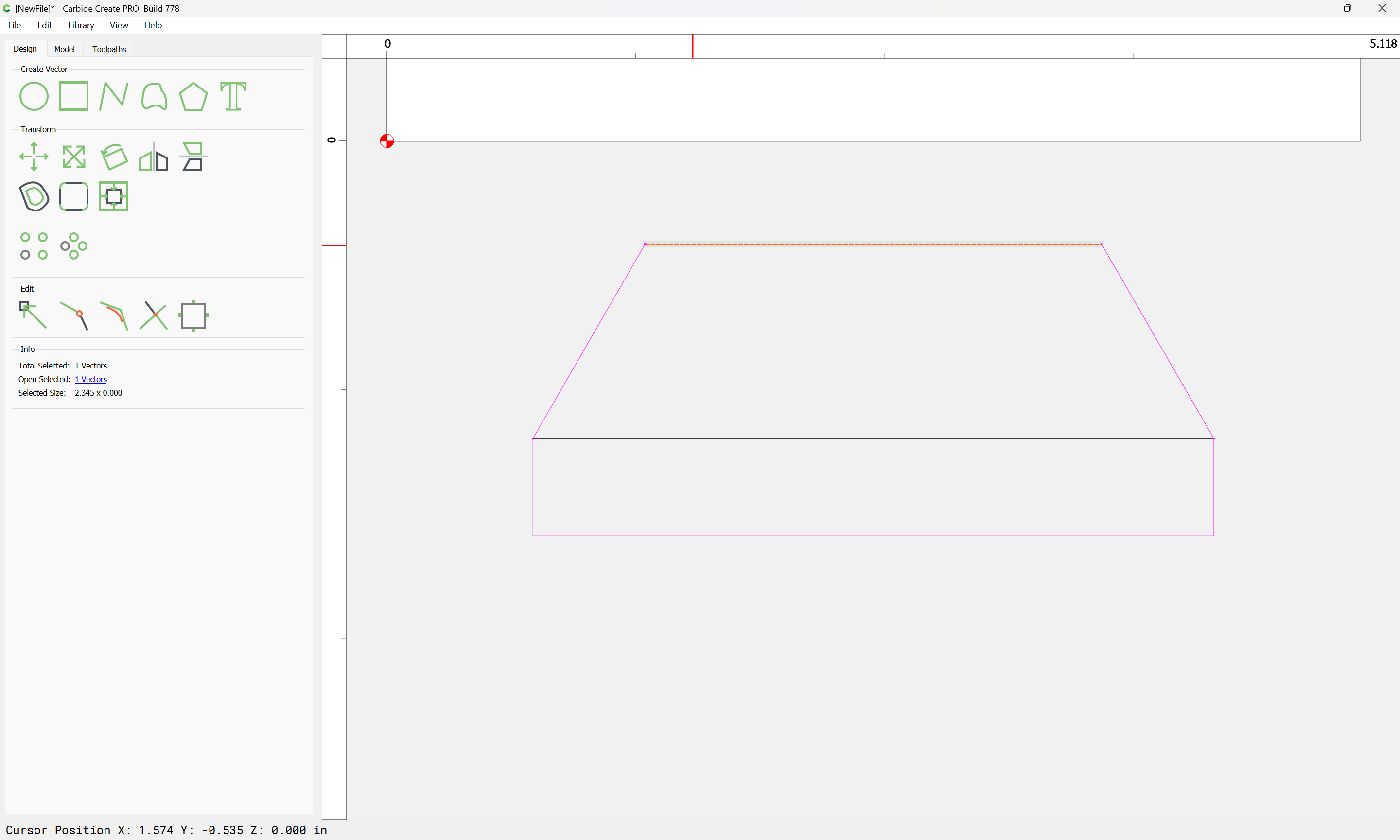

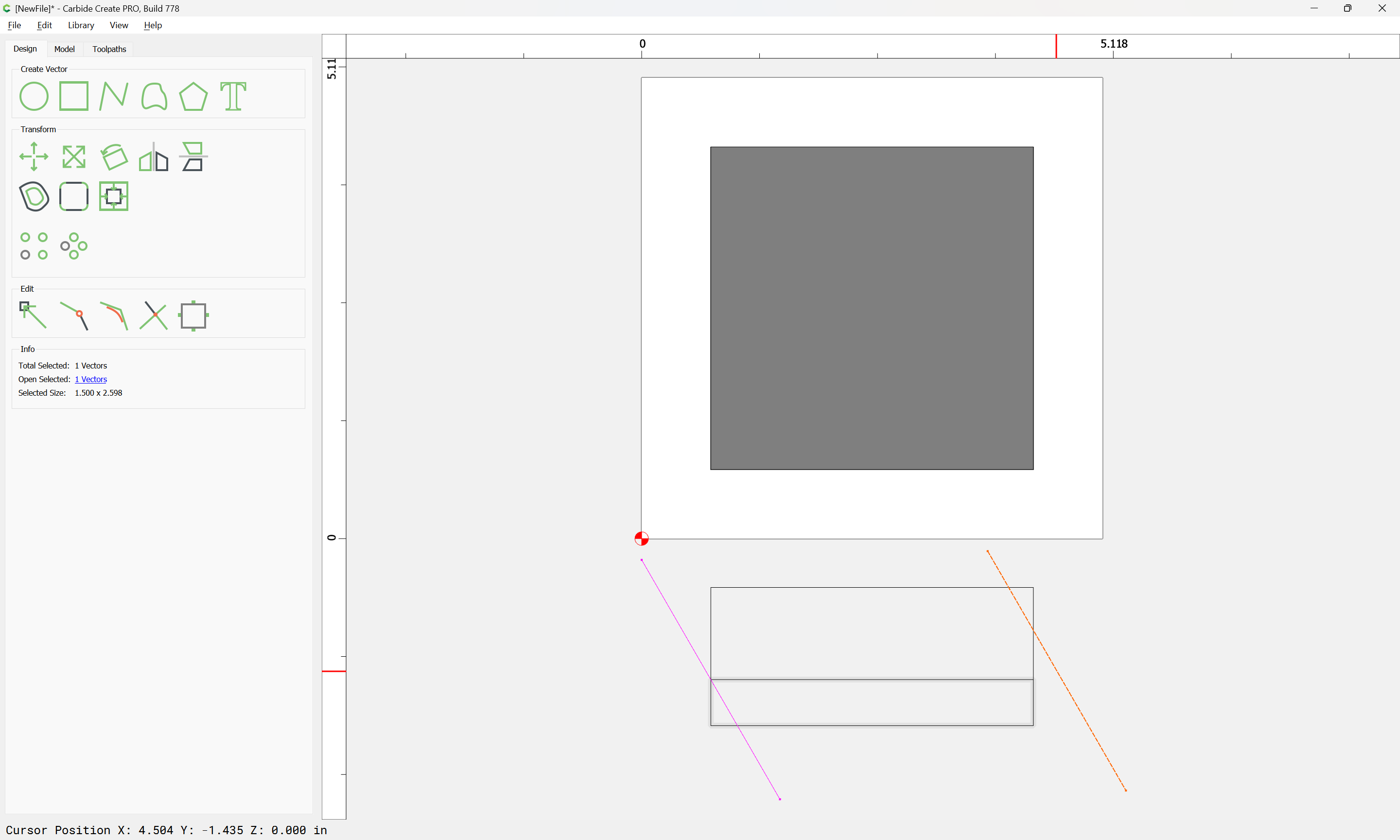

Next we need to draw things up in profile:
and then work up the angled line:

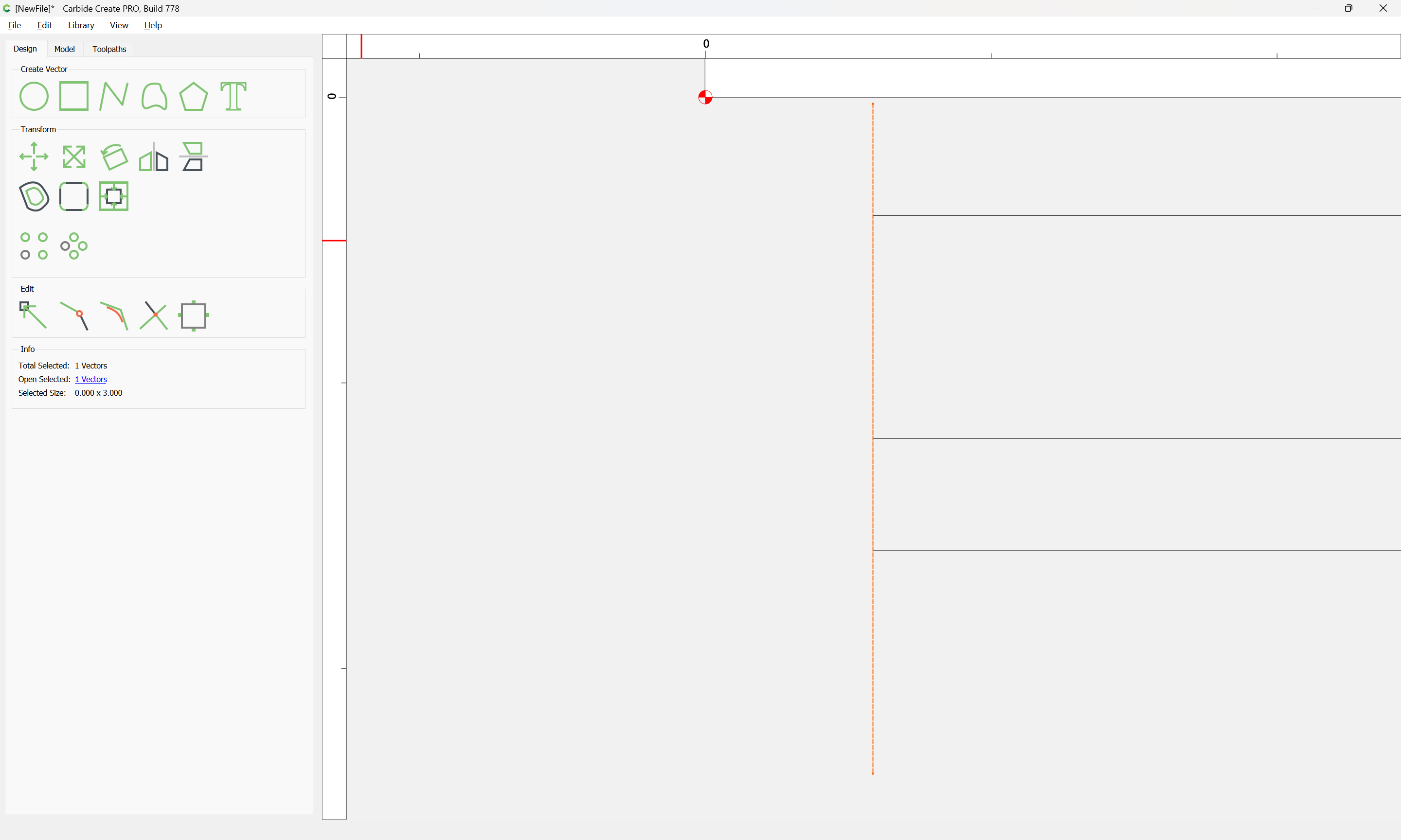

Draw two lines:
and join them:

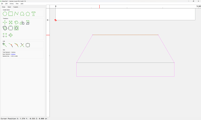

Yes

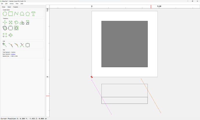

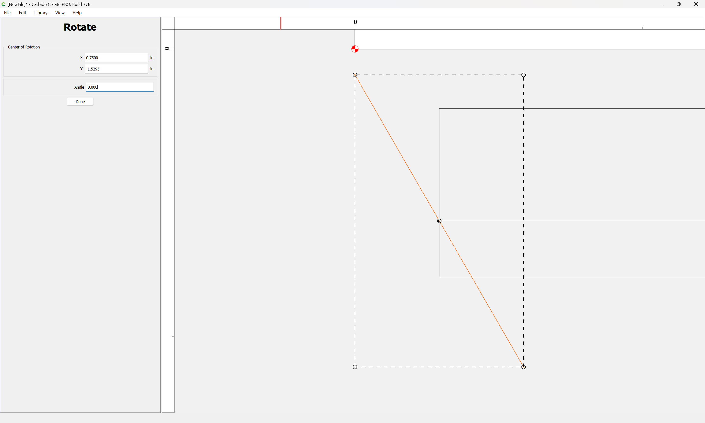

Then rotate 30 degrees:
Done
copy-paste
then drag into alignment:

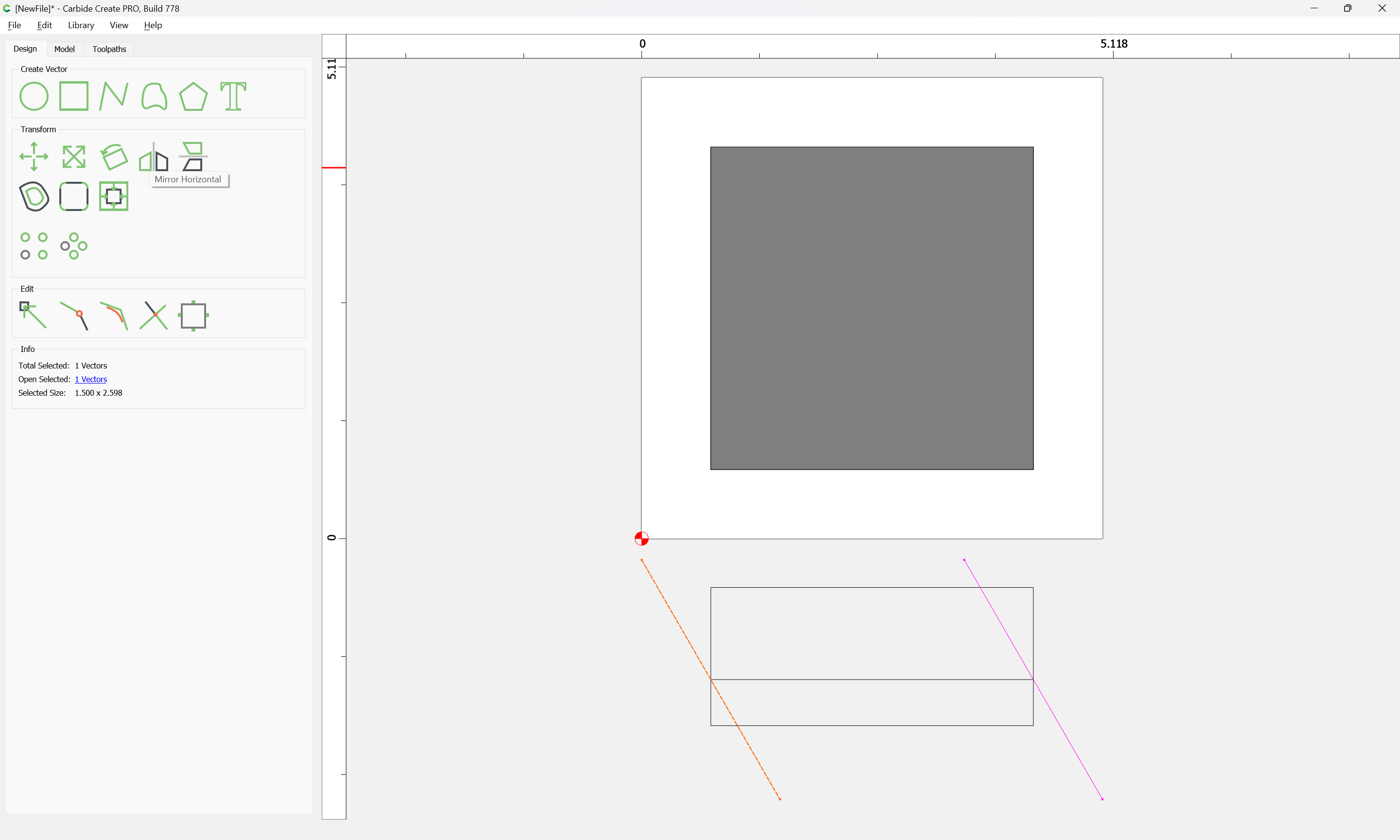

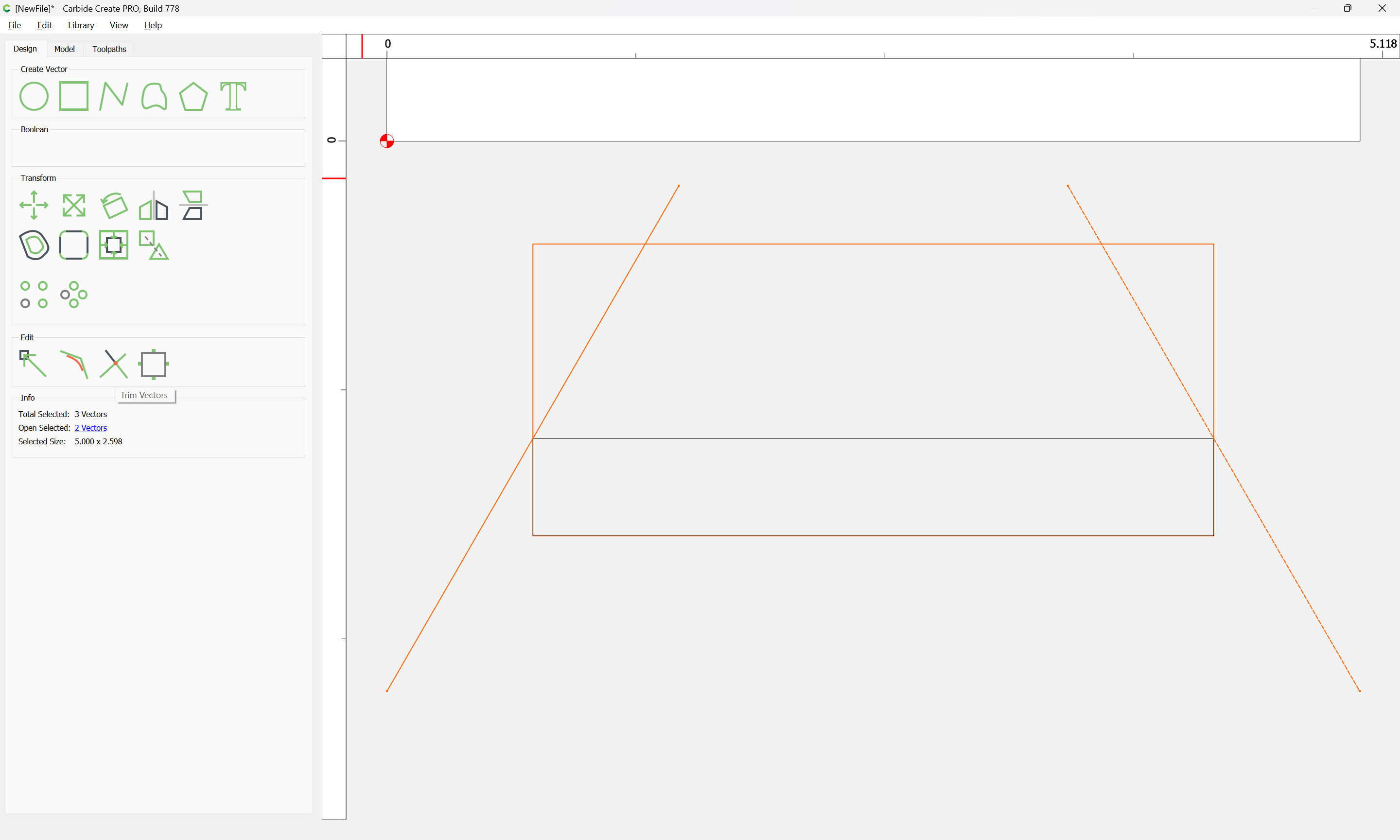

Then select the other:
and mirror it:

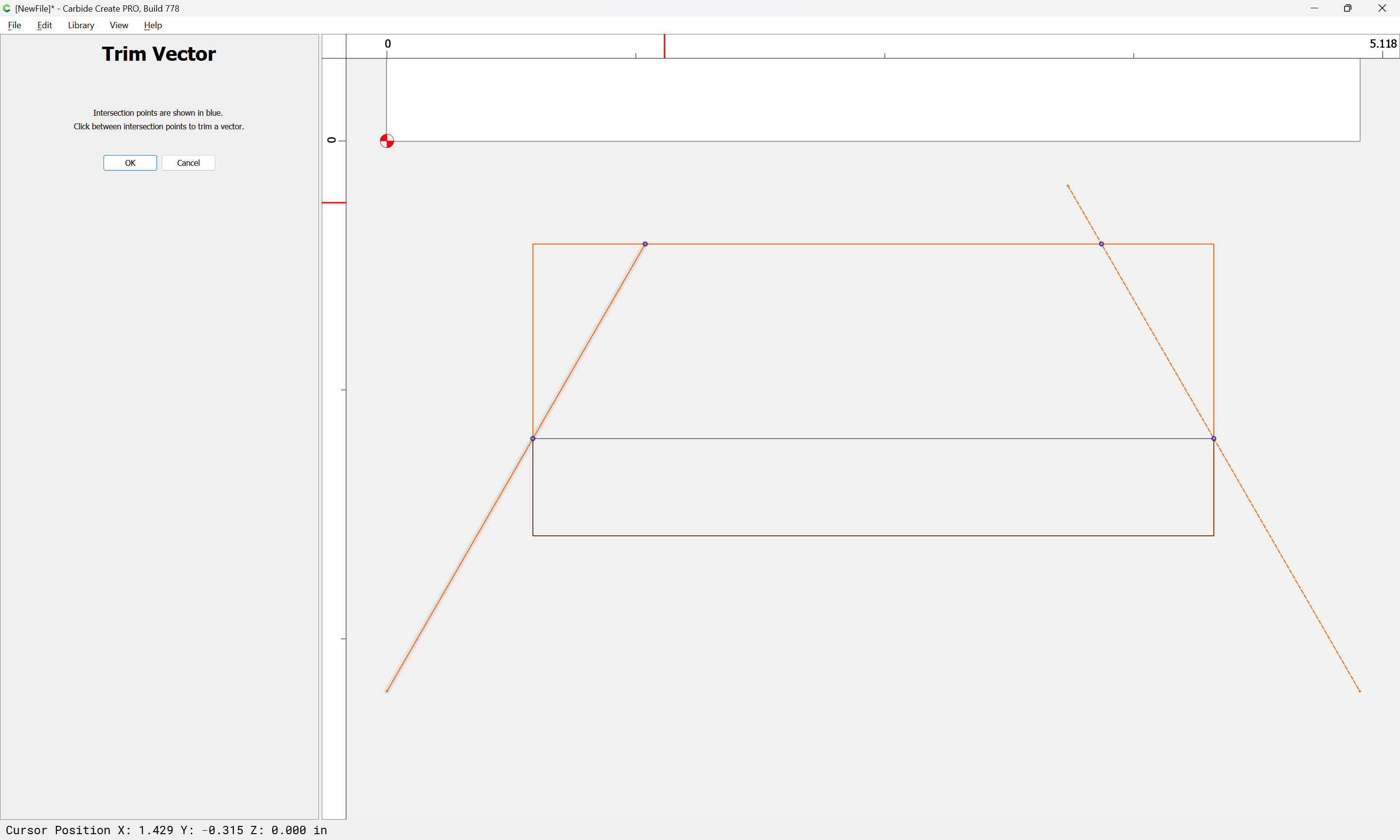

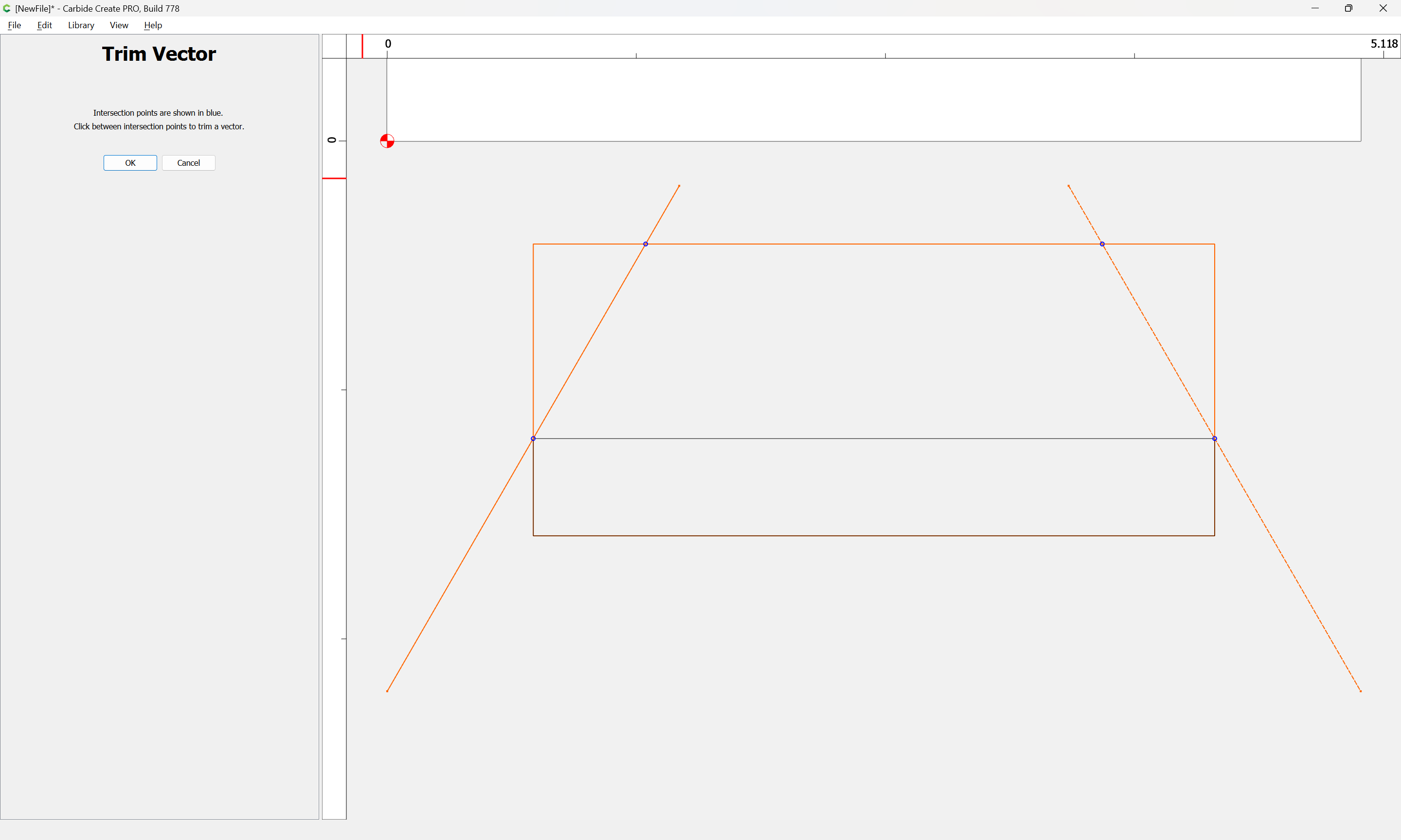

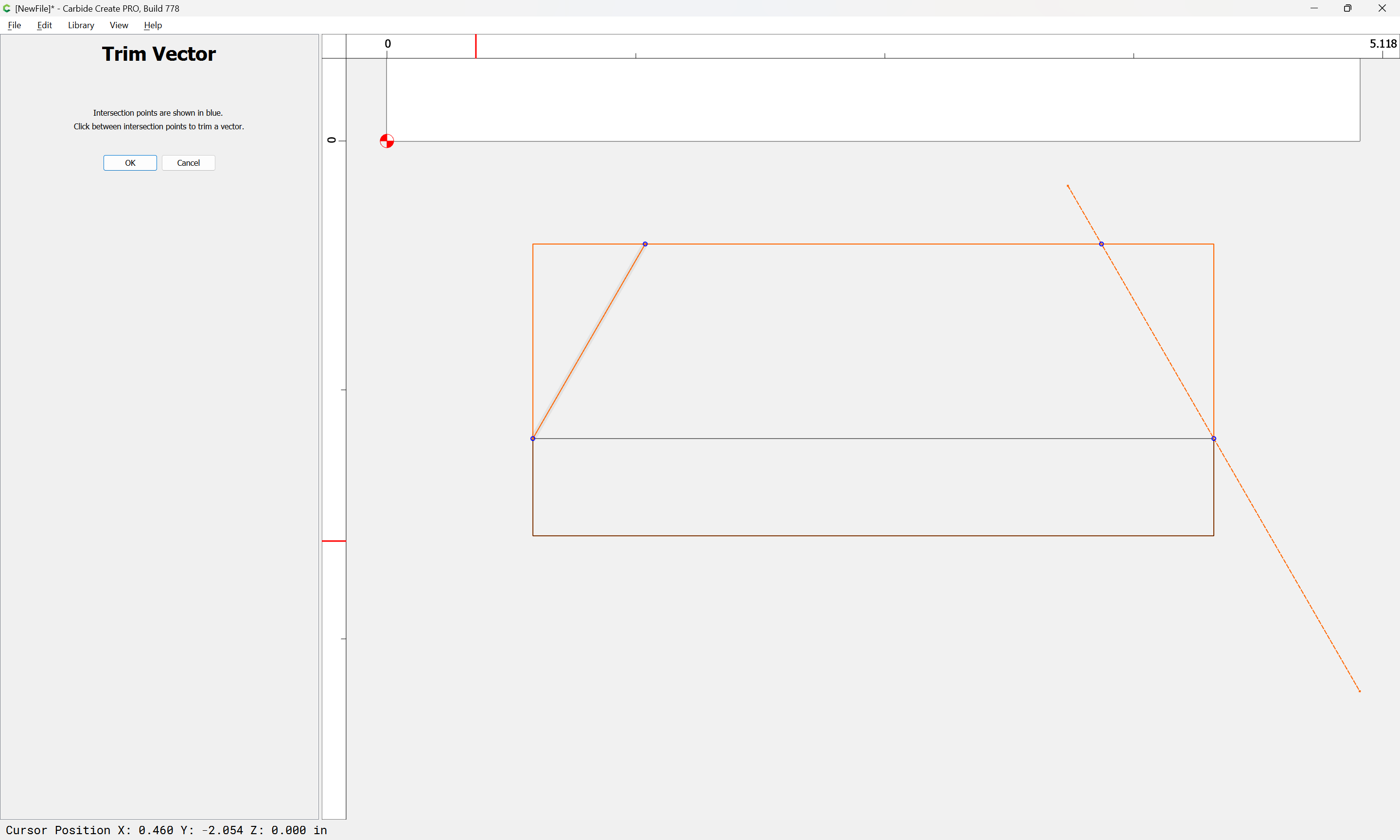

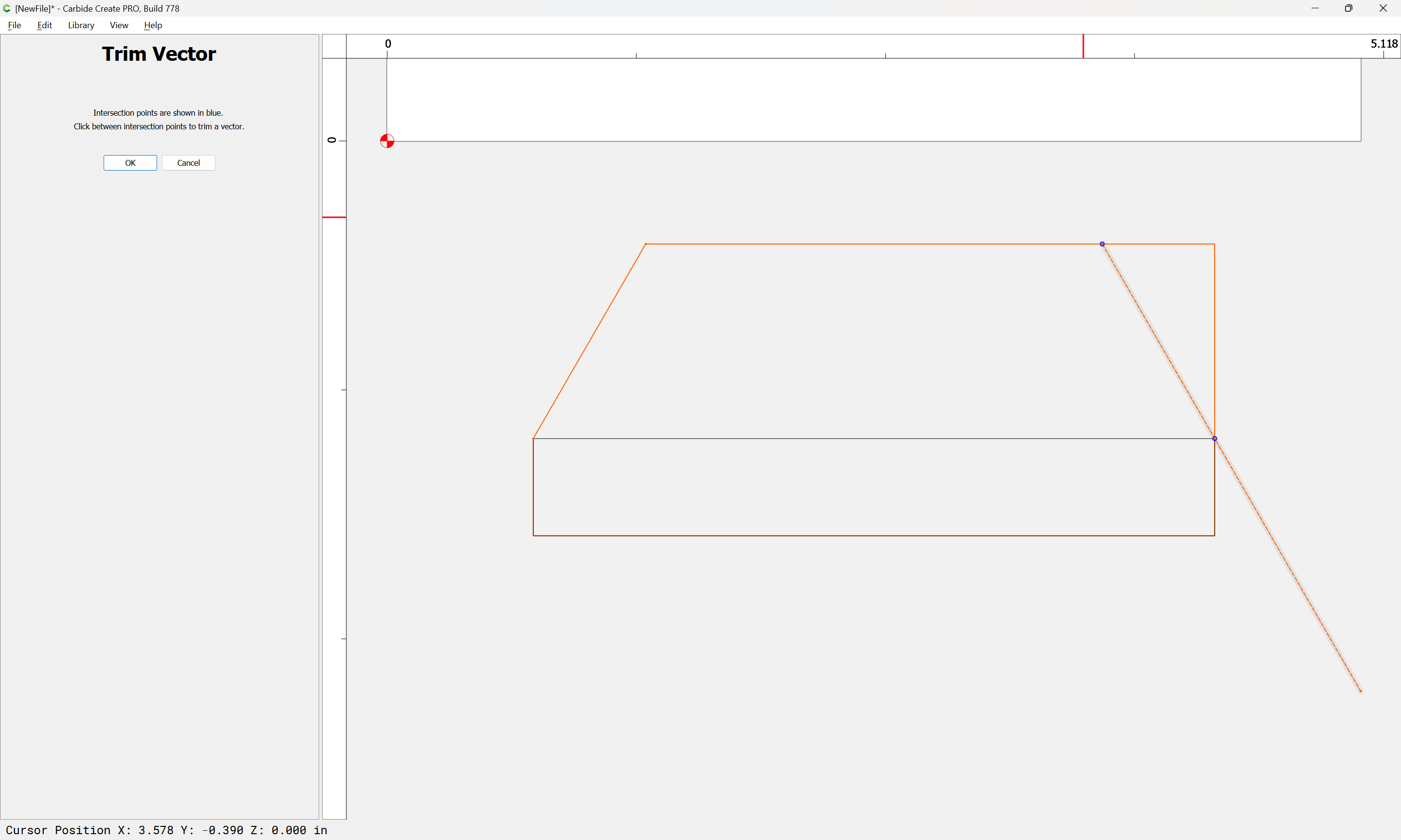

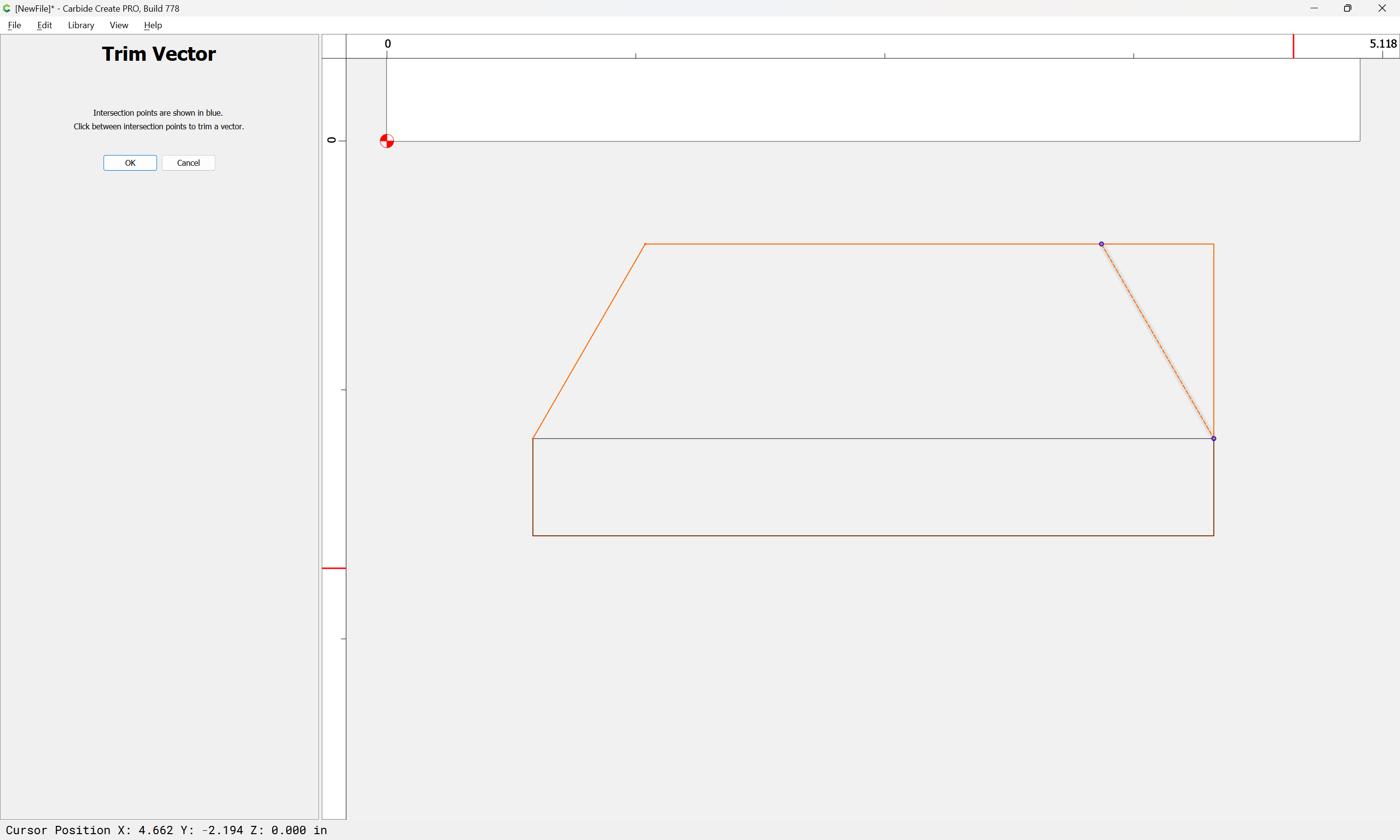

Select the geometries:

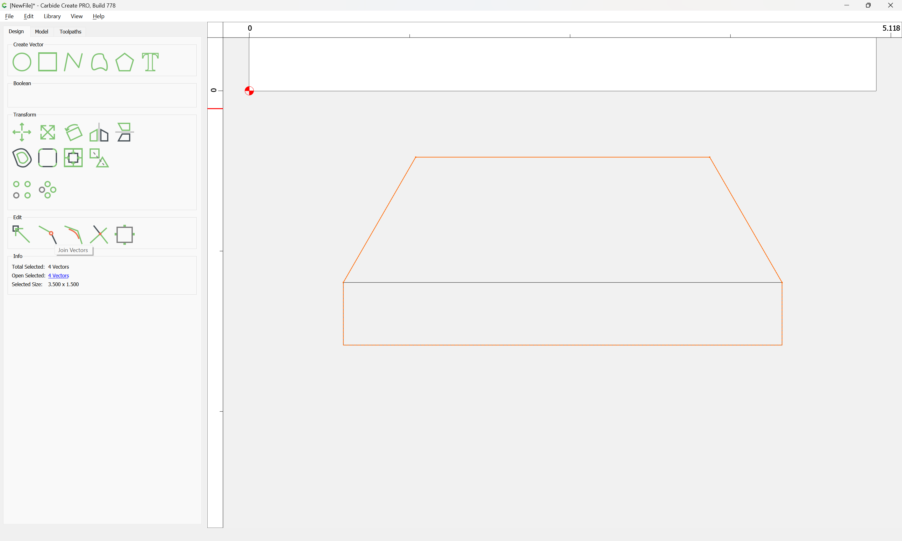

and use the Trim Vectors tool to remove what is not wanted:
OK
OK
If desired, use Join Vectors.

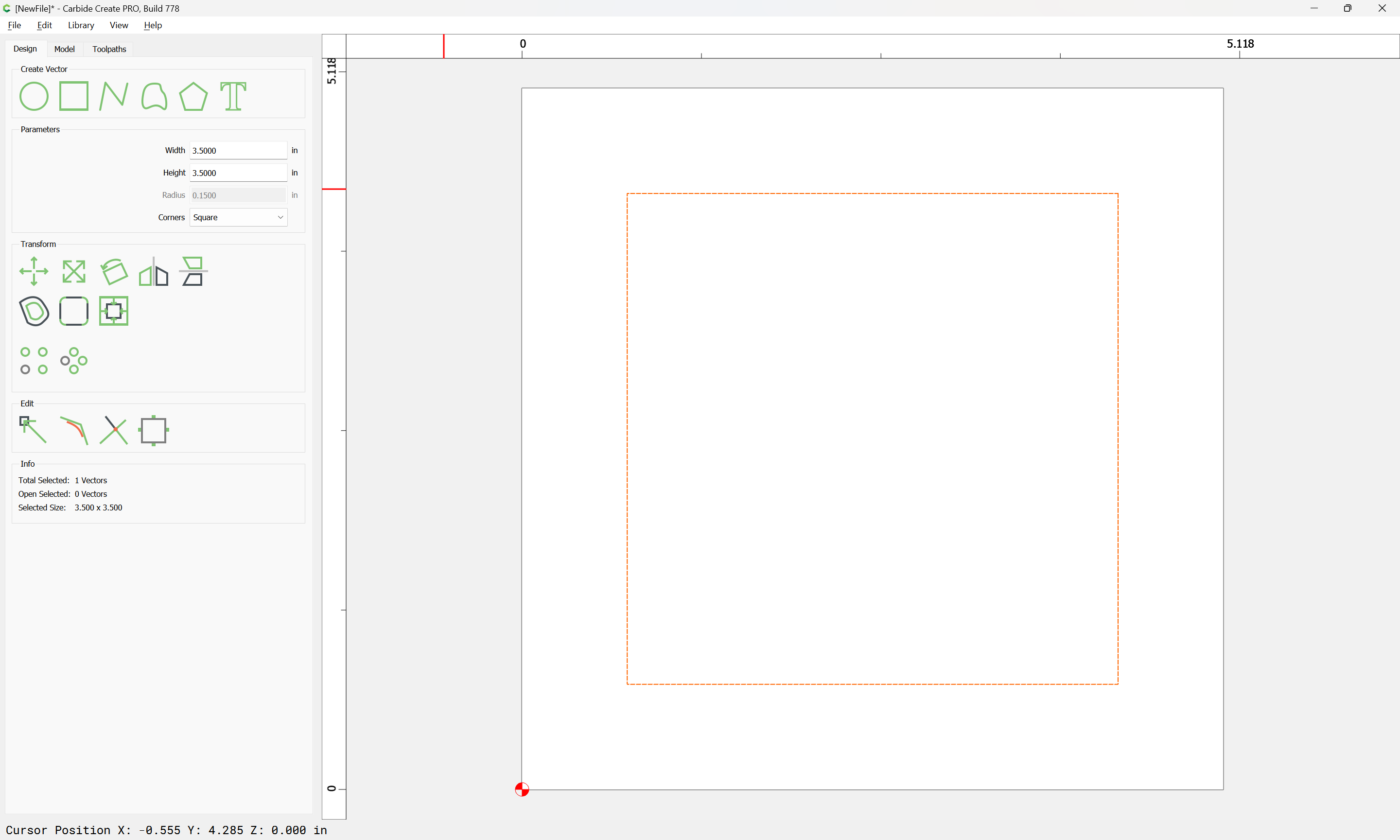

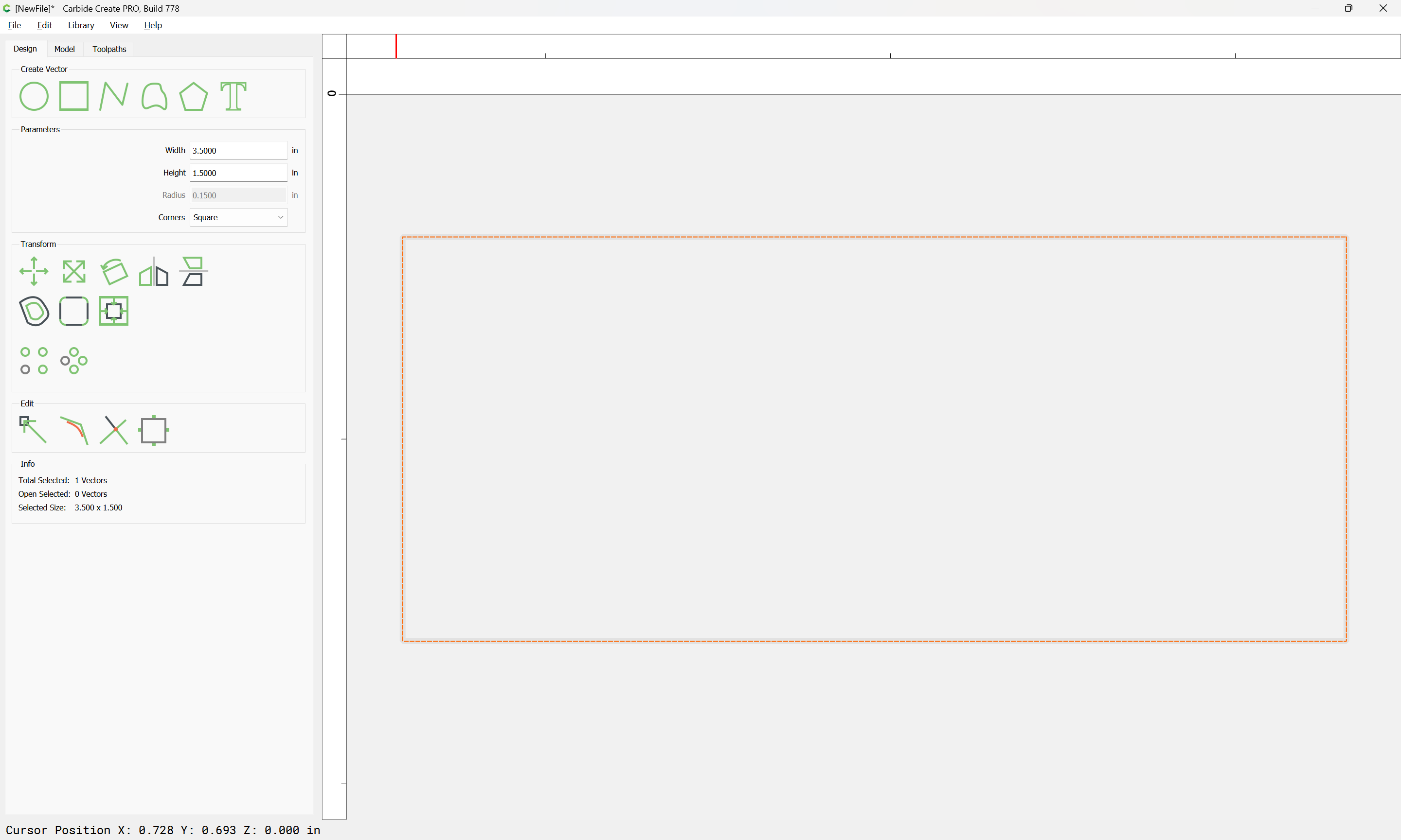

The necessary point is to get the side of the square:
so we make a square of that dimension:

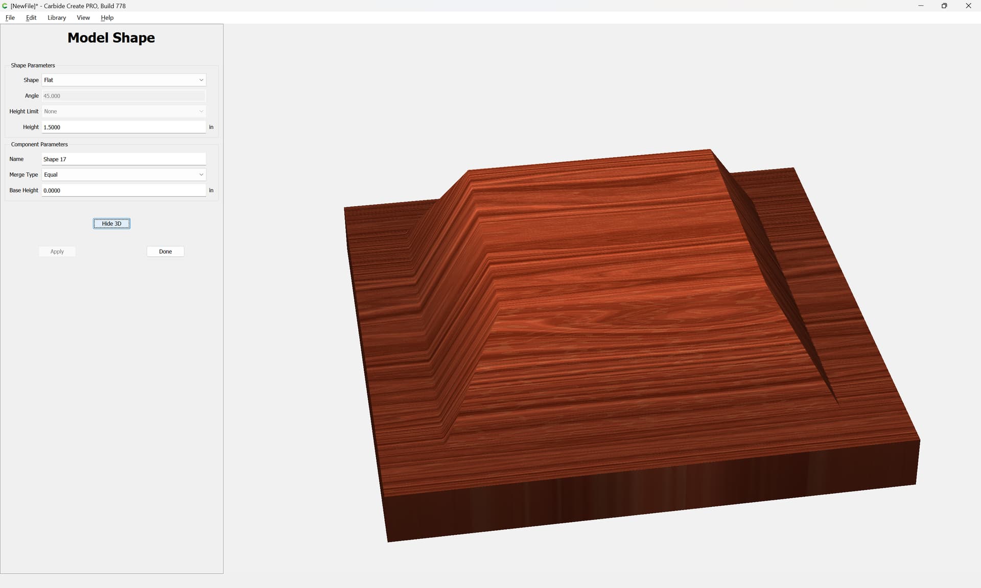

and knowing this dimension we can finish making the 3D model:
which just requires changing the bounding operation from Union to Hull:

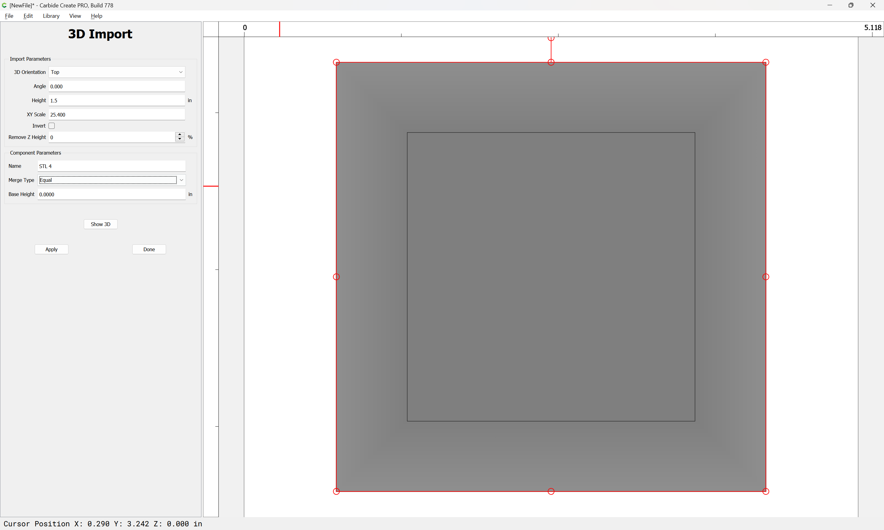

which may then be exported as an STL:
angled block.stl (1.1 KB)

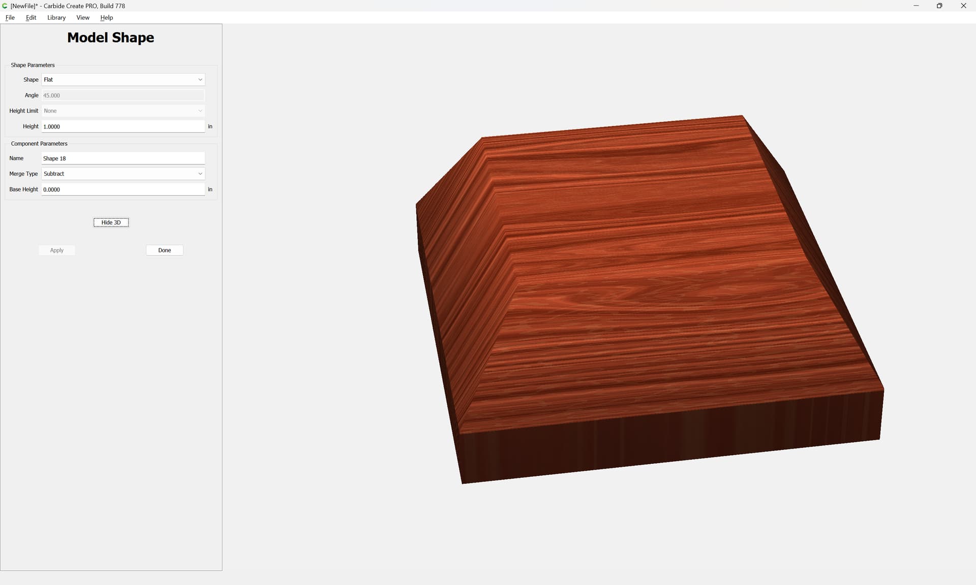

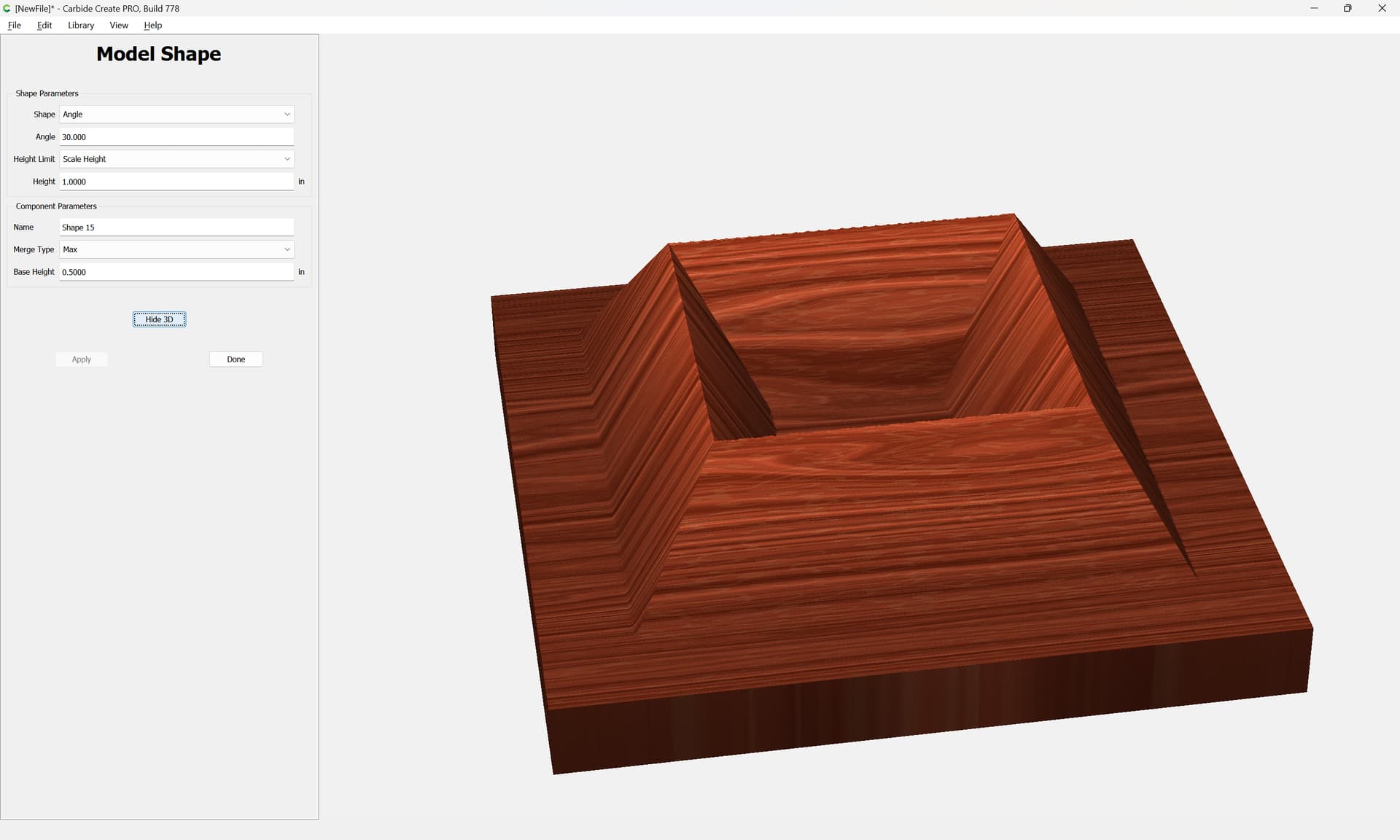

which may be imported to make the 3D Model:

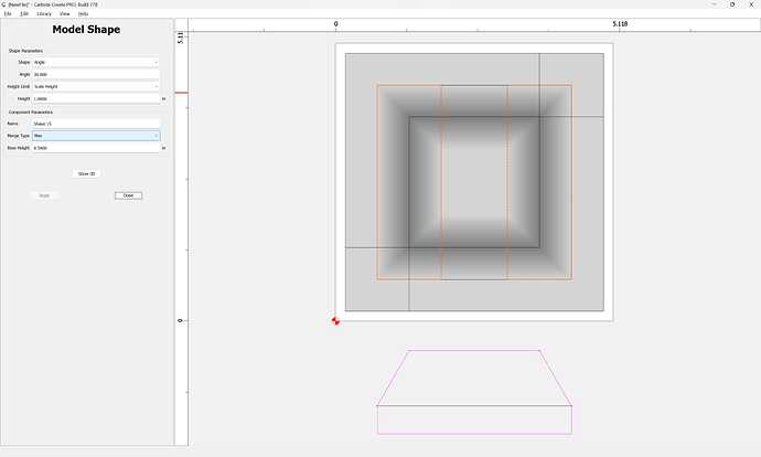

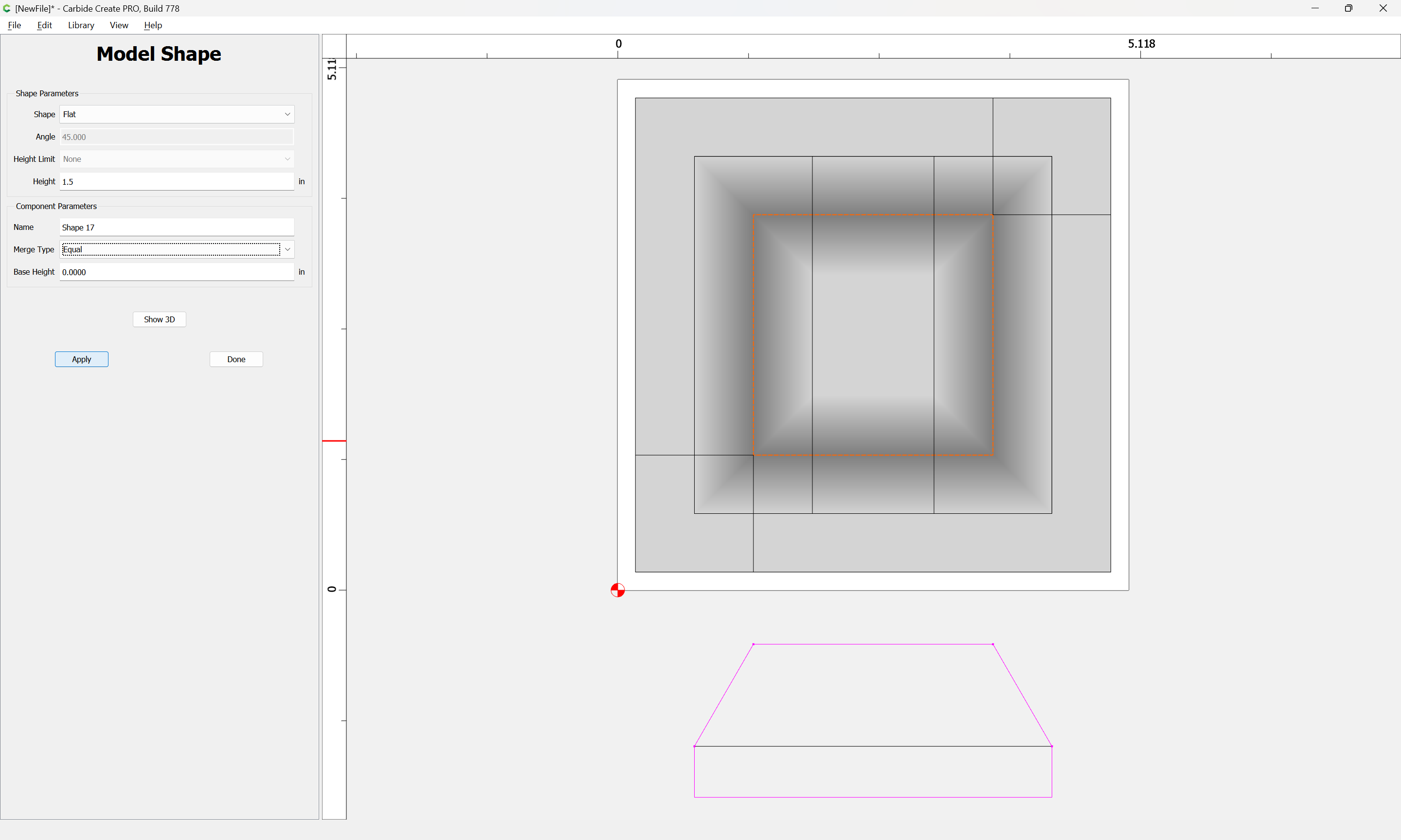

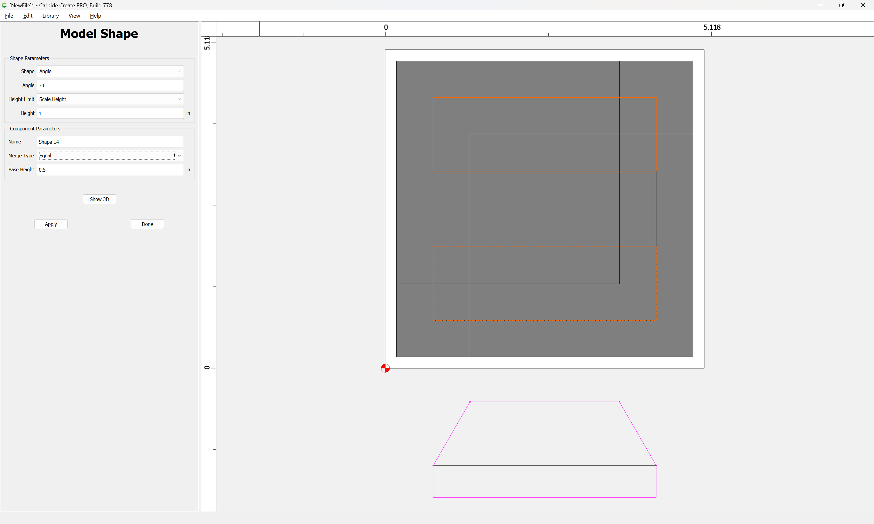

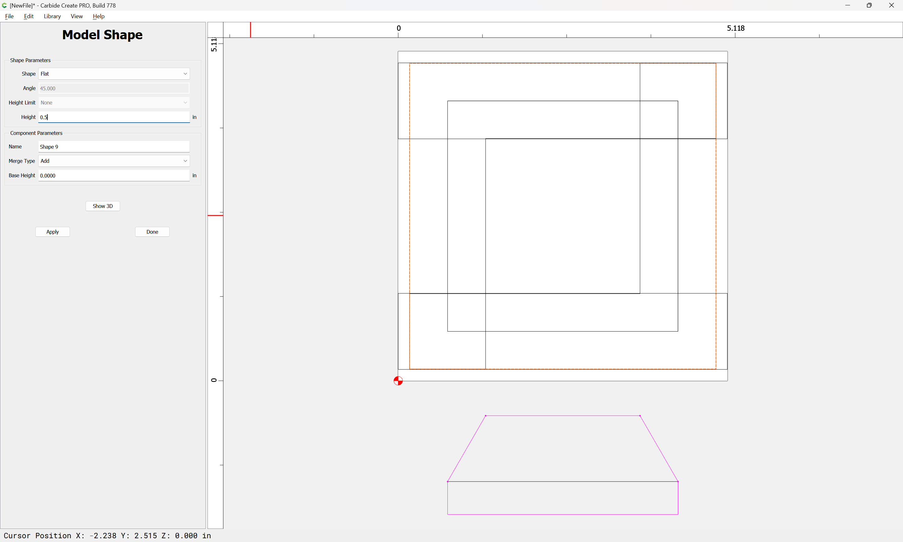

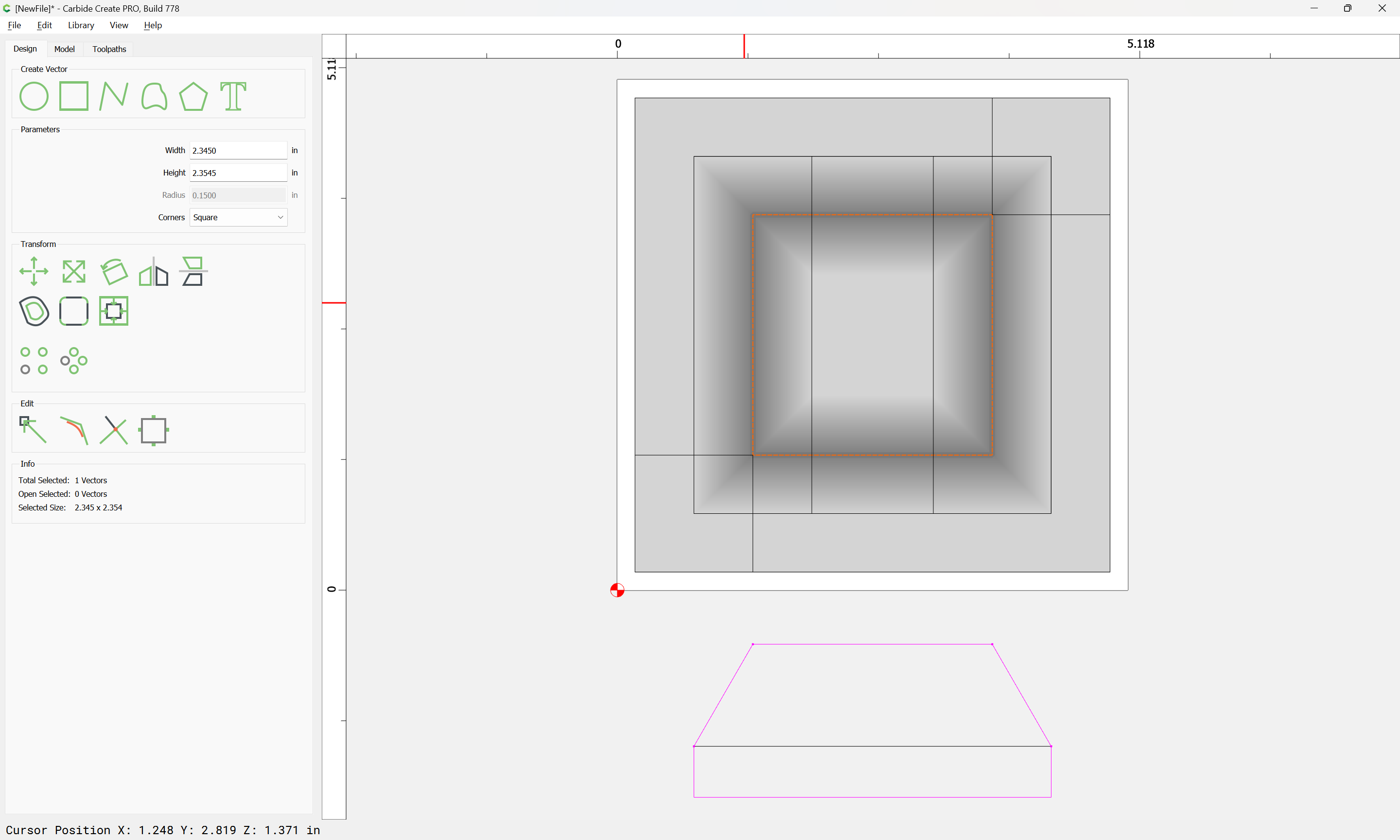

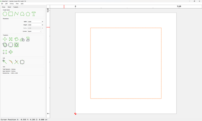

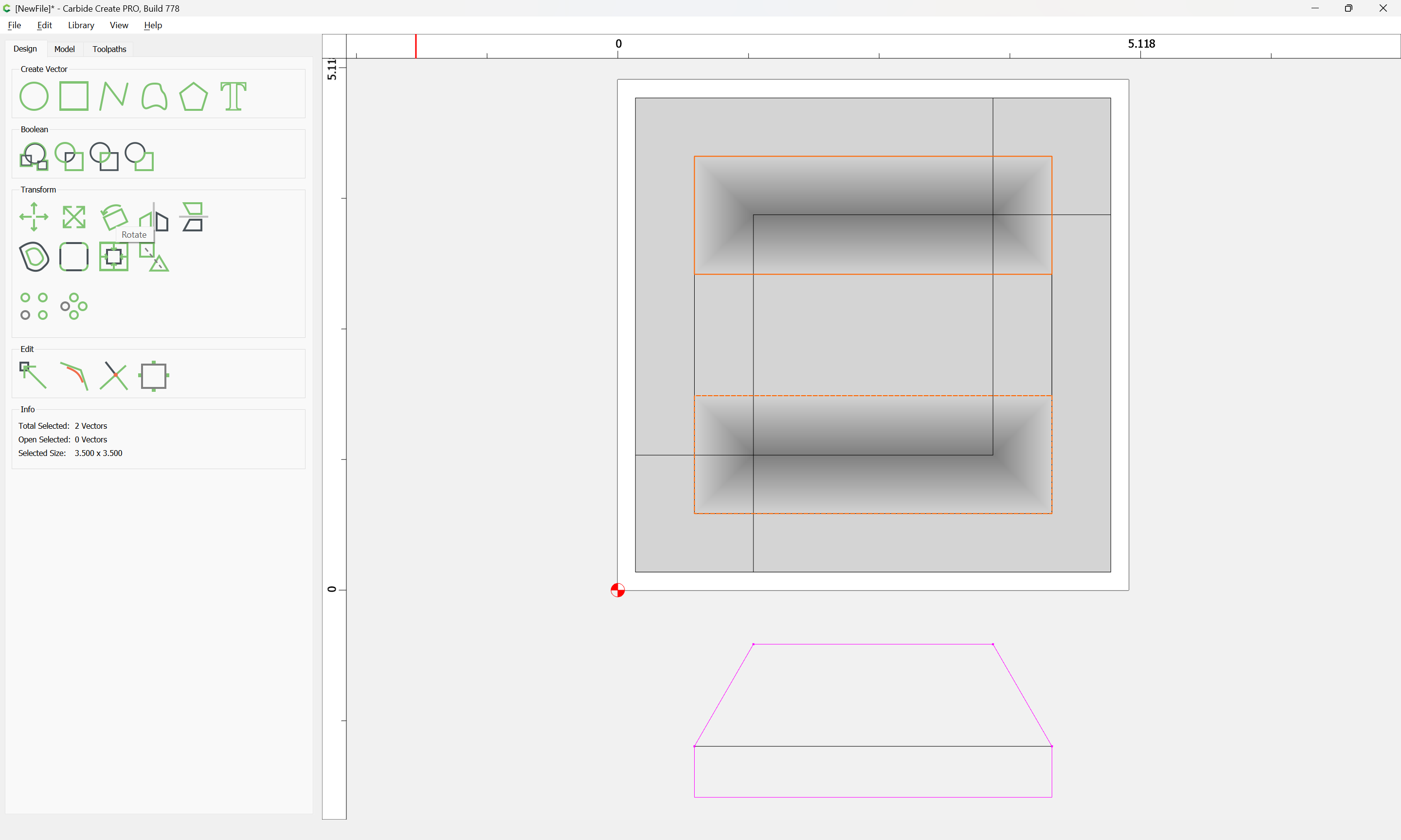

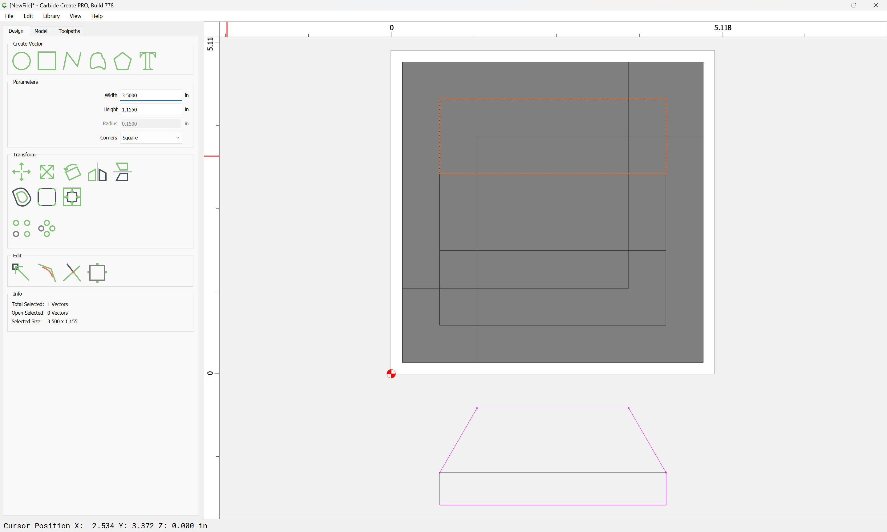

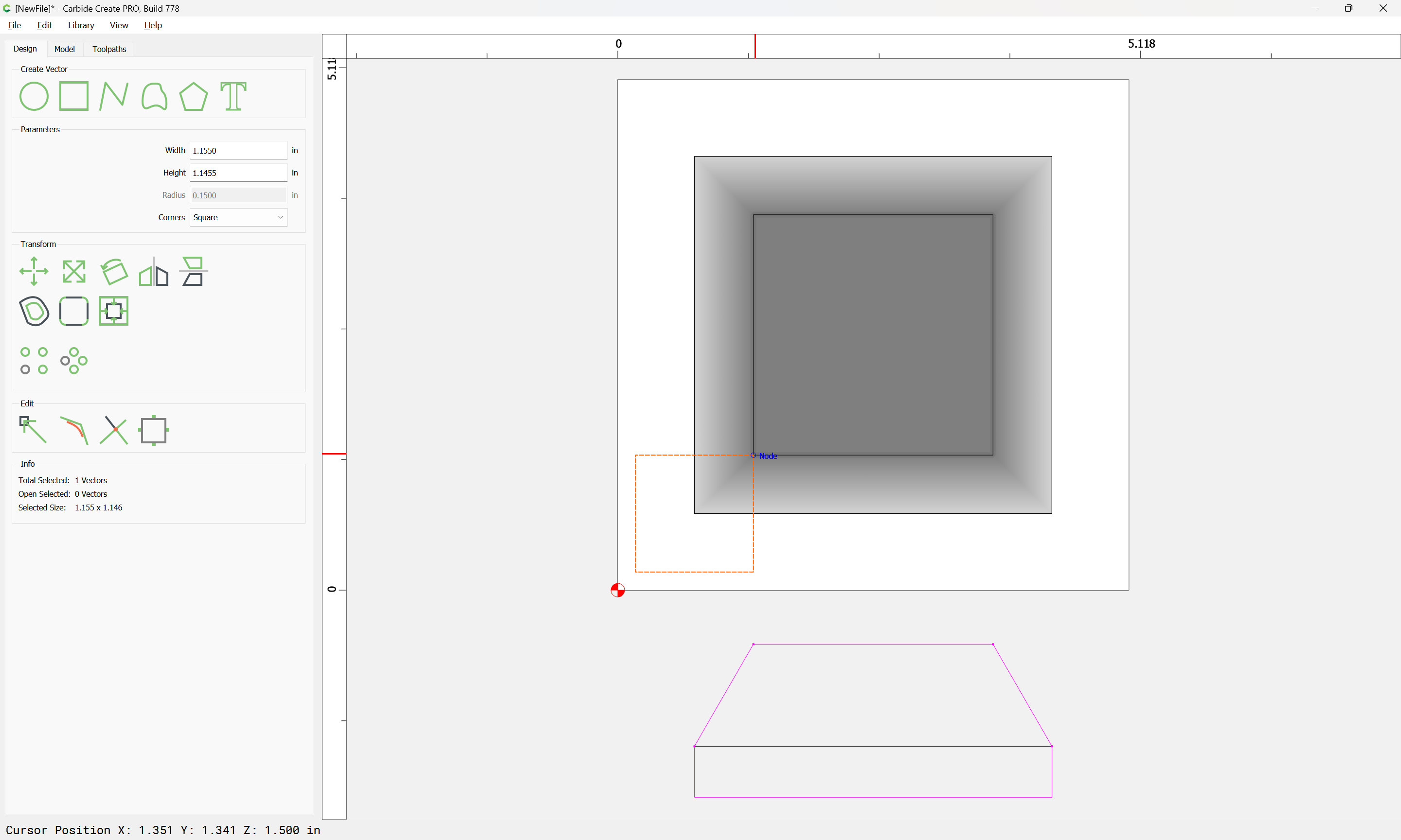

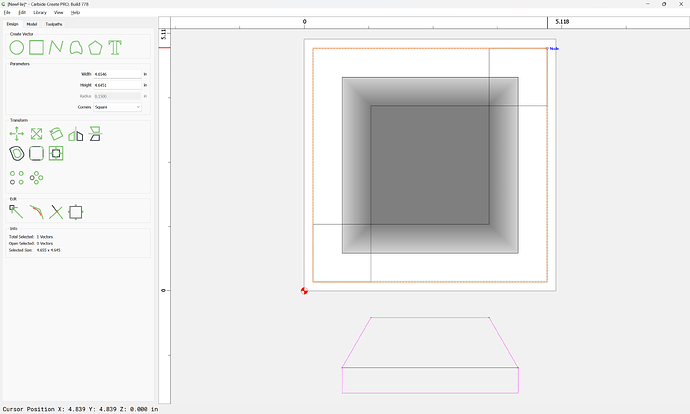

To make the equivalent in Carbide Create Pro requires drawing in some more geometry:

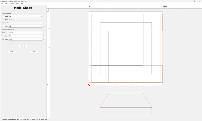

Model this to the thickness of the base:

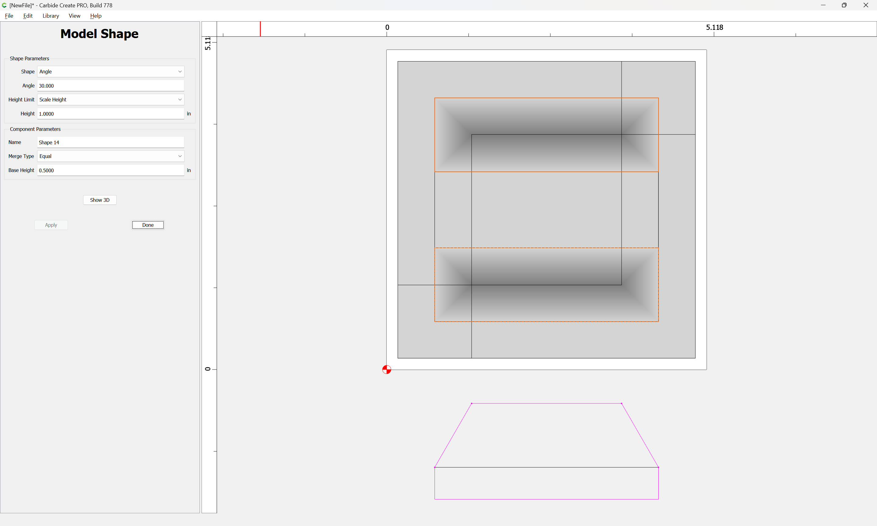

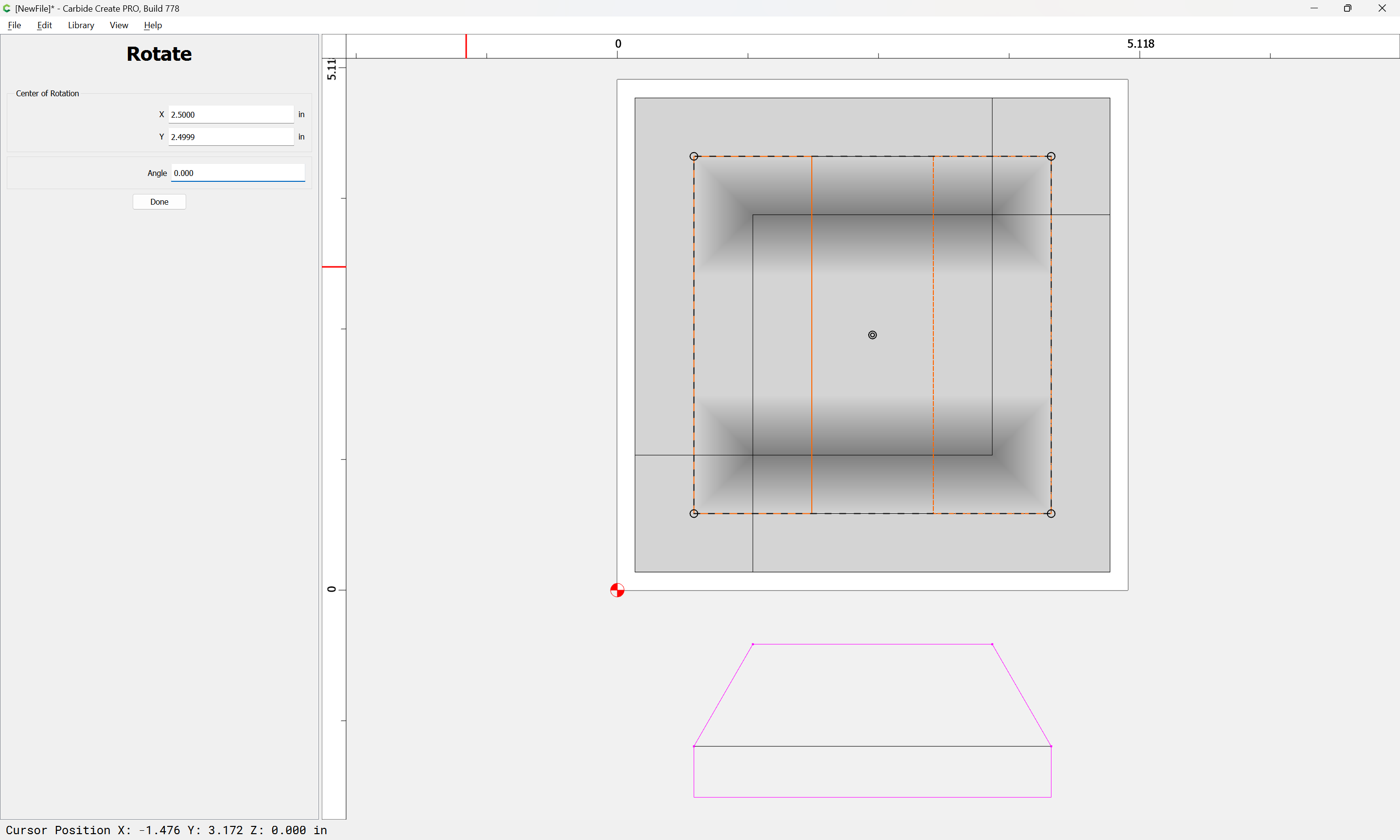

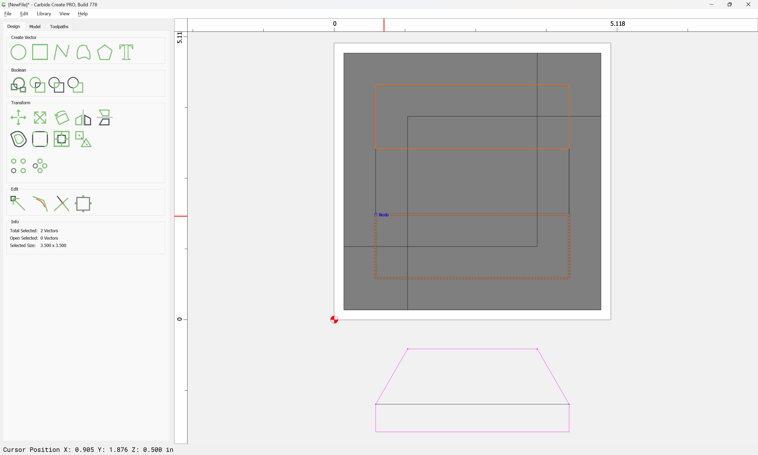

Then draw in additional geometry for the angles:

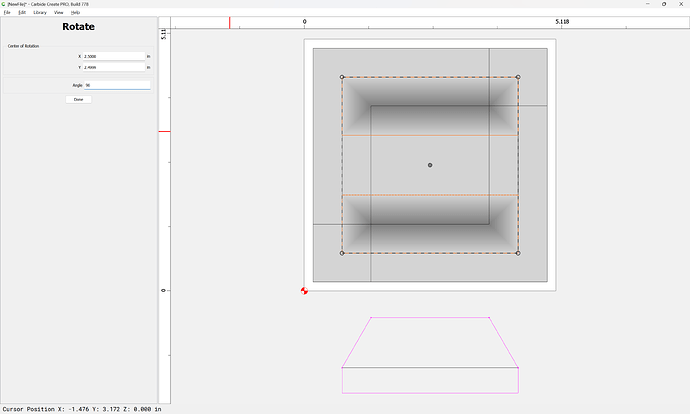

Rotate the geometry 90 degrees:
Apply
Done

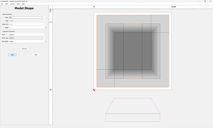

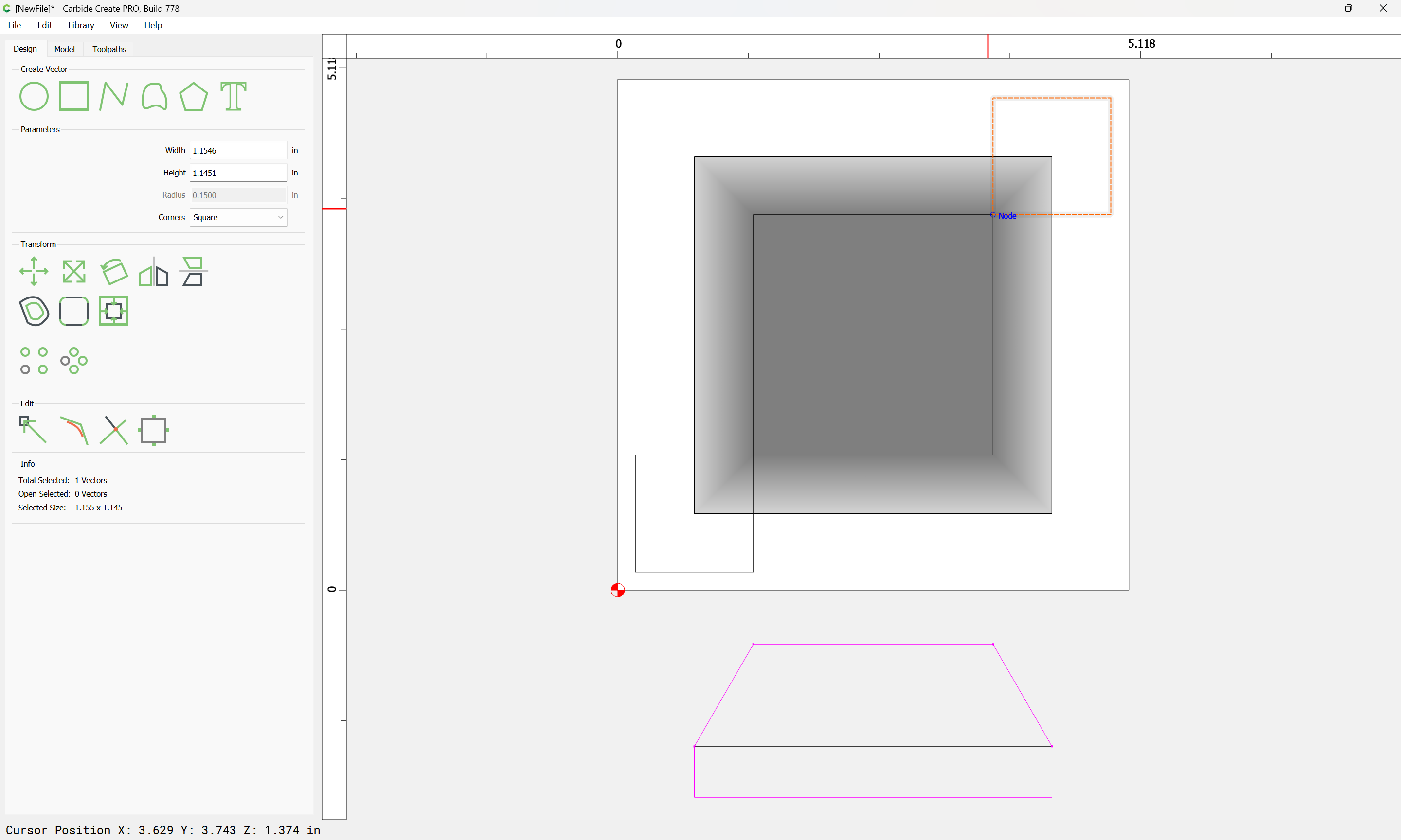

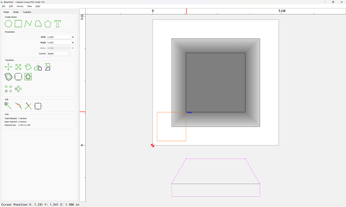

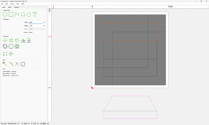

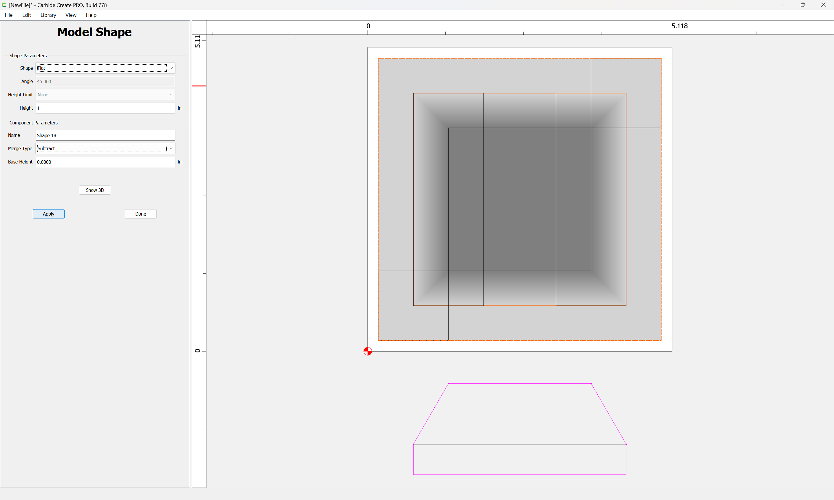

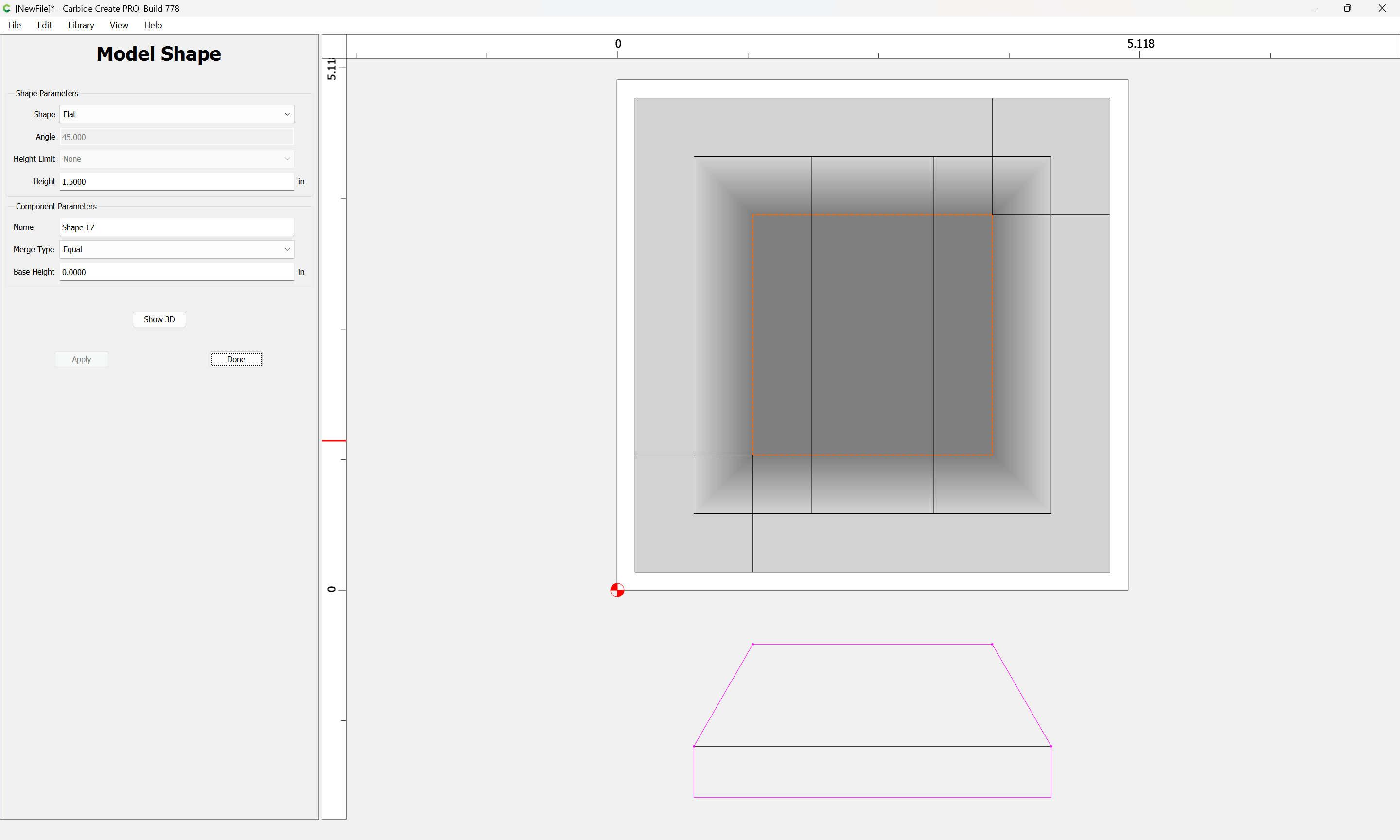

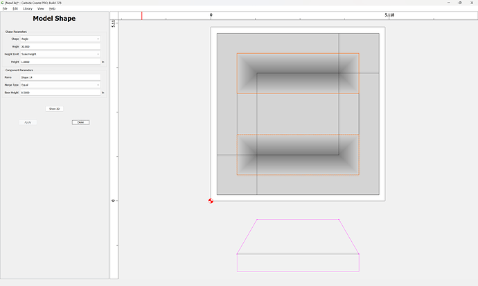

Select the inner square:

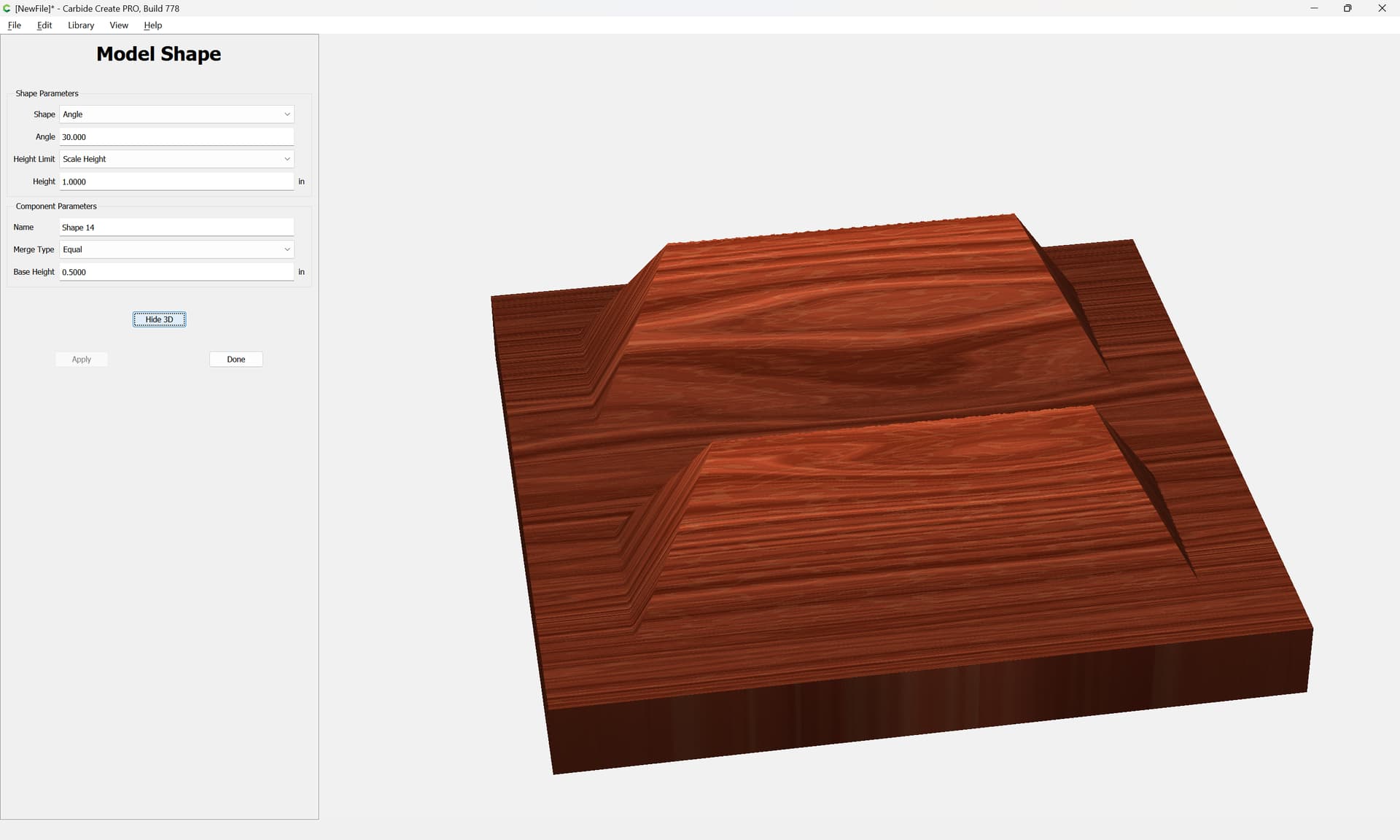

and fill in the interior:

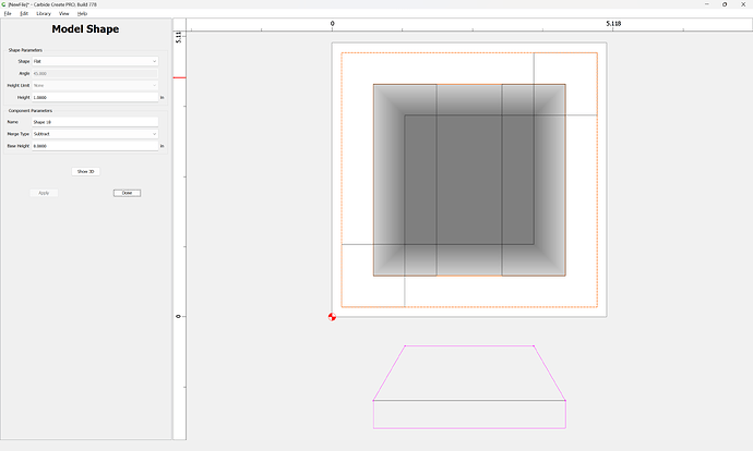

Apply

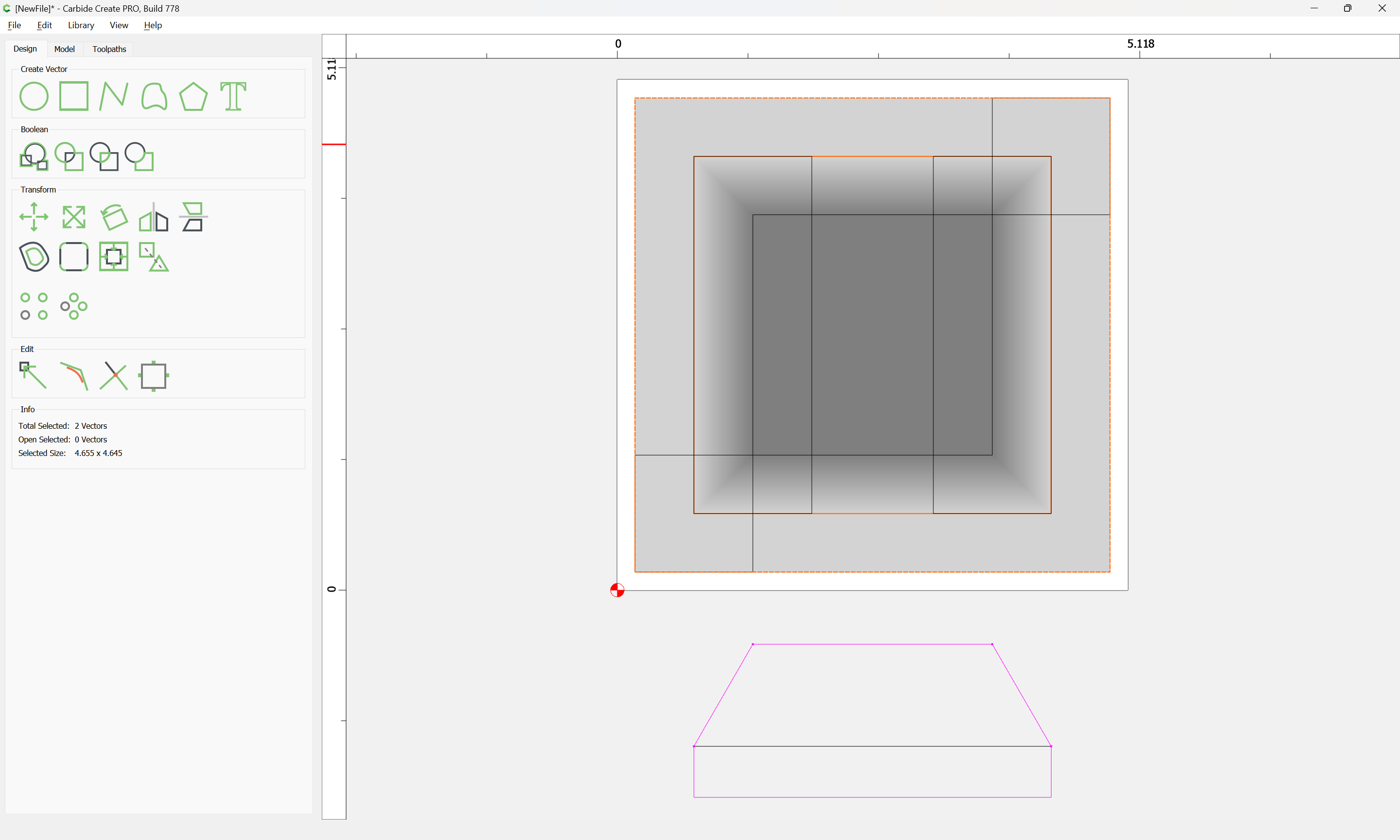

Subtract the base:
Attached as a v7 file.
pyramidal_square_v7.c2d (60 KB)
Wow, that may take me awhile to digest. Thx. I am working with wood and have a couple of long bits.
Thanks for the advice and pictures
