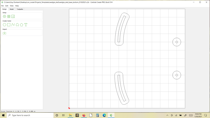

I am working on a sled that needs an arc cut that is 7 inches from the center of a 1/4 inch hole. I drew the two circles that are 1/4 inch apart and on the file I drew a triangle that represents the 30 degree from the center line I need the arc to follow.
I do not want anyone to edit and give me a file I want help figuring out how to make the arc either with Boolean or other method to get this 1/4 wide arc.
Thanks
Here is my c2d file: wedgie_sled_base_01302021.c2d (18.2 KB)
Here is one way to do what I believe you want:
  • select the outer circle and the geometry which defines the arc
  • Boolean Intersection
  • with the larger than desired geometry selected, shift click on the inner circle so as to make it the key element (dashed highlight)
  • Boolean Subtraction:
  • delete the extraneous circle
Will, Thank you. I knew someone would have an answer to my issue.wedgie_sled_base_bottom_01302021.c2d (285.0 KB)
Your instructions worked. I had the original slot mirrored and put at the top and then used the offset tool to make another pocket for a carriage bolt centered on the slot you helped me with. I got the whole thing worked out and saved. It is too late to cut tonight. Not because it is too late but because I am tired and you do not want to work on 3hp table saws when you are tired. I will get it done tomorrow
