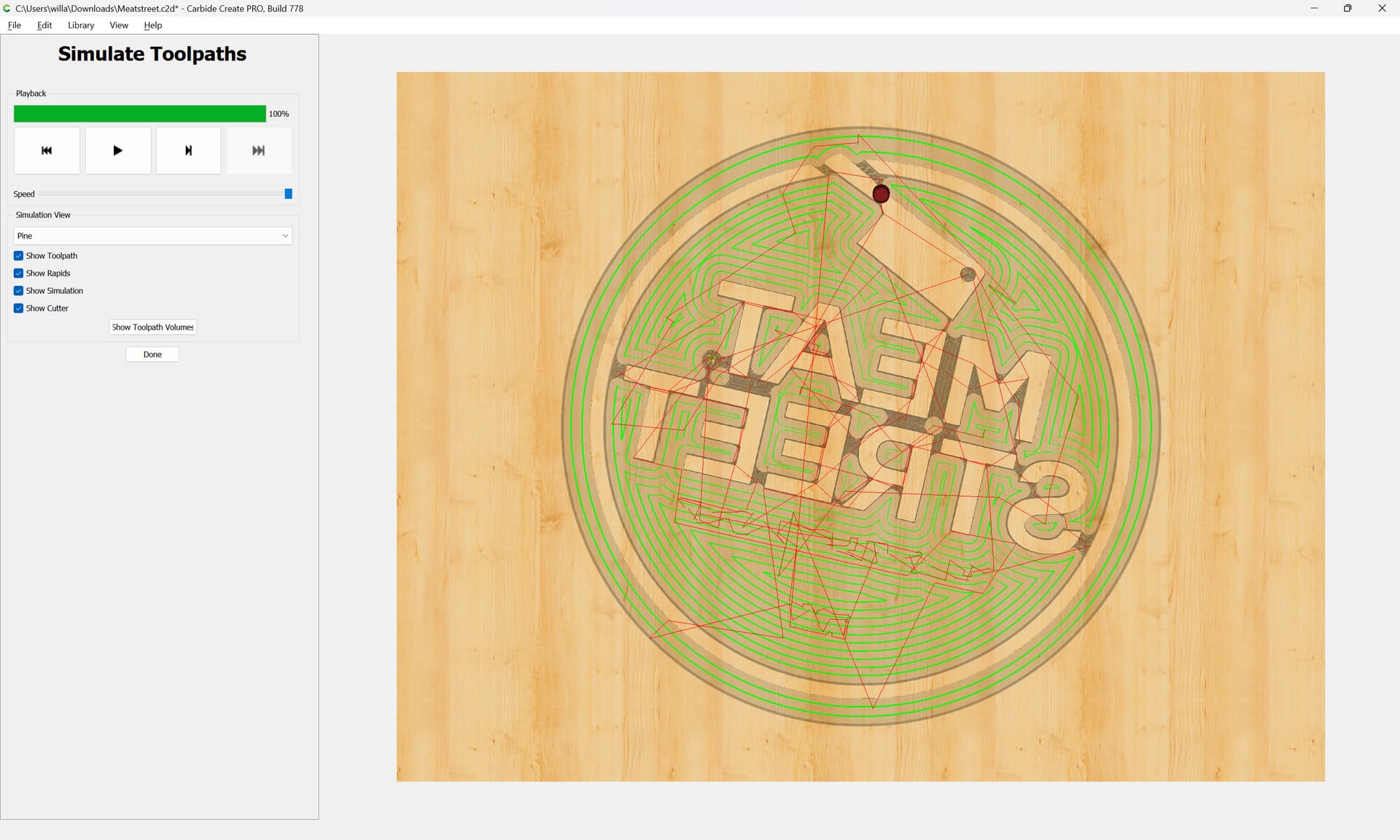

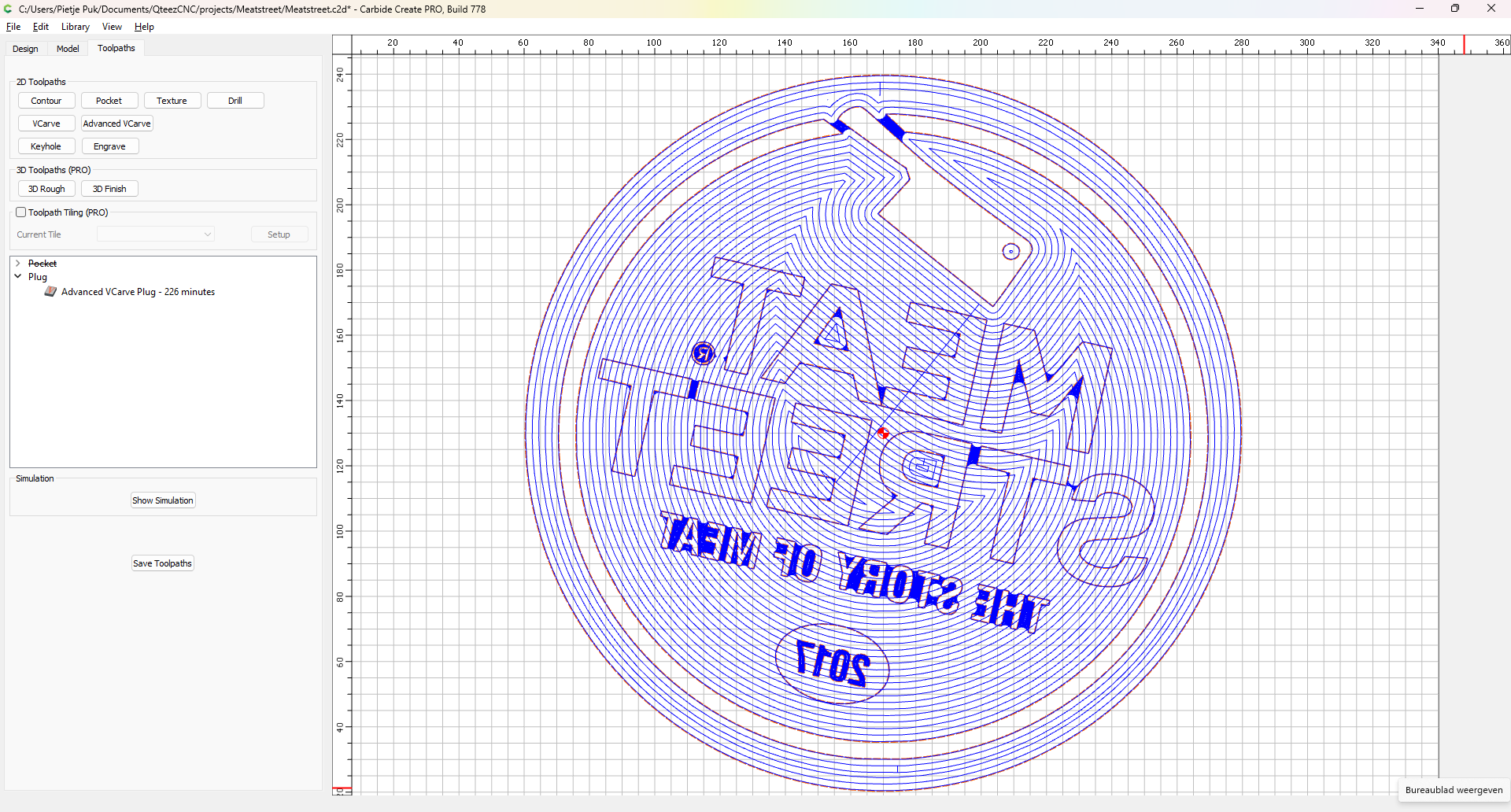

Hi! For a good freind of mine, I’m creating a cuttungboard with an inlay of his company logo.
I’m using the new inlay function of CC Build 778.
I created the female part of the logo and that works creat but after desinging the male part I ran into an issue creating the toolpath.
I created a boundery circle around the logo as shown in the ‘How to Create Perfect V-Carve Inlays on your CNC’ video from Carbide and when I generate the toolpath it skips the text within the logo.
When I change the pocket tool to a bigger mill, the big letters are oke but the small ones are still being skipped.
Can anyone tell me what I do wrong or to add some kind of a workaround?
I can mill only the circle and the rest of the pieces seperately but it will be a waste of meterial…
Kind Regards
Richard

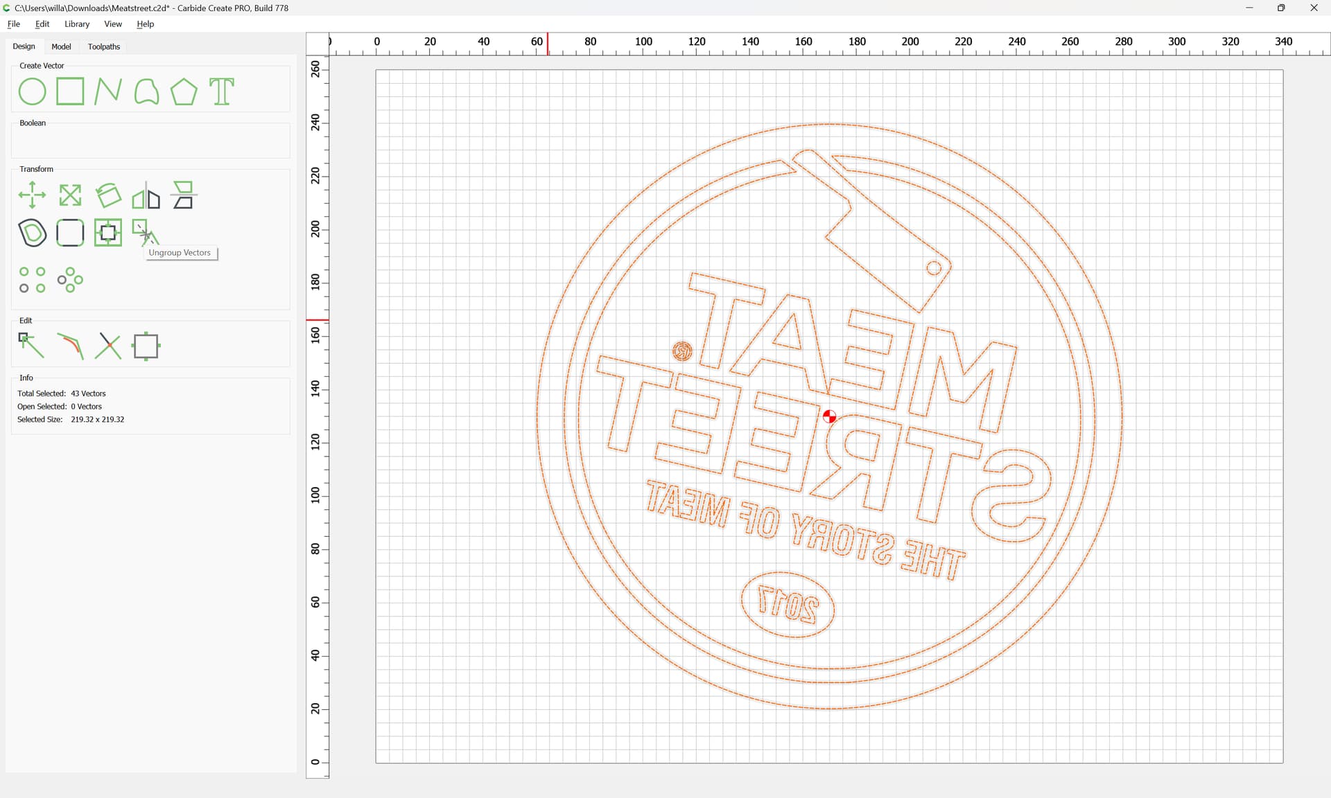

Is that text selected as part of the toolpath?
Upload your file?
Yes, all vectors are selected.
This is my file:
Meatstreet.c2d (356 KB)

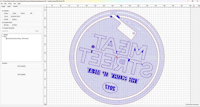

Opened your file:
and went to the Toolpaths pane:
and everything was expected.

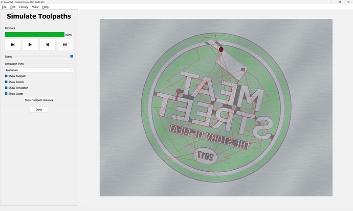

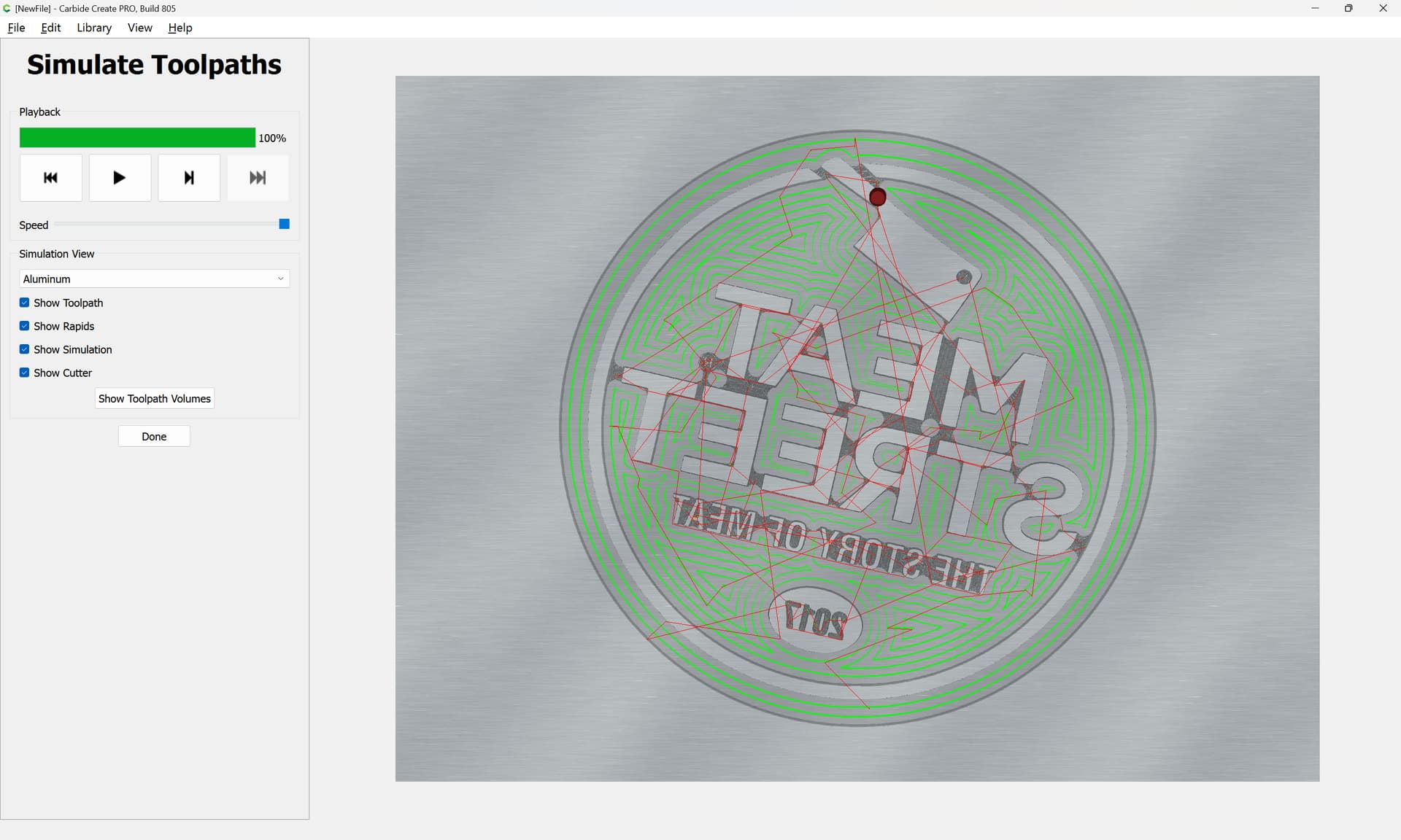

Please try the file in the new beta:
Hi!
I did a fresh installation of CC Build 778 just to give it a try but that did’nt work… Then I installed the Beta Build: 805 and that worked as expected!
Thanks for your effort!
