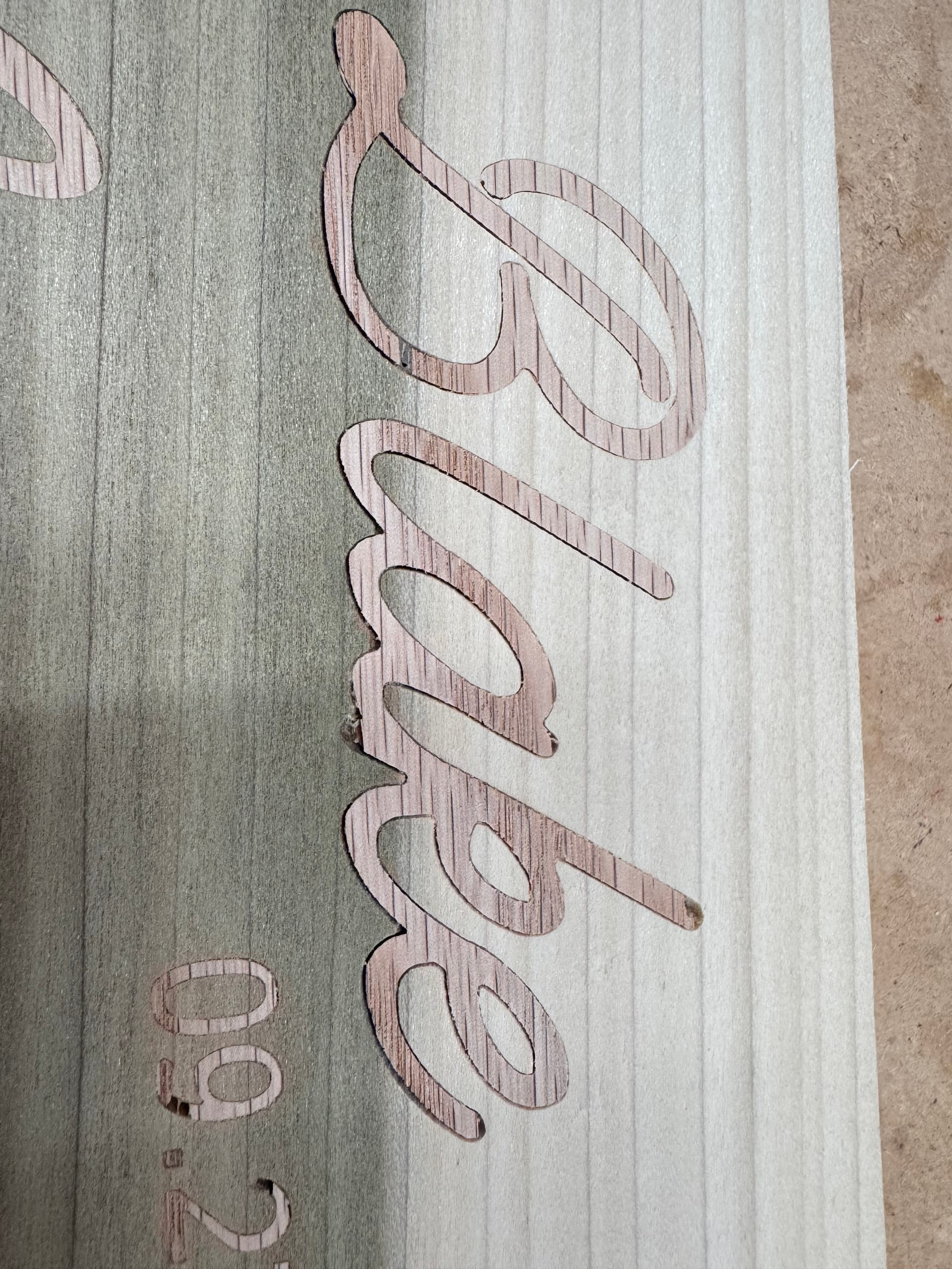

Hey guys, I’m looking for a little inlay help, hoping maybe someone can suggest a few tweaks on my settings. I’ve uploaded a picture of my results. My shoulders are too narrow and I feel like I am going back and forth a bit trying to get a better fit.

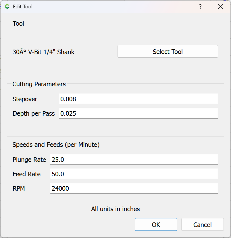

If you’re using a tool which has a ball-nose tip, that tool geometry is not supported in Carbide Creat.
No ball nose? 1/8" endmill (carbide #102) and a 30 degree vbit.
What is the tool used at:
Does it have a sharp tip, or is it rounded (ball-nose)?
It’s the IDC 30 degree v-bit, sharp tip, not a ball nose.
I have no idea why it shows up like that. I have the IDC library added and I load it from there. It matches the settings recommended from the site for the exact bit I bought. I think I have selected the right one. It acts as expected in all projects I run with a 30 degree vbit. I am just having trouble finding the right depth settings. I think I might be too shallow on the inlay and need to go deeper with those settings but I keep changing things and not quite getting a really tight fit, everything is slightly off!
I would suggest trying a #302 60 degree tool using the Carbide Create defaults as a starting point.
If the V-bit does not come down to a PERFECT point, then the tool cuts lower than programed. which makes the female pocket larger and male insert smaller. I like using this guy. I have a digital micro scope I use to inspect my bits occasionally, and I’ve had Vs that don’t come to a point.

Your image appears asymmetrically cut out though. IMO that can happen when the cutting edge of the bit “pulls” the bit into the wood on the cutting side. Happens when one tries to cut precise cuts with a too long bit. Use the shortest bit possible for those cuts.

Thank you for the suggestions. I am testing in edge grain but the end results will be cut in side grain, so hopefully will be a little better.
