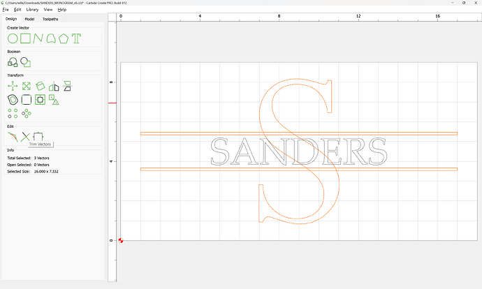

Does anyone know how to take out this middle section of a text? I’ve attached a photo of what I am trying to do. I pretty new to this and any help is appreciated.
For one example of doing this sort of thing see:
Start by setting up the file:
Set the text:
If need be, adjust the text:
then draw in the lines:

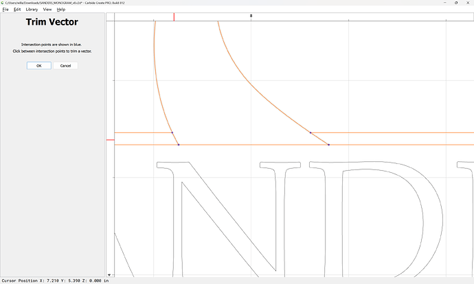

Convert the text to Curves:
Select the geometry:
and use Trim Vectors:
Click to remove what is not wanted:
If need be zoom in:
until you arrive at:
OK
OK
then use Join Vectors:
Yes

Note that you may want to connect the letters with the top/bottom lines, or connect the two lines:
One way to do this would be to draw in connecting lines at each end:
Then Node Edit:
Select the nodes in question:
Delete Node:
Then select everything:
Join Vectors:
Yes
