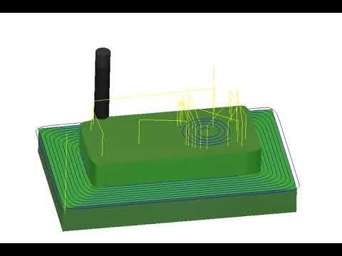

Here is the adpative toolpath, I was concerned that it seems a lot of tool edge engagment. Total depth of part is only 6mm

For sure you need to have the stock declared in Fusion match the real one, since Fusion will aggressively approach the stock / plunge nearby as Liam mentioned.

ok, at first look, a few comments:
  • The initial facing op will plunge right into the stock from the top, rather than the usual “start outside the stock”. That’s because you selected that top face of the piece rather than the top of the stock as the facing op area. Sure it will take a shorter time like this, but that plunge is a bit risky, and since you will need to remove all that material in the next pass anyway, I think it would be safer to just surface the whole of the stock
  • For the adaptive toolpath, you have your optimal load set at 1.27mm, which is way too high when using a 1/8" endmill in aluminium on a Nomad. In that video Winston recommended 0.305mm (0.012") optimal load.
  • On the other end you have max roughing stepdown at 0.25mm, Winston recommended 0.762mm (= three times less passes), but maybe pick 0.5mm to be on the safe side for a first try

It does not have rest machining enabled, so it’s not going to be aware of the previous operations (and since you have stock to leave set in the adaptive toolpath, it matters)
  • beware that the height of your piece is 11mm, so you’ll need to make sure your 1/8" has a length of cut of at least that, or it will rub
  • the inner lower holes have a diameter smaller than 1/8", so you’ll need another endmill and toolpath for those
@Julien Thanks… Lets ignore the contour for now. That was just my most recent attempt to find something that would create a toolpath that make any sense. The adaptive has left .5mm radial and axial and I cannot find anyway to create a valid removal toolpath. I played with horizontal and that looks promising for axial and I might figure that one out. But the radial ???
One of the many ways to skin this cat would be to duplicate your adaptive toolpath, check rest machining / from previous operations, uncheck stock to leave, and that second 3D adaptive toolpath will happen to shave off the 0.5mm axial and radial left by the first 3D adaptive toolpath

Here’s a version with some more ops to it to get further round the part, building on what Julien already did.
Do not assume that any of the feeds / speeds / depths are any good for a Nomad, I know very little about the Nomad. Also I am not sure that the bore operations are safe without air blast or coolant on the two flute 1/8" especially the deep bore in the third setup.
CineTape Horn Mount HELP v2 v13.f3d.zip (290.6 KB)
I’ll go through the changes in order to explain why it’s like it is. There’s many ways to do any part and this is just one. It’s not complete, there’s a couple of bits that aren’t machined and I’d consider removing some of them from the design unless critical. One needs a ball end mill to finish.
First I modelled the stock as an object, this also lets me put some sketches in the stock to use in setup.
First Setup
The first setup is for the major work, I set the Z plane and X axis specifically and selected a zero point, note that I set the base of the stock as zero so that we don’t have a dimension problem if the stock isn’t perfectly 1/2". You’ll need to zero off the baseboard, vice or whatever you are mounting the workpiece on.
First operation is a facing to take about 0.2mm off the top and face the part.
Next up is an adaptive clear
This goes all the way to the bottom of the part, carefully setting the bottom height to -0.5mm from the part to make up for the axial stock to leave does this.
Also note that the adaptive is entering from outside the stock so we don’t need to worry about helical ramping. Also the Adaptive is always cutting on the outside of the workpiece to give us a much better chip clearance through this stage.
A boring op gives the upper part of the small holes (which you’ll finish by hand)
Then a couple of parallel toolpaths giving us a finish on the flat surfaces.
Note the lower parallel leaves 0.5mm radial stock to leave to avoid heavy engagement on the wall of the upper part.
Then a contour walking down the upper block of the part (no idea what depth per pass for this on a Nomad). This is achieved by creating a sketch on the top face of the lower flat and projecting the upper block into the sketch to give a selectable continous path.
Next we need to walk down the sides again to cut the full outer contour, another projection into a sketch is used for this. Note there is a nasty square corner here which will give a heavy engagement and might chatter and mark the part.
This has done all the work we want to from this side, we left a nice shelf all the way round the base to make workholding easier.
