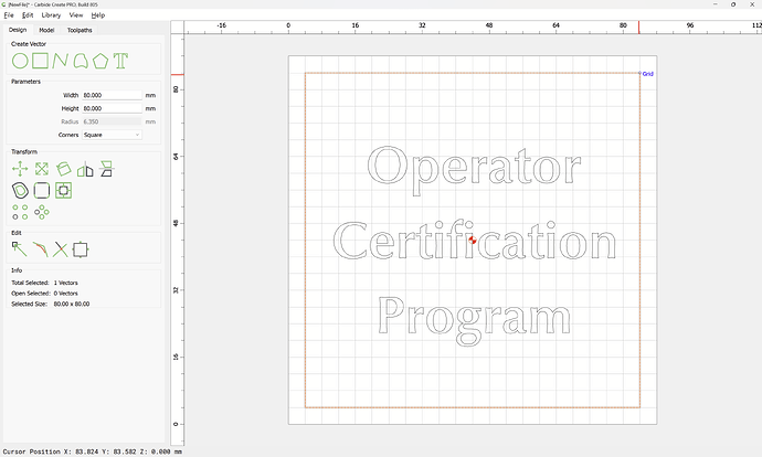

The big thing with texture toolpaths is that they need to be inset by the radius of the tool to keep them from cutting away surrounding material.
Textures may be placed at the bottom of a previously cut pocket which I believe is what you want.
For example, if one has a sign:
which is to be cut into some material so that the letter and border stand proud and there is a texture in-between, one starts with the pocket toolpath:
If we then assign a texture toolpath:
it will cut almost everything away:
So we inset by the radius of the tool:
Adjust size of tool and offset until the desired appearance is achieved.
