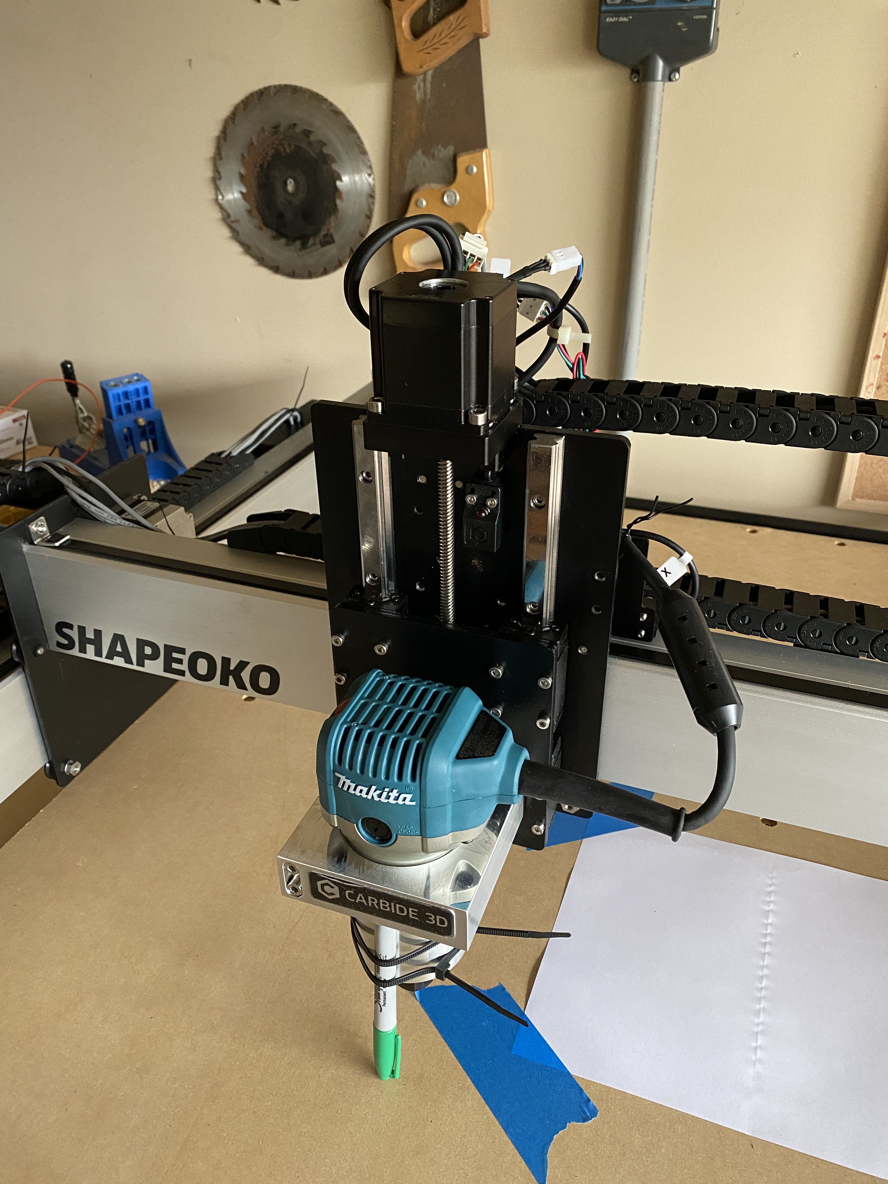

So I just got this cnc and by a miracle got it put together and went to go run the test and ran into this issue and I’m not most technologically inclined person so some assistance would be more than appreciated getting into this world!
The issue at hand is that when I click to run the hello world test the cnc is stuck and won’t move and makes a terrible noise and I’ve read to check the end switches and they look right but they don’t light up or anything? So I’m not too sure, can only post one since I’m a new member but any help would be appreciated

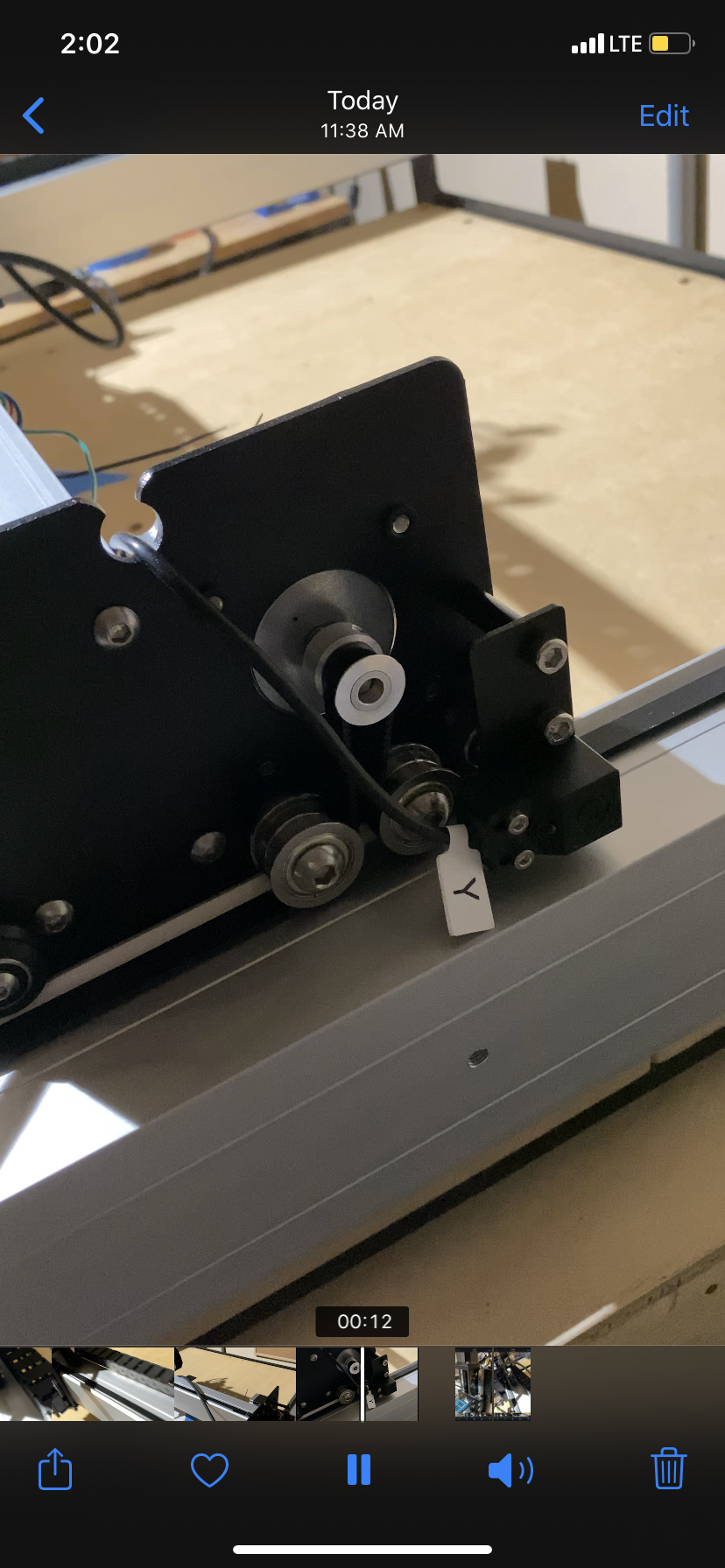

So I think maybe my X is wrong? Because I got it moving just now but it’ll go to the far left rail and just band against it and say failed to home, this is where I have my X at rn
Image.
The far left rail, as in away from the limit switch?
turn off the machine, move the axes manually (slowly!) such that X is a couple of inches away from its limit switch, and move Y as far as possible away from the Y switches (such that X will contact first), then launch homing and observe:
  • whether the X limit switch LED lights up or not (probably not based on your description)
  • what could interfere (cables)
  • if the movement stops short of the limit switch
Homing should go Z up first, then X &Y together to the back right.
Maybe motors mixed up?
Mmh, I did not notice that while reading, it looks like X might be going the wrong direction indeed
X Axis stepper motor wires reversed?
(Not that I’ve done that on my Shapeoko, 3D printer and certain other items however…)

What exactly happens when you try to initialize the machine? Does the router move up first?
All fixed! Had some wires mixed up
And a axis backwards! Thanks guys
