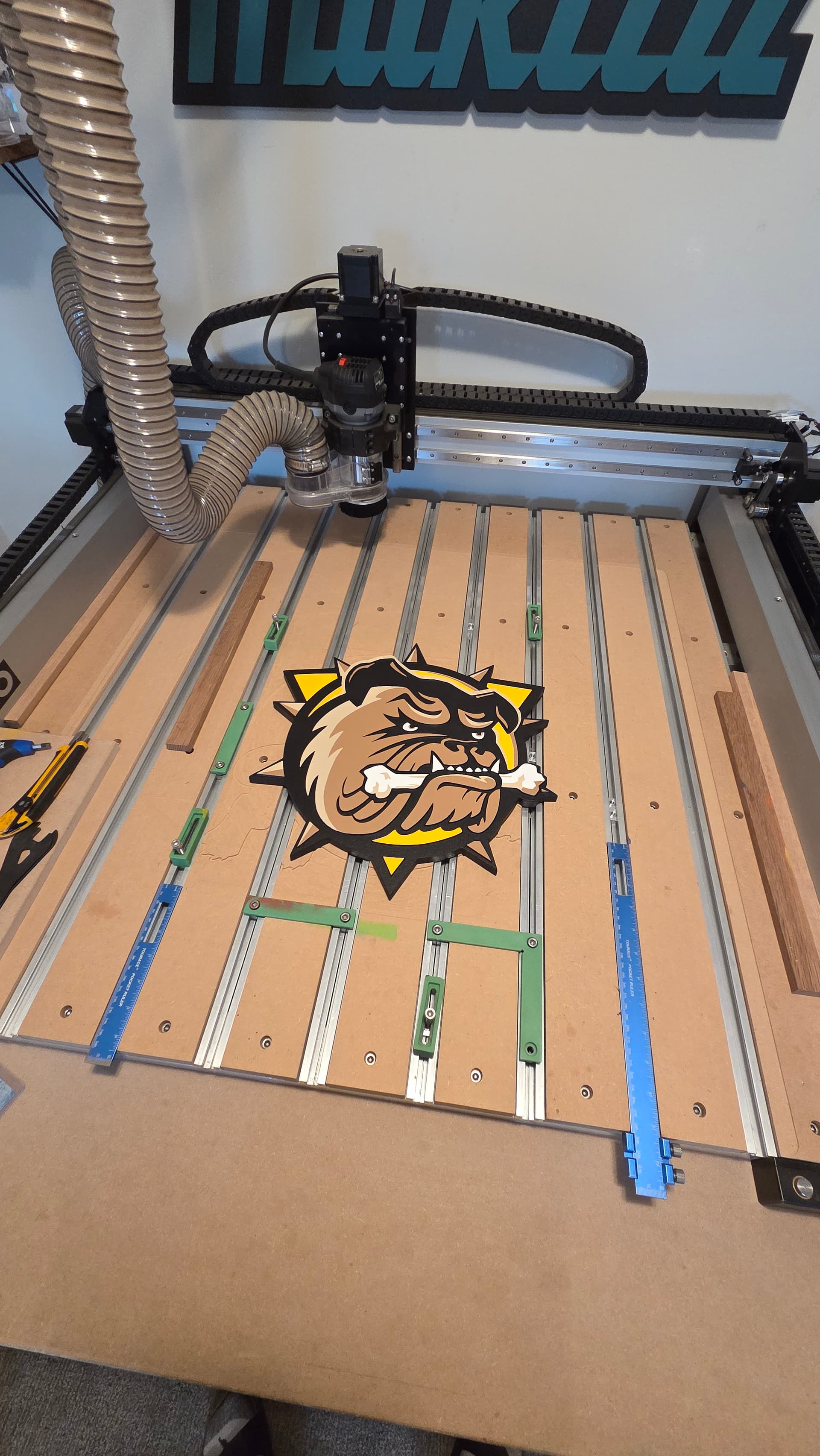

Really cool…is this painted…how did you make this
Thank you, it’s one piece of material.
Pre-painted with yellow, beige and brown, covered with Oramask, then carved and painted with black.
