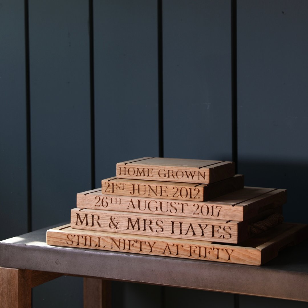

About to make a purchase, but I have one questions which is not 100% clear after a lot of searching around.
How do you hold work that needs engraving on one edge but the piece is larger than Z axis will travel?
I have uploaded a couple of examples (not our work - but we have similar requirements (different product line)) - I assume this are done on CNC - but the how it is done (holding) puzzles me.

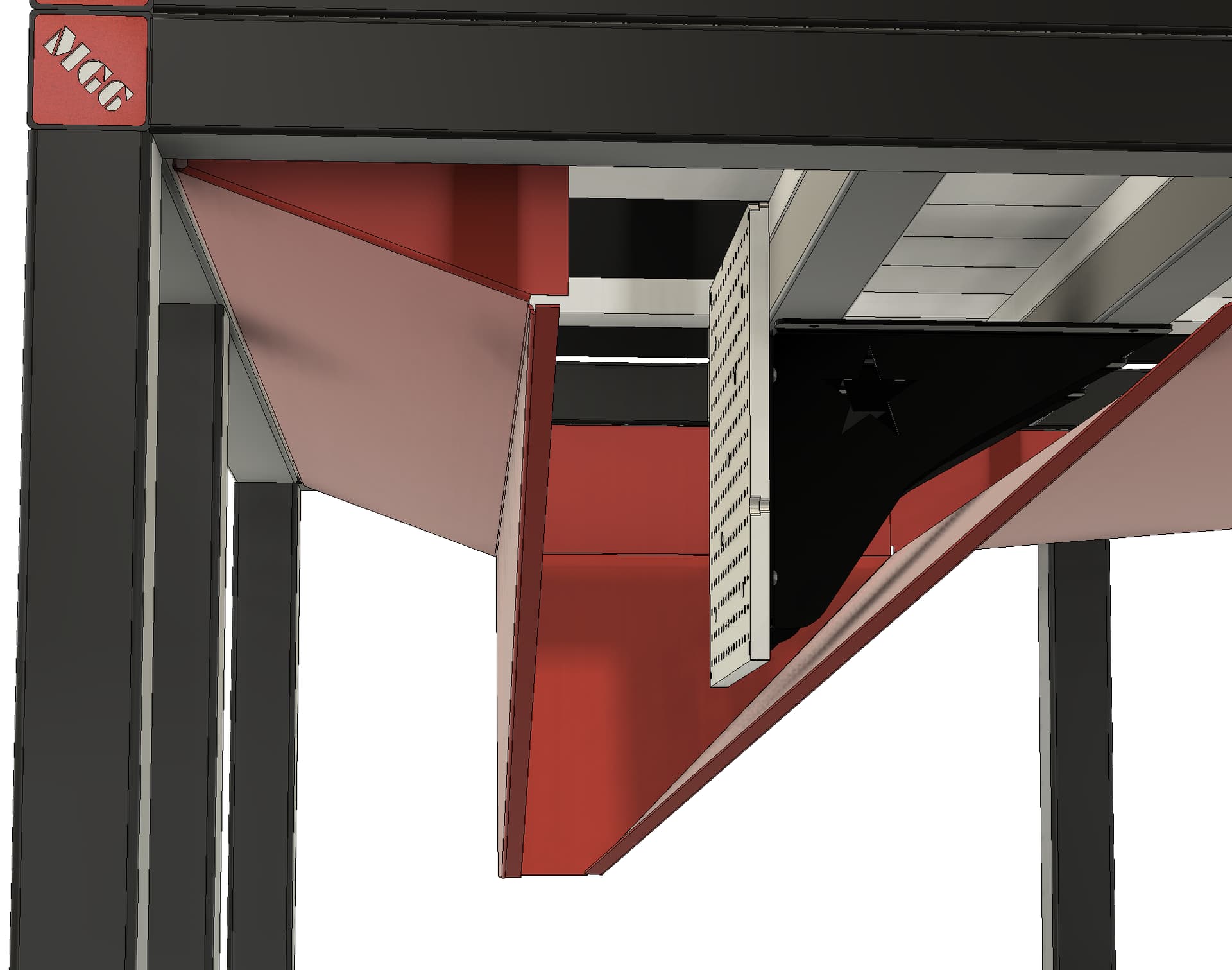

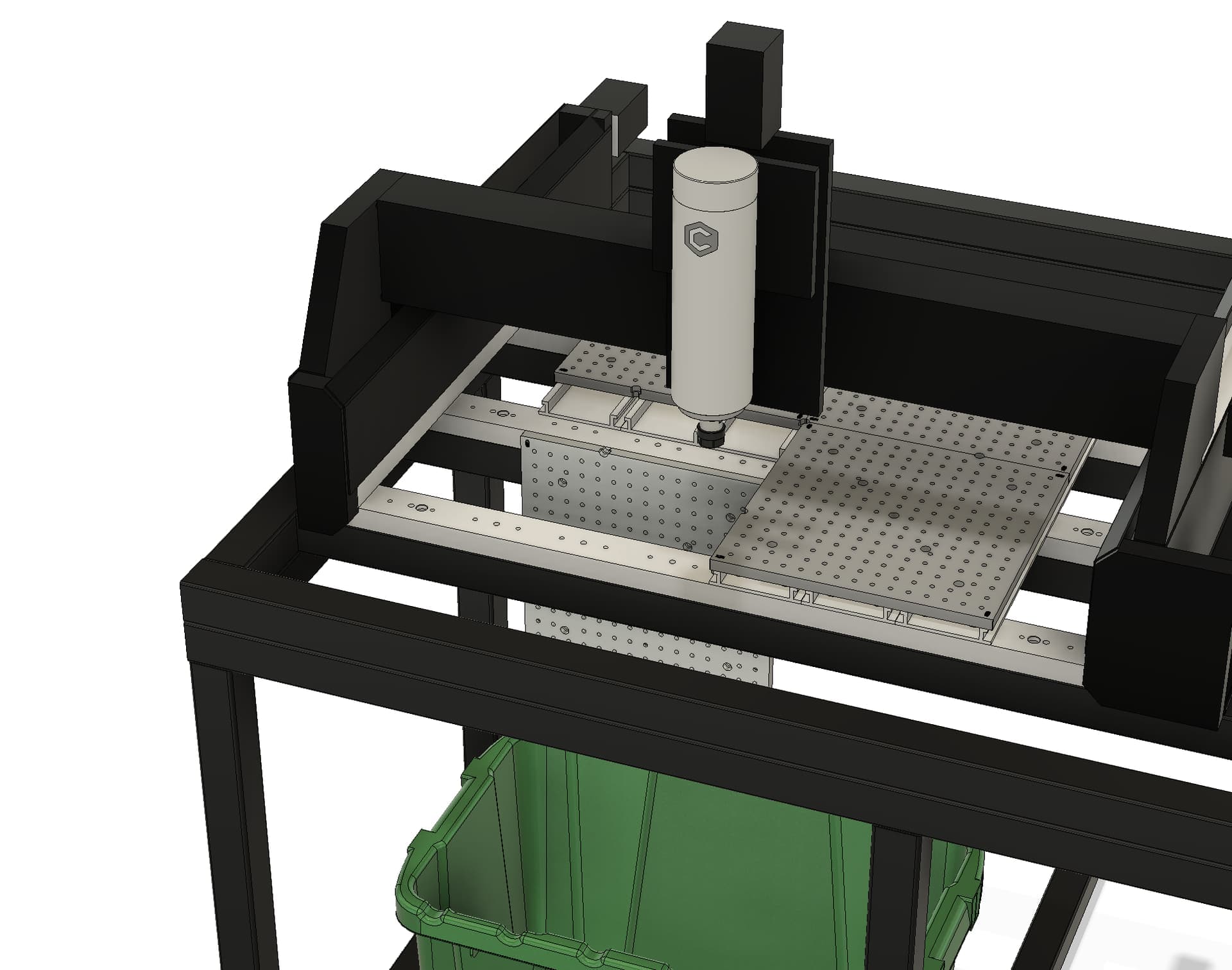

If you have an SO5 Pro, implement the “Gantry Shift” option:
then work up some suitable solution for clamping at the front of the machine — this was easy on the SO3 (just use the front endplate), folks have worked up various options for the more recent machines.
Great thanks @WillAdams - I will read through that post - thanks for the help
This is something I’m still experimenting with on my SO5 Pro — I was thinking about bolting a piece of 48" extrusion to the front of my workbench and using that.
Curious what other folks are doing/using/considering.
