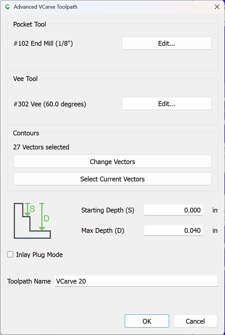

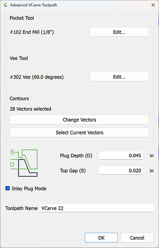

I’ve put both sides of the cut (hole/plug) in one place, I have been just disabling one group, saving toolpath, then opening with Motion and running… Cannot get this thing to fit correctly. Any advice?

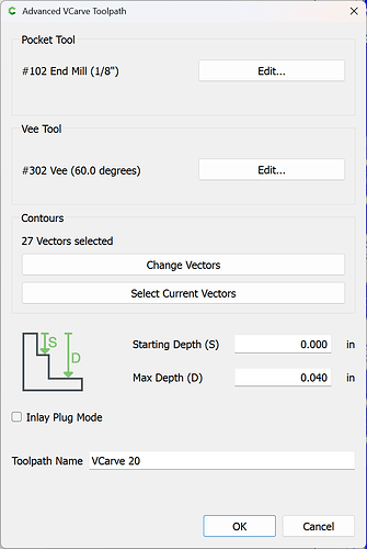

This cut is quite shallow:

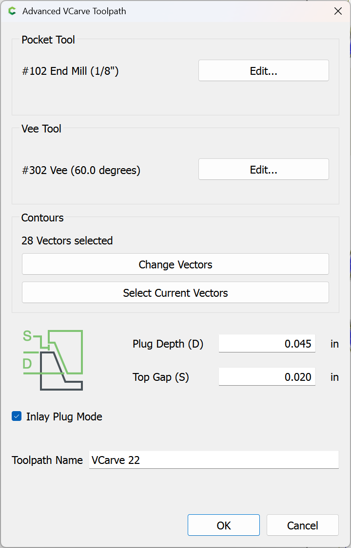

while your plug is over half-again deeper:
Try again with a deeper pocket (which will preserve the lines)?
I’d recommend testing out settings for files in smaller test pieces.
