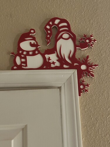

Hi all, I’m curious… when I initialize my Shapeoko 4XL, no matter where the router is located, it slowly moves to the far right corner, as I’m facing the machine, and moves to the front right corner just a little left and stops. This is where I would insert a bit to be used for a project. My curiosity is, which one of these locations would be considered the home position? The reason I ask is the router does not stay in the far right corner (as I thought it would) , it moves forward to the front right corner slightly to the left. Thanks in advance for your input… Merry Christmas to all…also, here’s a project I made using HDPE board…
