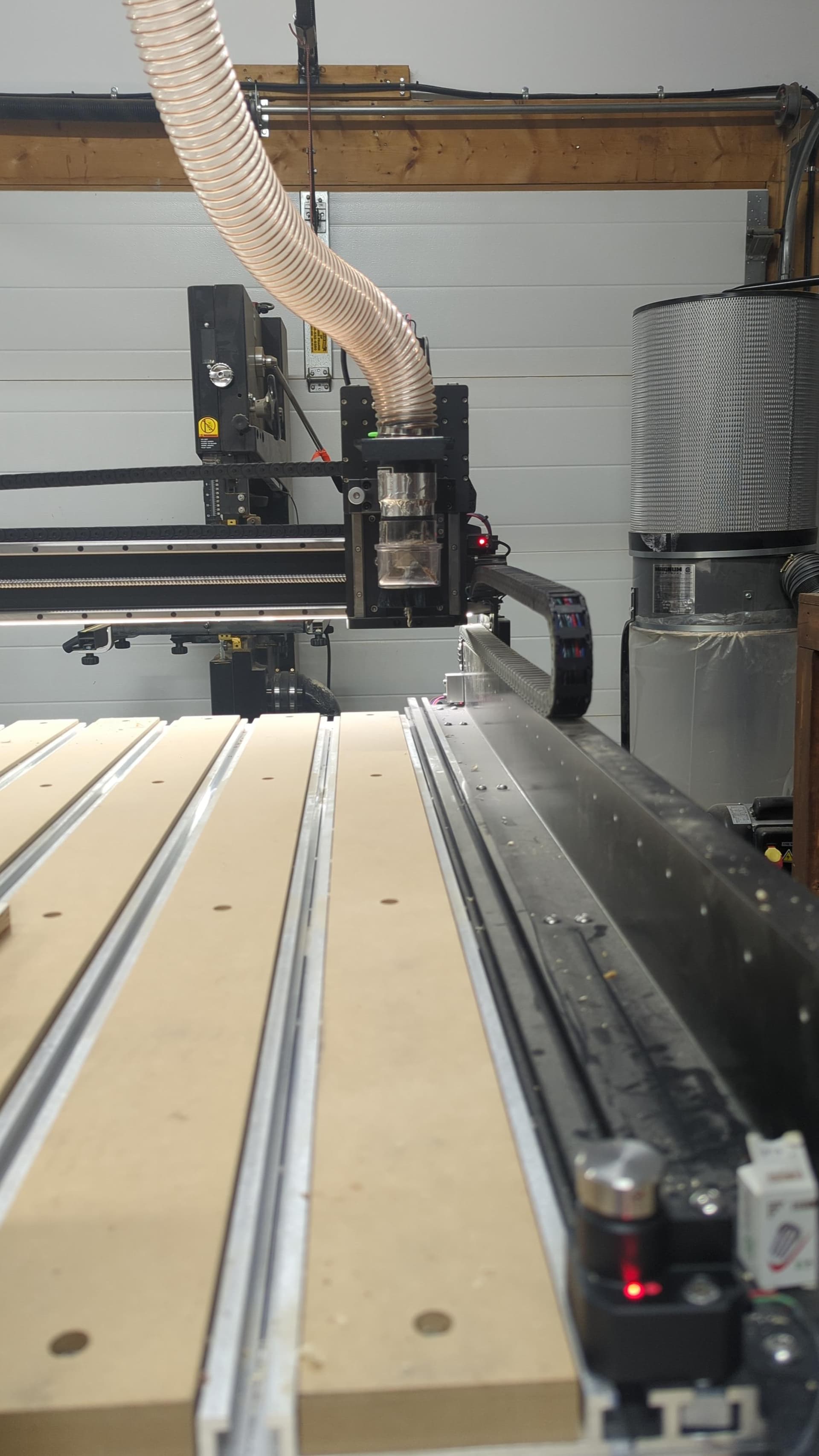

Homing issue alarm 8
Hey everybody, I came across this today while trying to initialize my machine. Any ideas what to do next?
As noted at:
https://my.carbide3d.com/faq/error-codes/
this is:
Pull off travel failed to clear limit switch. Carbide Motion does several checks to avoid this error so it is very rare in a Shapeoko or Nomad CNC machine.
See:
https://my.carbide3d.com/docs/troubleshooting-homing/
if that doesn’t address things, let us know at support@carbide3d.com (and mention that you’ve seen those two pages and tried the things in them so we don’t send them again).
I was able to use the jog setting to move the machine around but went to test and initialize and the same error message popped up
Homing issues all fixed. My motor coupler was loose and it was spinning out on the y-axis. Thanks for all the help
