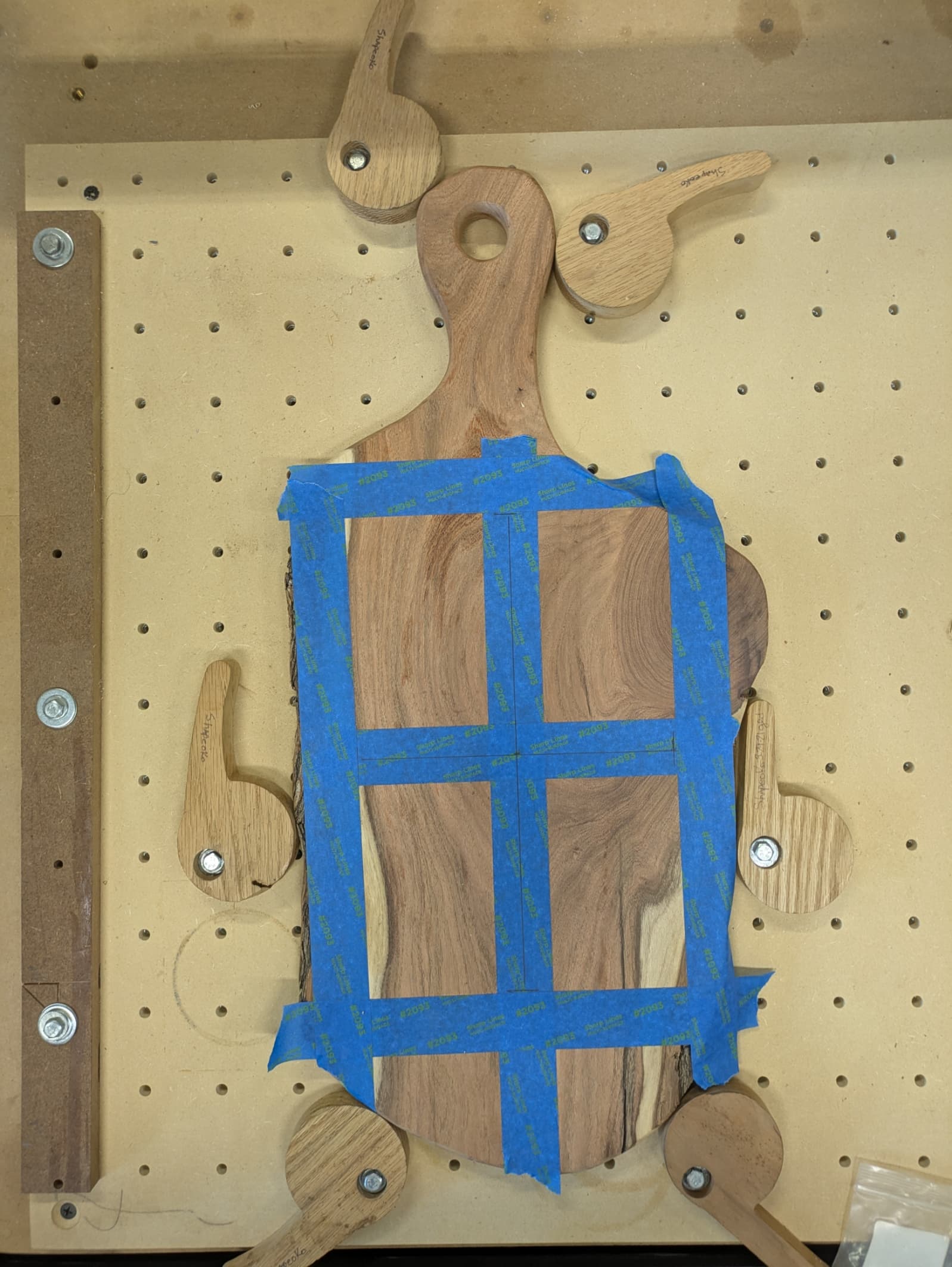

Personally I mainly use my BitZero to set the Z. I use the center on most projects that I do that are square/rectangle. I simply use a ruler to draw diagonal lines with a piece of blue painters tape in the center. I then insert a vee bit into my Shapeoko and set the X and Y in the center. I use jogging first fast to get in the area and then slower to get me right over the X I made on the blue tape.
When I use the BitZero for setting Z I am 90% setting the Z on the spoilboard (Bottom of Material) and save my spoilboard and I dont have onion skins to remove from my projects.
Using the corner is a good method but if you want a hole dead center then why not set your X and Y dead center to start with.
The center even works with irregular shaped items. I recently cut some lettering in to this for a friend. I made my center line and used a square to mark the cross line.
