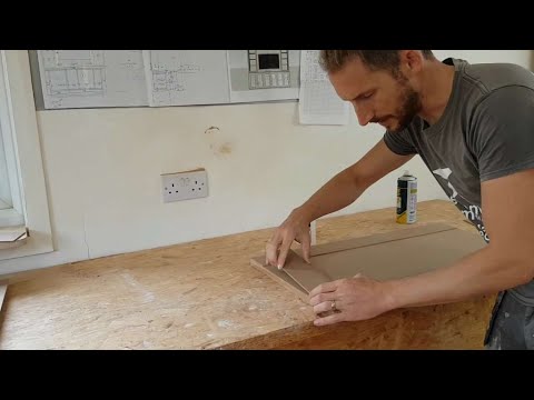

Have you considered cutting the door in two parts? I.e. cut out a 1/2" rectangle for the “base” and then cut the stile/rail as one piece out of 1/4" material. Then you can glue them together and avoid the time it takes to perform a pocket operation. It worked really well when I tried it. Here’s a youtube video that gave me the idea.
I thought about cutting out each individual rail/stile, but I opted to cut it out as one piece so it would be seamless. I’m sure I’ll find a use for the leftover material in the middle.
