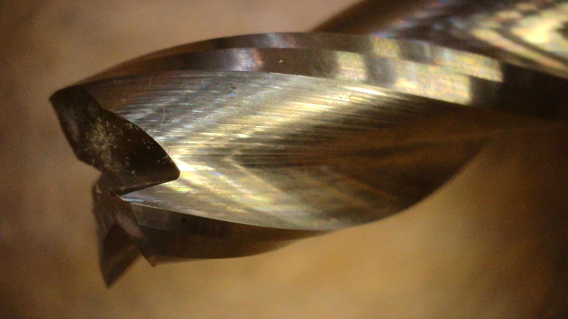

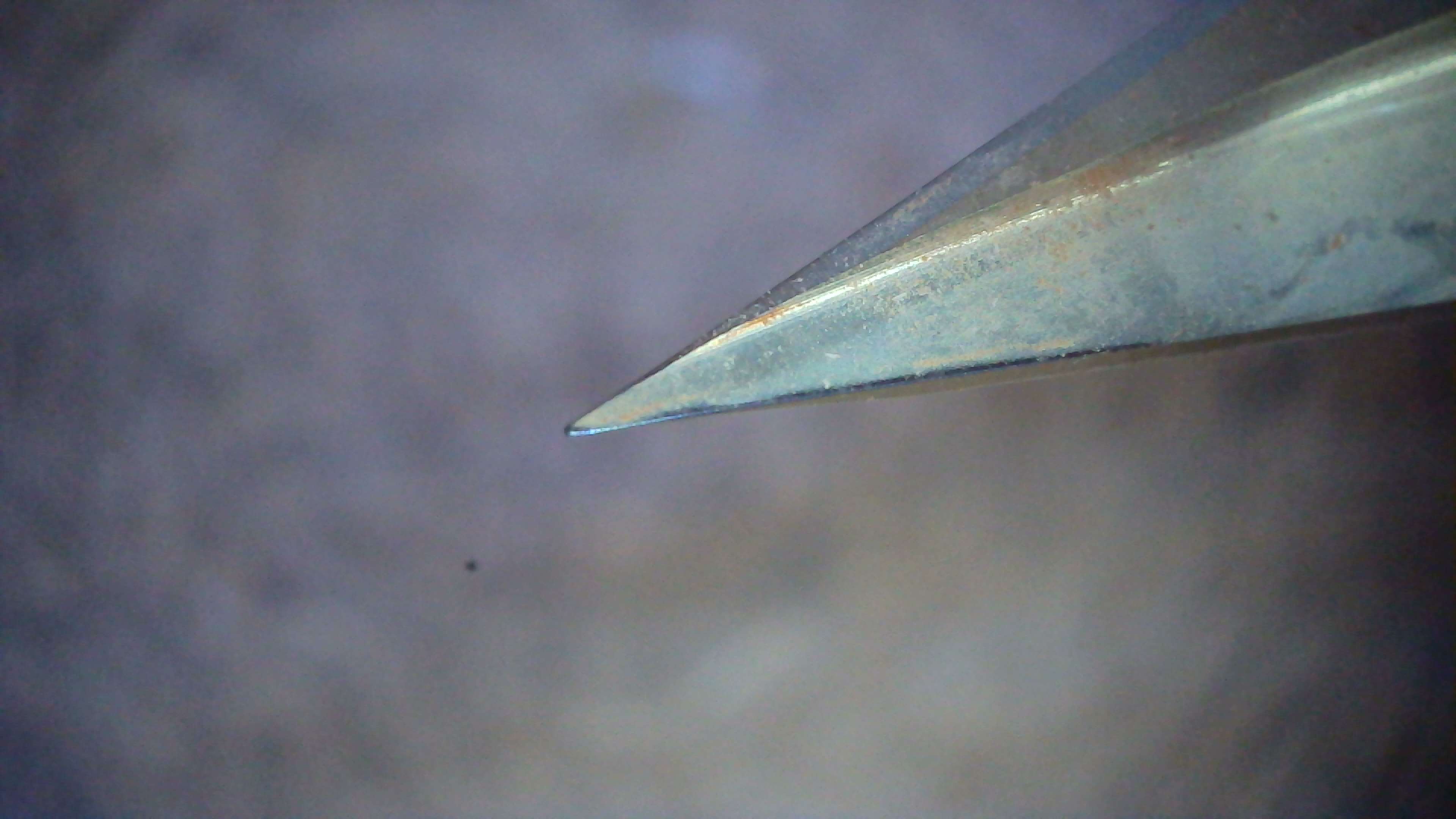

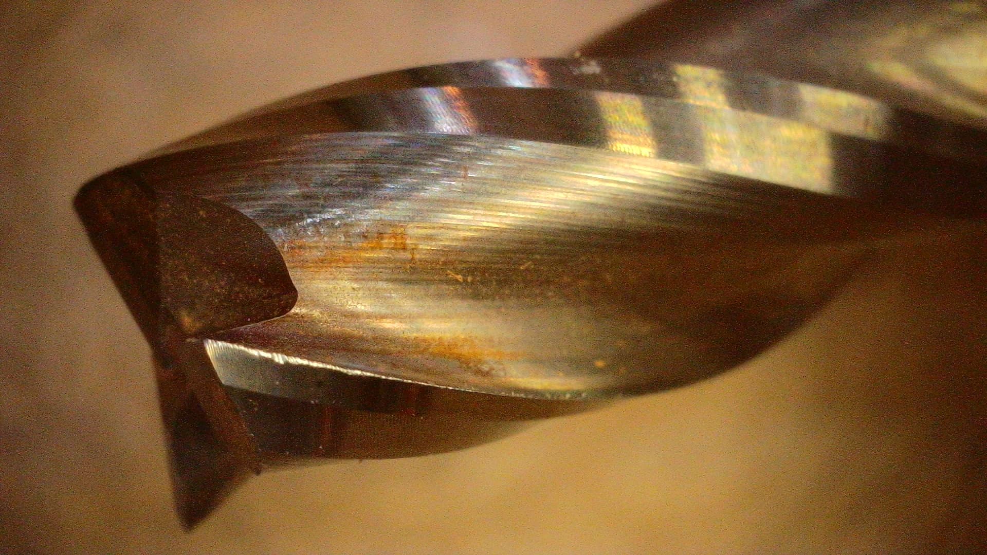

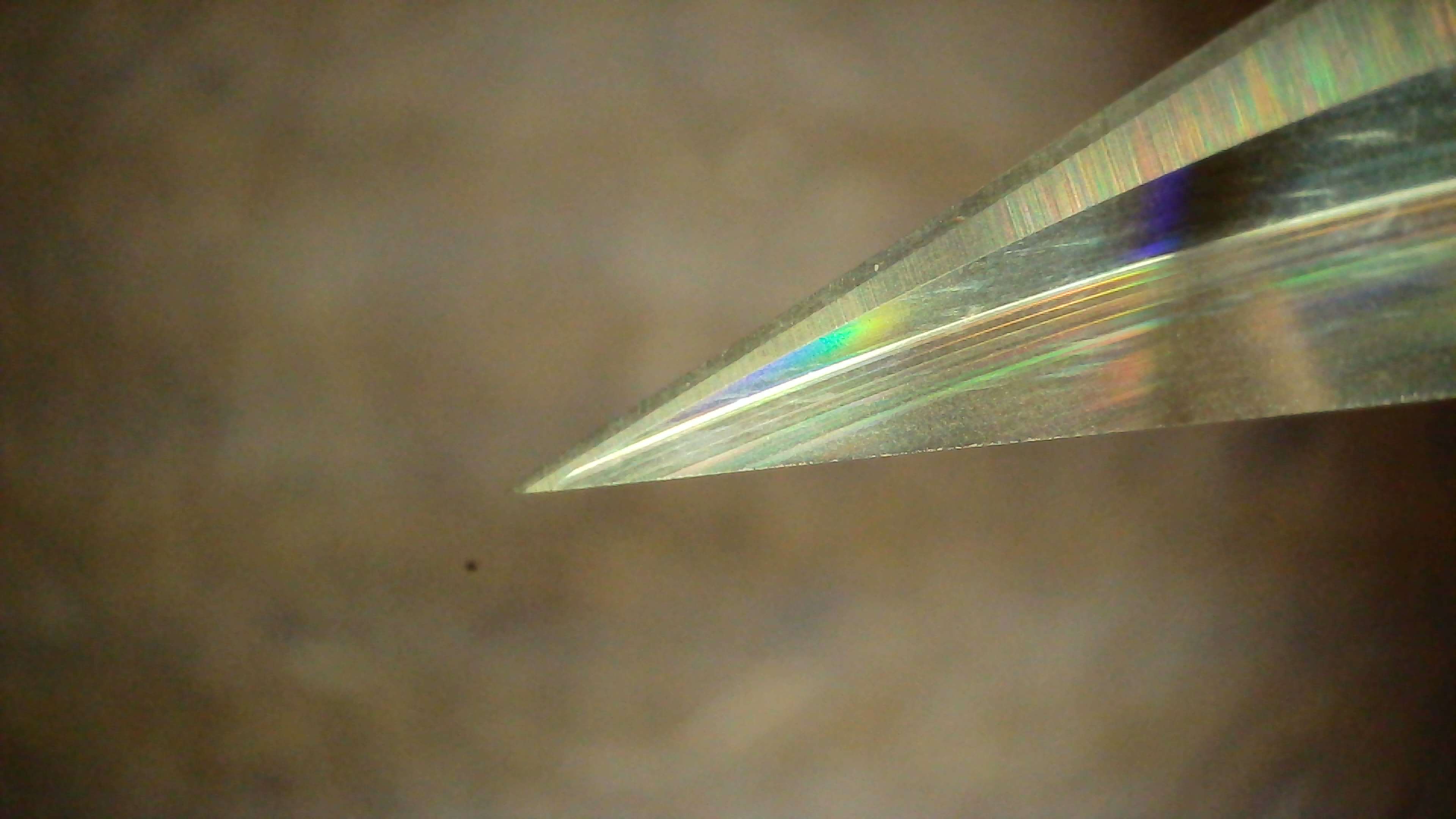

Well, “no longer cutting well” was a symptom, but I wasn’t sure if it was material or user error. I took @Emmess advice and bought a cheap digital microscope off of JeffBezosIsStarving.com
Observations:
My recently retired Cadence MFG 30* Jenny. I used this bit A LOT when I discovered inlays back in January of '24
My new girl, also a Cadence MFG 30* Jenny. Only about 50 minutes on this lady.
Stark contrast.
My old Carbide 3d #201. Has been my work horse for about 8 months.
My barely used #201
Microscope provided some great insight. I’m also going to make a spread sheet keeping track of usage. I love speadsheets!
