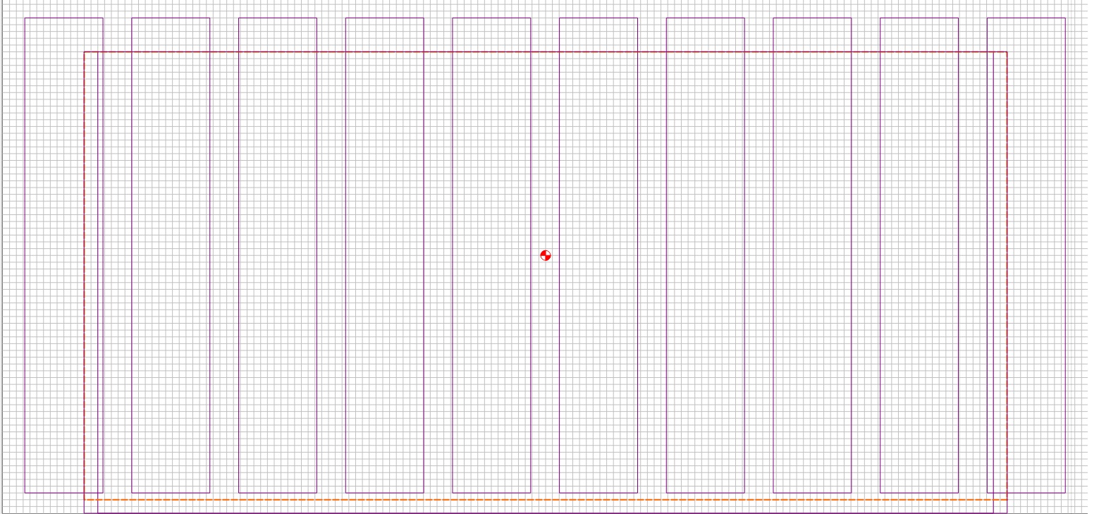

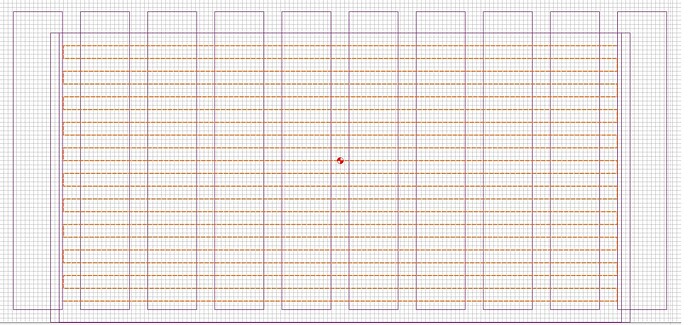

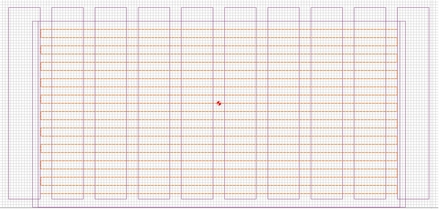

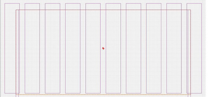

The MDF slats are kindo of beat up for lots of reasons. Decided to do the flattening thing using McFLy. I attempted to get an idea of how off-flat it was by using the jog function to try to find Z -0- on all the MDF slats. It appears that surface varies by as much as .02". Approach is to do a border pass, as shown in Outline.jpg, around as much of the base as the bit can reach. Then do a Left to Right and back pass partially overlapping that outline. That’s shown in Interior.jpg. The passes overlap by a 1/4". Depth of cut is .002". Feed rate is 125 - 150 IPM. I’ve set the router to its lowest speed, occasionally bumping it up to a “2”. I’m getting a visible furrow along every other row. That means that at 1.5" intervals I can take a clean sheet of paper and butt it up against the “X” path. When I run my finger along that paper-MDF line, I can barely feel it, which makes me thing that the router is tilted slightly toward the back. When I try using the Jog function on one of the slats to run similarly spaced passes front-to-back, I can barely feel the rows.

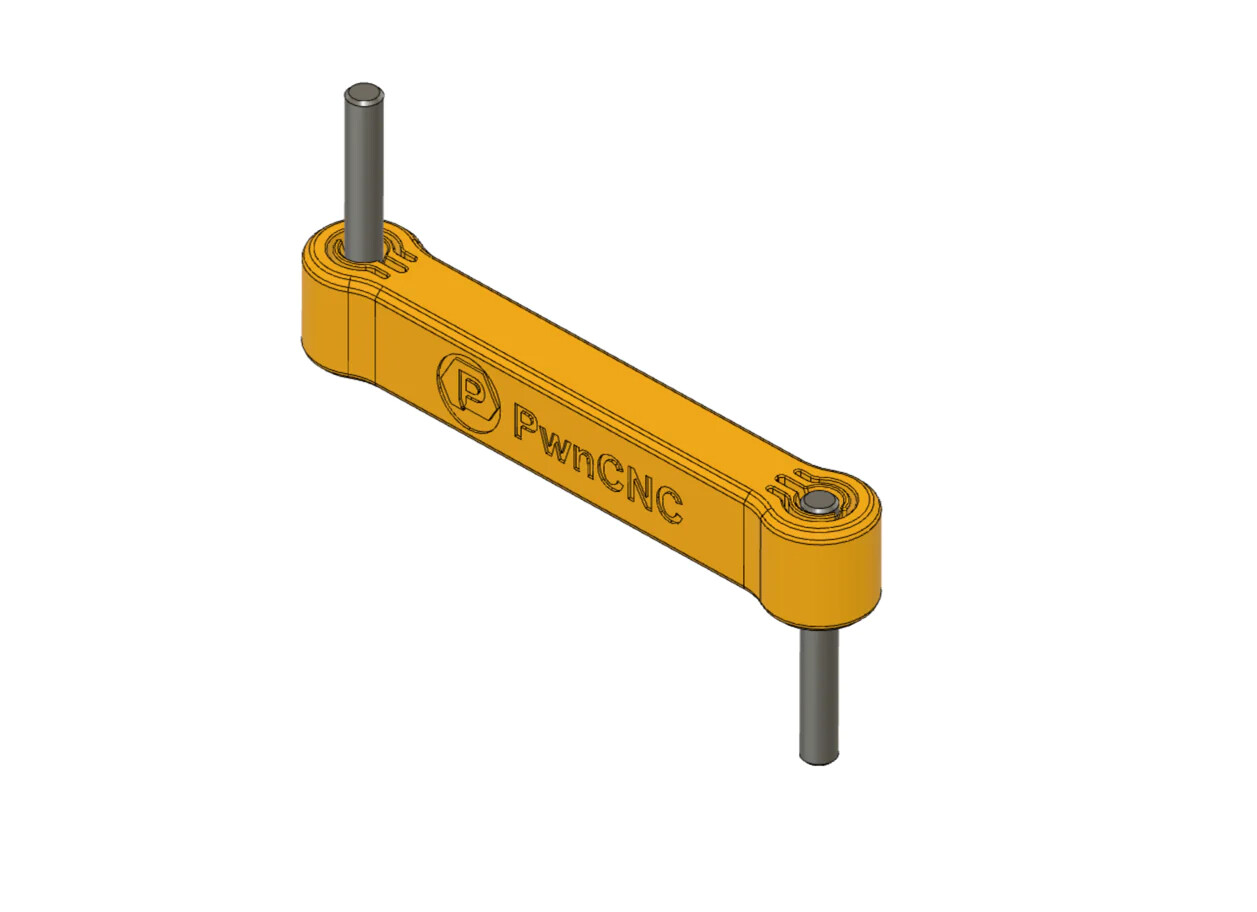

The simplest (and cheapest) type of tramming tool is a tramming arm. Any rigid bar of hardwood, aluminum, or a rigid plastic & 2 dowels. It doesn’t have be built precise or accurate at all. The only thing that matters is the dowels don’t move, and the arm doesn’t flex.
So to check the front to back tram, insert one dowel in the spindle & point the arm forward. Move the machine head down until the lower dowel just touches the table & zero your Z axis.
Now raise the Z, spin the arm pointing toward the back, and move it down until it just touches.
Read the difference by the current Z value on your readout.
