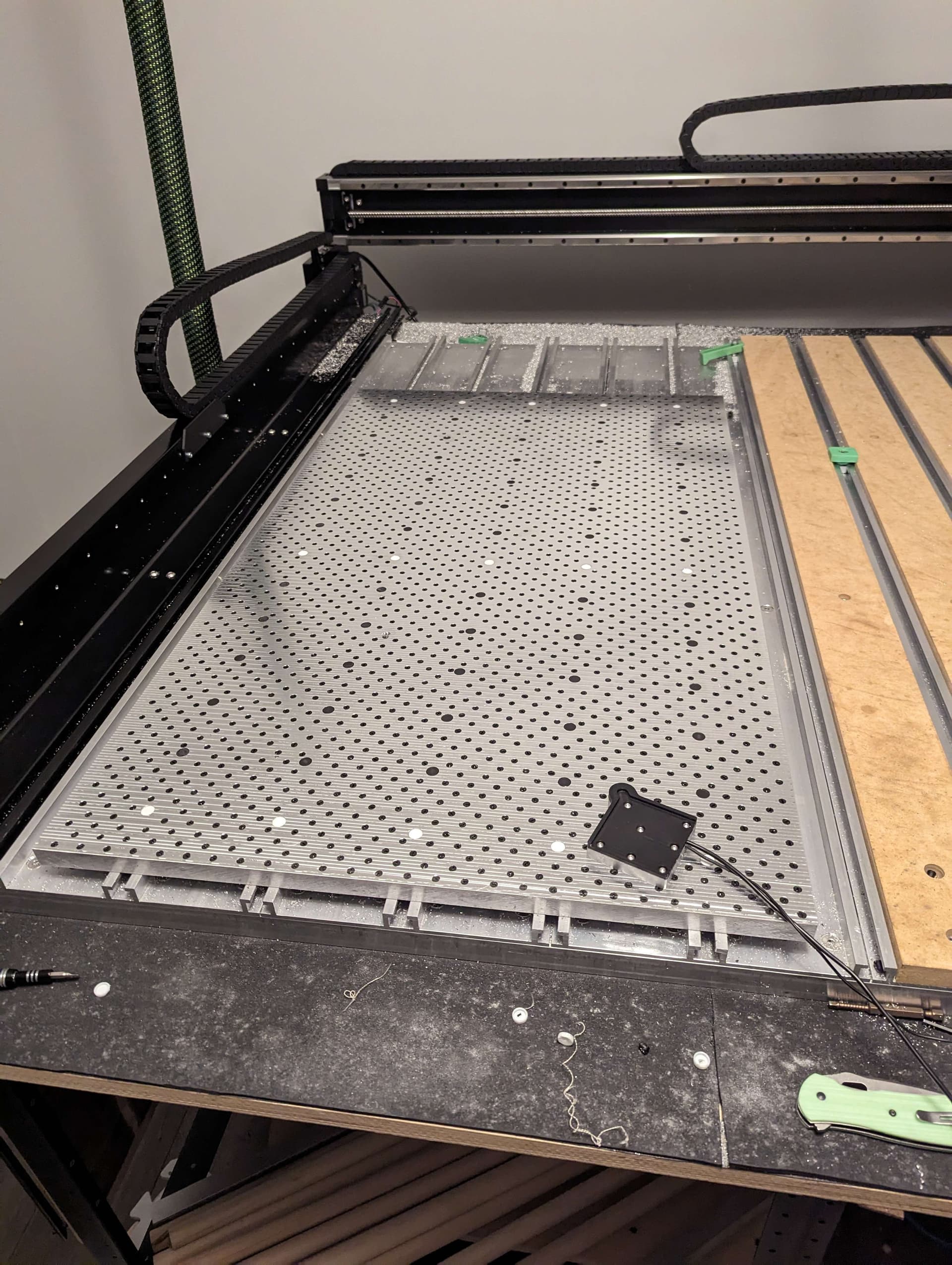

Saunders plates are cute but how about a 50lb slab of 6061 21andsome x 36 all machined using CC. (DONT DO THIS SERIOUSLY JUST LEARN FUSION AND BUY SMW)

1/8 Tools can do about 50x spiral entry holes to 3xDia before breaking without pre-through-drills which you cant do without center drills. This creates exponential time increase.
Cutting fluid is nice but if you can’t get enough you’re basically spitting on it and if you have air blast you cant just spray it you will need to set up a misting system.
Tapping 2315 holes will turn you crazy. Buy a tapping arm because even a threadmill will need a de-galling in Lye every 200ish holes.
The effort it takes to trick CC is better spent learning to read Gcode and then a CAD program finding a post processor, setting that up, setting up your machine, making some ghost files to make sure you understand your post is good, then learning feeds and speeds, then testing those feeds and speeds gradually getting more and more ballsy.
Or you can do something like this and your programs will take forever and be inefficient, wear your tools prematurely, battle CC’s bullsh where it sees a line and refuses to contour it because geometry bad. (hence the 6th side of this program being done separate)
mitee bite .31.c2d (72 KB)
And finally: 2315 of anything is a bad time. Because 2 seconds per op is an hour let alone minutes per op
