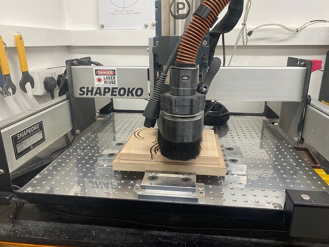

I have a 2.2kW spindle kit and a from PwnCNC, who make parts for many different machines. It arrived truly plug and play after sending an image of the controller board. Mains lead, spindle lead plus the PWM attachment lead.
The V7 dust boot can be attached at any height on the spindle and does not impinge too much. My maximum available Z axis height is measured from the baseboard to the collet nut.

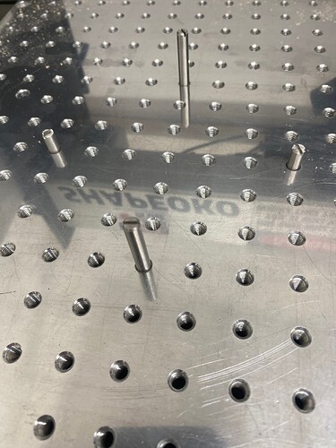

PwnCNC is truly machine agnostic and they create items that are tested to work with several different CNC machine manufacturers. My machine is a belt-driven Shapeoko 3 dating to July 2020. My modifications include the Carbide 3D HDZ heavy Z axis, a belt adjustment system that permits me to tune the belts to a set frequency (C3 ~ 130.813Hz) and a Saunders Machine Works baseboard with 840 x M6 threaded holes plus their stiffener bars and modular vice system. I can reliably machine metal to a tolerance of ±0.001" and on one occasion achieved an unbelievable tolerance for my much-improved machine of ±0.0004".
My machine is a standard size so I only have a work envelope of 400 x 400mm but if I had another sized machine and space to put it, I would also want the Masso controller and the ATC provided by PwnCNC.

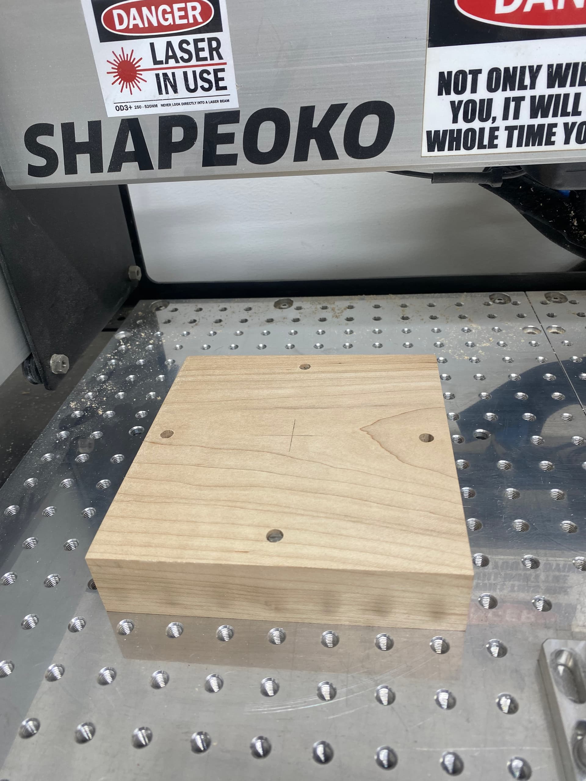

The only issue I’ve had is when i tried to cut 3.5 in tall stock. I clamped it from the side (fairly low) so it pulled the material into the bit. Lesson learned, make SURE stock is held down firmly. Probably would have been a good idea to clamp it from the top, but you live and learn. ![]()
If your stock is a little long, or the edges won’t show, you can cut a groove in the side or end with a table saw, I usually go about 1/2 up from the table & use that groove to clamp the block.
