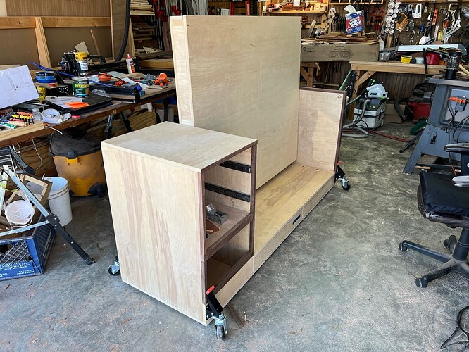

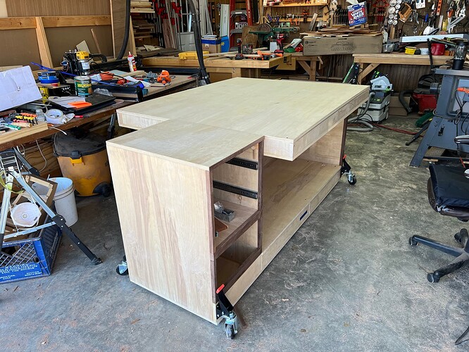

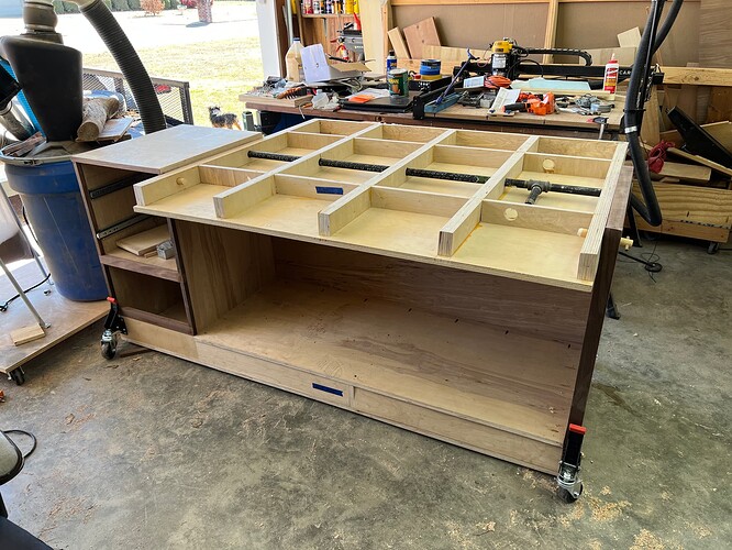

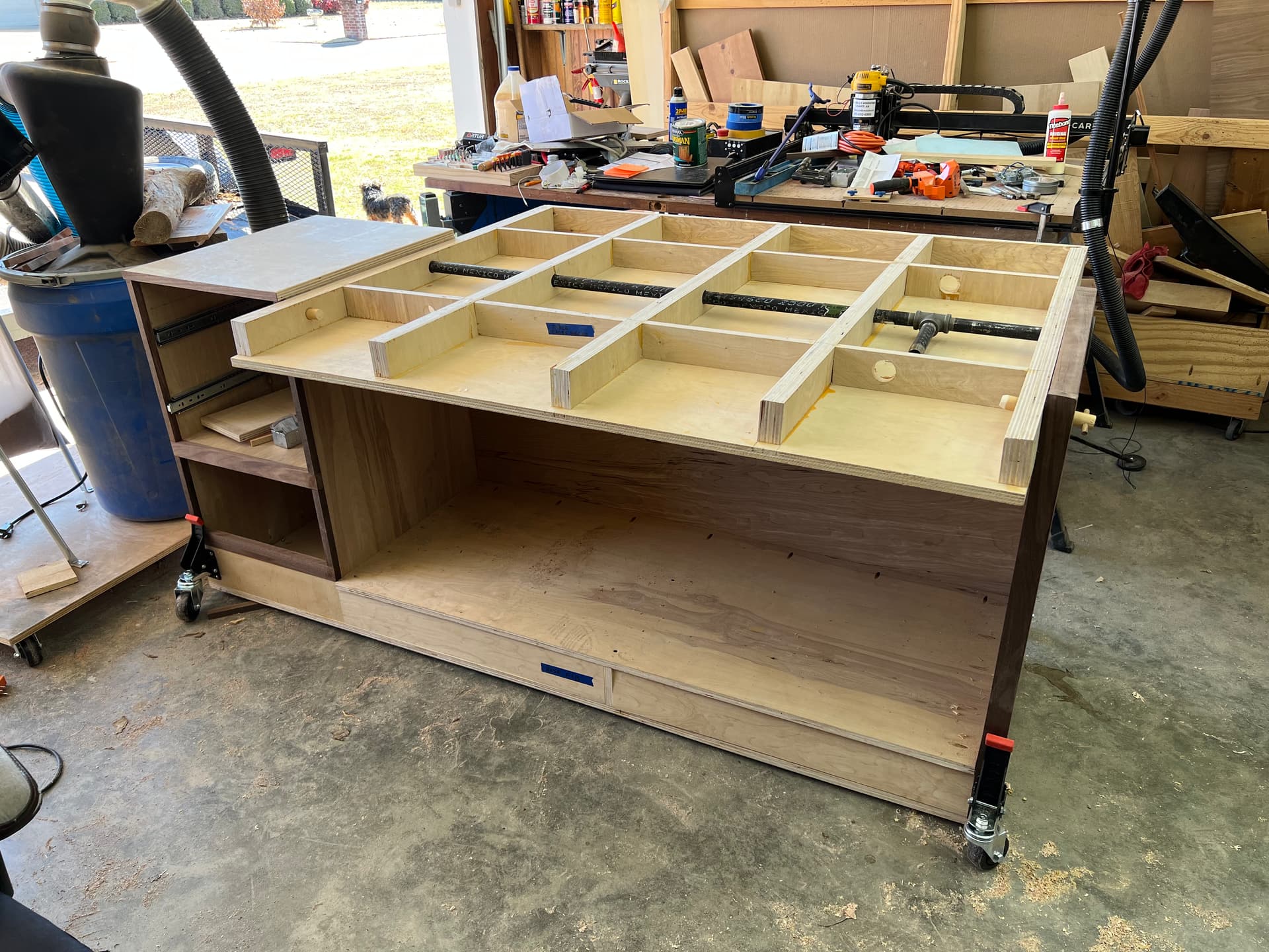

How did you bolt your machine to your tabletop?? I’ve just about finished my flip table and I’m ready to bolt on my machine, but the mounting holes are too small to use a socket big enough to use any appropriate sized lag bolt or regular bolt and nut. Ideas???

The original plans include folding legs, and I have them made, but I’m not installing until proven necessary. The table is held in place with (2) one inch dowels and is incredibly sturdy as is. So time will tell.
