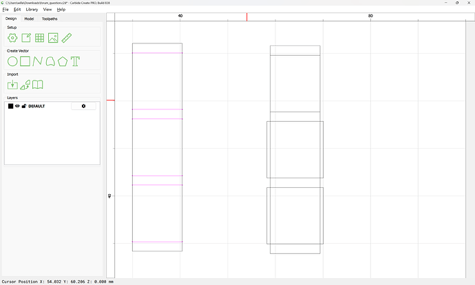

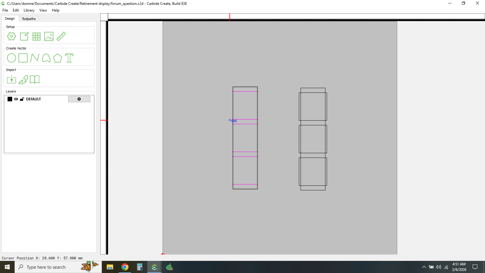

How do I join these vectors?

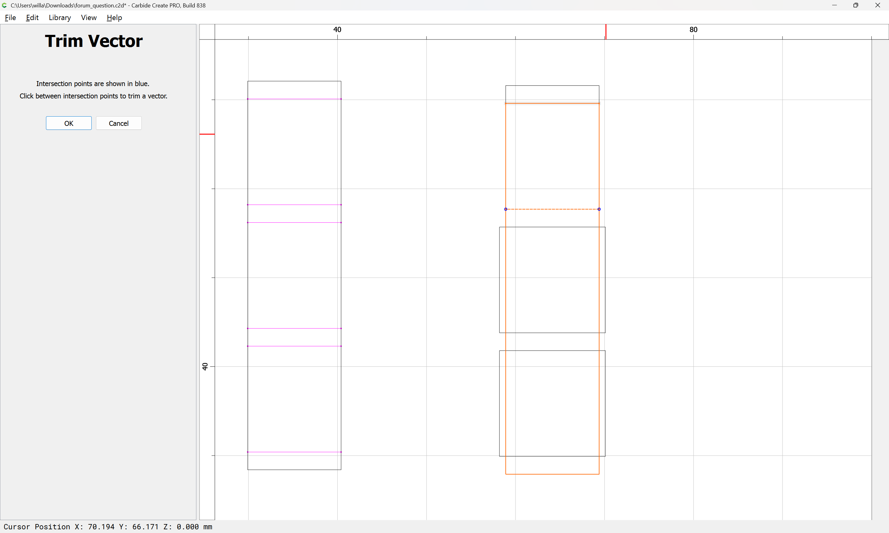

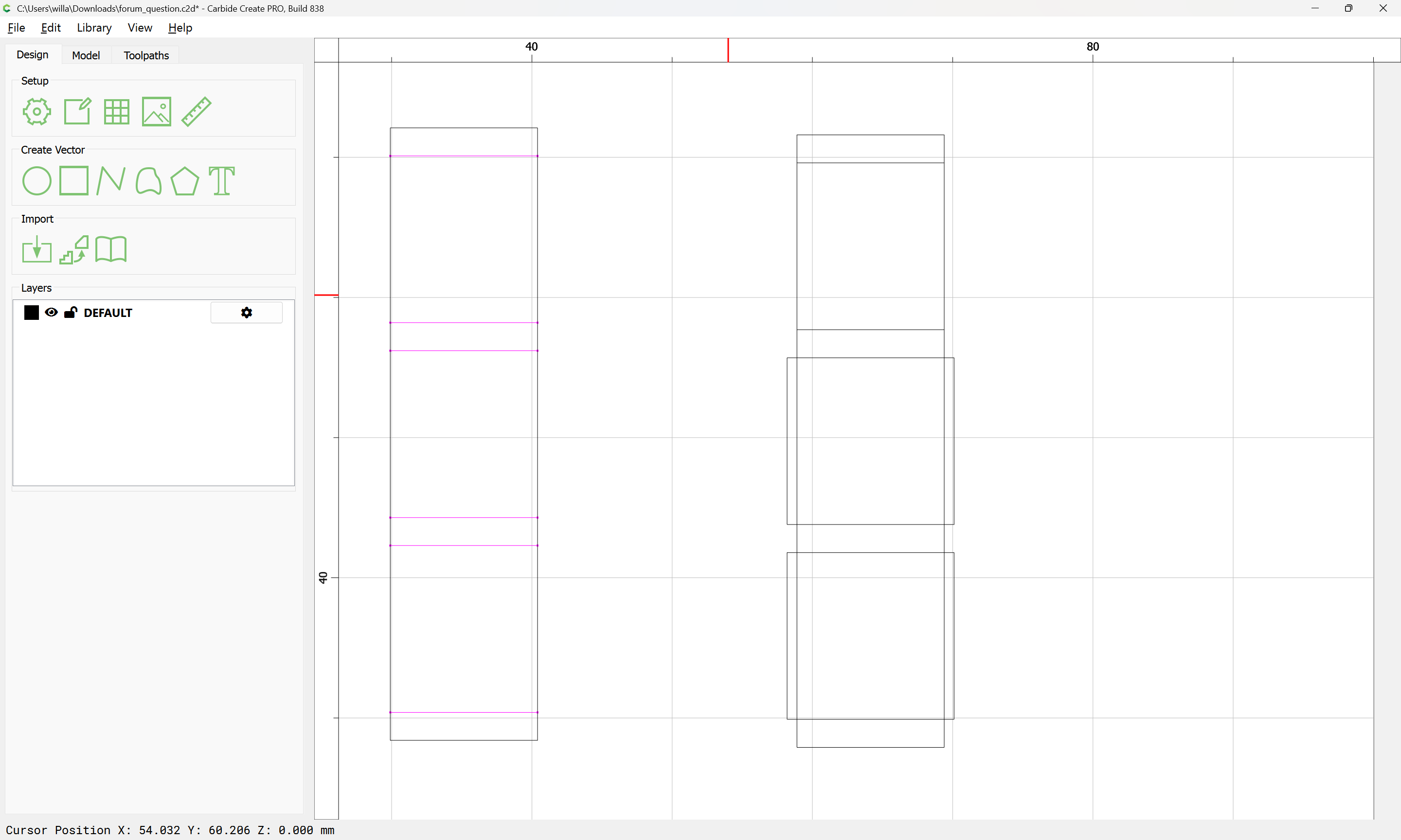

I drew the shapes on the right. Used trim vectors to end up with the shape on the left but I can’t seem to join the vectors. What am I doing wrong here?
forum_question.c2d (52 KB)

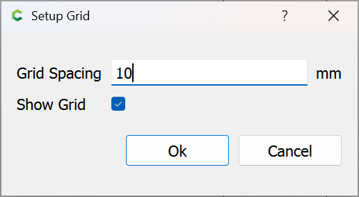

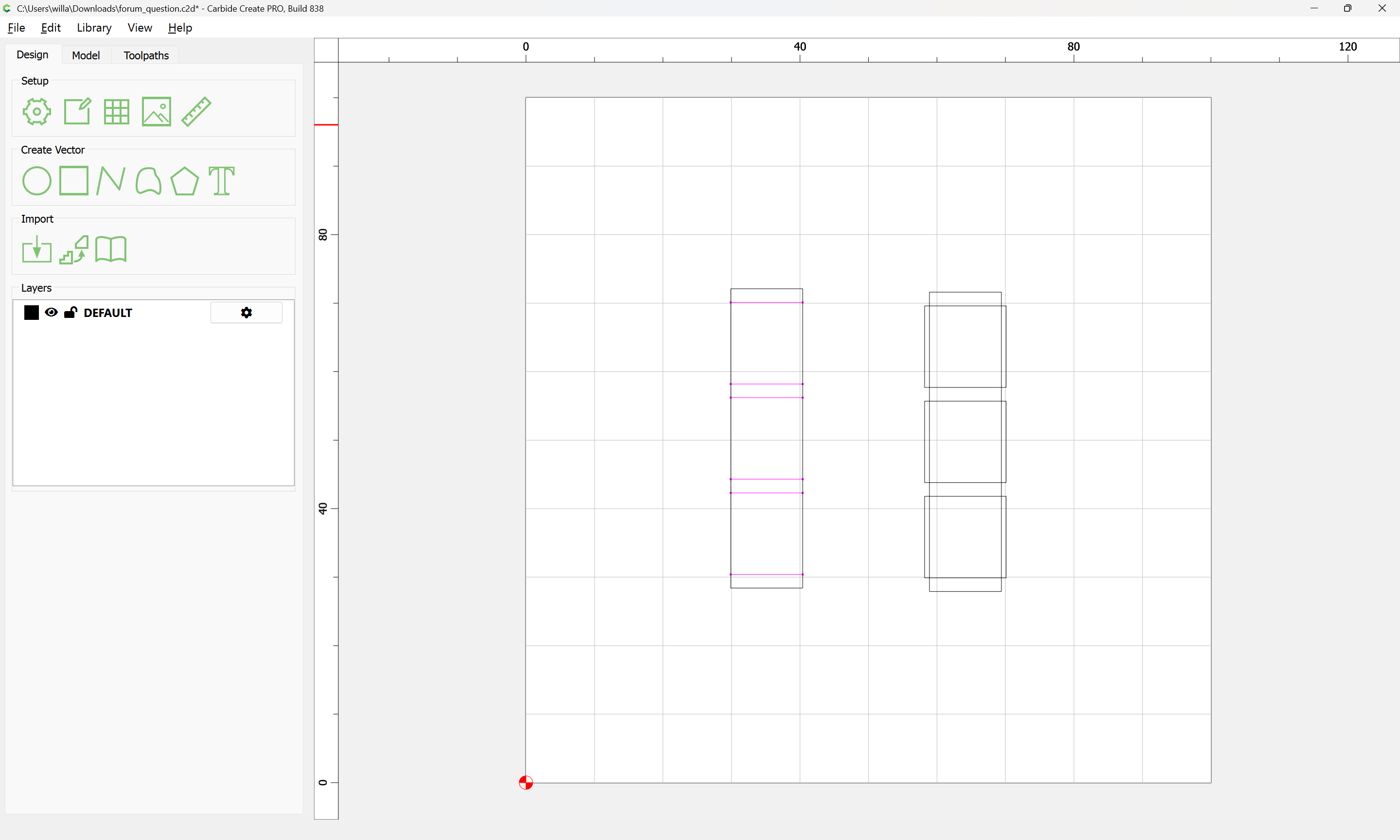

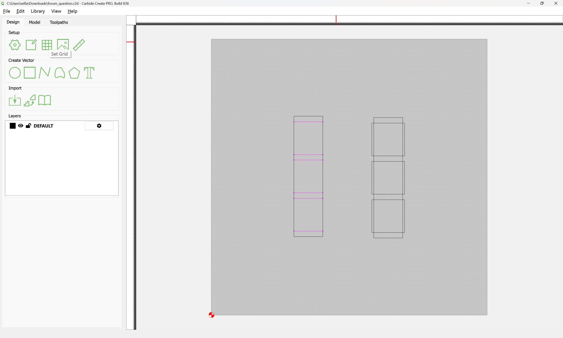

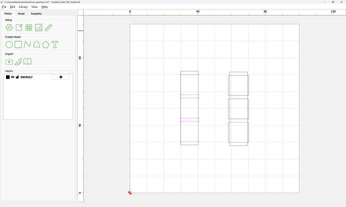

Start by setting the Grid Size to something reasonable:

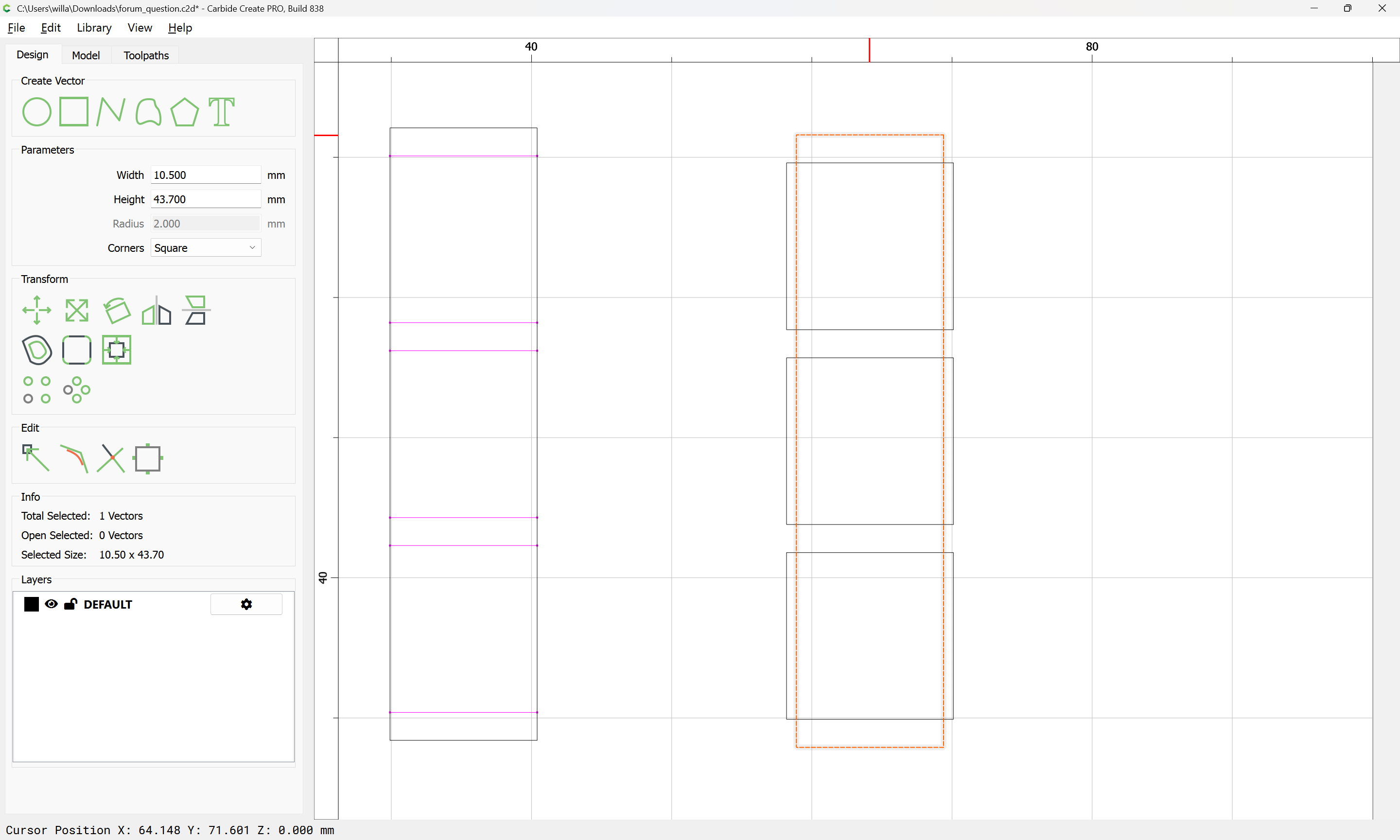

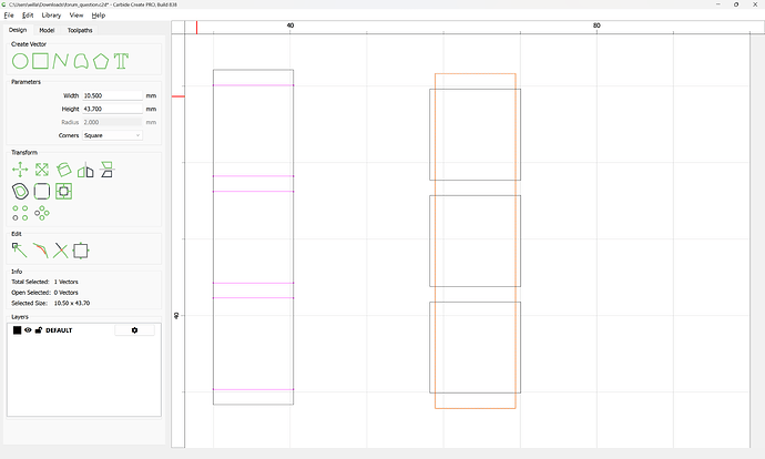

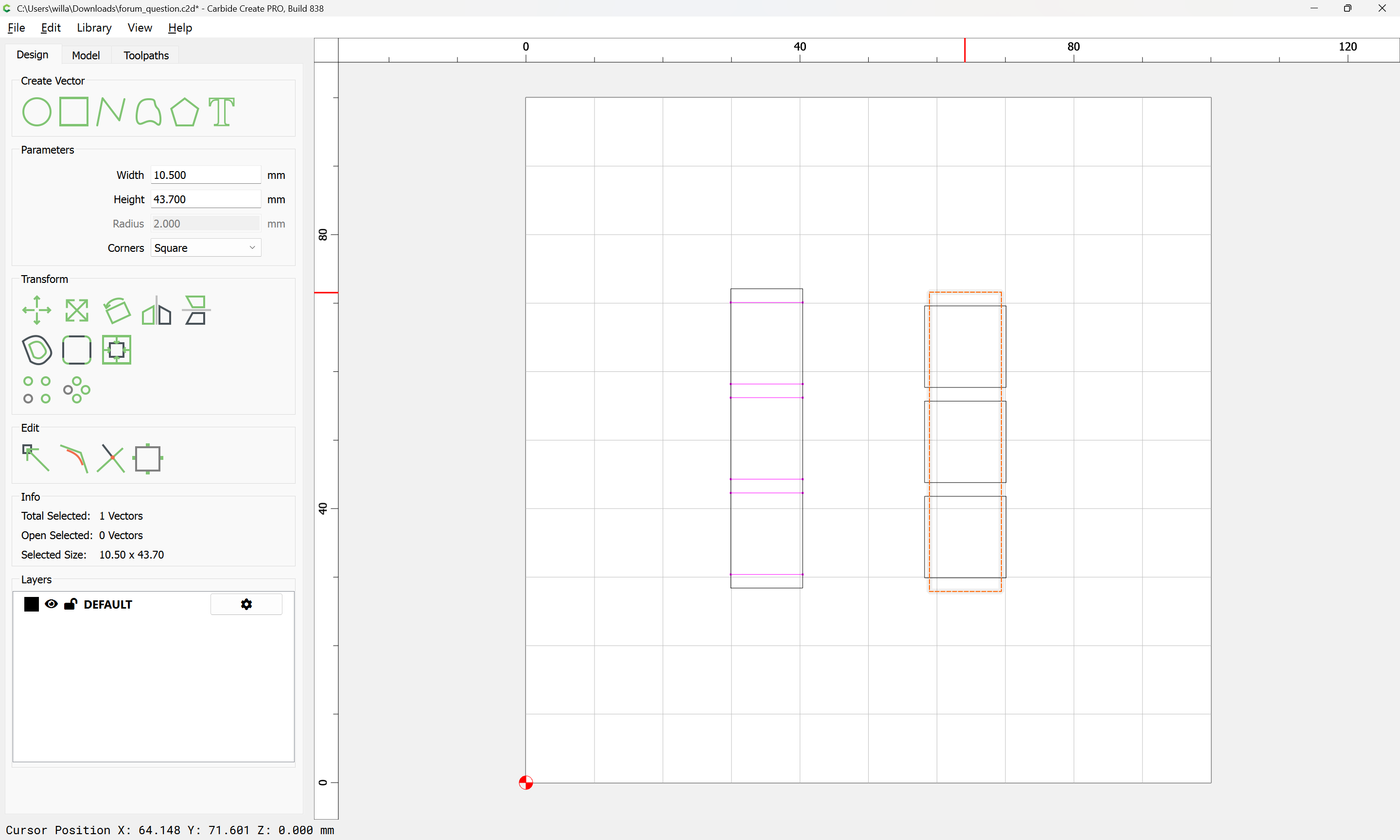

Note that when using Trim Vectors, it is necessary to trim out the entire shape — this means that one must duplicate anything which one wishes to preserve for further operations or other usages, so select the largest rectangle:

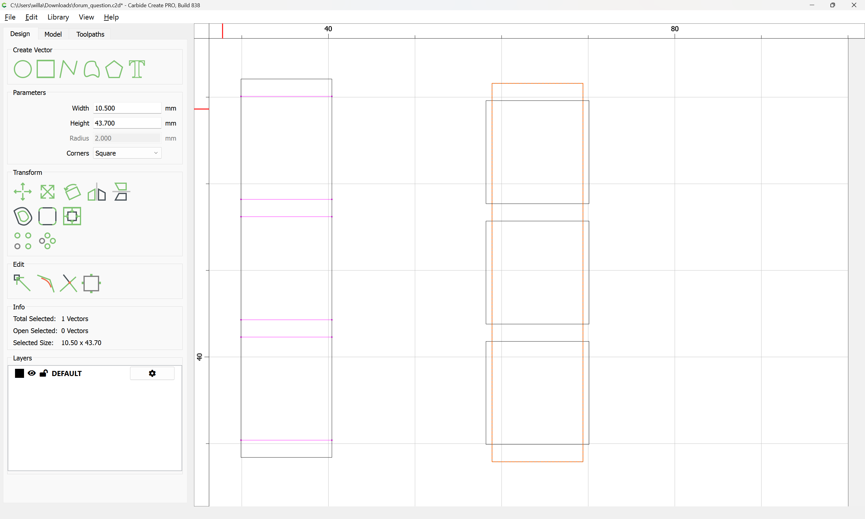

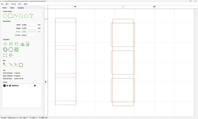

copy-paste it in place:

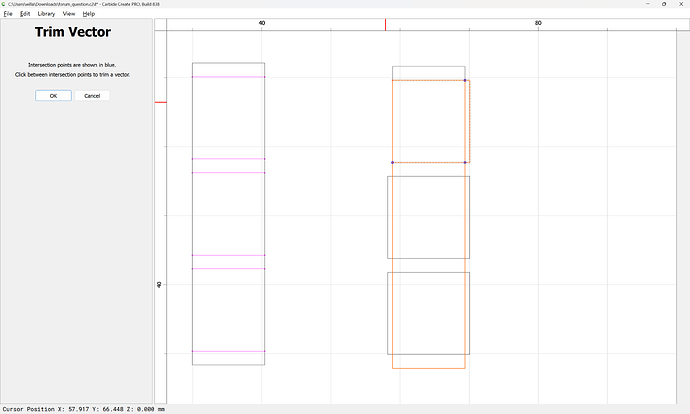

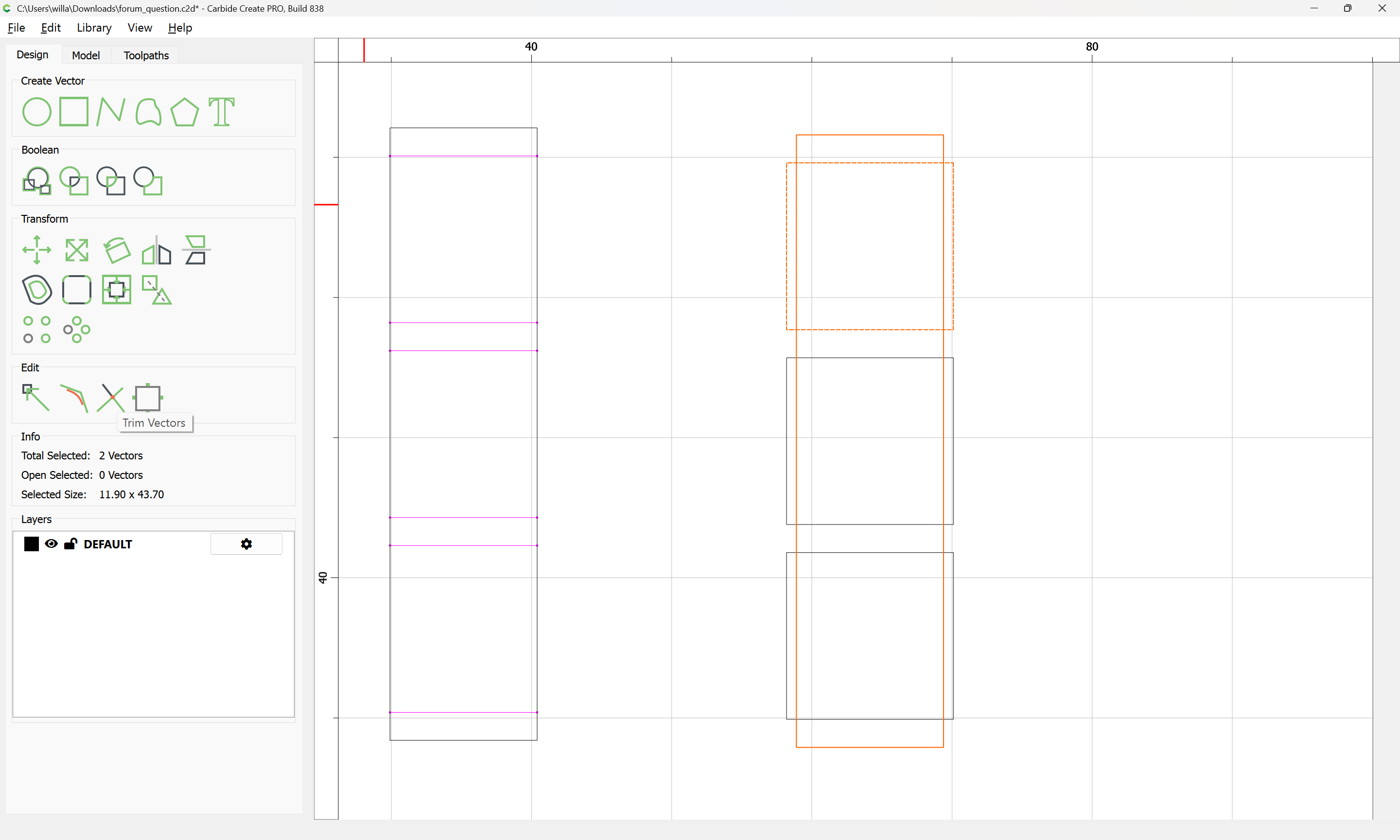

Then use the replica for one operation by shift-clicking to add one of the other pieces of geometry to the selection:

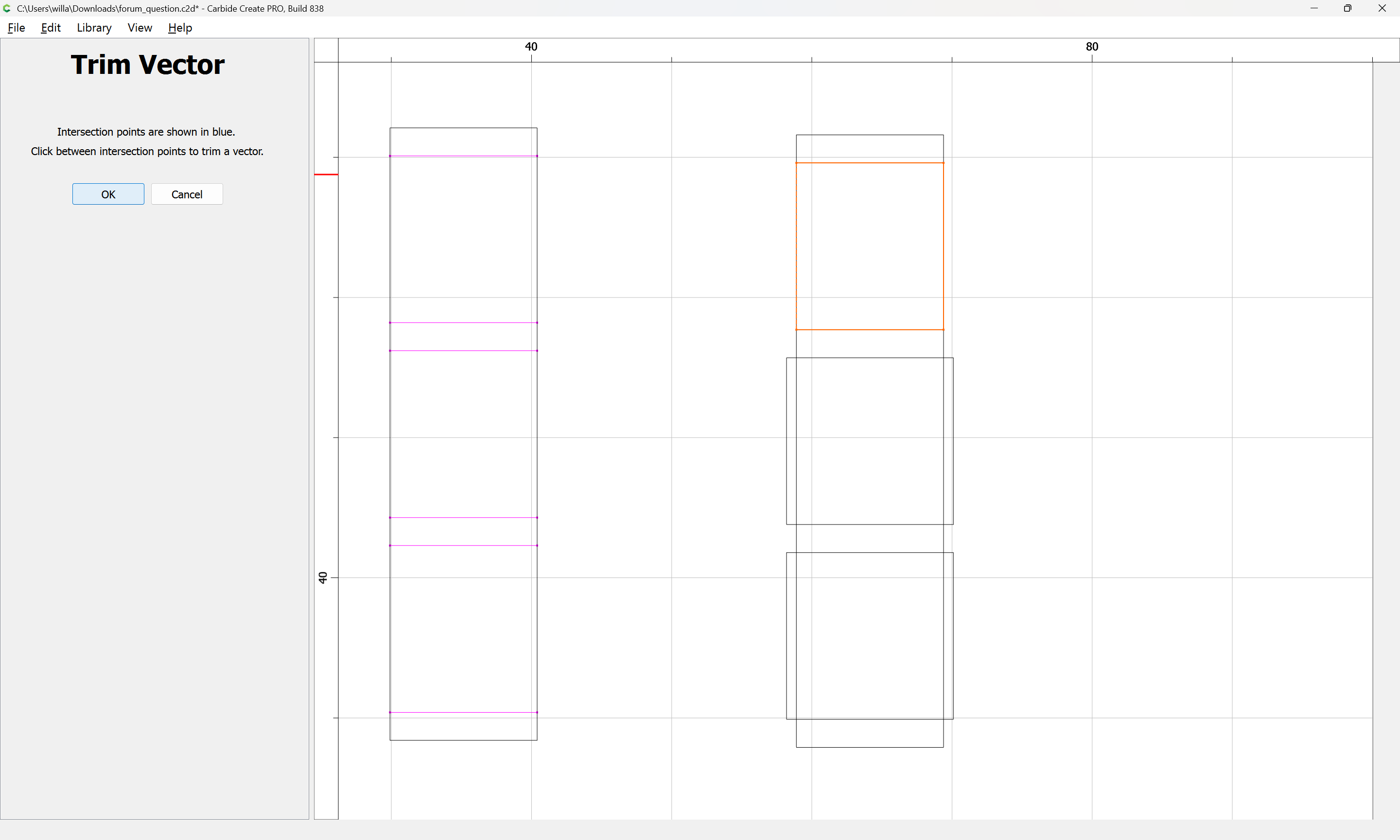

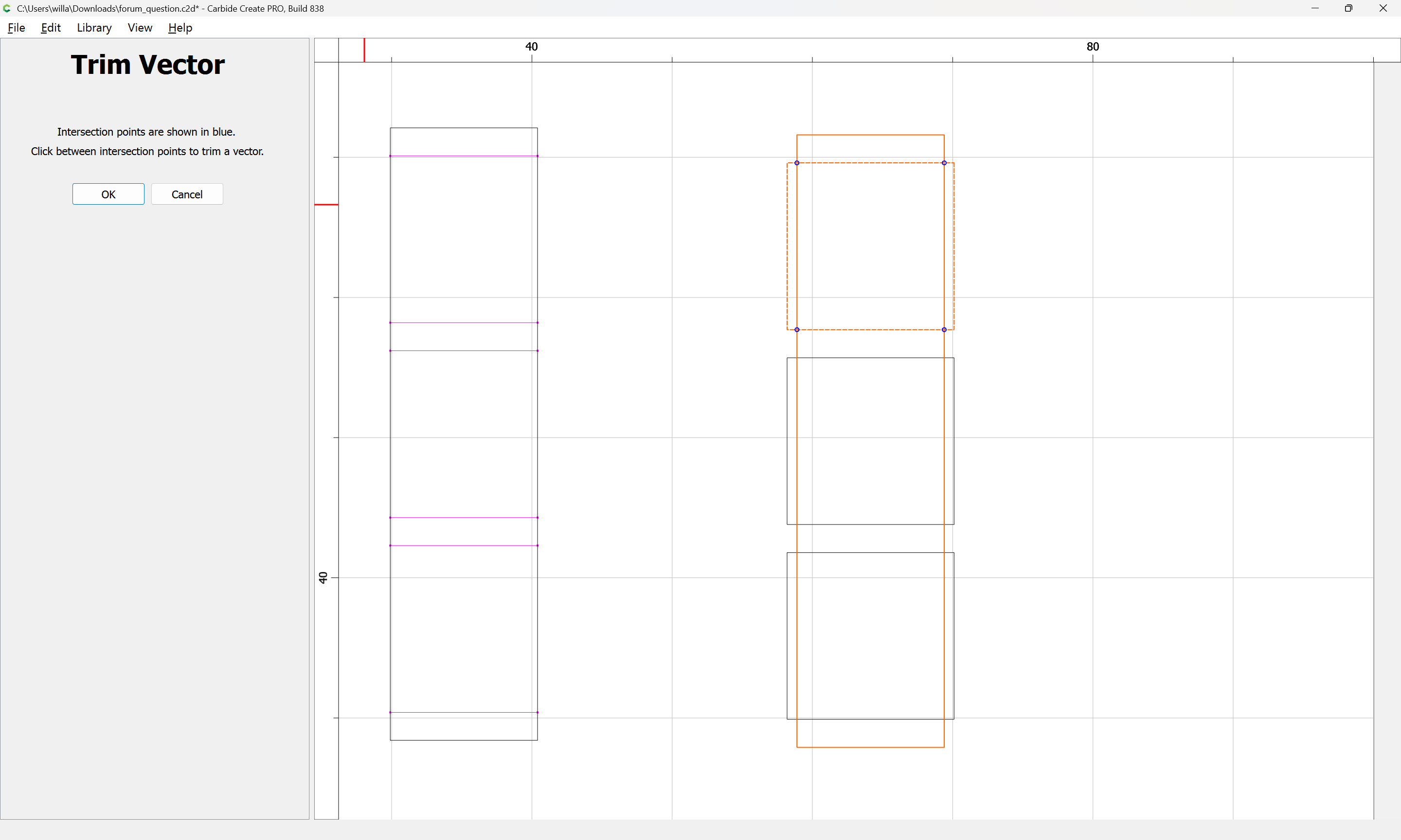

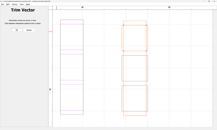

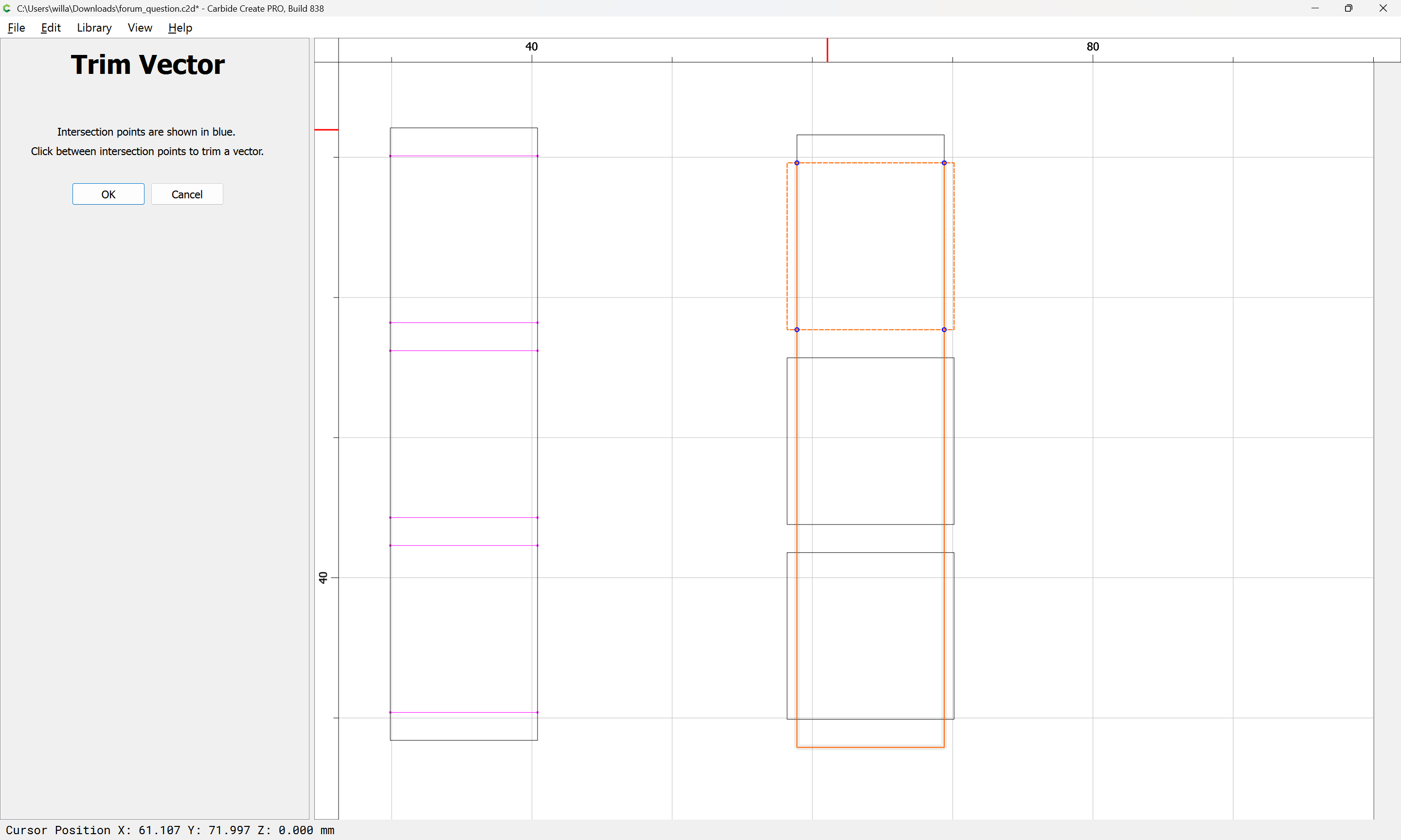

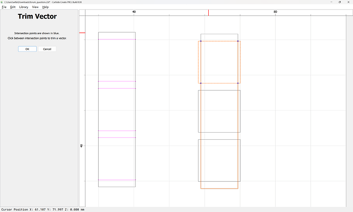

then use Trim Vectors:

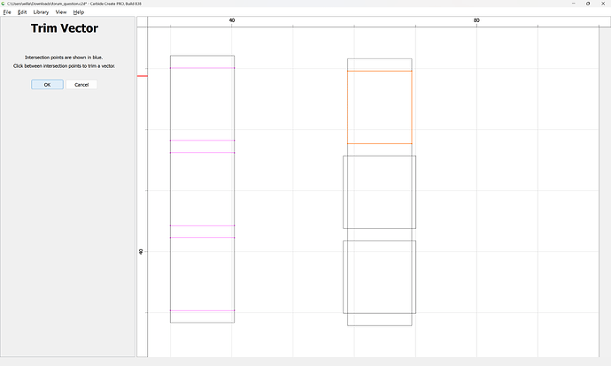

to remove what is not wanted:

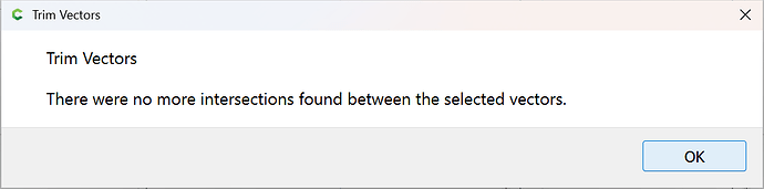

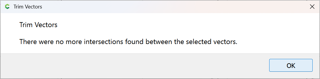

Until one arrives at:
OK
OK

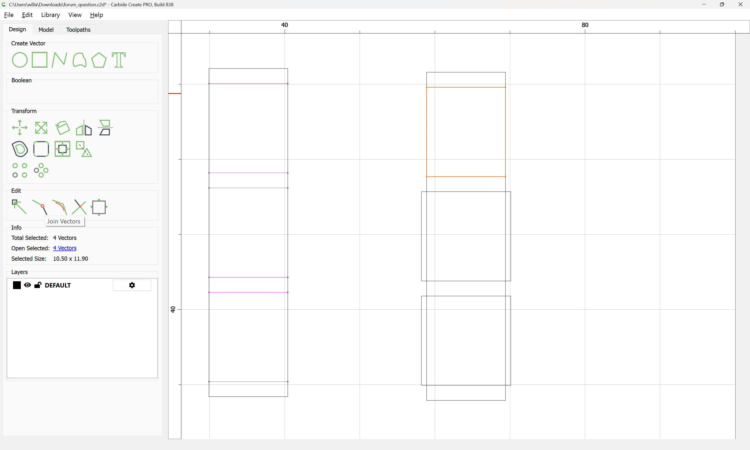

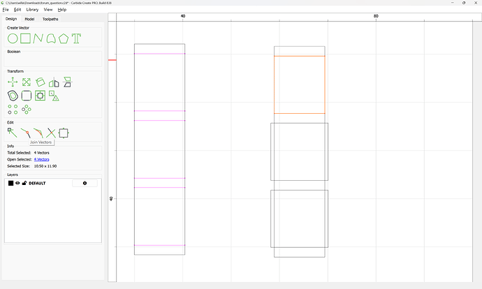

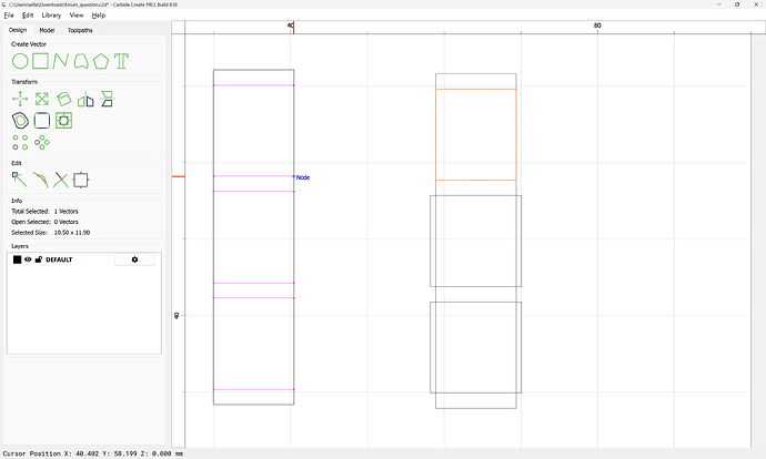

Then use Join Vectors to close:
Repeat for the other two:
