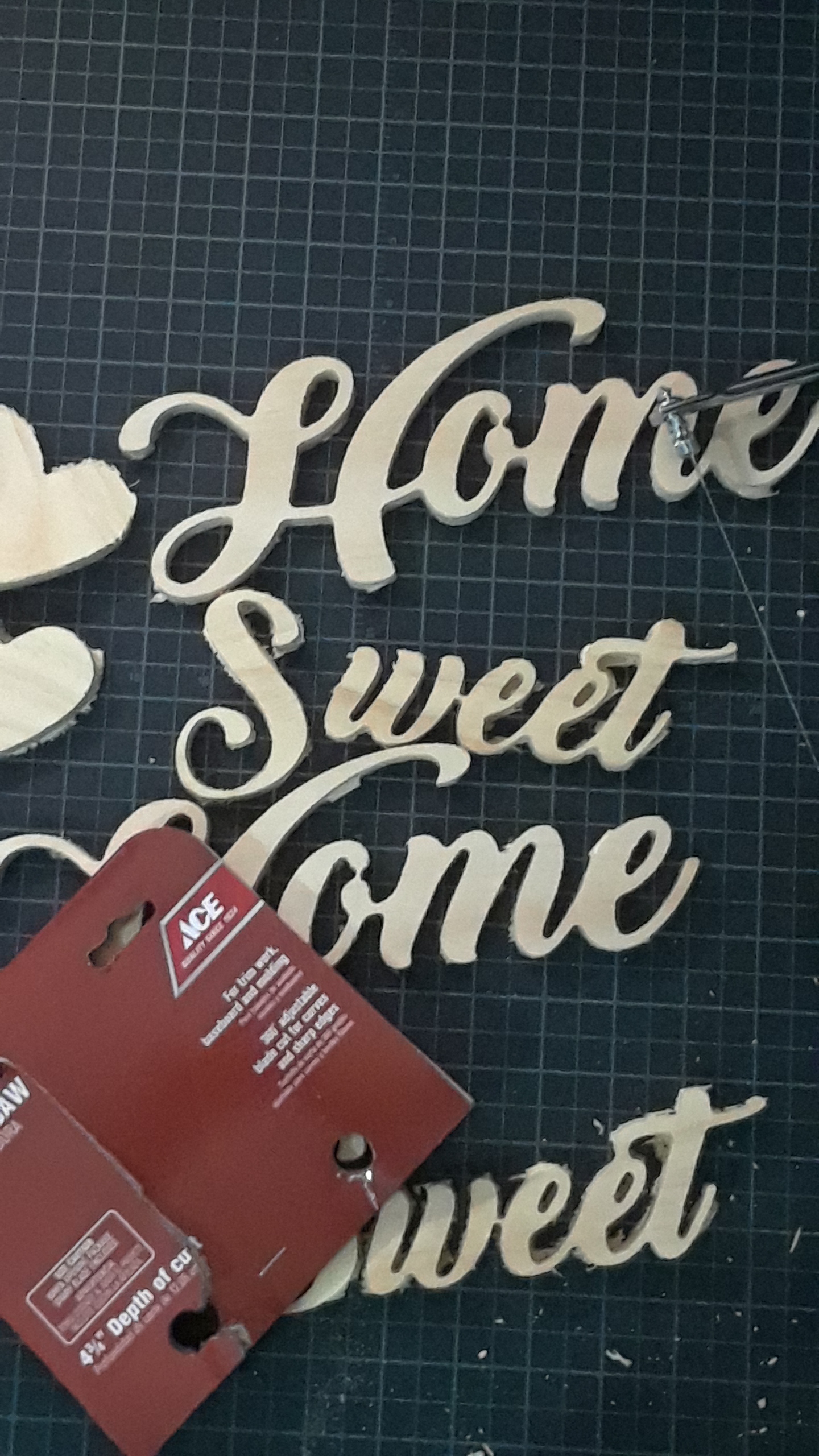

How Do You Cut Your Small Tabs
Hey, what are you guys using to cut Small Tabs? I already tried my Oscillating Multitool, but it wont get into the small places with out damage. Tried my dremel, but my hand would pretty much need to be…well…a CNC to stay on course and not cut & damage my nice, previously cut letters. lol
Just curious if someone has something I “havent” tried.
Have you tried a coping saw?
Hmm…I have not. About to run to my local Ace and see if they have one.
Thank you there dear chap! lol
How big are the tabs? I often use very small tabs set up in Aspire like .1 inch in height and .05 long and the use a small wood chisel and hammer. Does not always work on bigger parts. I now use blue masking tape and Titebond to secure most of my work. Many use tape and super glue, faster, but on large parts cost comes into play.
Welp! I’ll say this much @MrGNY
It worked, but by golly…it is very tedious having to setup and thread that blade for each section of letters you need to cut. I got through it though thankfully right before my local Ace closed too. Sheeesh! lol
Depending on the part geometry and material and tab thickness I use:
  • a sharp chisel
  • an X-acto knife
  • a razor saw blade in an X-acto knife handle
  • a Japanese flush cut pull saw
  • a gouge (I’d love to put together a full set with radii to match every possible contour)
  • a utility knife (usually the Gerber EAB I keep in my watch pocket, but I really should go for the Stanley in my tool chest)
Just like Will Adams I use a variety of tools depending on the part. I found that oss tool would nick some projects. A SHARP chisel works well, a Japanese pull saw works and if it is a larger project I use a router table with a pilot bearing to trim off the tab.

Search for “keyhole saw” or “jab saw”. The Jab saw is made for cutting drywall and the blade may be too wide for some curves. Keyhole saws are smaller and narrower, but harder to find.
Keyhole Saw Hikimawashi Nokogiri 4 inch x 15tpi
Kobalt Keyhole Saw
