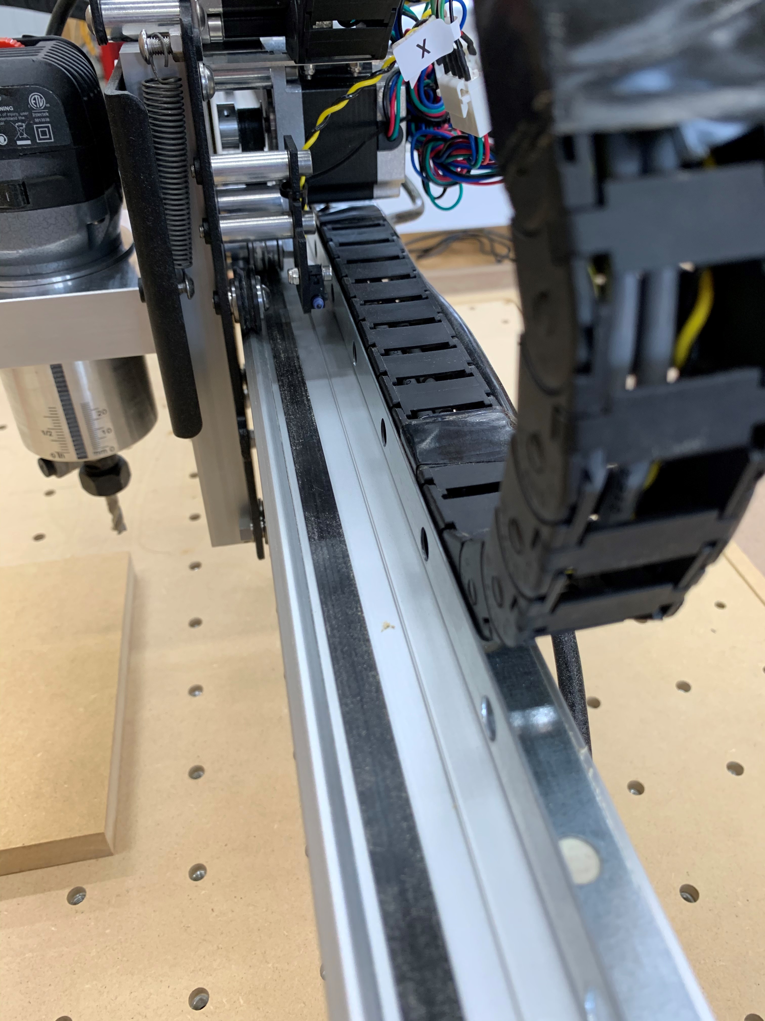

I used electric tape for the router power cord and a metal angle to keep the drag chain away from the screws. I also used heavy duty double sided tape to secure the chain end near the control box.
