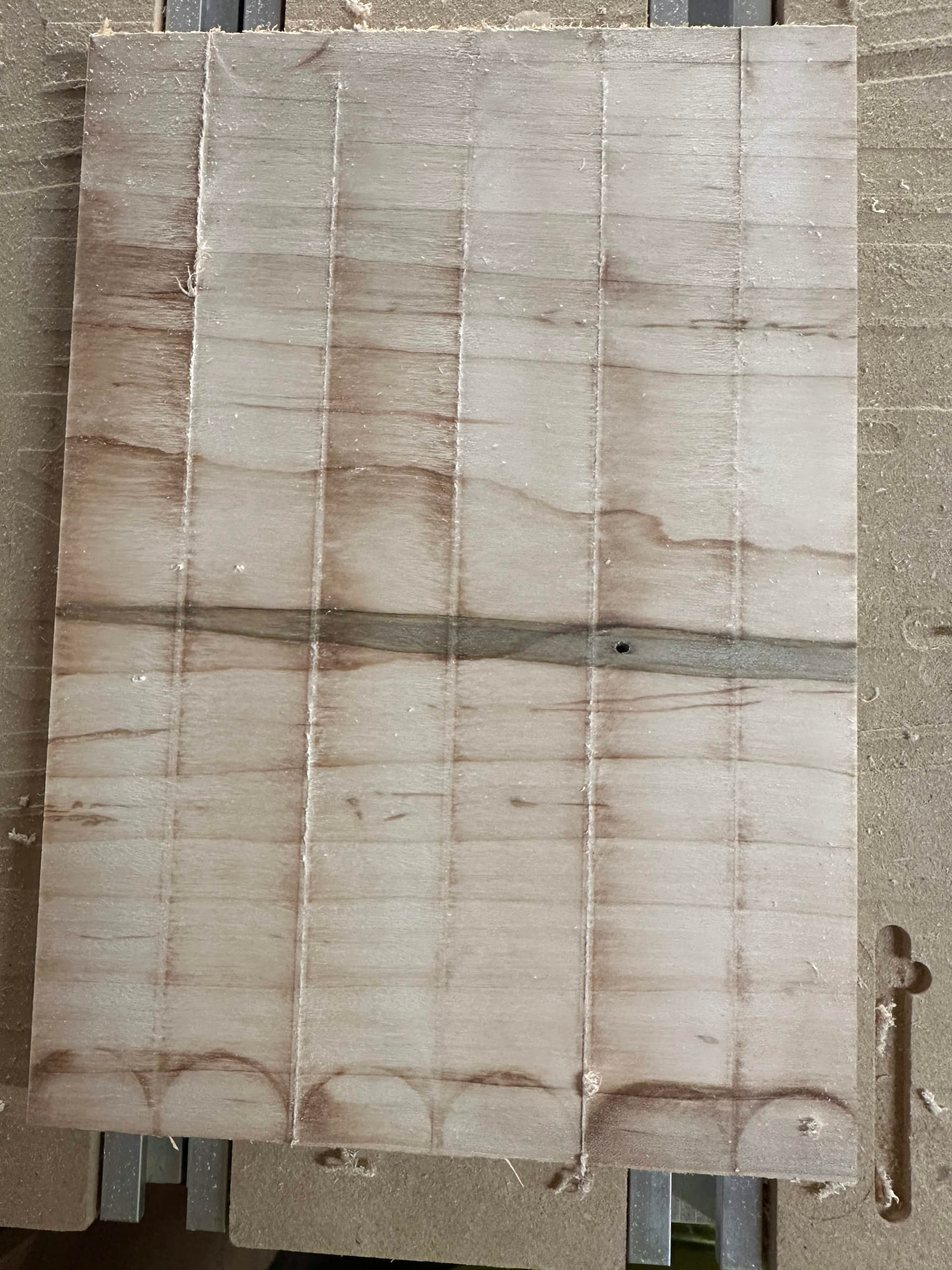

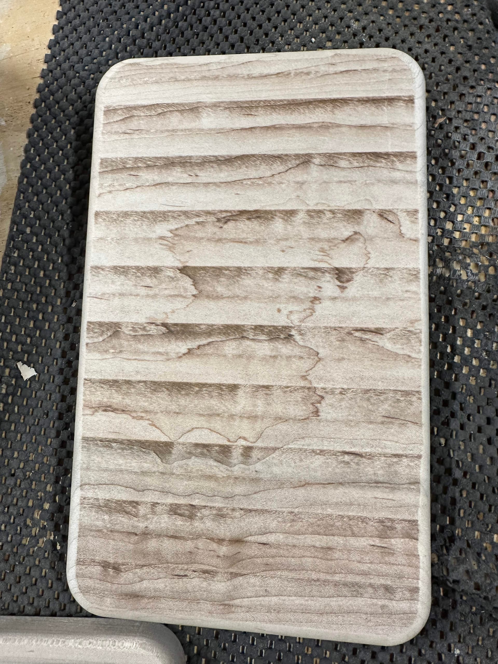

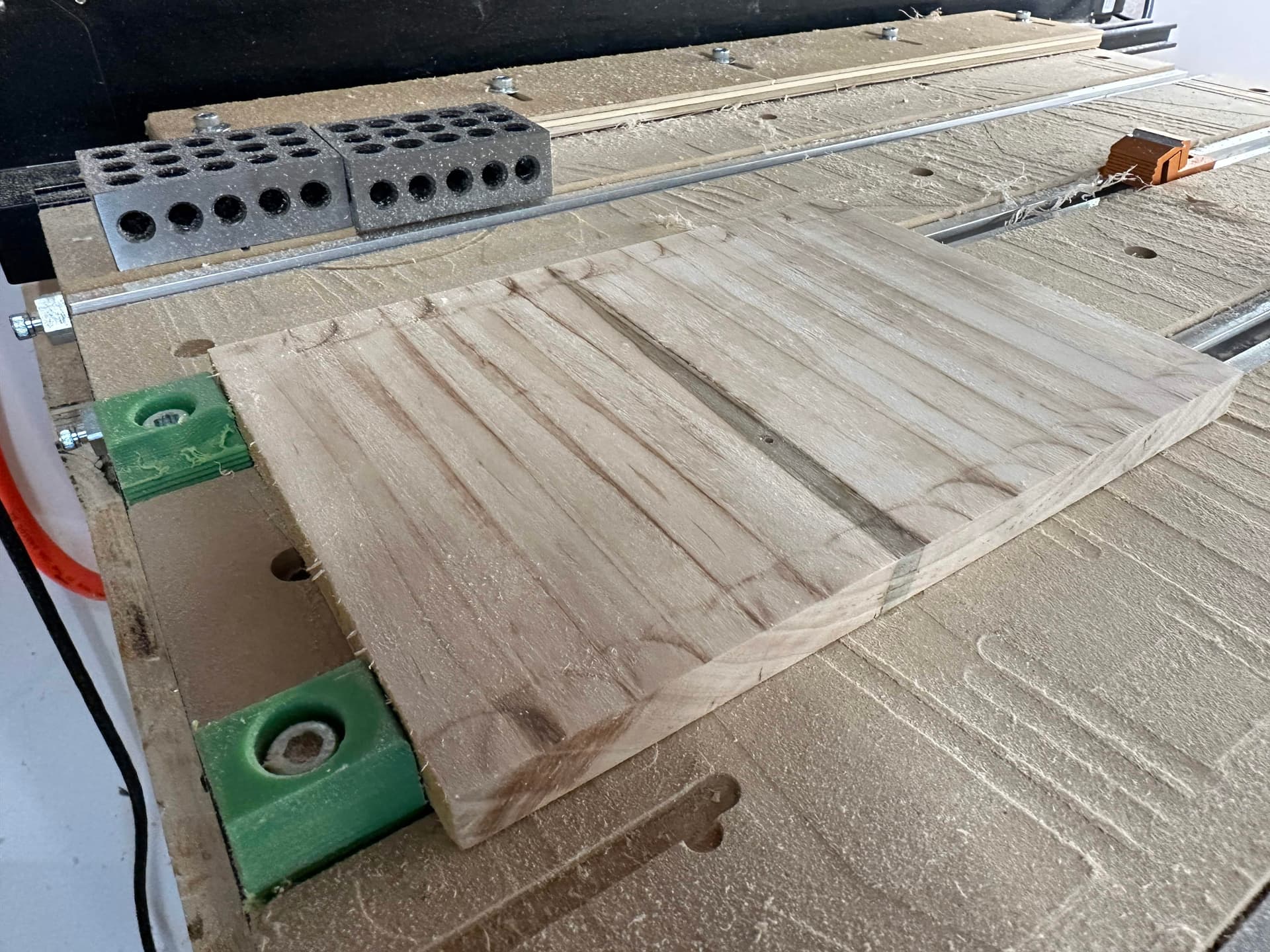

This is a board I did recently where you can pretty clearly see the lines and burning from the flattening process. The lines are easy to feel as well and it took a bit of time to sand out all the markings.

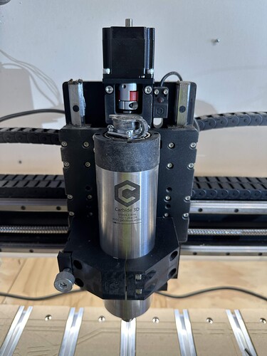

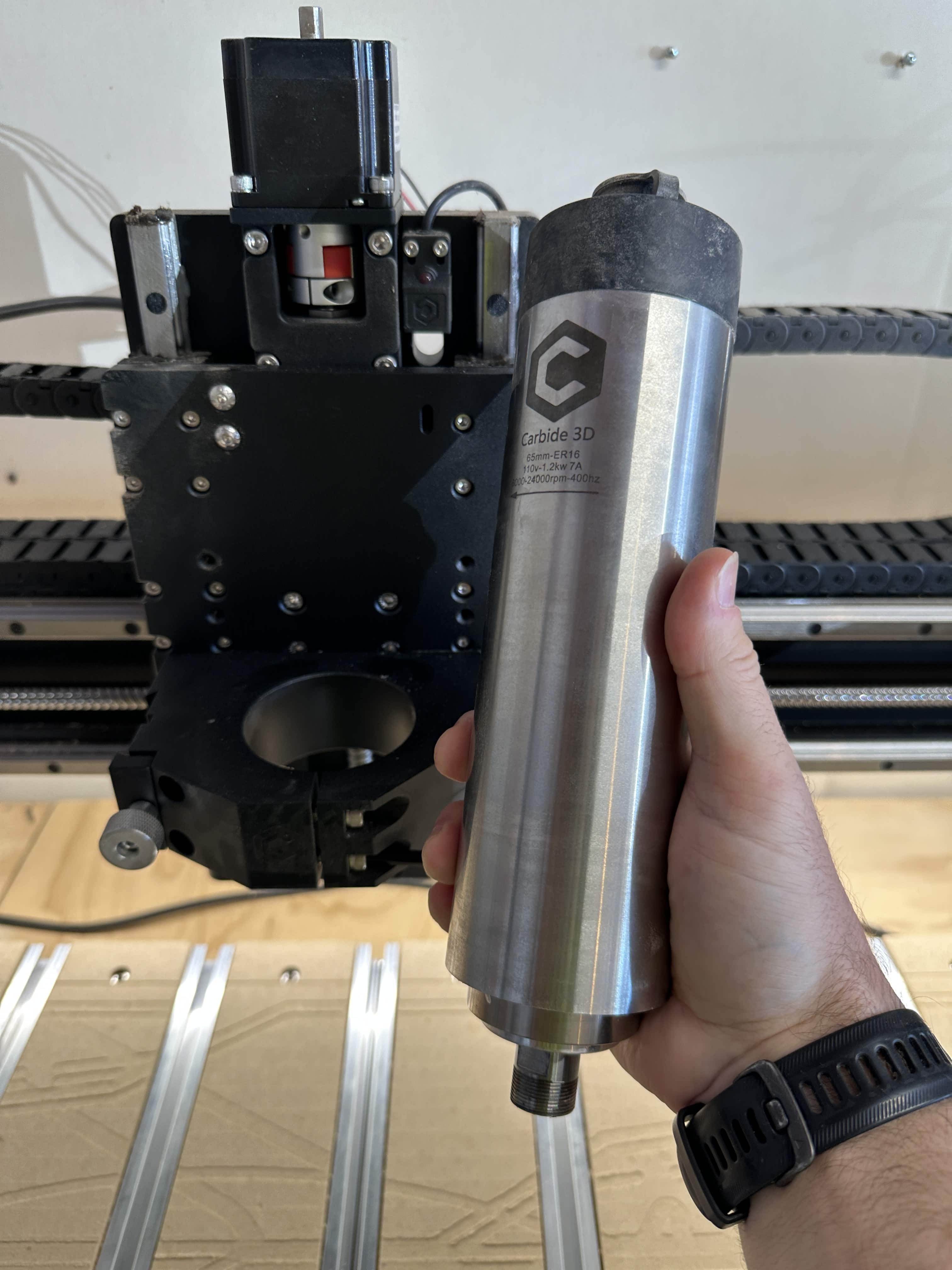

First I brought the spindle to the front center, removed the bit, and disconnected the control wire. Don’t forget to replace the cap so any dust that might be floating around stays out
Next I went ahead and removed the spindle from the mount by loosening the two silver screws at the front of the holder. BE CAREFUL! The spindle is HEAVY and you need to have a hand on it so it doesn’t just fall out the bottom.

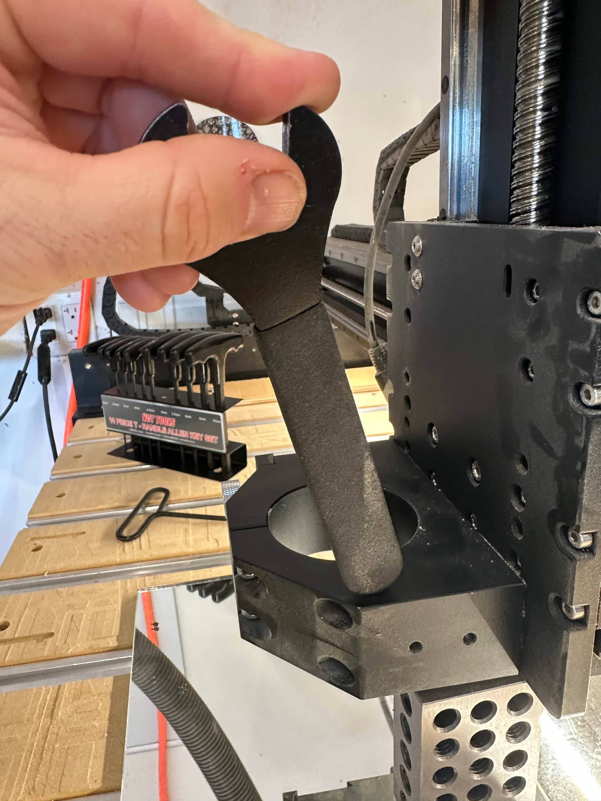

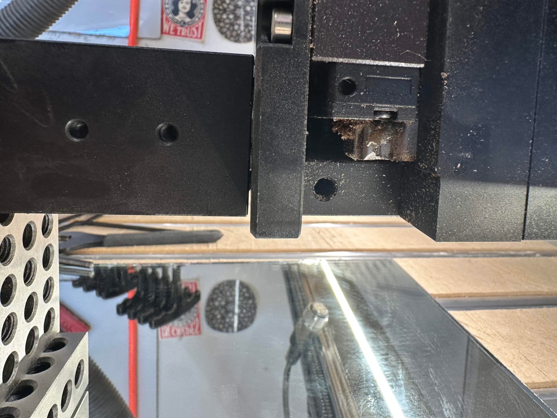

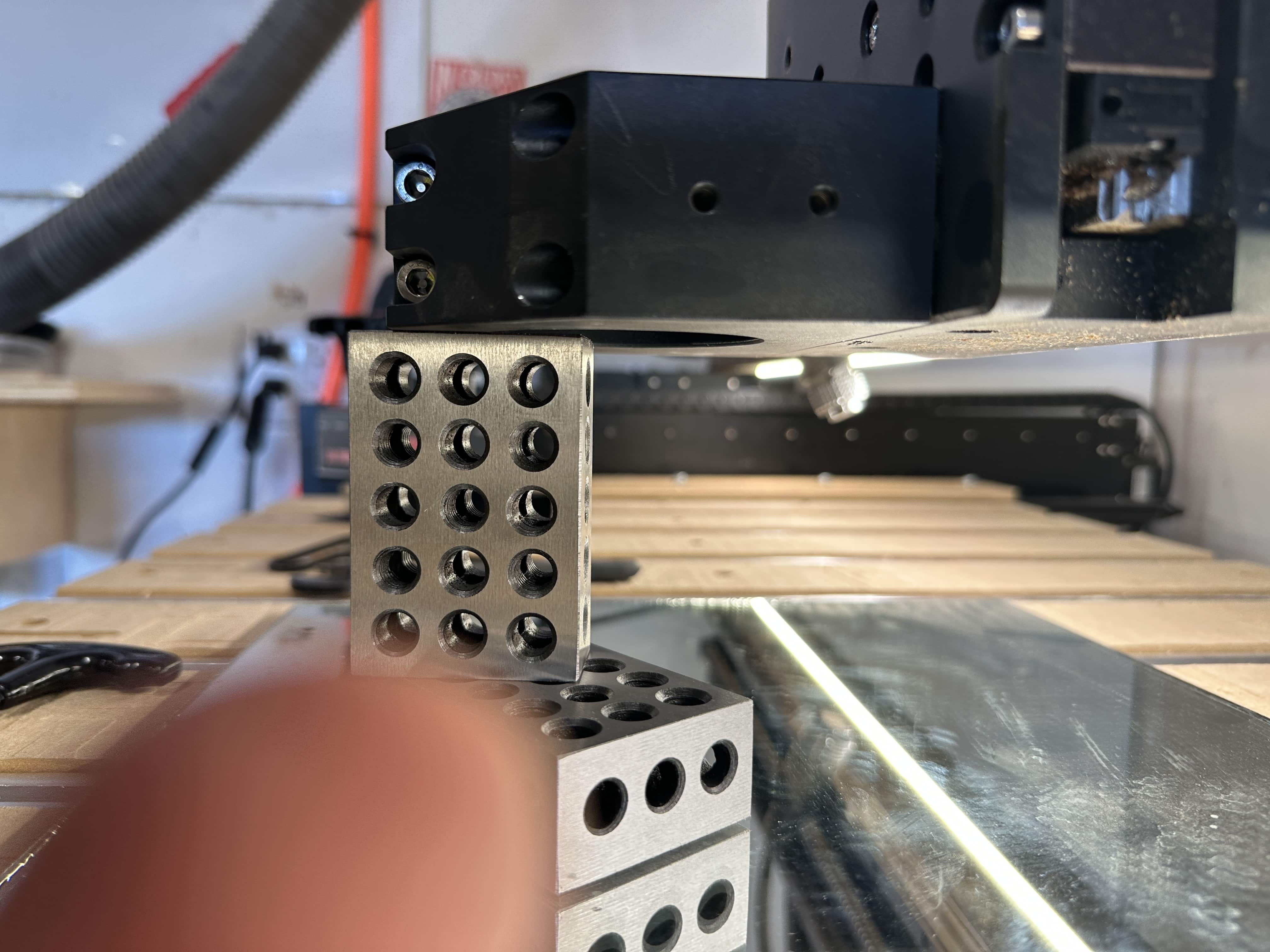

The next thing I did, which is totally optional, was to verify that the holder was, in fact, not flat before I did anything else. The last thing I would want is to go through all this only to discover that the problem was something else and I potentially made things worse.

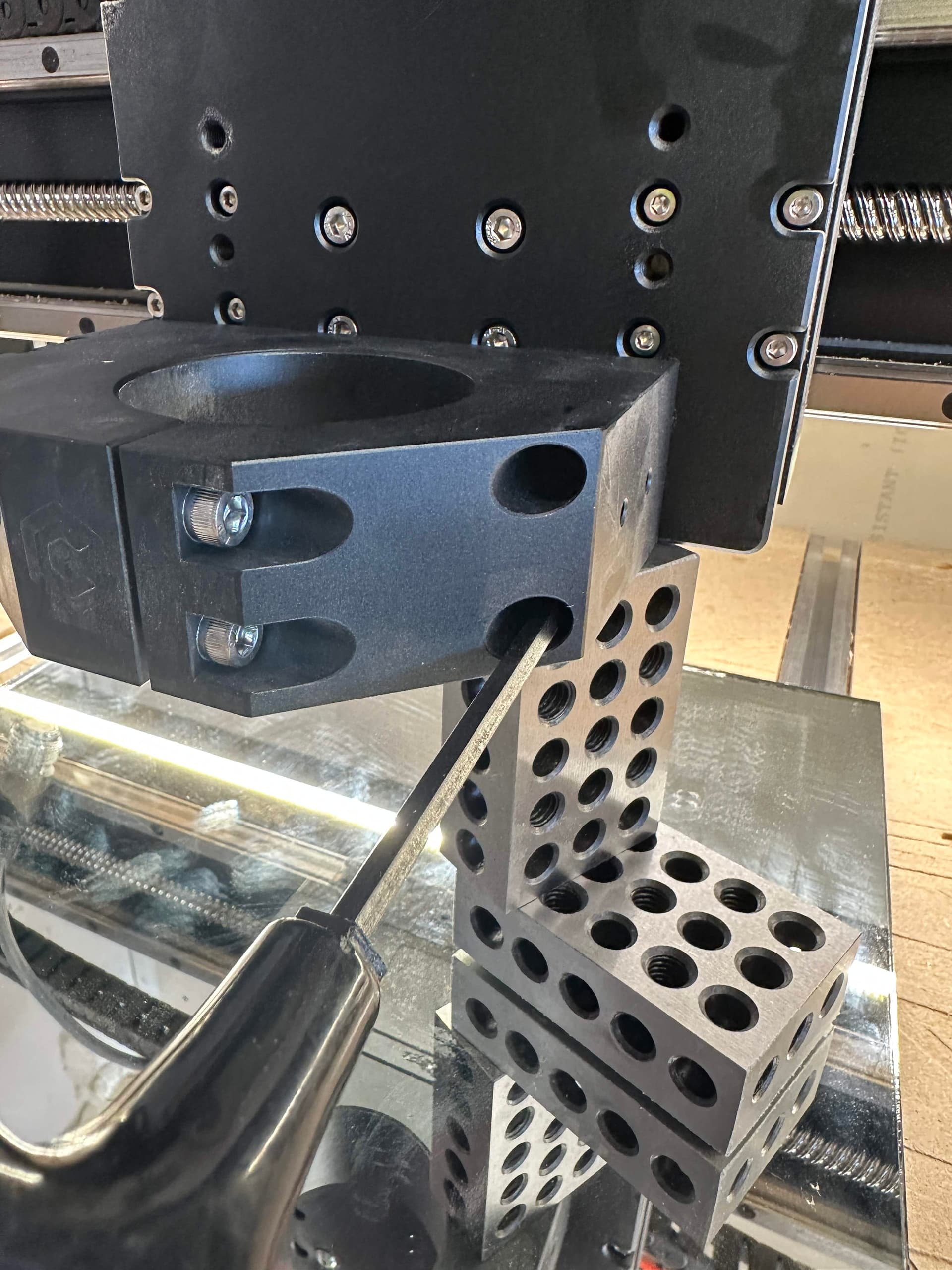

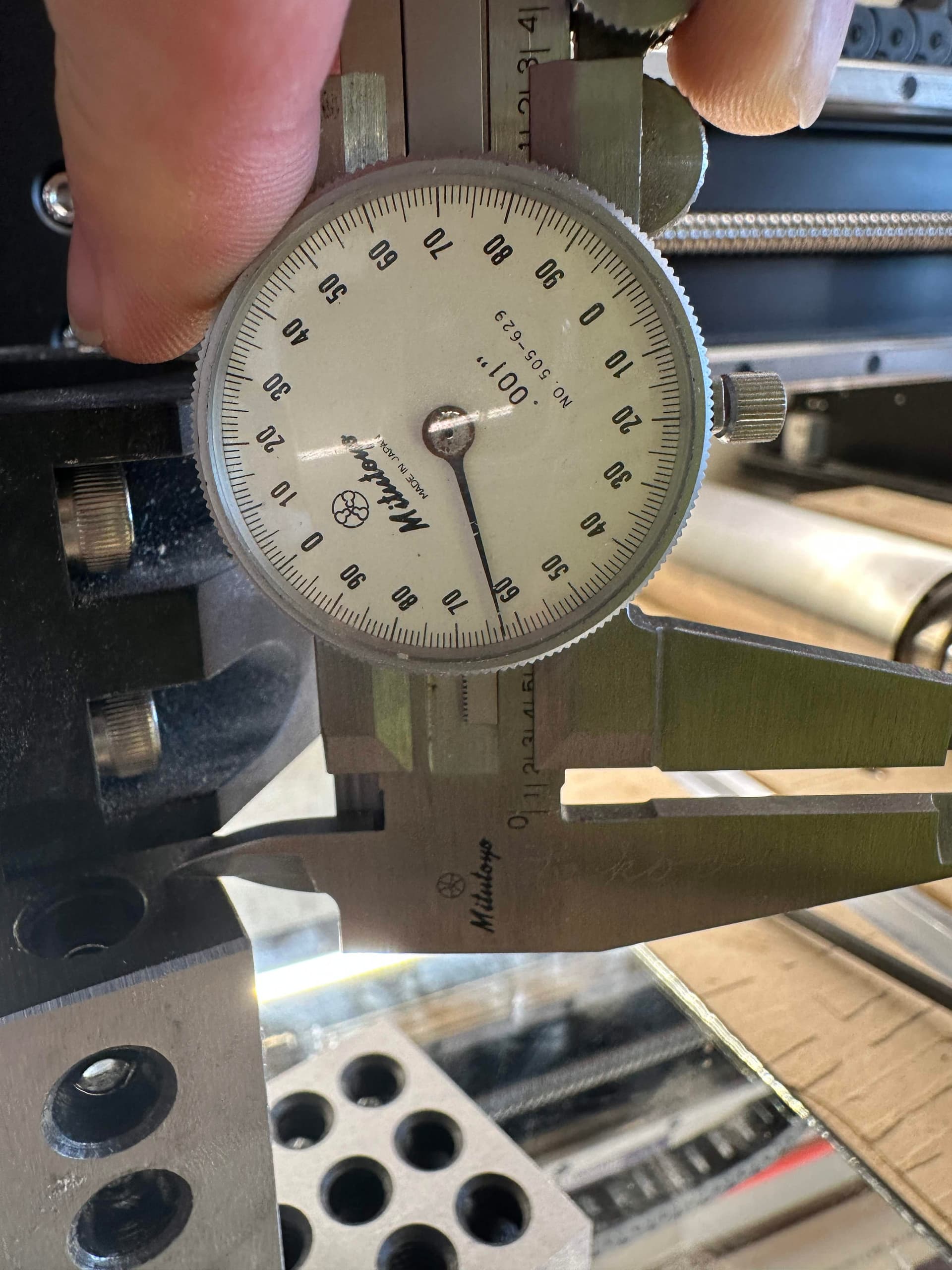

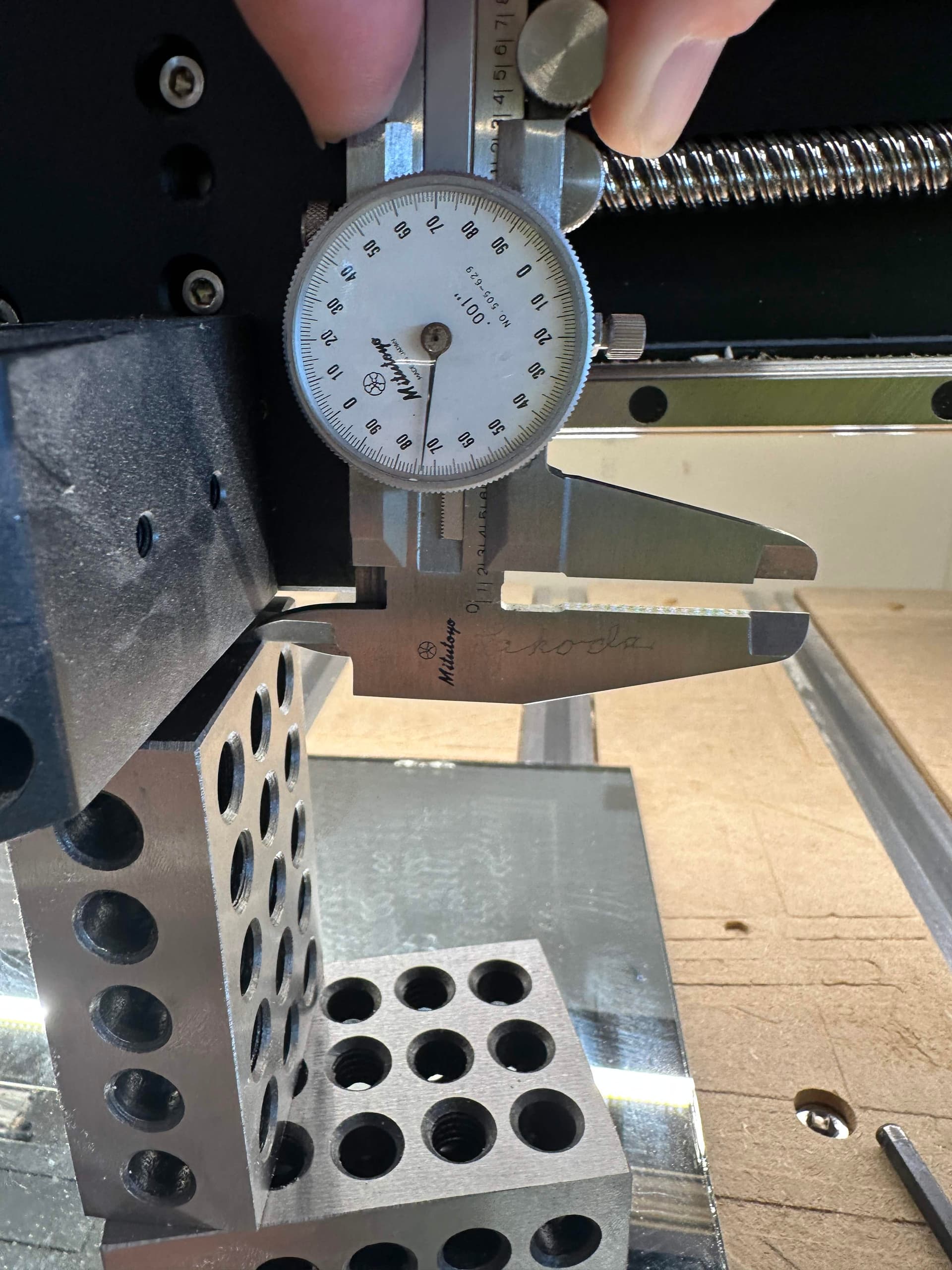

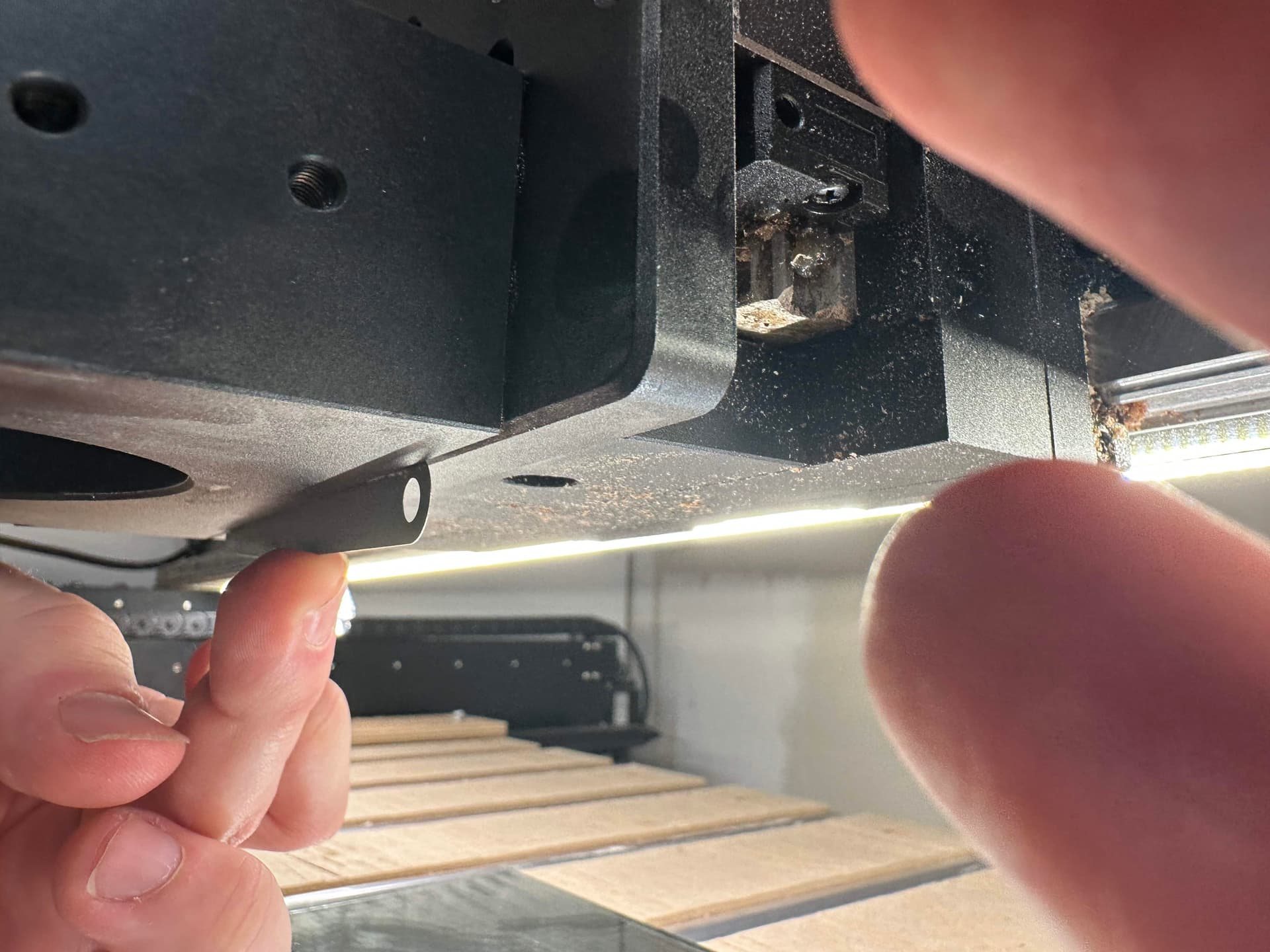

I put the glass down below the z-axis and put the two 1-2-3 blocks on it so that they would be tall enough to reach the axis when it was lowered. Next I lowered the z-axis so that the spindle holder was just above the two blocks but not touching because I wanted to measure the gap. At the front, I could measure a gap of ~0.165" and at the back I could measure ~0.175". So there was definitely some tilt involved.
In this case the spindle was leaning forward at the top as my wrench demonstrates.
Now that I know I’m not imagining things and there definitely is a tilt to the spindle, it’s time to actually do some fixing.
The first step was to very slowly lower the z-axis until the spindle mount was just resting on the 1-2-3 blocks. I put it to the smallest increment and brought it down bit-by-bit until the blocks could no longer move around underneath. If you have it set too high when you move it down, you’ll probably end up cracking the glass and/or getting the z-axis to jump steps.

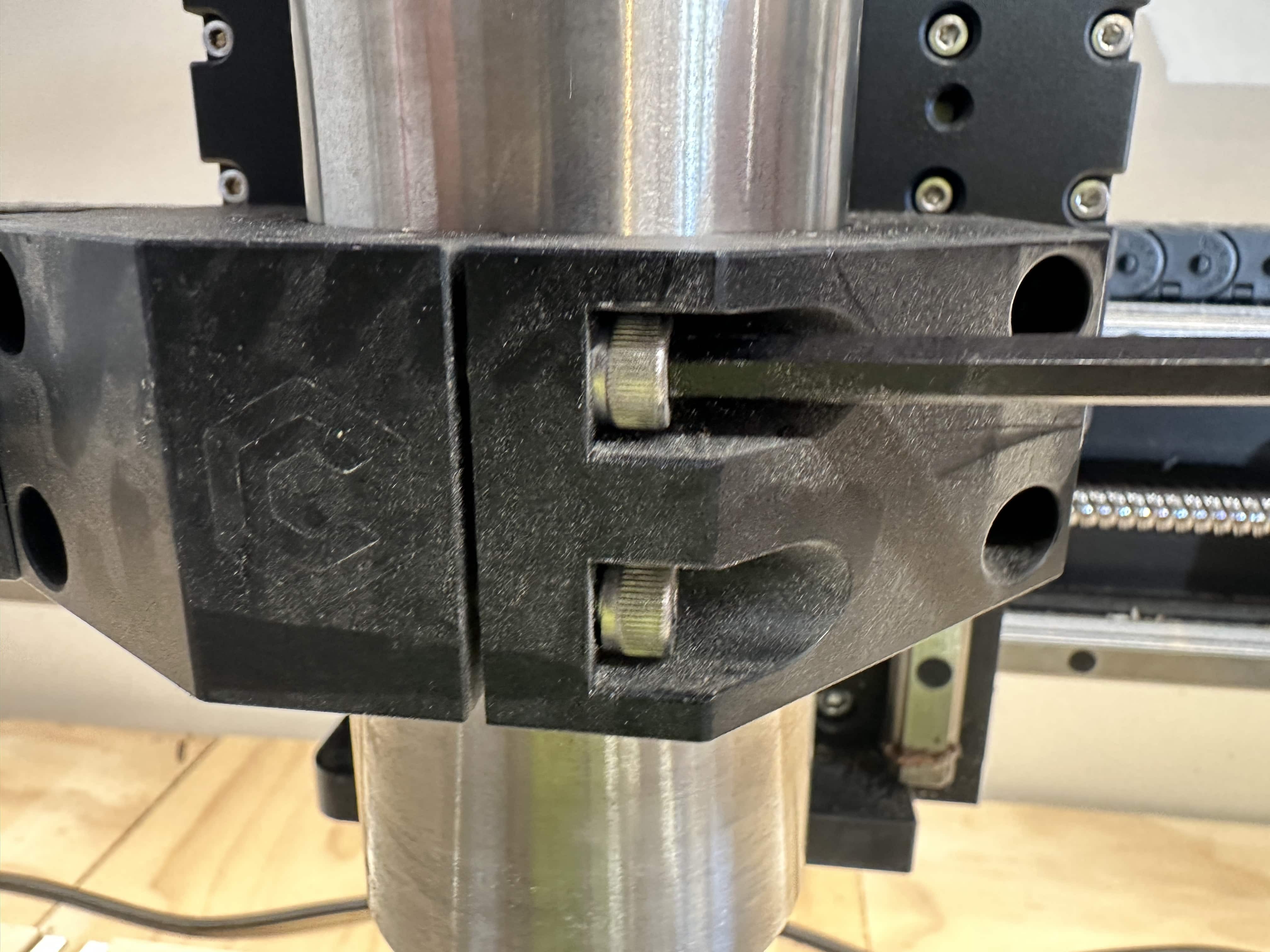

Next I loosened the four screws that connect the spindle mount to the rest of the z-axis.

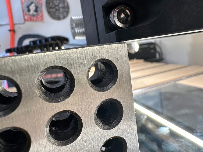

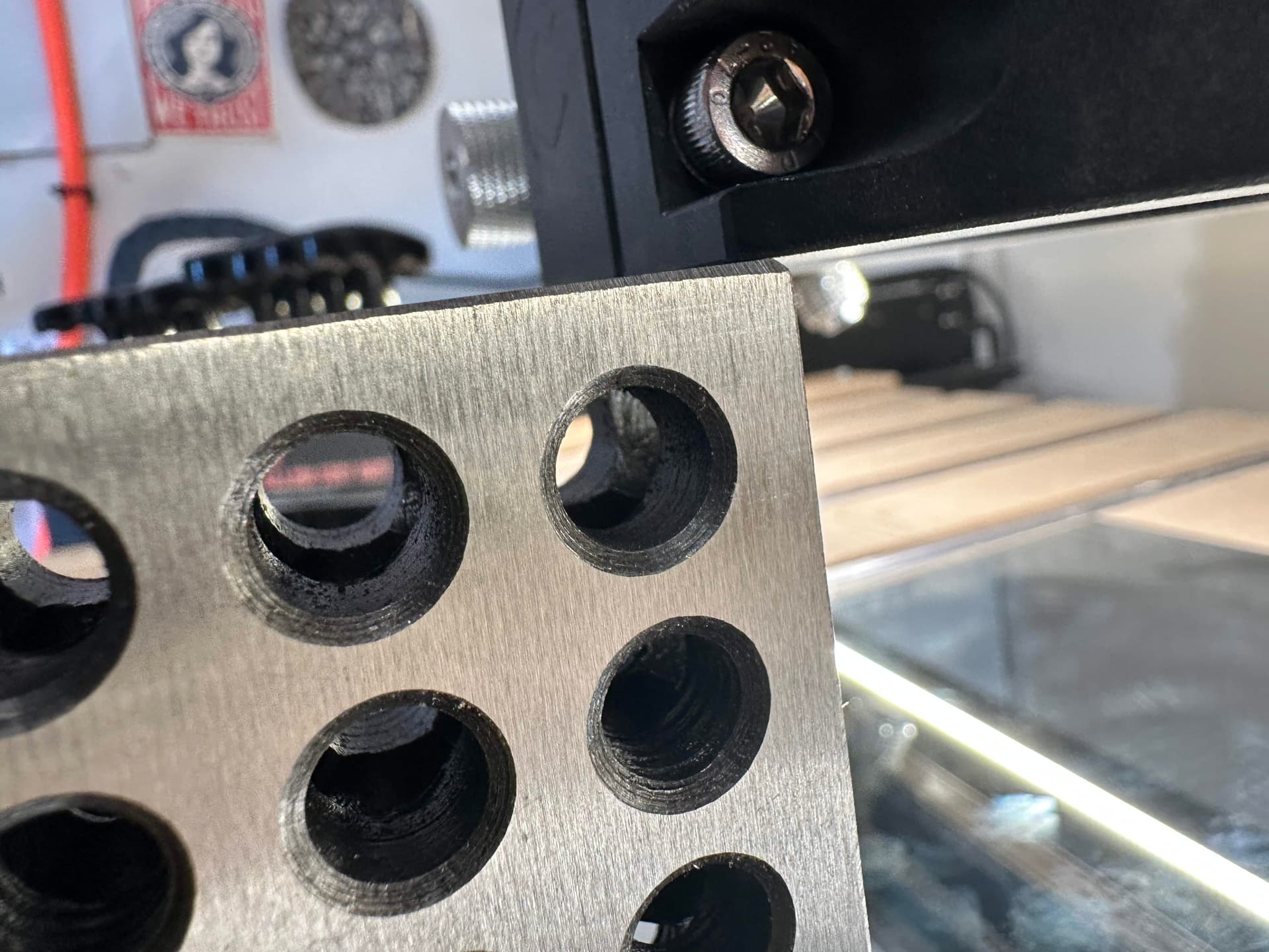

Once all four are loose, the spindle mount has quite a bit of play in it. This is important because even though my goal is to fix a front to back lean, I don’t want to have a side to side lean introduced as I’m tightening things back. Looking along the side, I can see that there’s a gap and it’s pretty clearly wider at the bottom than at the top.

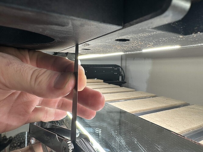

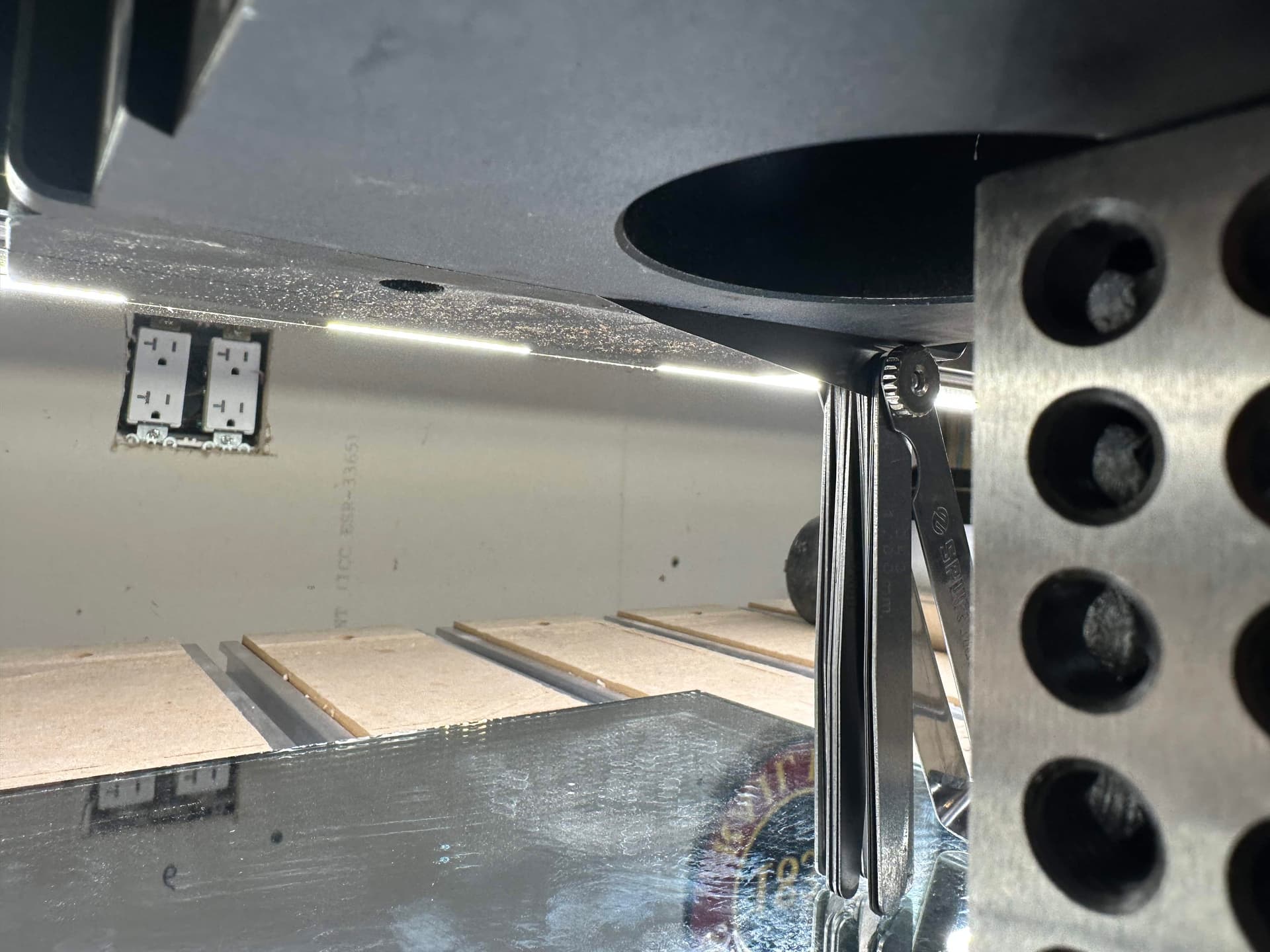

Now it’s time to fix that gap. With things in place, I took the feeler gauge set and tried to see what would fit into the gap. Starting with 0.5mm and working down to 0.3, 0.2, then 0.1 was able to get in but was definitely too lose. So I tried 0.15 which still felt loose, so then I tried 0.18. That seemed good.
After removing it from the set, I slid it lengthwise into the gap at the bottom. All the way in so it was completely hidden in the gap. Keep in mind that the farther into the gap the spacer goes, the more significant the impact will be. I didn’t want it hanging out of the bottom of the mount so I decided to have it fully hidden but you can leave it hanging halfway out if you need or want to.

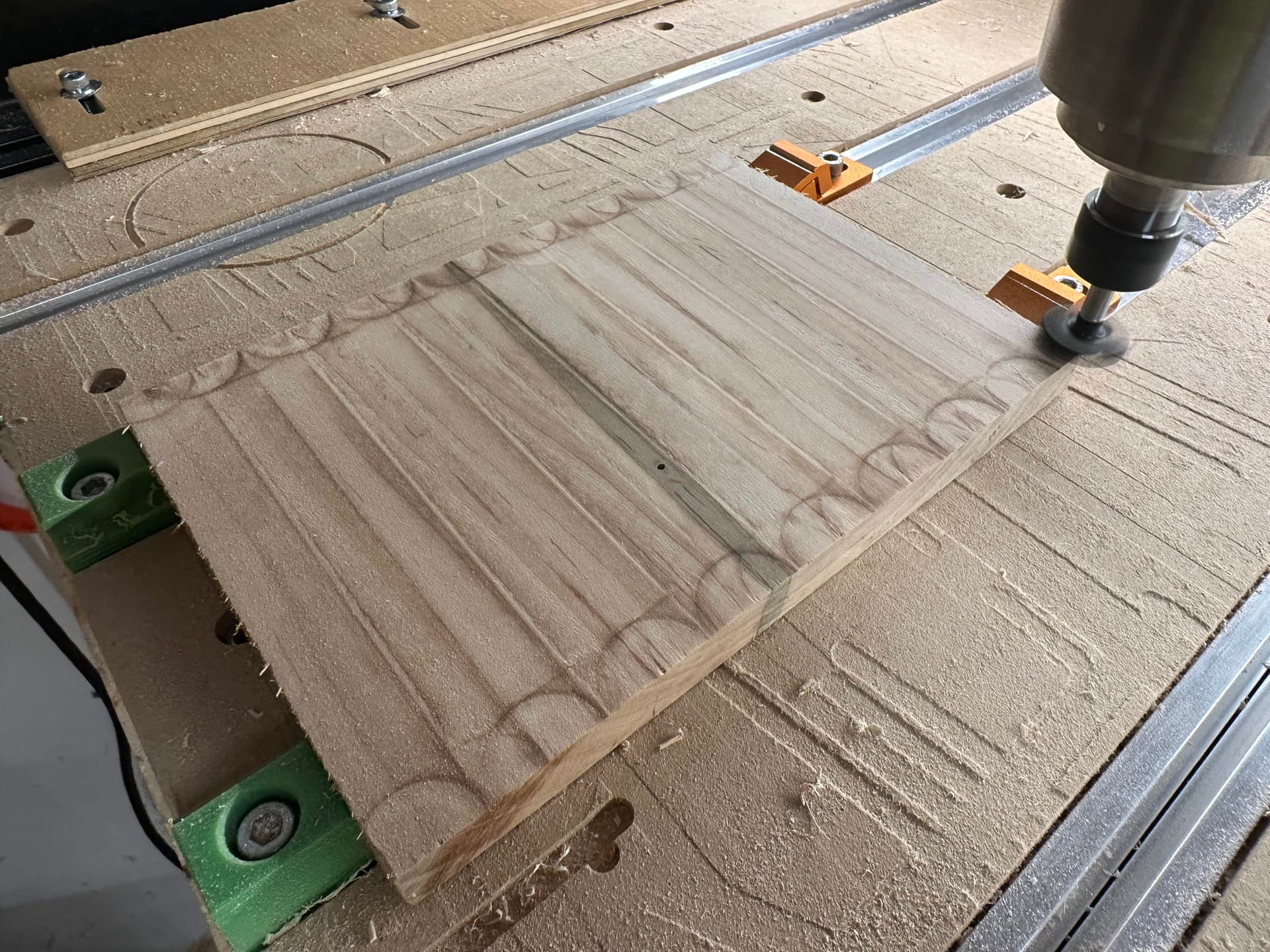

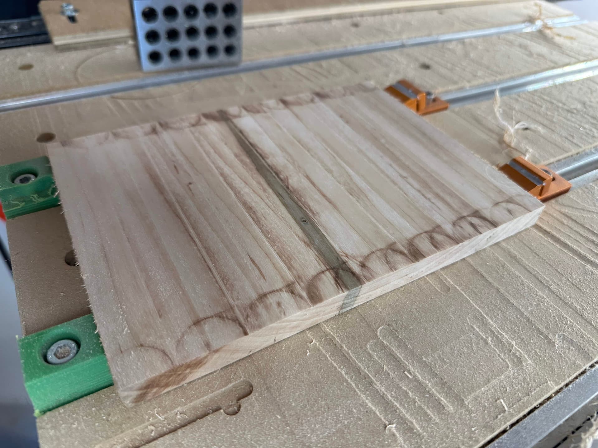

Now I got my test board and surfacing job set up. All of the normal steps to starting a project: measure the wood, create the toolpath, zero the head, etc. Initially I left the surfacing default set at a 50% stepover and I had it moving along the x-axis since that was the direction the spindle had been off-axis.

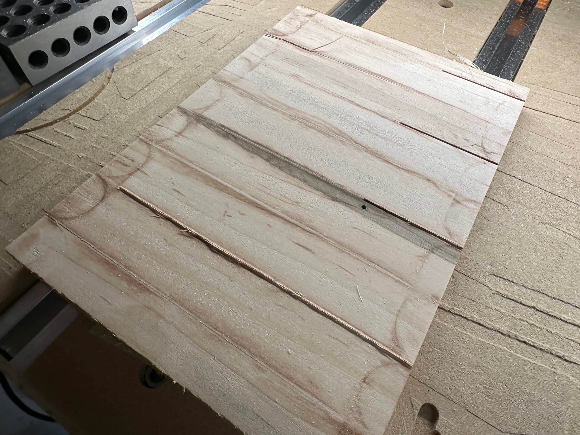

The result was definitely much better than the previous attempt but I could still see burning and feel a bit of a lip between passes. Also, I unintentionally made some decorative notches in my holddown clamps.
At this point, you’ll probably start a bit of a cycle. Based on the result of the surfacing test, check to see if you can figure out which way it might still need to be adjusted. In my case, I felt like it might have been adjusted too far and needed to be tilted down just a little. You’ll need to follow the steps until you get things the way you are happy with them:

For me, this meant that I went from a 0.18" to a 0.13" spacer. This time it felt like I went a little too far in the other direction.
So I tried a 0.15" spacer which was definitely the best so far, but still not perfect.
I would have loved to try a 0.16" spacer but the set I have didn’t have anything between 0.15 and 0.18. I thought about stacking two together, but decided that it was good enough. I also changed my job from a 50% stepover to a 100% stepover because I realized that the overlap would mean that there was less clarity about which direction the problem was really in.
There was still some burning, but it was pretty minimal and actually seemed to be happening on both sides of the pathway, so I decided to stop there.
As a test, I updated the surfacing toolpath to go 90 degrees for the angle. This way I could see if there was any visible tilt in the side-to-side direction.
Based on the results, I couldn’t see a clear angle that looked worse than the others so I decided this would work. I switched from clamps to double-sided tape because my board was getting thin so there could be some movement as the head is going over from some small amount of play in the tape or in the unevenness of the spoil board or something.

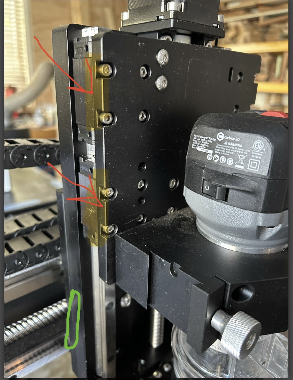

Any thoughts about shimming between the vertical plate and the linear rail bushings vs the spindle / router bracket to the vertical plate?
In my case, the y-z plane is just about perfect. I just need to adjust x-z.

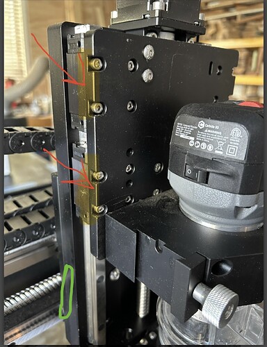

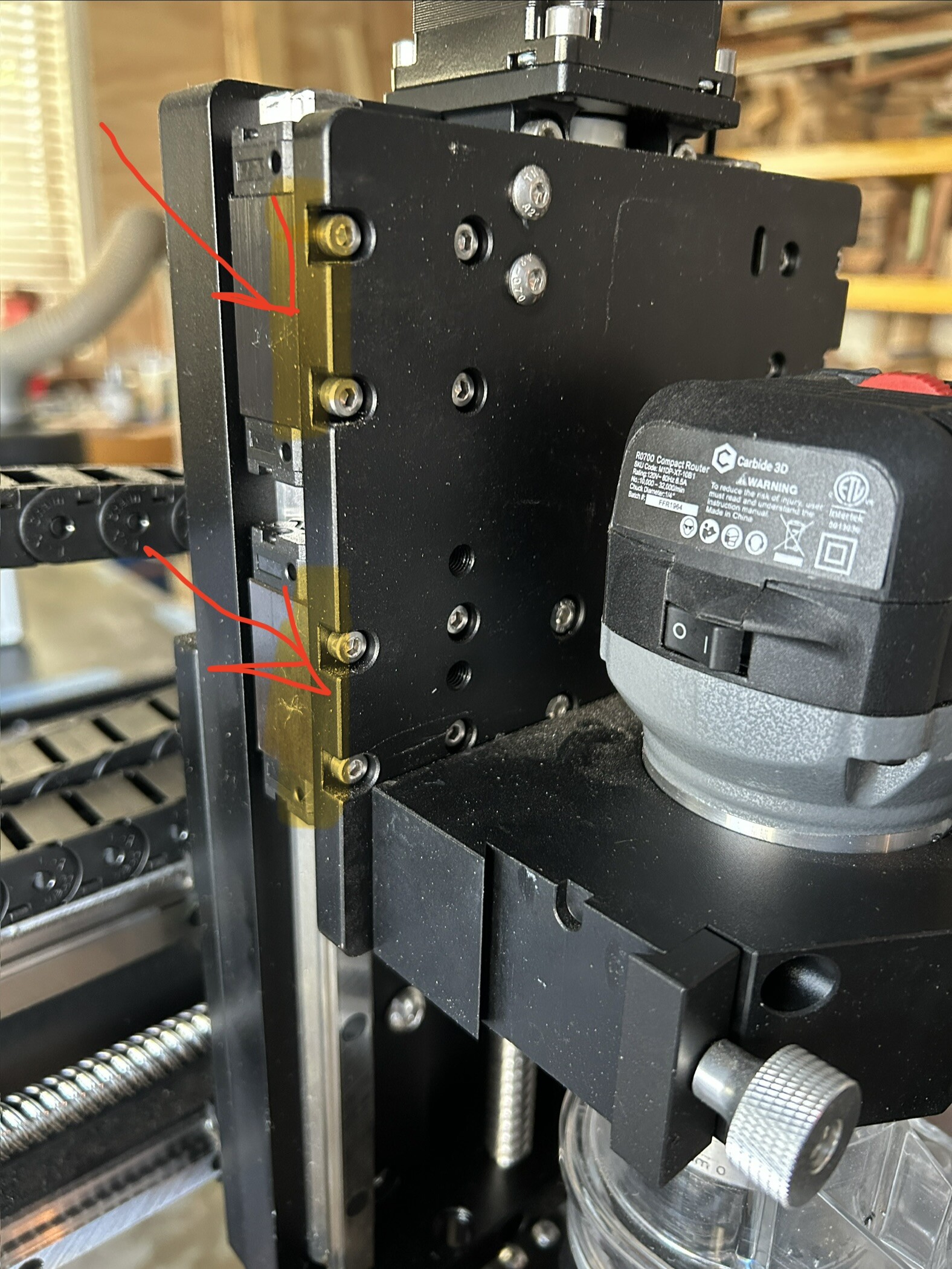

I marked up this pic to show what I’m thinking about and would be grateful for your thoughts. Thank you!
I’m having a hard time visualizing what plane you’re referring to when you say you need to adjust the x-z, but based on your picture adding shims to those both would definitely be possible. My personal take on it would be not to mess with those, though.
  1. There are 2 unconnected points represented that you would need to add equal spacers to if you want them both to be shifted the same amount
  2. There are 4 screws per linear rail slider so more parts to adjust that could potentially affect your alignment
  3. I don’t know if or how the spacers might interact with the two sliders that could cause uneven alignment between the two. As in, if one spacer isn’t quite aligned in some way with the other, it could potentially cause there to be a mismatch when you tighten down the screws.
My approach would be to focus on the clamp holding your spindle/router in place. There are 4 screws total which makes it easier to make adjustements once you have everything how you like it.
I realize that loosening the 4 screws on that clamp will likely disrupt your alignment in every direction which would necessitate checking level in each direction, but it’s a single, large block of metal with plenty of surface area to put a spacer behind in whatever placement is needed for your need. The perfect solution would be if the carriage had some kind of built-in tramming ability, but working with what we have available, I think focusing on the spindle/router clamp is the most straightforward approach that will cause the least disruption to the rest of your machine’s alignment.

Sorry for not being more clear. I was exploring where to shim and noticed an opportunity to put shims in a location other than the between the spindle/router bracket. That is what I was trying to flag in the markup. My worry was like you said, once I bust loose the 4 bolts that hold that spindle/router bracket to the vertical plate, I will go out of alignment in all directions.
In the picture I posted, I would only add shims to the left and right top or left and right bottom to fix my problem. In my case, the top of my router is sticking out toward me (when standing in from of the machine).
You raise good points about adding additional slop to the system if I mess with the linear rail connection(s) to the z plate. I will focus my attention on adding shims behind the spindle/router bracket.

I shim between the back 2 plates as shown with the green circle in this image.
