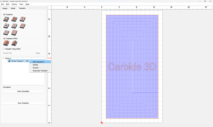

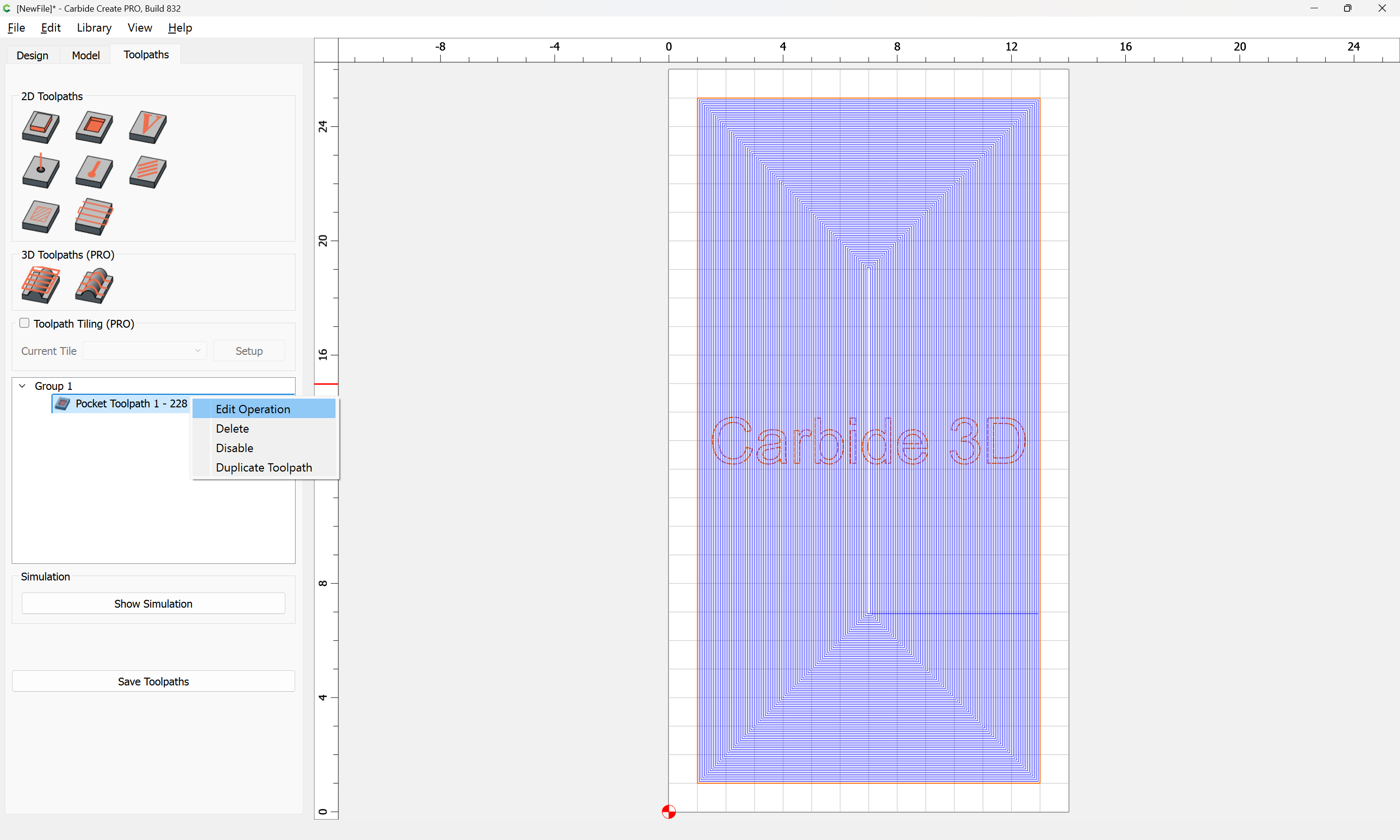

You can select all the vectors you want cut and then right click on and duplicate the existing toolpath. “Use current selection” then “OK”
Disable or delete original toolpath.

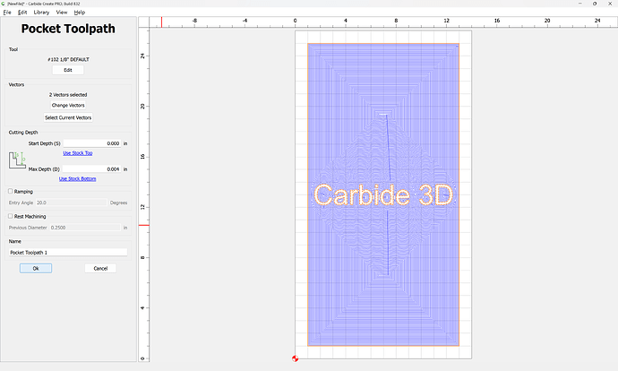

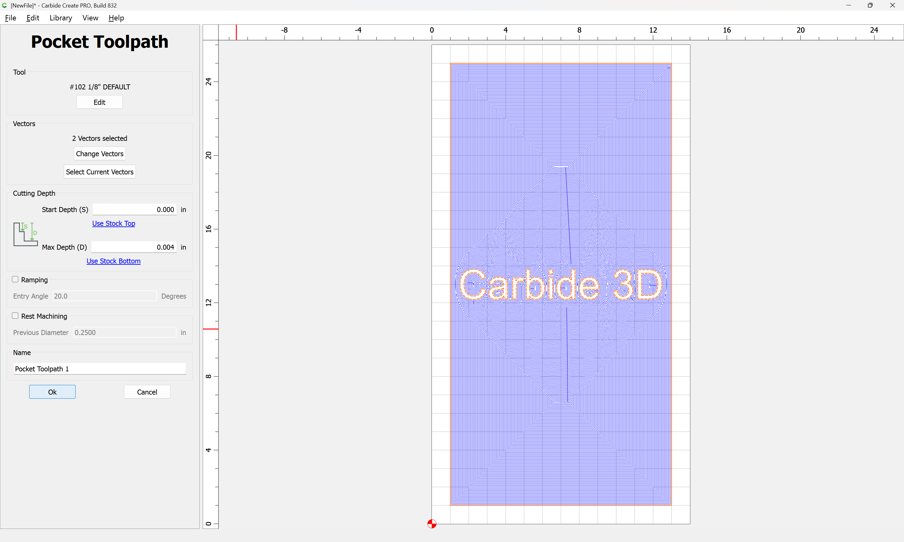

Edit the toolpath:
click “Select Current Vectors” | OK
shift-click on the item you wish to add:
Edit the toolpath:
click “Change Vectors”
“Use Current Selection”
OK
