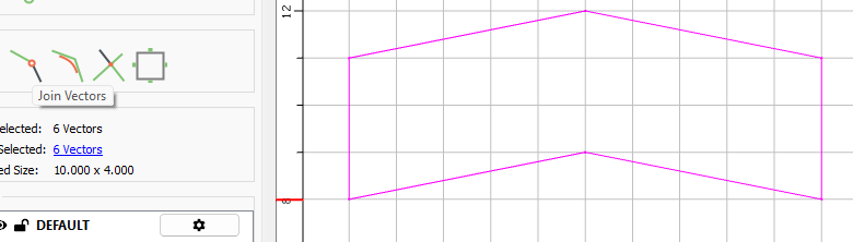

I’m new to CC (migrating from Easel) . I used the Polyline tool to draw a chevron shaped object. It works, but the G-Code generated is cutting each side (of 6) fully before moving to the next side. It’s taking forever to cut. Any suggestions?

Are they 6 separate lines, not joined (Pink / Magenta)? If so, join them.
Yep, I had grouped them but not joined them. Makes perfect sense. I’ll do a simulation and see how it works. Thanks much.
