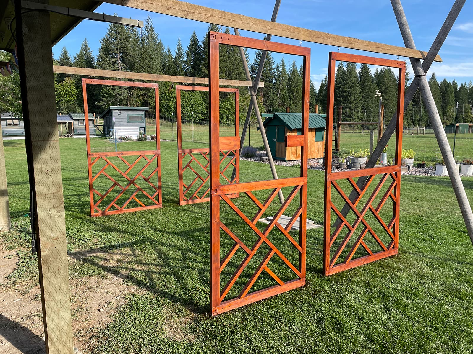

I use it for blowing sawdust around, running my sprayer for paint/finishes, filling tires, soda blasting and even blow out my irrigation for the winter. It’s a bit more quit than my smaller compressors. I would say it’s on par with the noise from my dust collection. I pull it around all over the property so the mobility is nice as well. At just under $400 I’ve been quite happy with it.
I was able to spray all 4 gates with oil finish with only 3-4 run cycles on the compressor. There was quite a bit of spraying with all the wonky angles/nooks & crannies.
