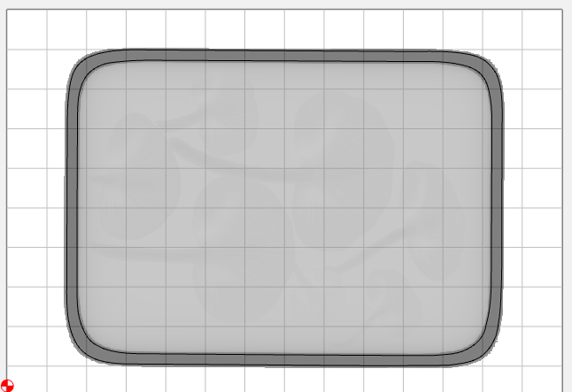

If you right-click on the 3D component, you can select Create Outline Vectors
You might have to play around with the Height Threshold value, but it usually works at 0.0 to get the outermost outline.
I believe I did try that option to Create Outline Vectors but it did not show the actual outline vector so I presumed it did not work. Is it supposed to show an outline vector like an offset vector?

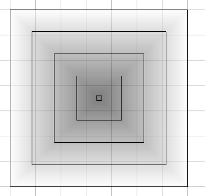

It’s more of a horizontal section through the solid component. Here’s one I just did. I had to increase the Height for the section, or it would only get the outside vector

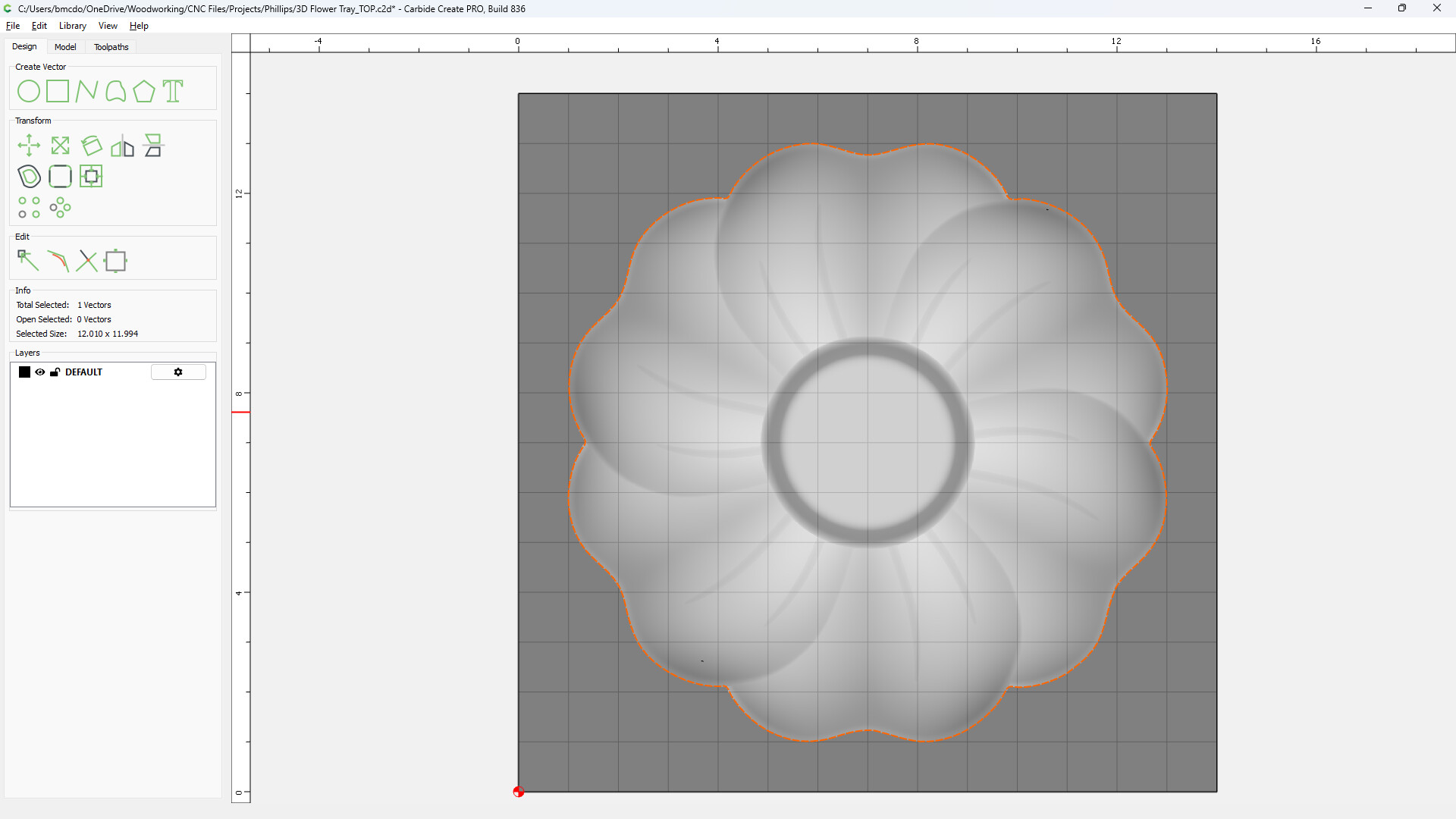

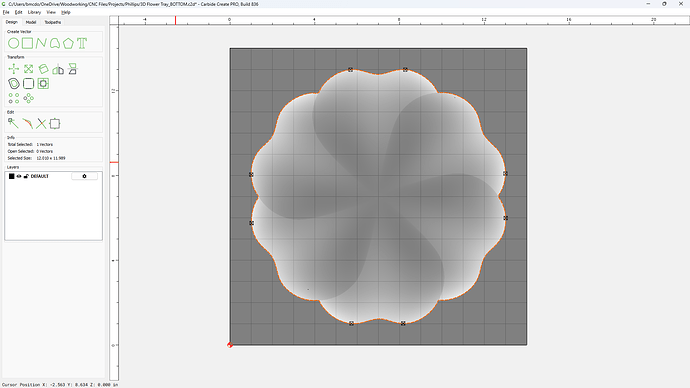

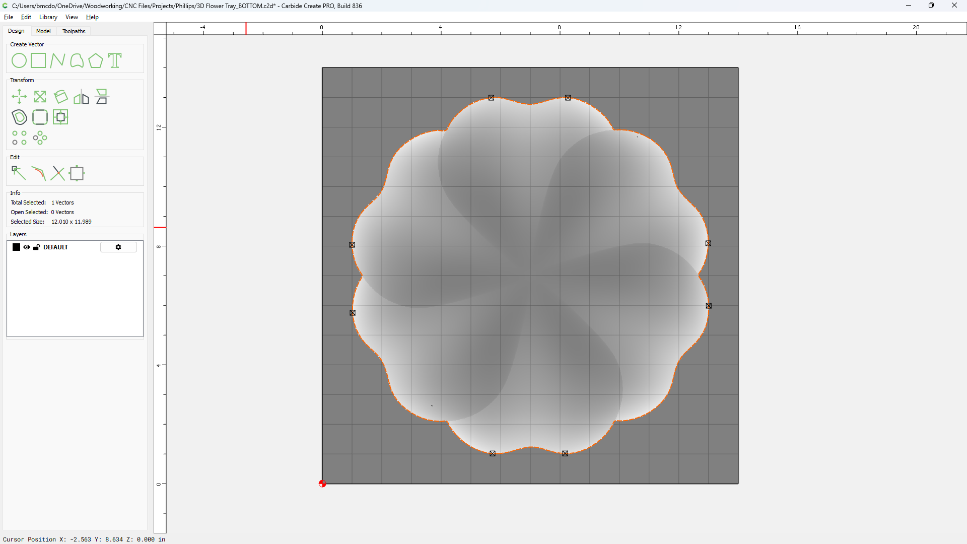

This is the bottom side of the 3d tray I am working with and I added the outline vector with a height of 0.0 to cut the outer profile after the carve is completed.
That sounds correct. If you have the top shape as STL, it will import as Top & Bottom views with the outer edges / silhouettes projected down the base level. So either one traced at 0.0 will give you the outermost boundary, or parting line. You can see this when you “Show 3D”
