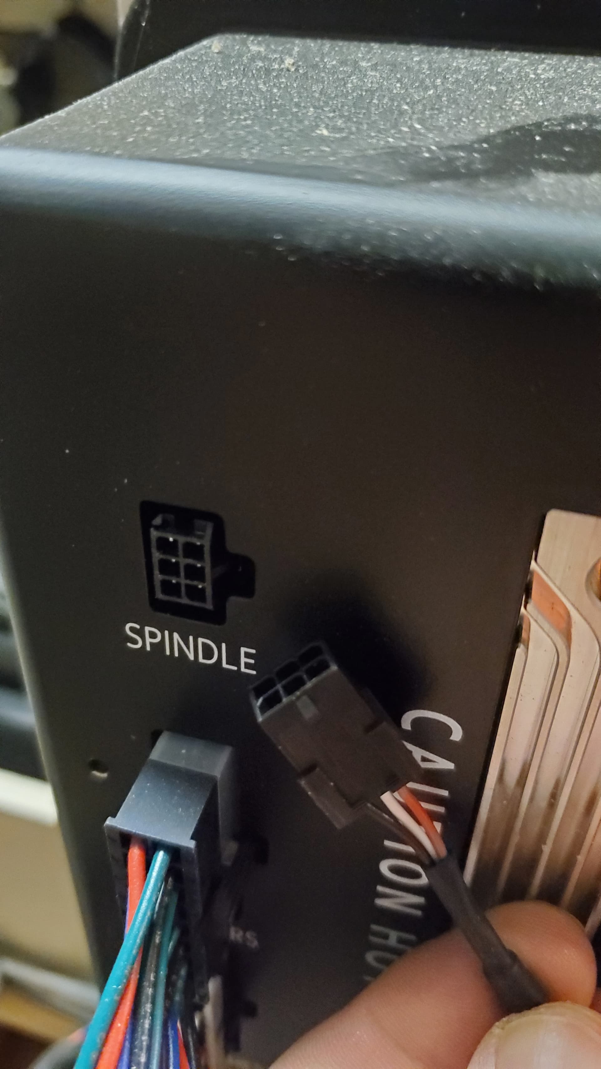

Just received and trying to connect my new Carbide 3D VFD Spindle. How can I connect that cable? Do I have the wrong cable?
Shapeoko 5 Pro 2x2

And there is no book for the control box? Normal? What do I do with all the button on the control box?
There should be an adapter cable in with your SO5 Pro to make up this connection. Let us know if you didn’t get it.
E-mail us at support@carbide3d.com if you have any questions and we will do our best to assist — that said, mostly it shouldn’t be necessary to fiddle with the buttons.
Bingo, yes i got it. I completly forgot i had that cable.
Thank you.
