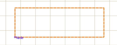

How to copy a structure matching precisely over each other?
How can I copy two structures above each other matching one or two corner points or other matching structures, e.g. in different layers?
If you grab the object you are moving by a Node, then it will ‘snap’ to nodes in the other object. Once the object is selected, nodes in that object should be highlighted as the pointer nears them.
Click to grab the object at the node, and it will now ‘snap’ to nodes on other objects.

I usually do this by designing things so that they are symmetrical and a common center will work for grouping and aligning.
Yep, I used a common corner if they were not symmetric. Needs some more clicks than using a node.
