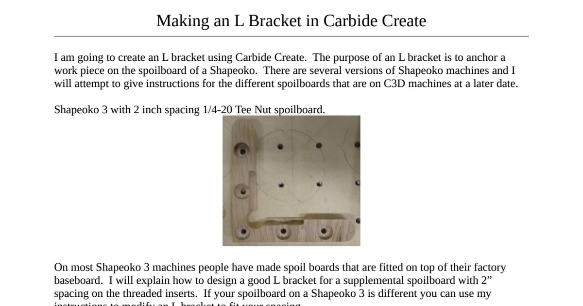

How to Create an L Bracket in Carbide Create
Attached is a pdf with the instructions on how to
make this L bracket. The L bracket accommodates the BitZero V1 but I give you the full instructions to make the L bracket in a different size, spacing and for a BitZero V2.
You can see in the picture above why I needed a new L bracket. Cannot remember what happened but something went wrong and cut into my old L bracket.
The PDF instructions are too big for the forum so here is a link to google drive that should be available to anyone that clicks on the link.
The purpose of the pdf is a how to build an L bracket in Carbide Create. This is geared toward people that dont have a lot of experience in Carbide Create. I think the L bracket is useful for placing material on your spoilboard that is square and secure.
