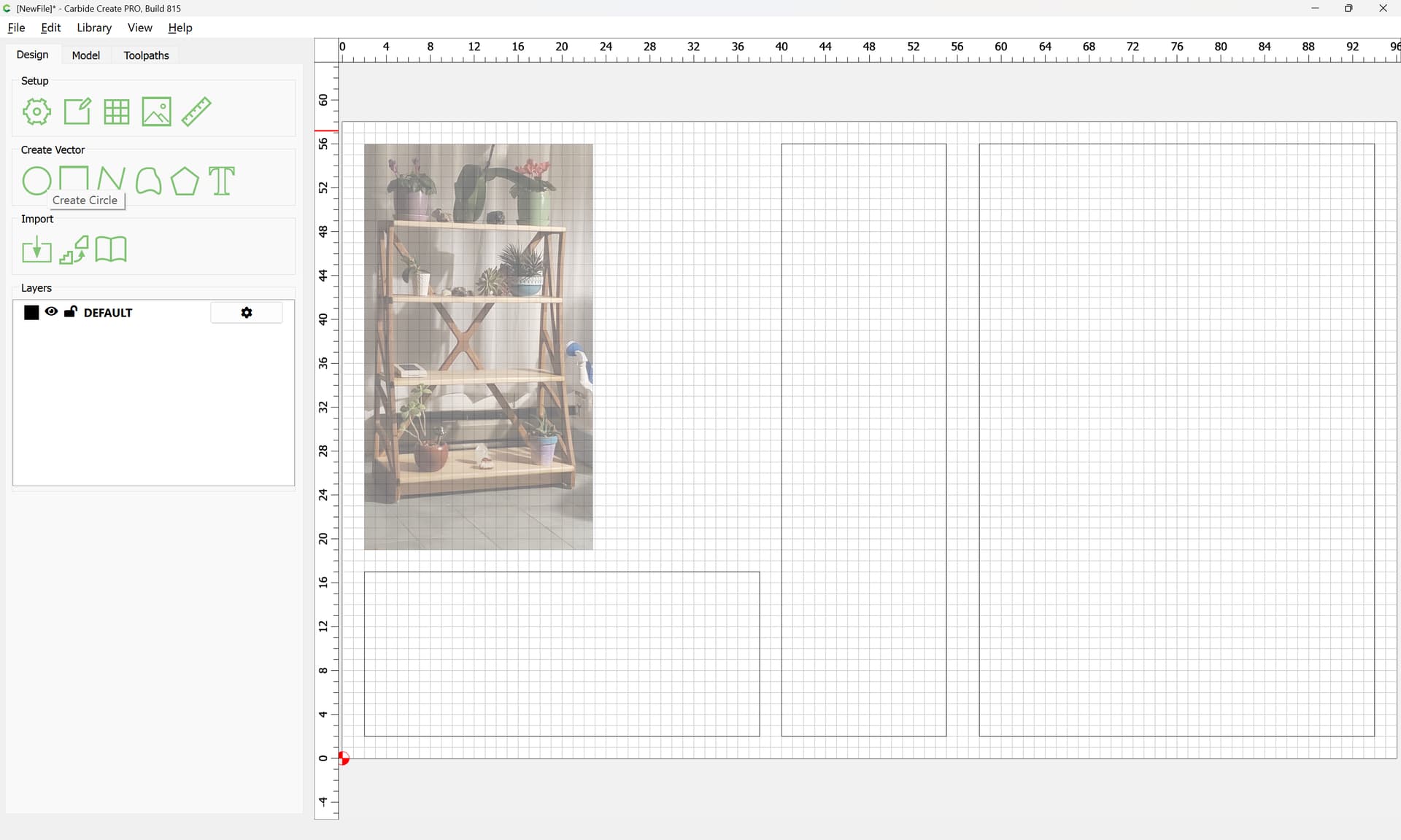

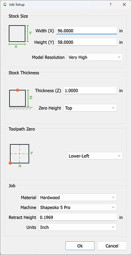

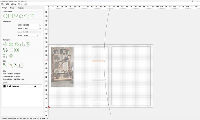

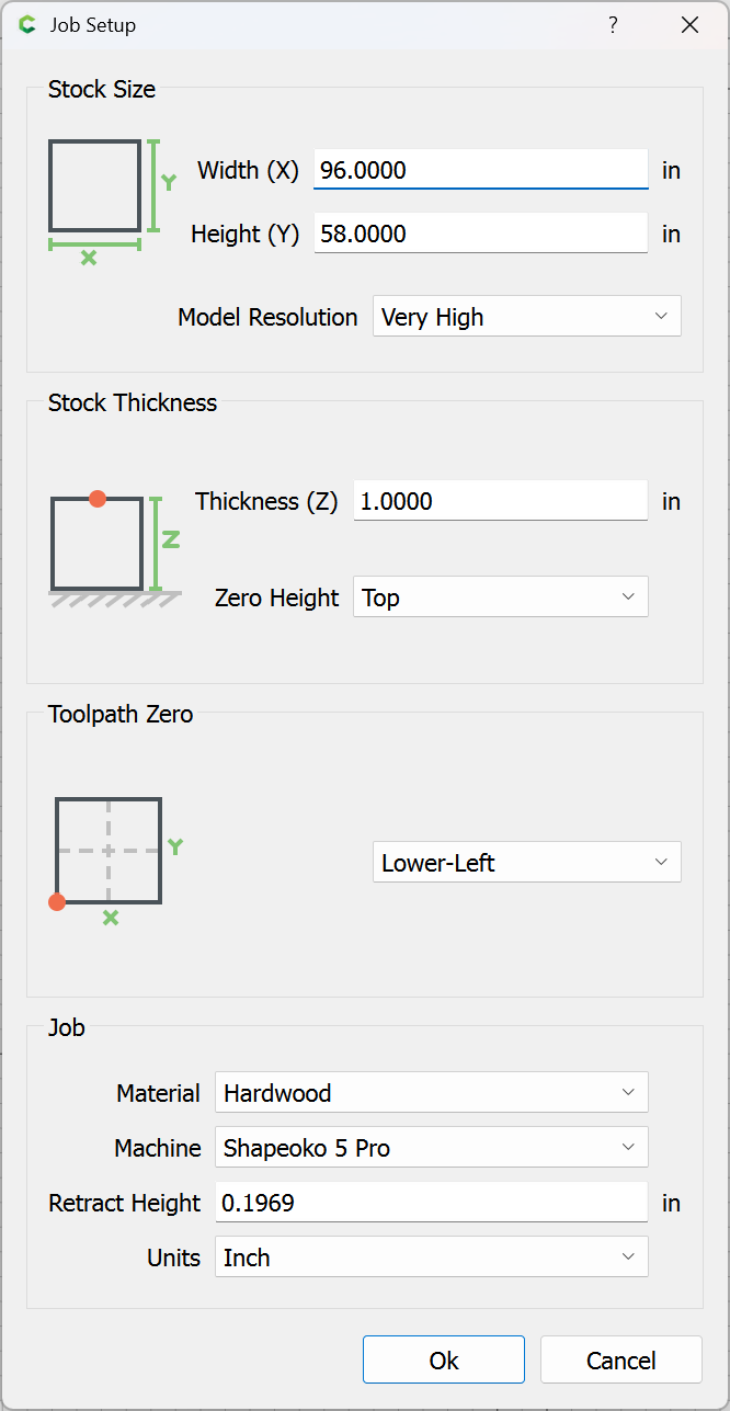

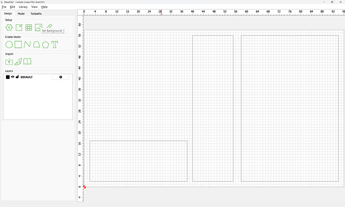

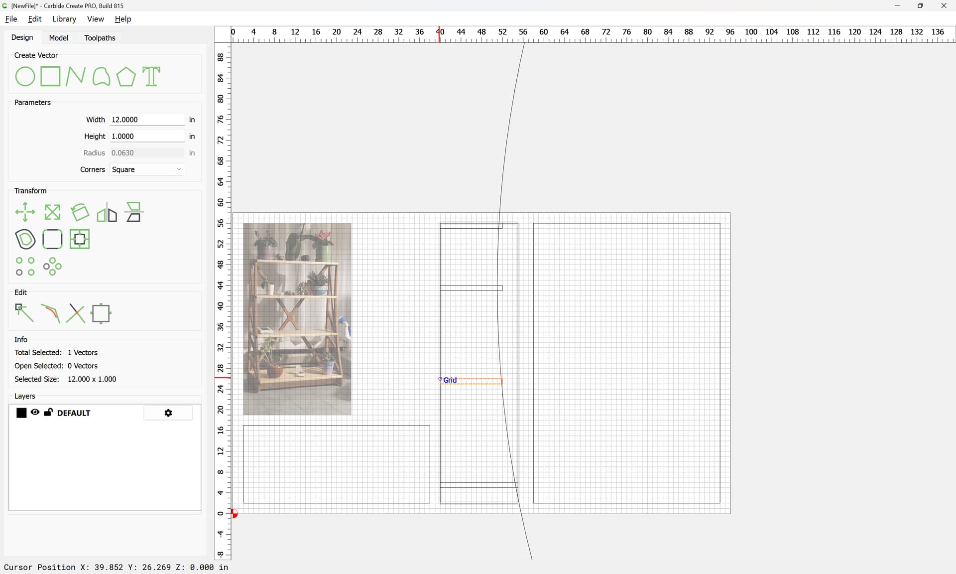

Estimating from the tiles being 12" x 12" the overall proportions look to be 36" wide (X), 54" tall (Z), 15" deep (Y), so we start by making a Carbide Create file comfortably larger than that:

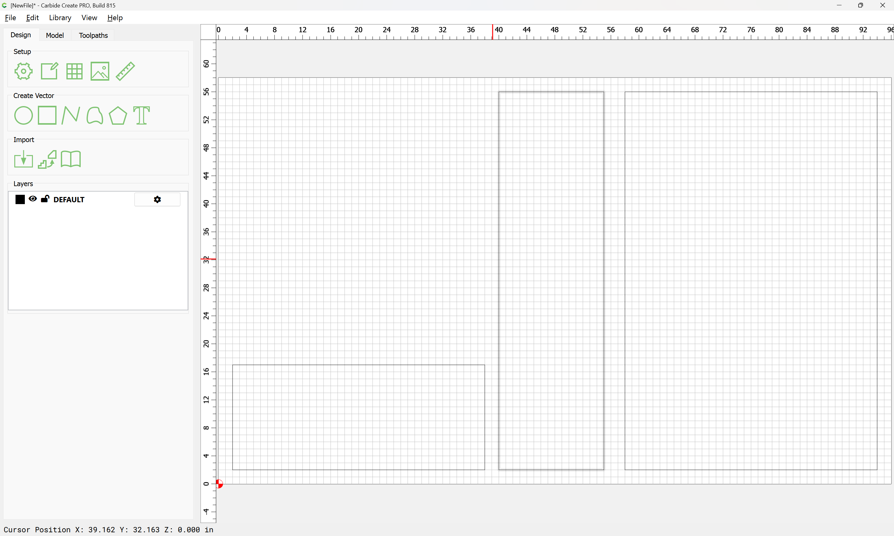

and then we draw in the views:
and then begin drawing in the various rectangles and arcs/circles which define the shapes in question…

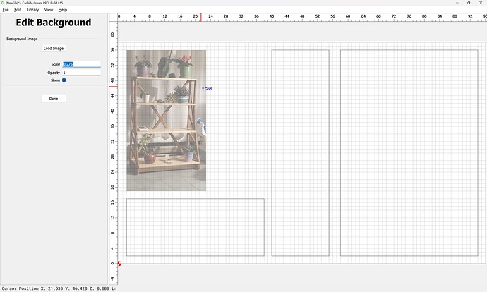

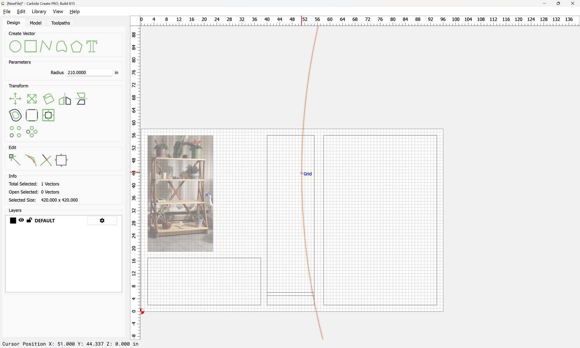

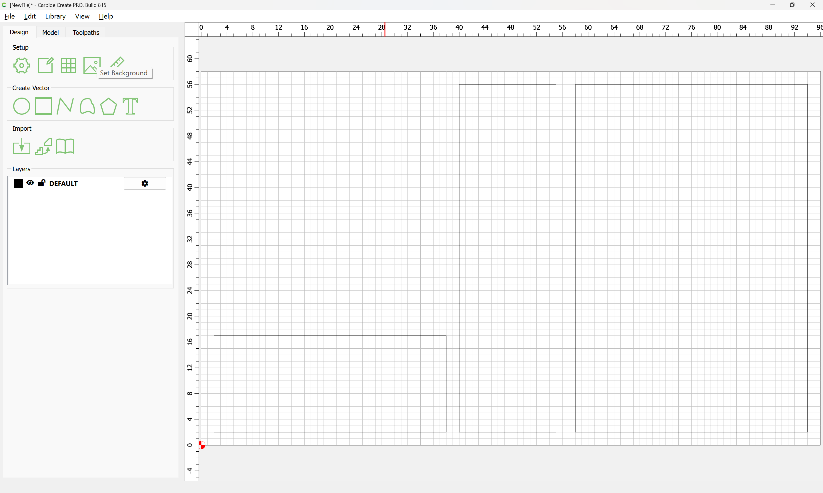

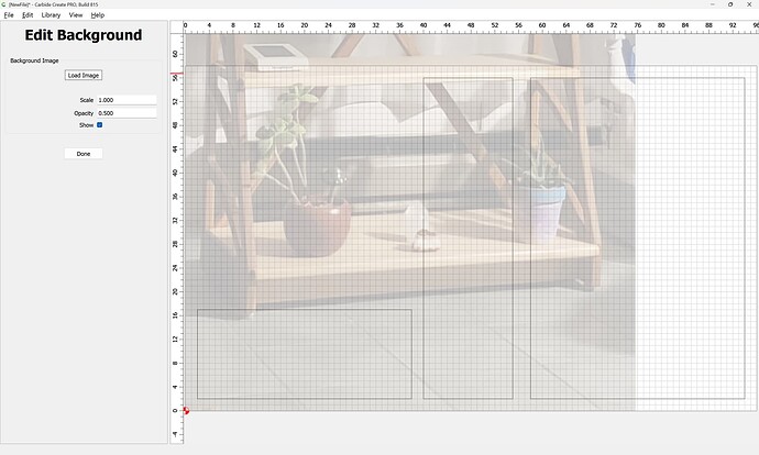

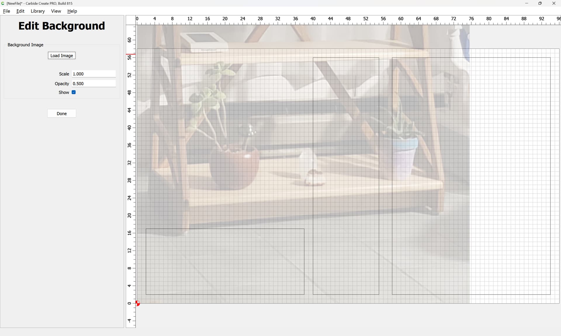

In doing so, it will be helpful to have the image to refer to — since multiple monitor setups are not universal, and we have the space:
Set Background and Load Image:
and adjust as described at:
https://carbide3d.com/hub/courses/create/importing-images/
Done

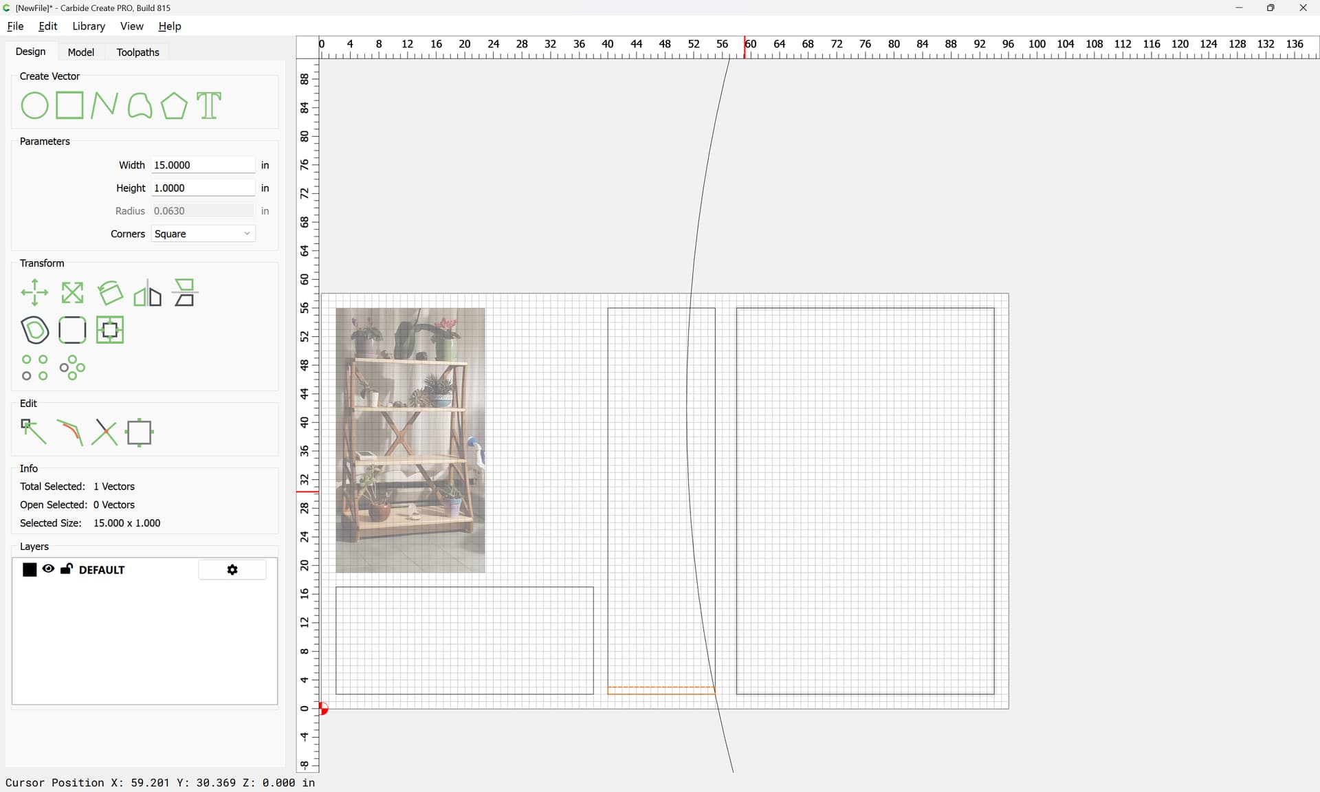

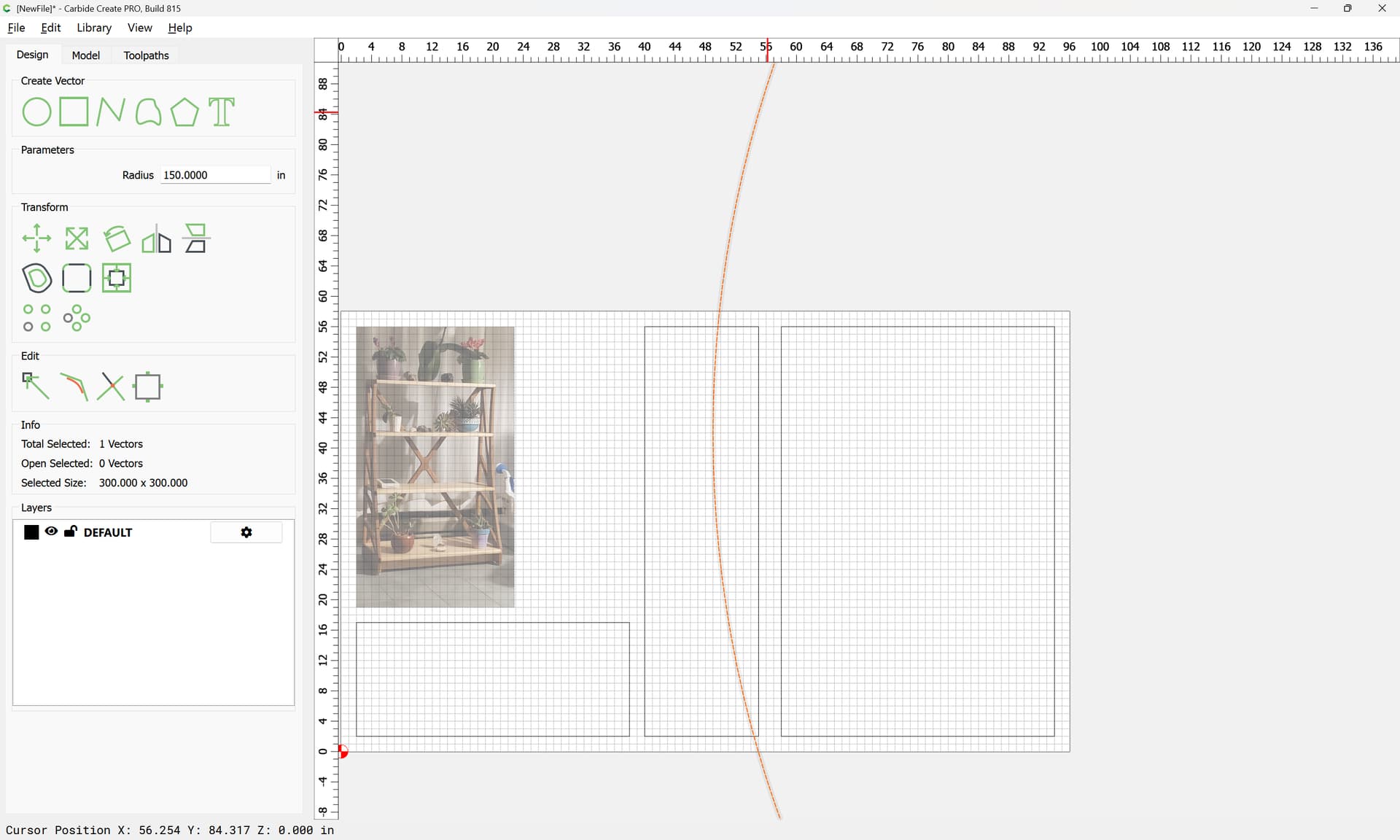

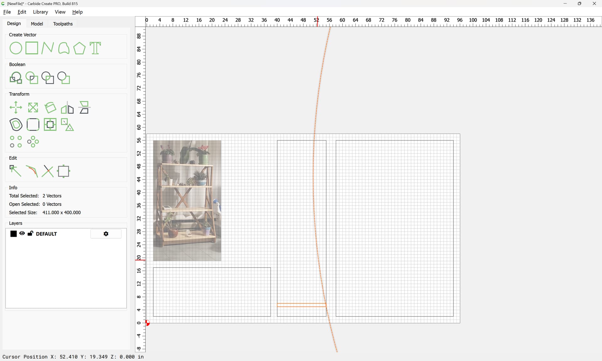

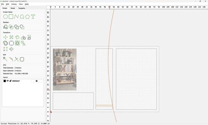

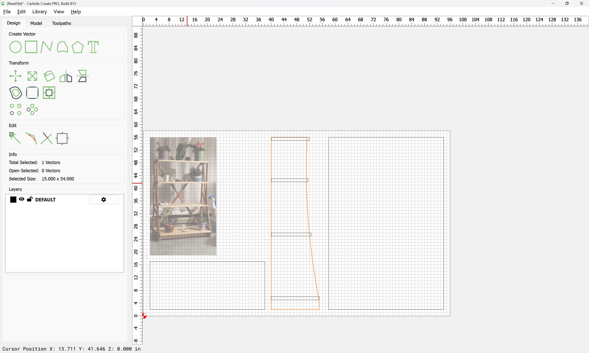

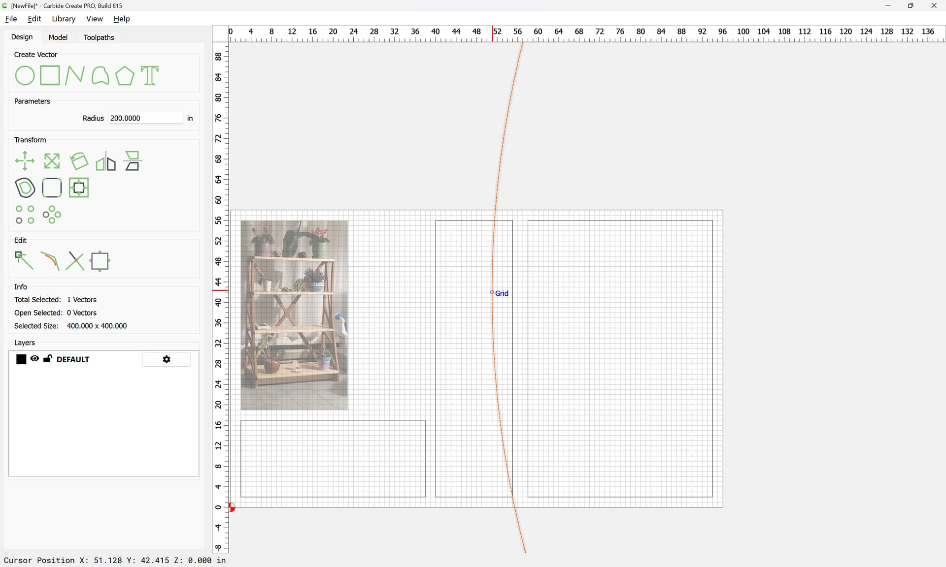

The defining characteristic is the curve at the front, so we draw that in:
iterating until we arrive at something which seems reasonable and pleasing:

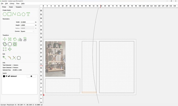

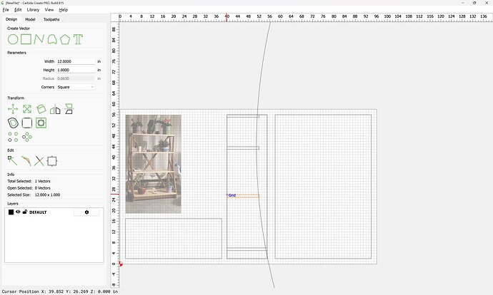

Then draw in the shelves:
and adjust for the kickplate at the bottom:
and for the fact that the shelf protrudes past the curve:

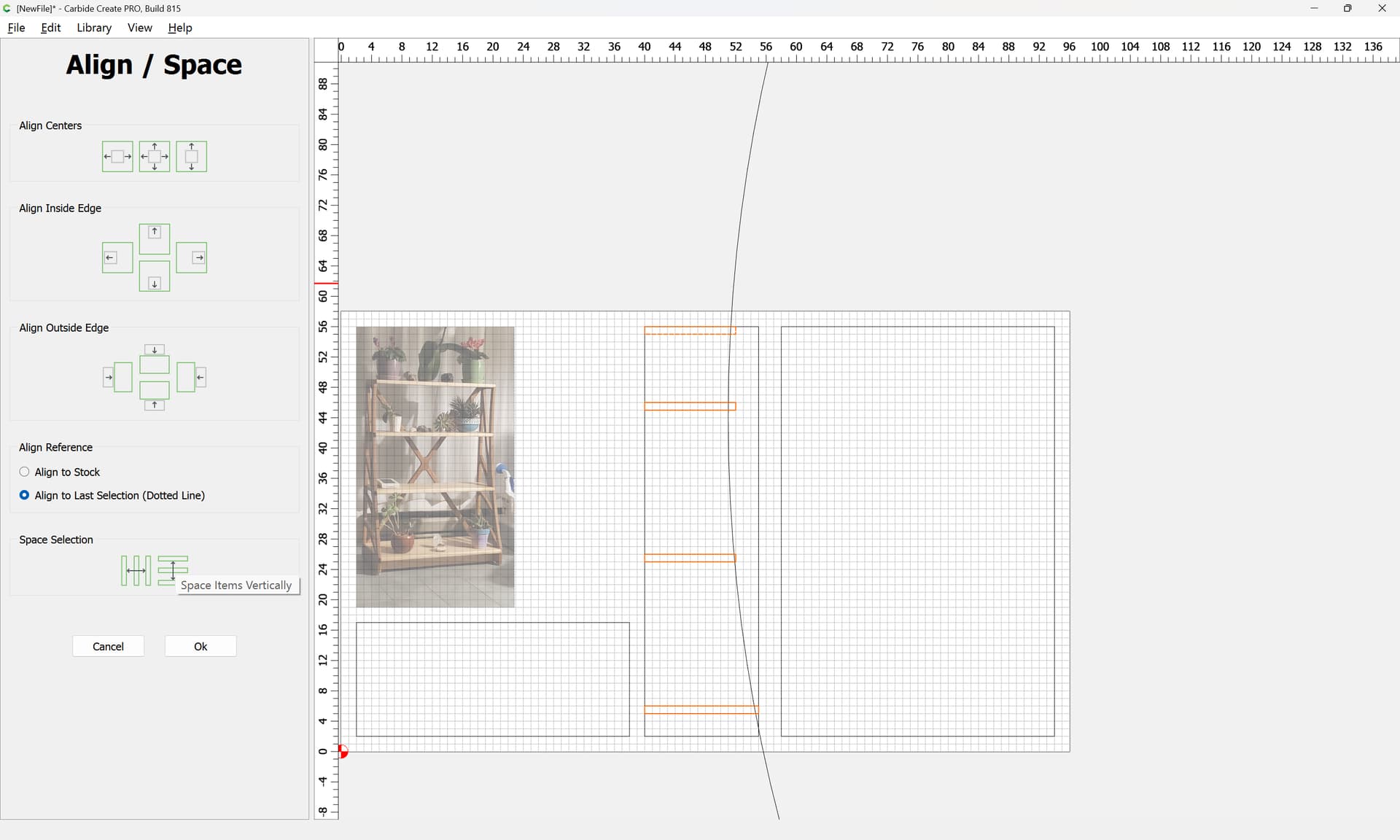

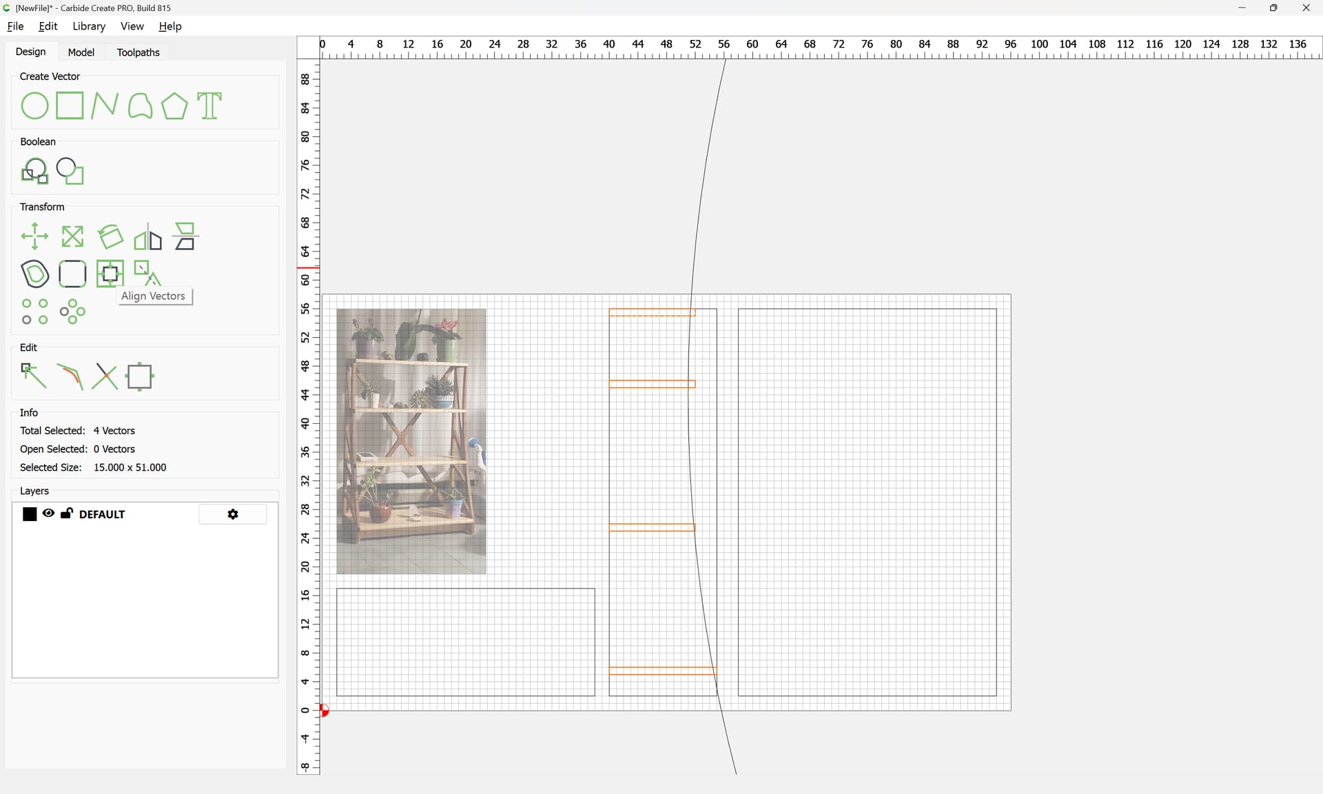

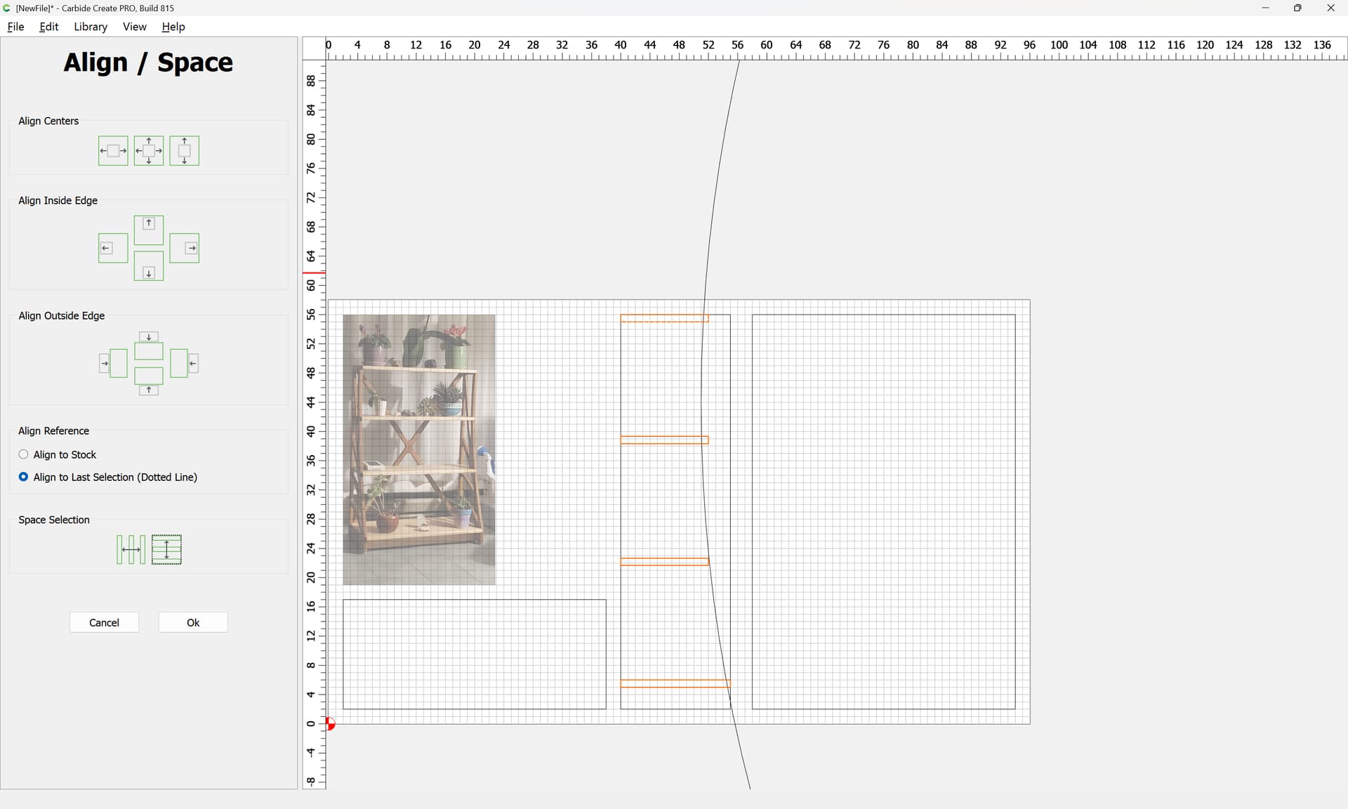

Roughly placing the initial shelves:
Align Vectors:
and Space Items Vertically for an initial even spacing:
Ok

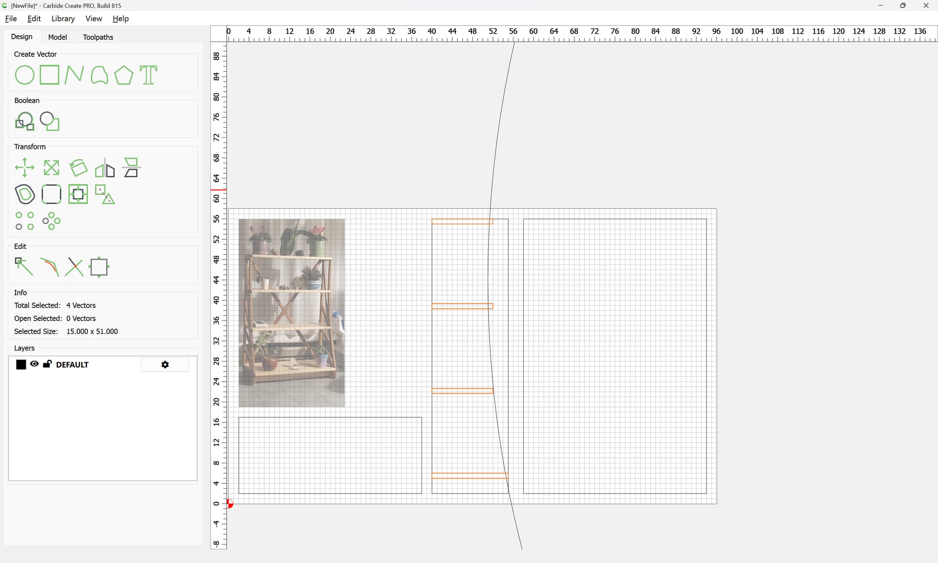

and then drag to adjust for a more pleasing proportion:
and adjust the shelf depths:
and adjust the circle placement:

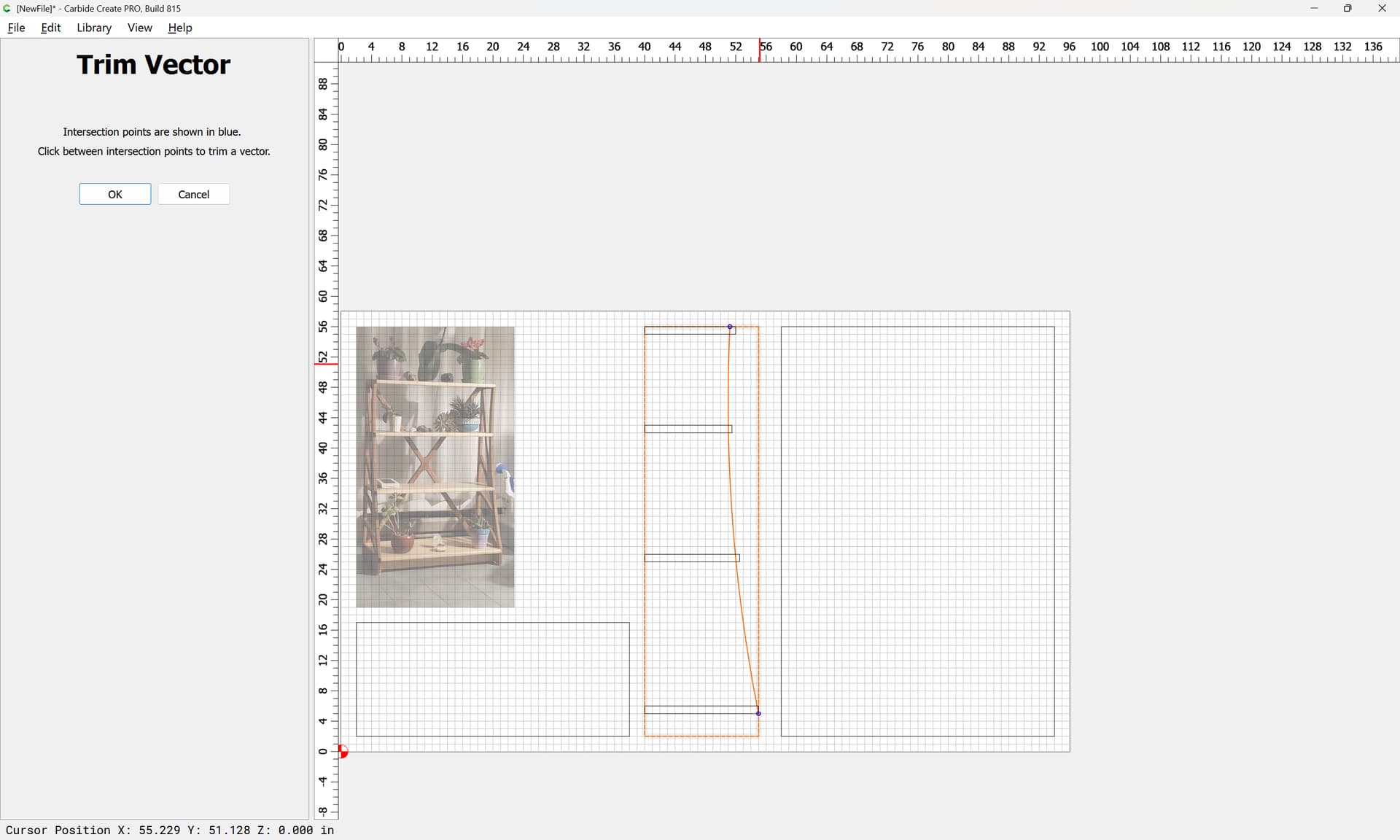

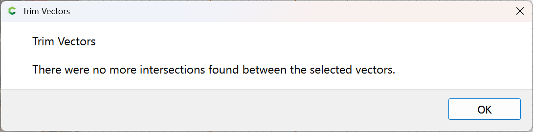

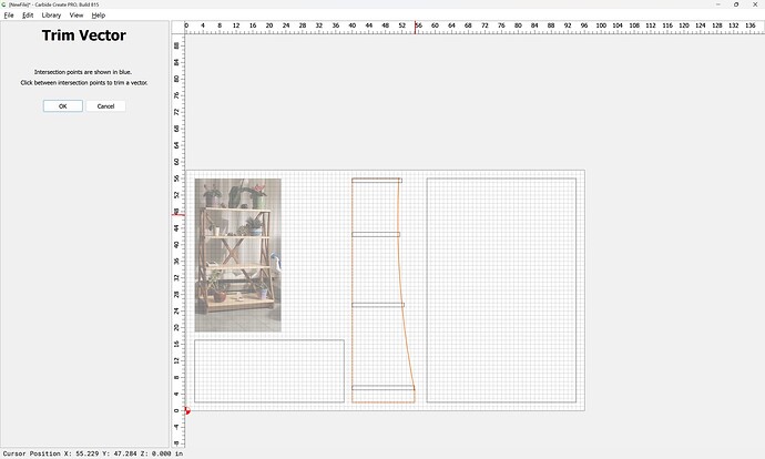

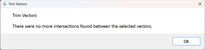

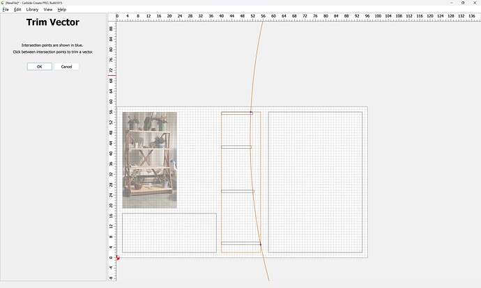

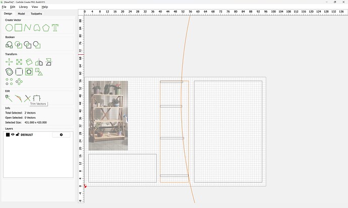

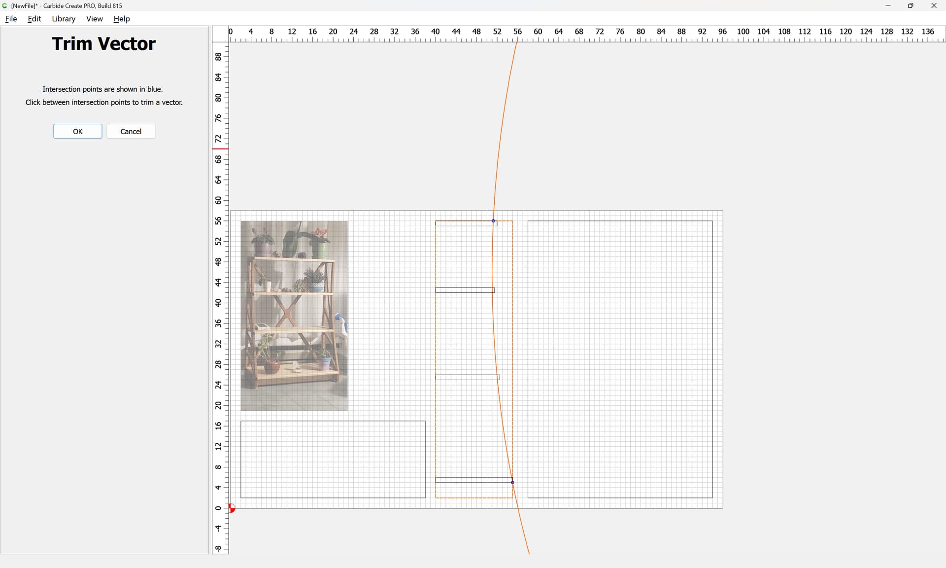

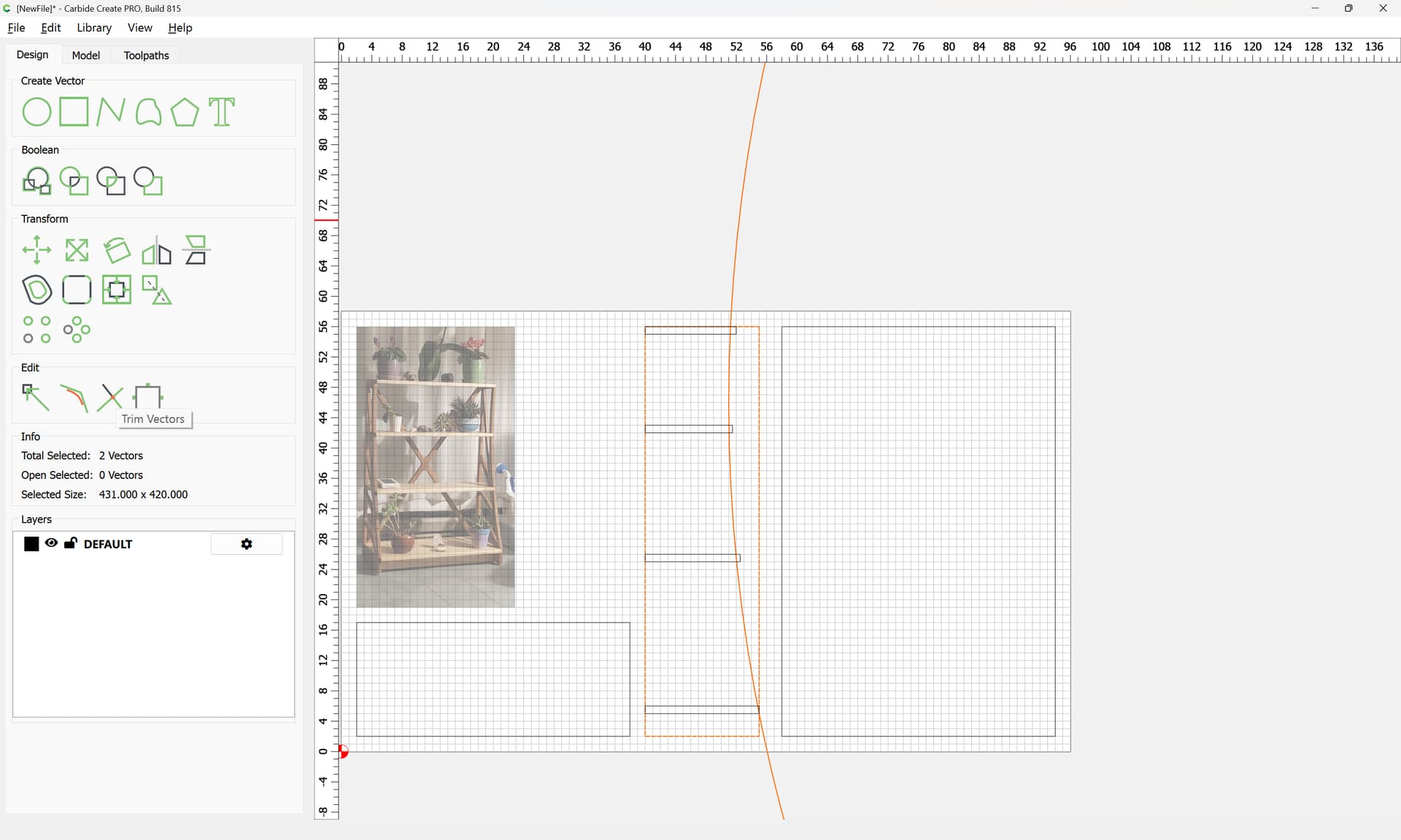

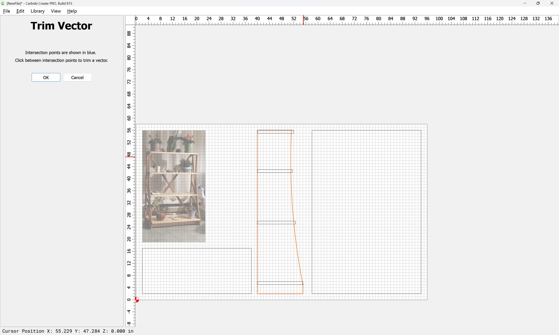

Select the circle and the profile rectangle:
and use Trim Vectors to remove what is not wanted:
OK
OK

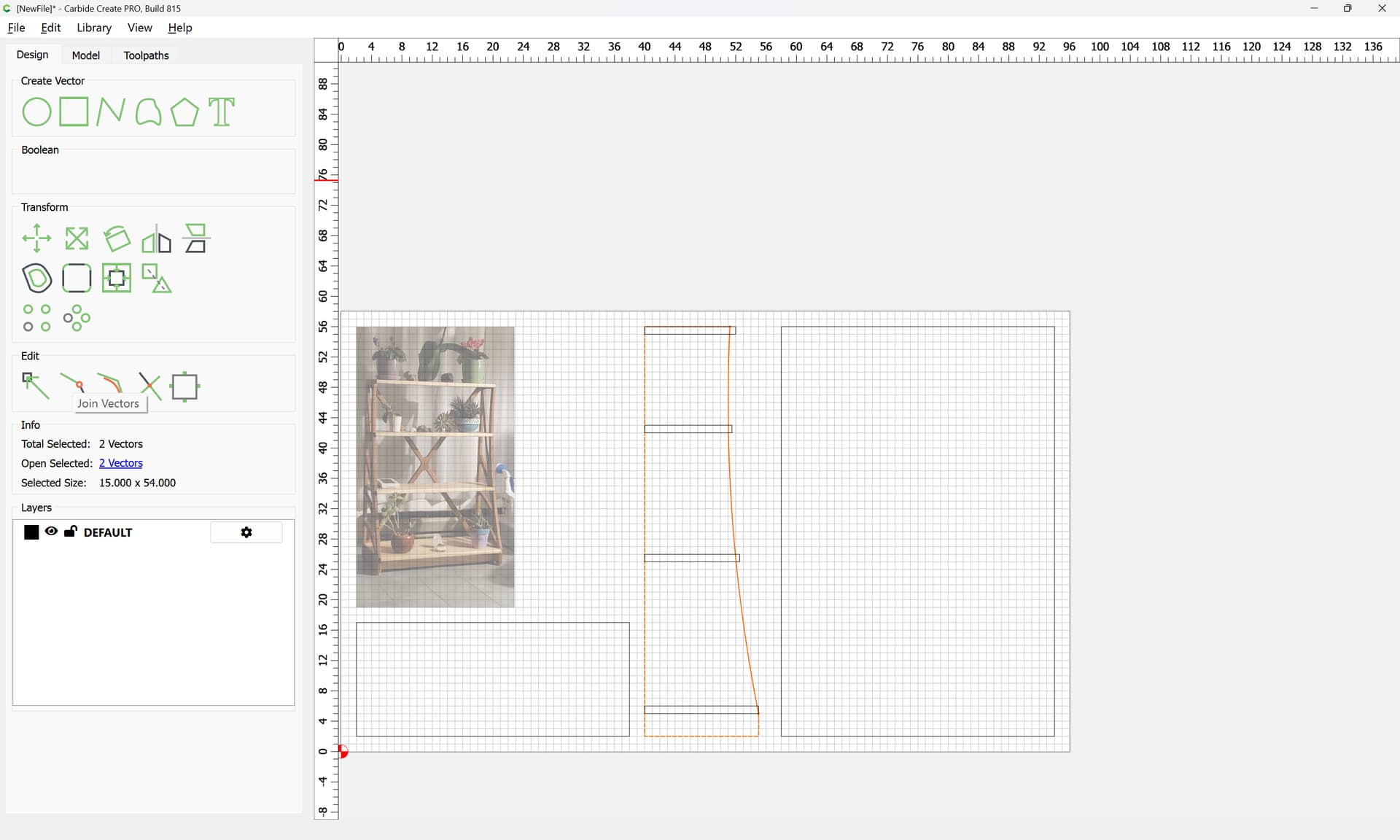

and then use Join Vectors to close:
Then it is simply a matter of drawing in the curves/lines to create the side and back, and the rectangles for the shelves, and then re-solving the joinery (half-laps and rebates for the shelves should work well, with miters (possibly with box joints for the corners) and using dowels for the top shelf.
