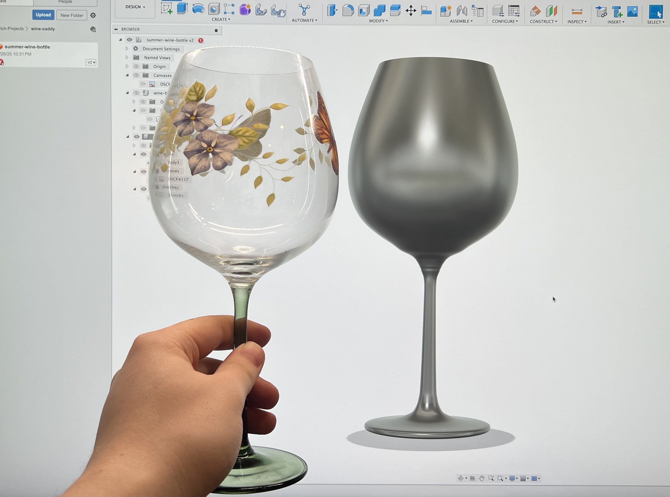

As a few others have said, photographing can definitely be done with great success. The setup can take awhile but that time is amortized over the number of objects you plan to capture (I photographed everything I could find in the kitchen :sweat_smile:)
Recently I designed a custom wine caddy thing at my wife’s request. She wanted specific glasses and bottles but she also wanted the curves matched in the caddy. The idea being that the pieces would sit more snugly in the caddy and not clink around when carrying.
The curvature was verified with a little 3d print. Everything matches up much better than I expected, well within the limits for a tight fitting foam if I wanted to go that route.
Granted this took an entire night, tracing is not a fast process.
If I ever try out the tool foam I’m definitely going with the bed scanner. It’s so much quicker and easier to “get right” than the photography but both are viable.
