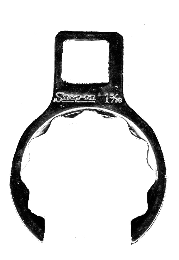

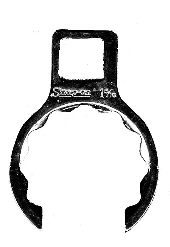

A perfect example is I have a 7/8 snap on wrench 5 inches long, and I want to do a cutout in foam or hdpe. I have tried photographing, scanning and I cannot get a decent enough representation to put into the computer. have even tried using the trace tool, it has a lot to be desired. I recently found a digitizing probe for another brand CNC machine. Is there a seamless or semi decent way to digitize tools and such? My friend has a creality 3d scanner raptor pro, could this work>? Thanks in advance
Steve
Can you post the image from the scan, and an accurate overall dimension? I gotta believe you can get that close enough for foam. Assuming you’re making a drawer insert, tool storage… ??

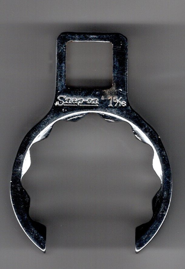

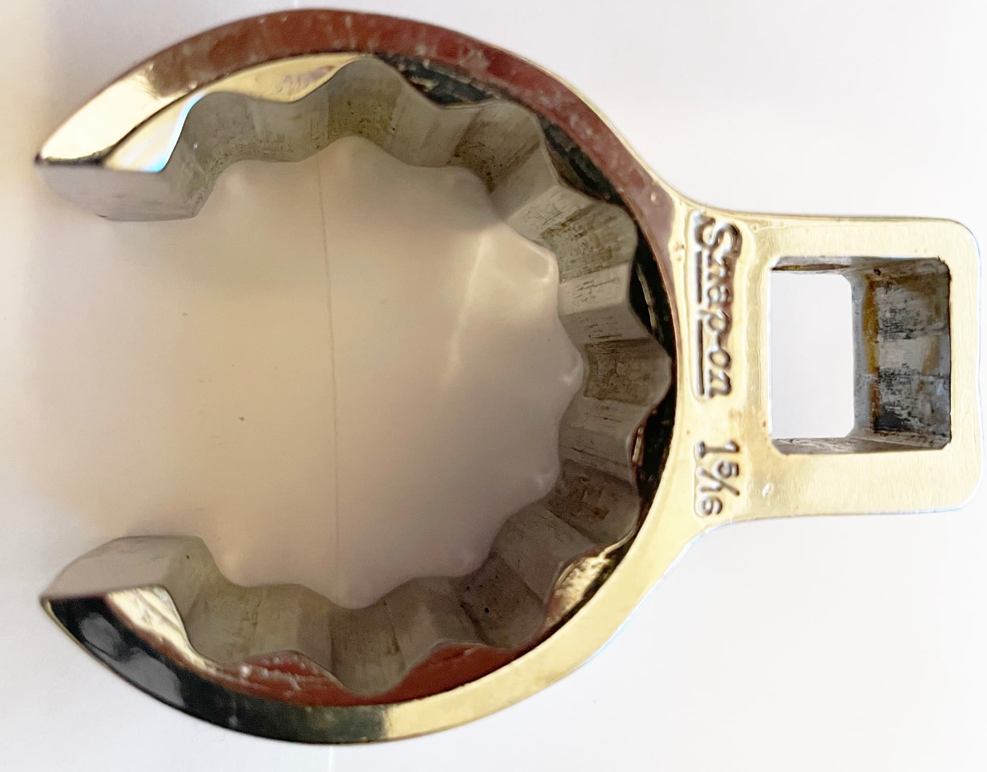

Yes it’s for foam. I have tried lots of things, but when you take a photo, its not true, it expands from the center of the shot. And its a serious pain getting it shadow free for the trace function. This one semi finished example was a real pita. Gotta be a better way

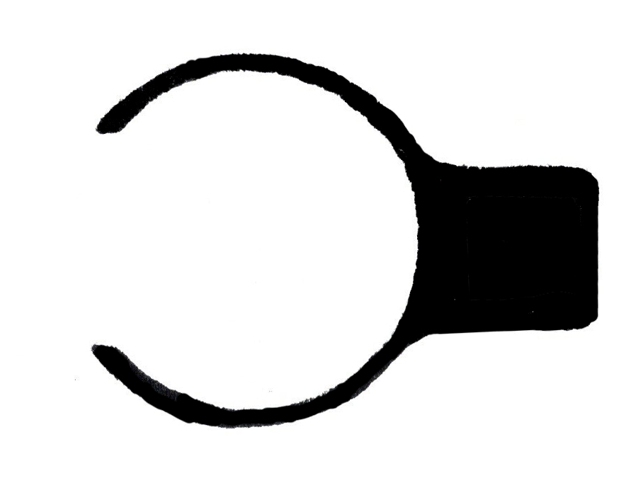

Thye two on the right I literally scanned on a bed scanner.
To reduce distortion, the best way is to be as far away as possible and zoom in.
What you want is that the width (or height, or depth) of the object is small relative to the distance to the camera. The angular field of view (how much of the image the object takes up) isn’t nearly as relevant.
I think tha’ts what the lower left pic was. Zoomed in. Still a lengthy process. Ill play around with it. Appreciate it

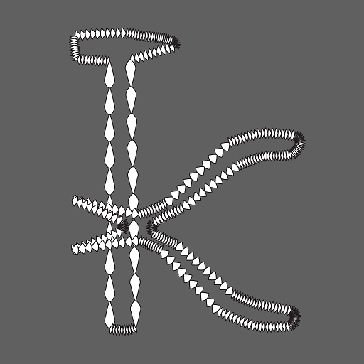

There is a utility app for this if you have an older Android phone, “Toolkaiser”:

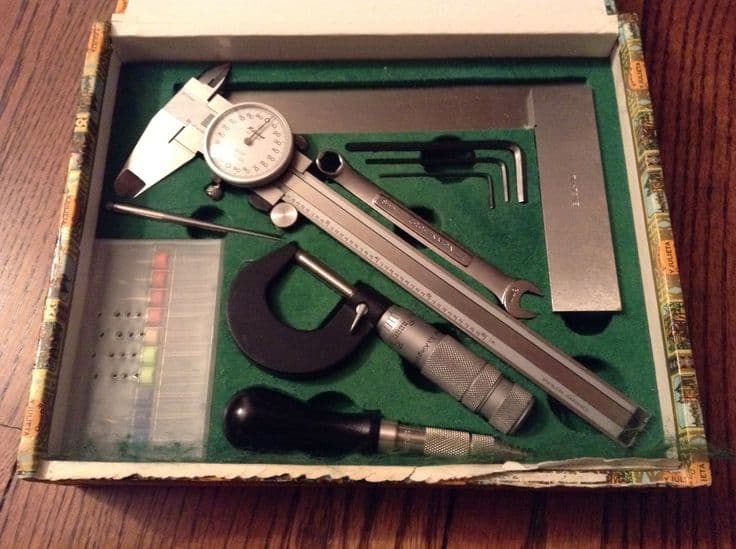

That said, ages ago, I modeled a full set of tools so that I could make a fitted case in 3D:
it was pretty straight-forward to do, just a lot of time measuring tools and programming the outlines in OpenSCAD.

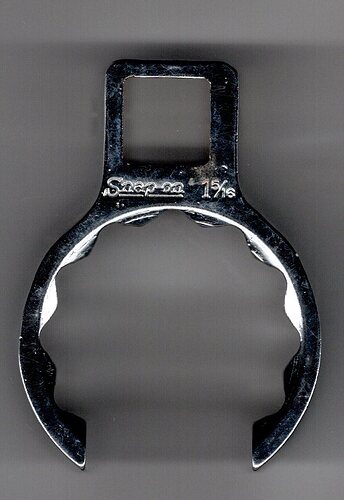

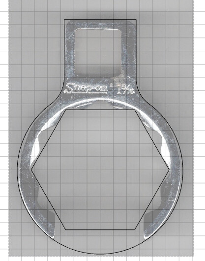

The 3rd image you posted seems plenty good enough to manually trace.
How accurate are you trying to be? A couple of measurements and this would be pretty accurate.
It’s just a circle & a square with a little editing. I used the hex to scale the image to the actual nut size. This took a minute or two to draw up.

The app ToolKaiser is available for Apple phones. I just downloaded it from the app store
@Steve340
Here’s the link to the iPhone app.
Looks very promising !
Thank you Ill give this a whirl !
Steve
The only chink In the amor so far is when you go to complex edit There’s no back button and you can’t save progress I spent 10 min perfecting a tool and I hit smooth and poof All
My work was gone and no back button lol ir it looks very workable
