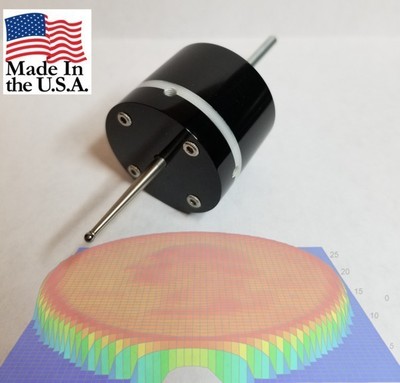

It all started with one of these:
Which will act similar to the bitzero and bitsetter, and if you plan to buy one yourself, make sure you buy a “normally open” one that closes to ground, and can work with only 5V of input voltage (which is what the Carbide3D PCD supplies).
I then had to learn how to make those little 3 pin molex connectors to connect a long wire (the probe comes with maybe 4" or so) from the bitsetter splitter board to the probe… and soldering thin wires is, lets say, not my super power. But I got it to work, albeit a bit ugly (I optimized for “it will work” not “is it a pretty solder joint”).
A simple test with having Carbide Motion in the settings screen, and then by hand touching the probe showed that both the LED turned on, and CM noticed the probe. Ok, all the evil analogue stuff taken care of and working: The final contraption can be seen (next to the object I’ll be scanning) in the picture below:

  • The probe is fragile. And it gets out of center easily and then the rest of the probe cycle is a misfit
  • The probe also probes side ways (and has deliberate amounts of play for that), which means on a smooth sloped surface it will “slide” a bit before triggering
  • The probe is not super great at probing completely vertical walls due to the deflection property
