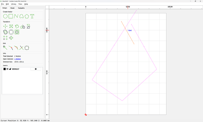

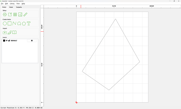

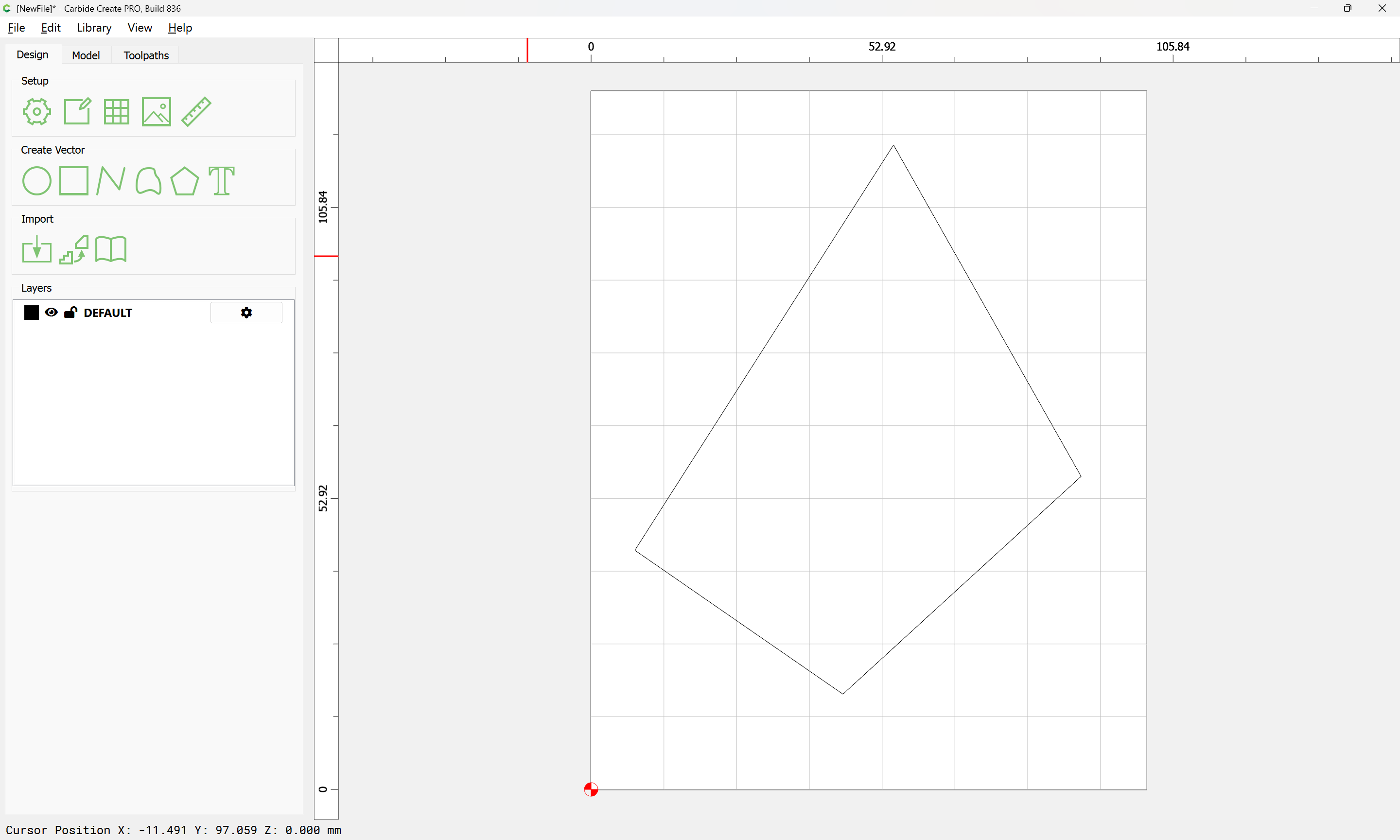

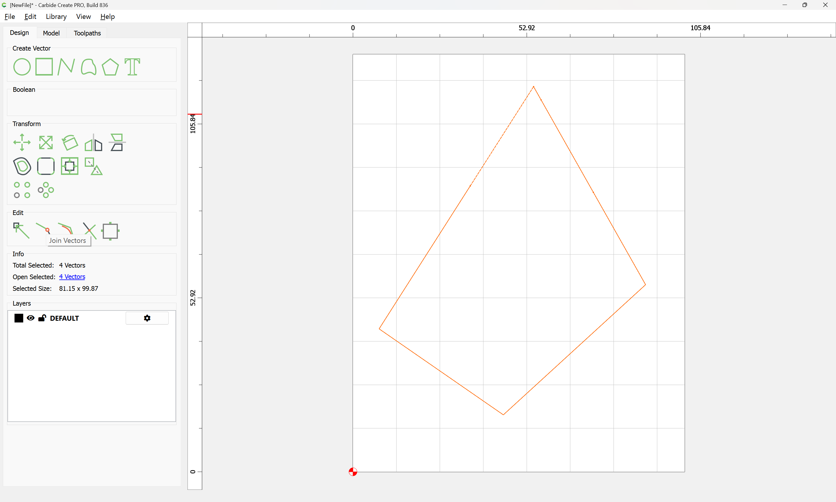

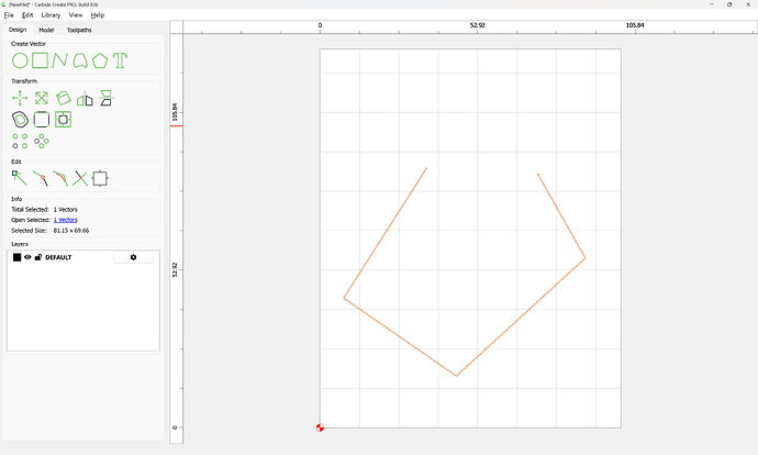

Given the vector:
which one wishes to appear as:

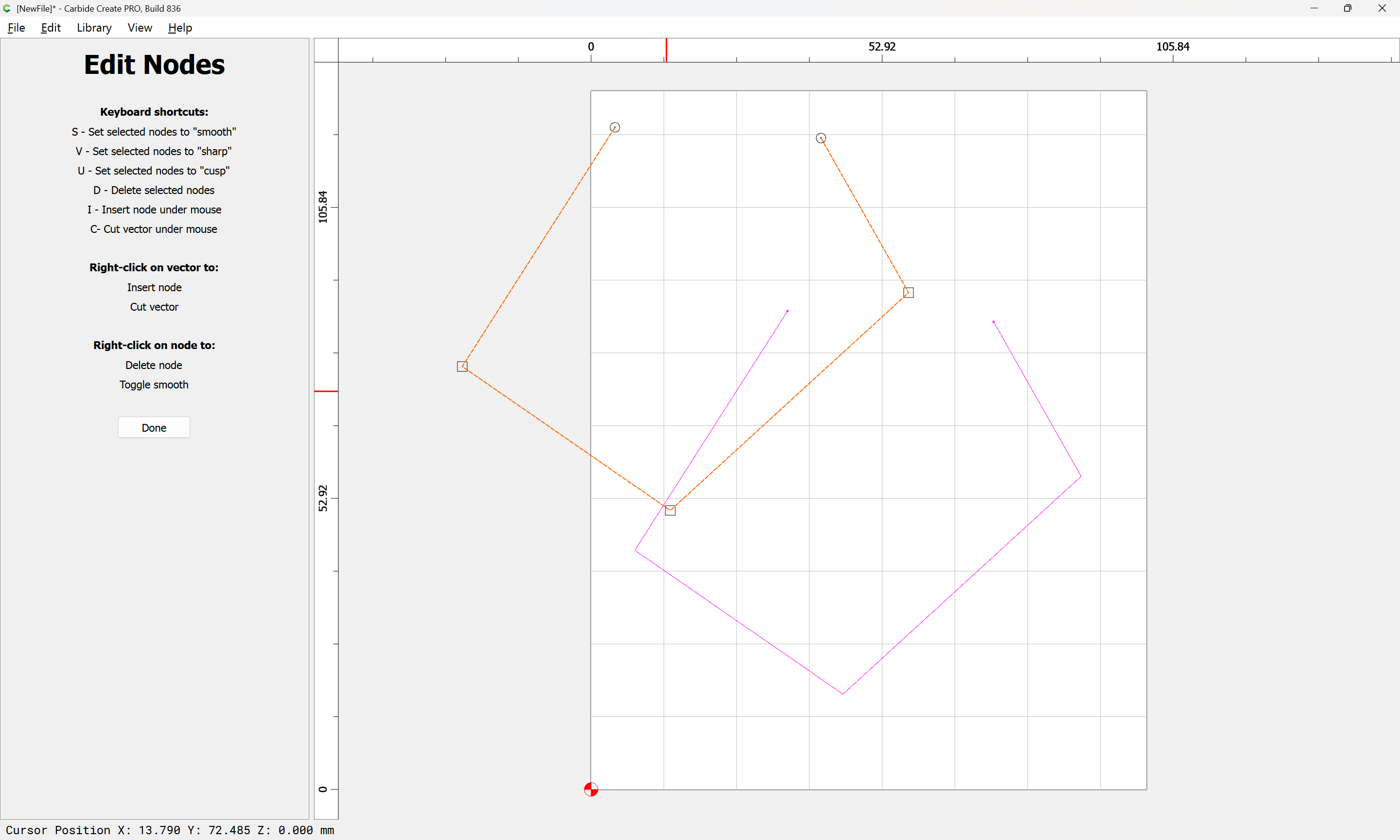

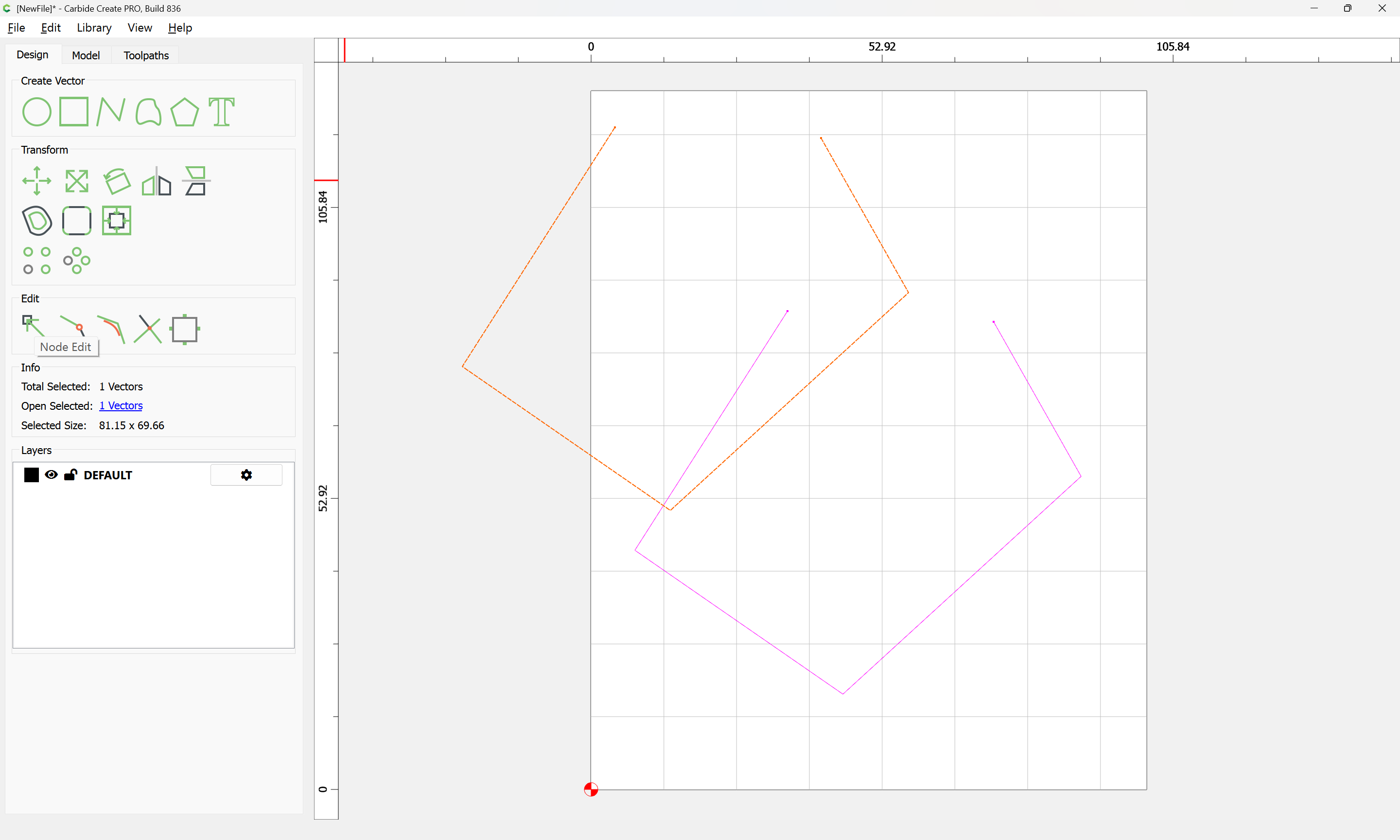

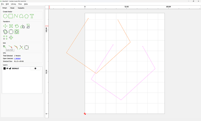

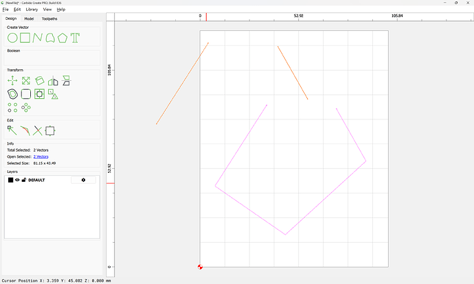

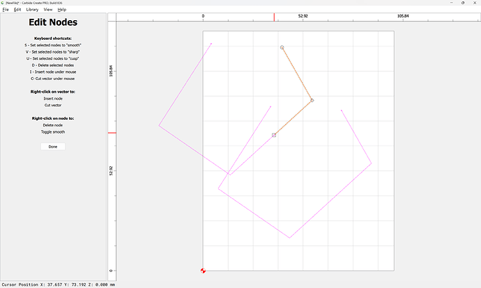

Then one needs two lines of a sufficient length, this may be made by copying the geometry:
and node editing it to remove what is not wanted:

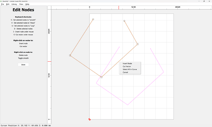

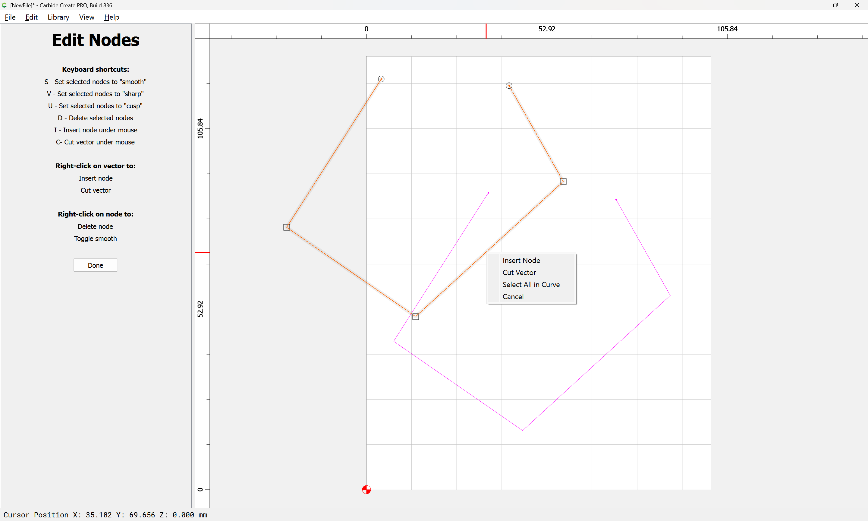

Cut Vector

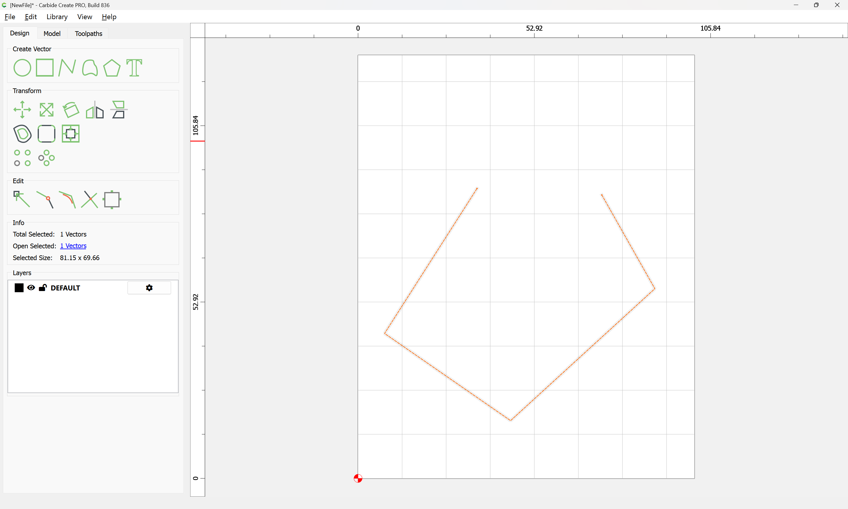

Select the geometries in question:

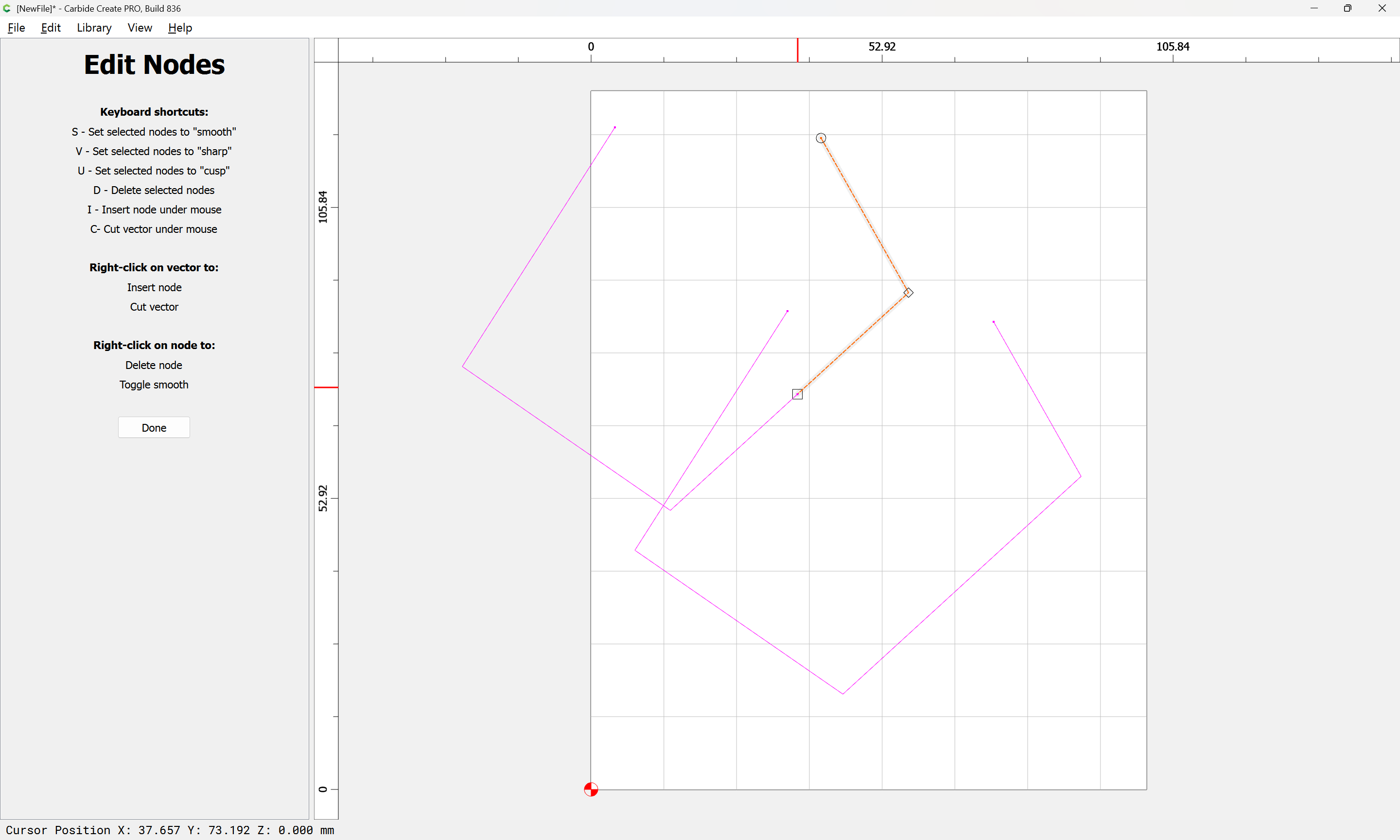

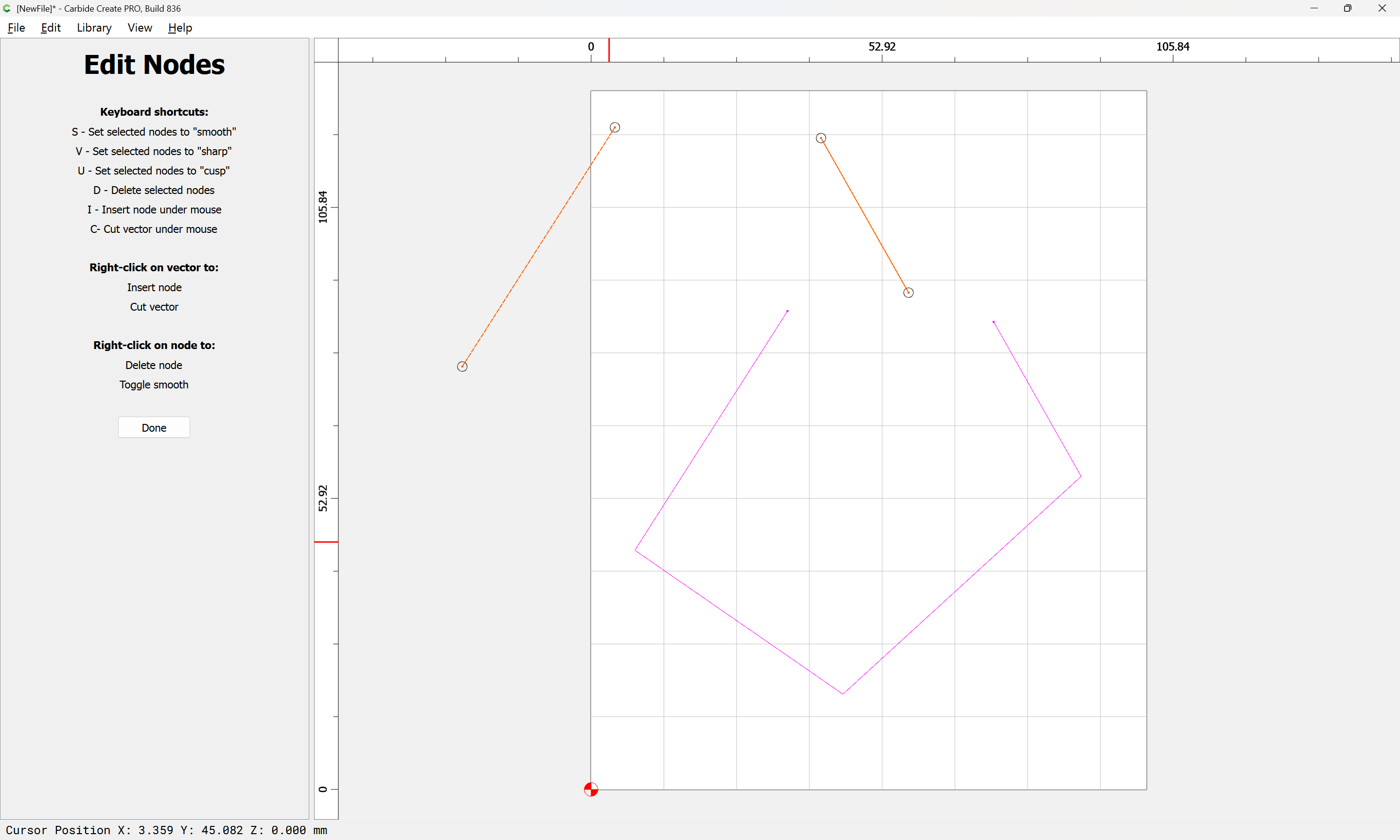

then select the nodes which must be removed:

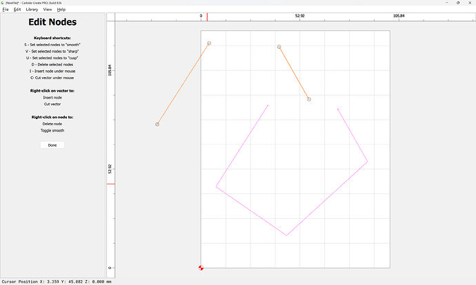

and delete them:
Done

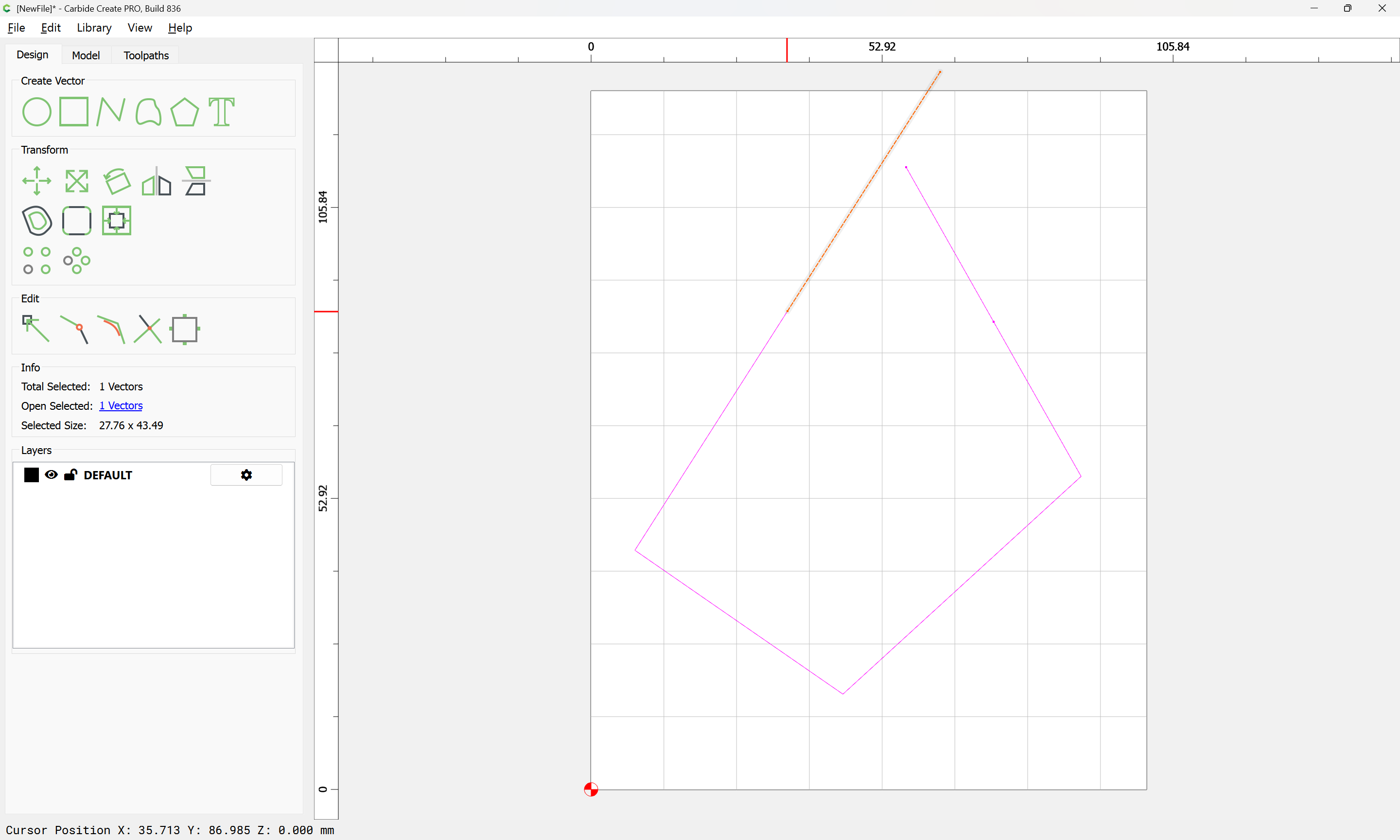

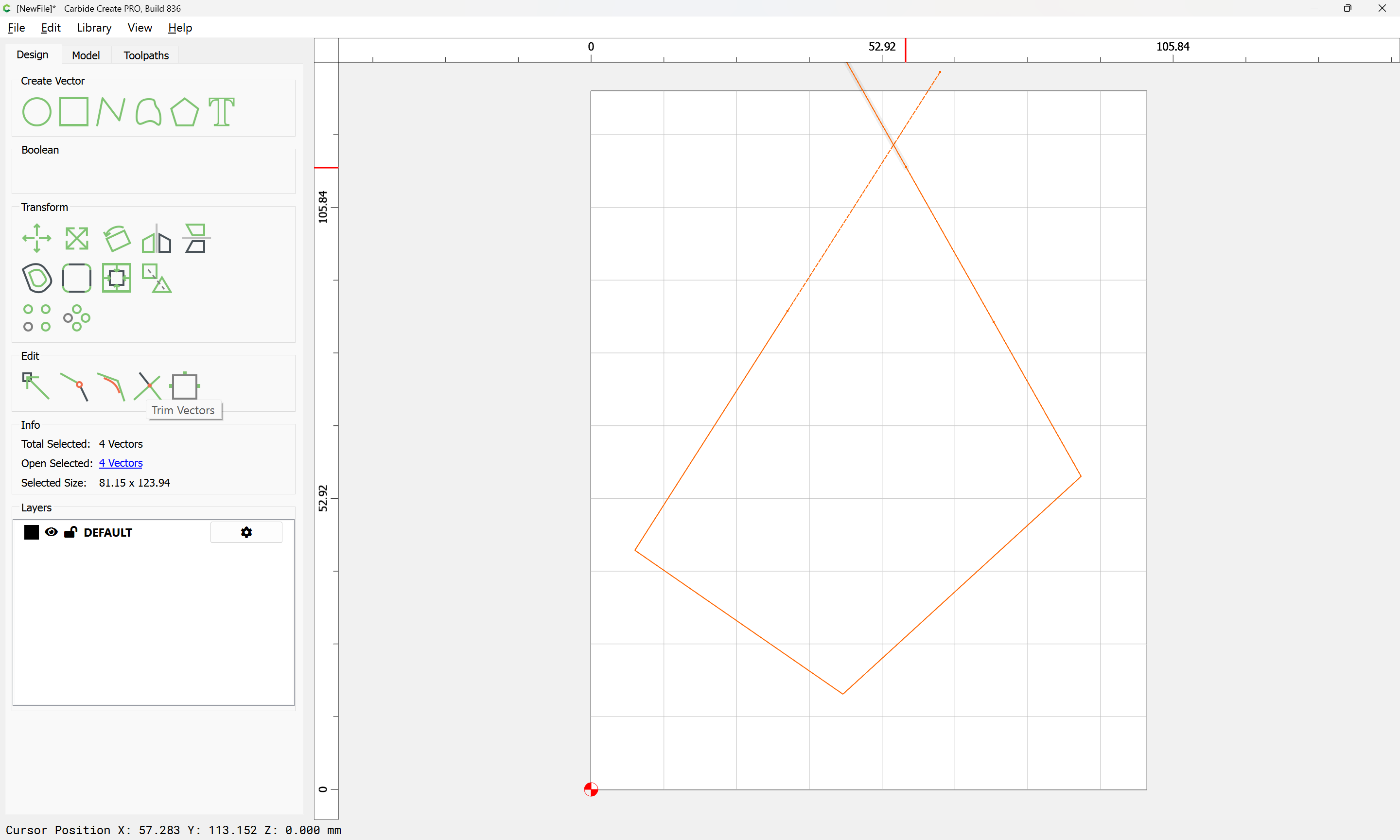

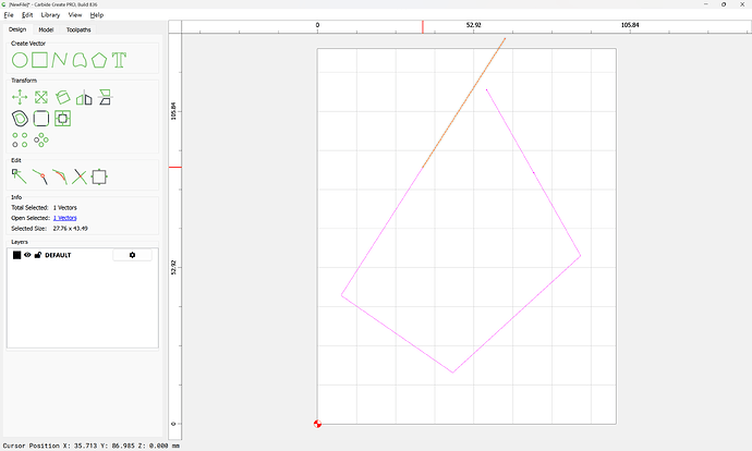

Then drag the lines into registration:
and if need be, duplicate again:
and drag into registration again:

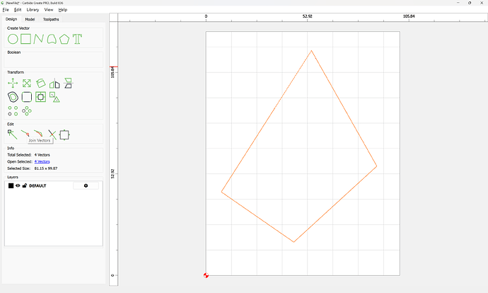

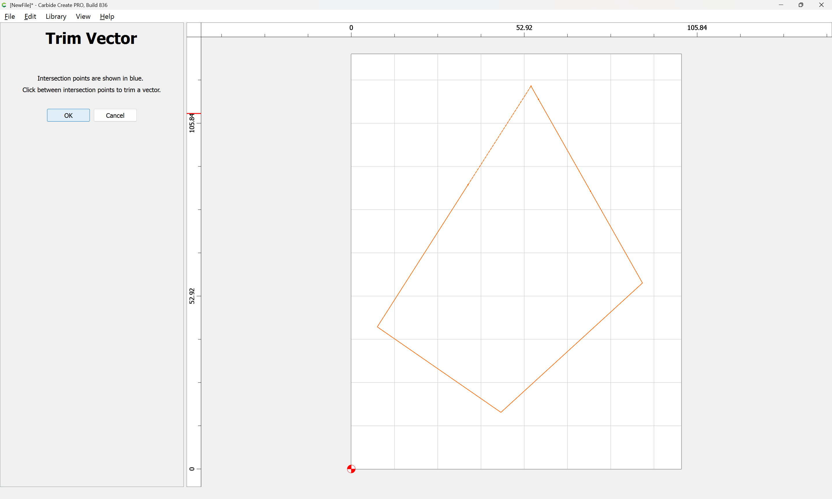

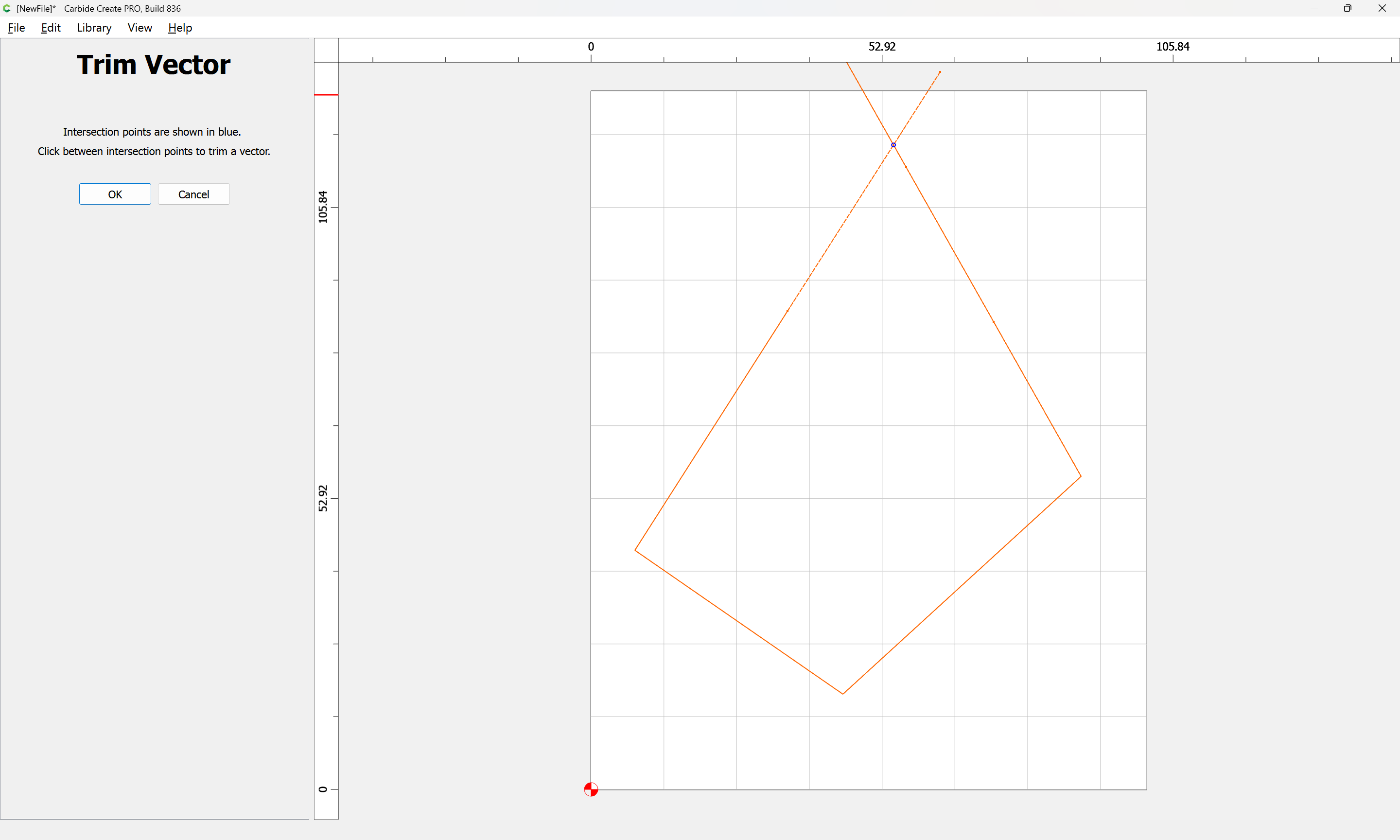

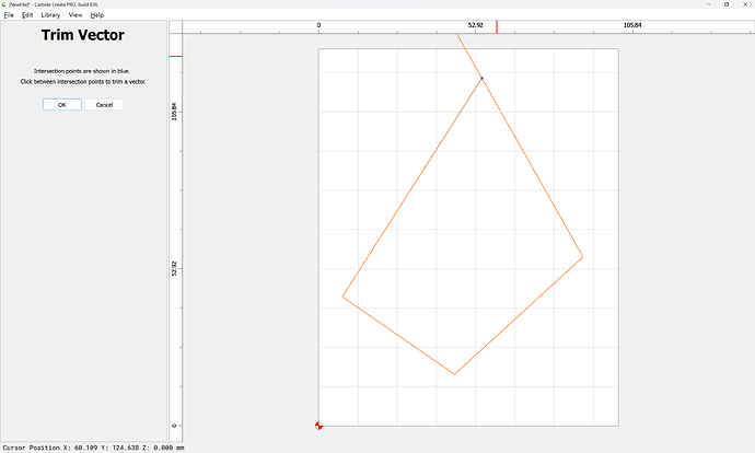

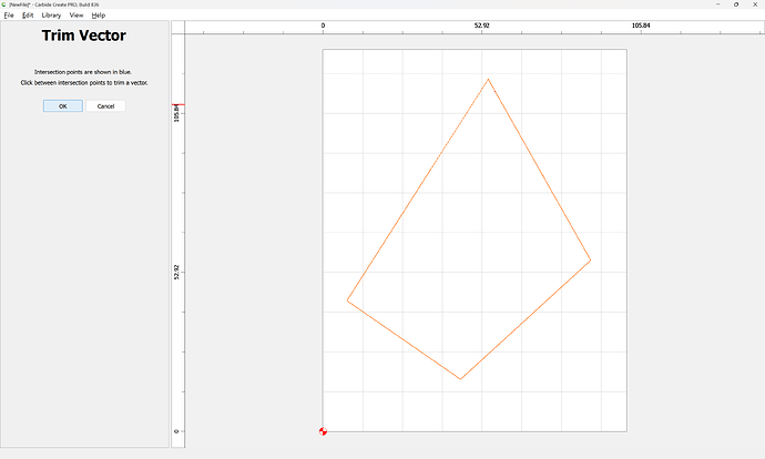

Select everything:

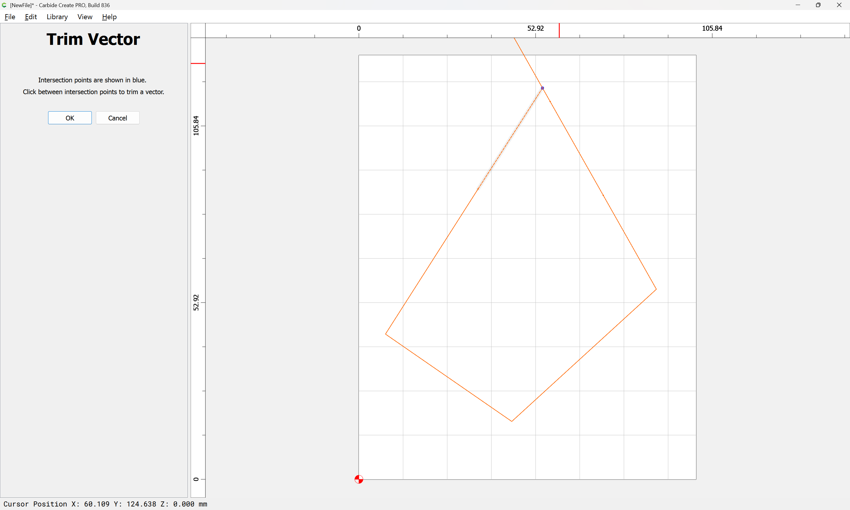

and use Trim Vectors:
until one arrives at:

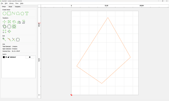

OK
OK

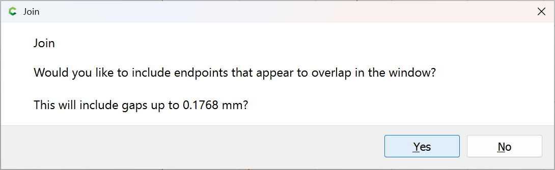

Join Vectors
Yes
