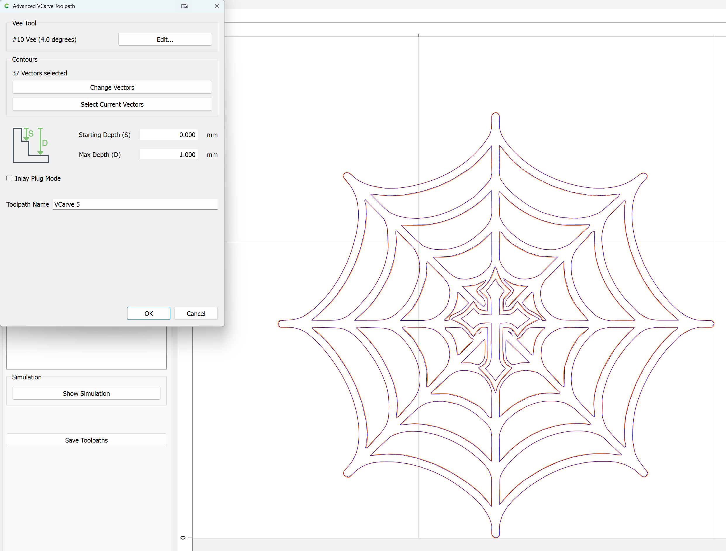

Hi!

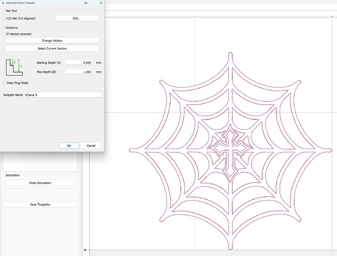

Please look at the image. It’s a small engraving that’s supposed to be made with a 4deg V-bit.
Sometimes when I engrave stuff, the blue line goes along the center of the drawing, which means it will regulate the width of the engraving by changing the depth of the bit. As it’s supposed to be.
But in this case the blue line (the simulation of where the bit will go) goes directly along the inner and outer edges of the engraving. I already know it will be a mess.
What did I do wrong and what do I do to make v-carve work like v-carve?
What is the scale of your carve? (i.e. How thick are the web filaments?) With a 4 degree V-bit and a max depth of 1mm, the bit should run only 0.035 mm from the edge of the carve.
UPLOAD YOUR FILE.
The reason it is tracing the outside edges is because you set a max depth. Use the value t instead.
What does this mean? What is the value t?
It represents the thickness of the stock. Rather than having to type in a specific number, when you use ‘t’ the program will use the value in Stock Setup of the thickness of the material. If you change that thickness, it will automatically change in any toolpath you use it in.
Using ‘t’ here just says not to limit the depth of the VCarve. It will instead go as deep as needed to touch the design on both sides of the tool.
