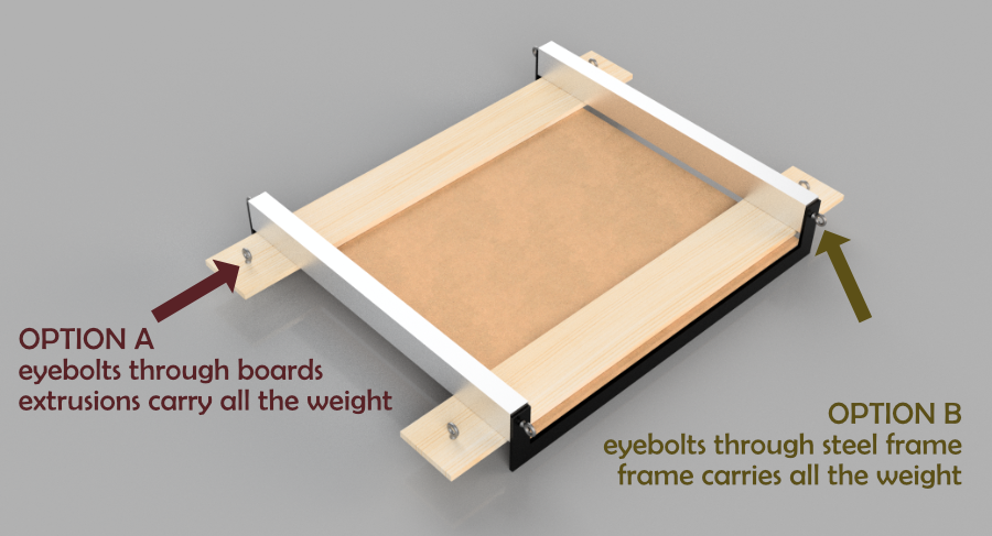

How to hoist my XXL?
Option A, Option B or some other?
I need to lift my XXL, firstly to slip in some foamboard, but also to move it to a new bench someday, and ALSO to store it up near the rafters while I use that precious 16 SqFt as an assembly table.
A, B or other? Thanks!
I would do C:
  • put boards underneath parallel to the extrusions
  • use the PEM nuts for the leveling legs to bolt the machine to the boards
Will, I knew you’d have a great idea!
Kind of a double edged sword though, I need to lift it to get to the PEM nuts. I guess I could prop each side up on a 2x4 temporarily.
So if you are going to lift it up when not working in use why not build a torsion box. You can secure Shapeoko to torsion box and lift torsion box. The torsion box will keep machine level and stable.
gdon: excellent idea!

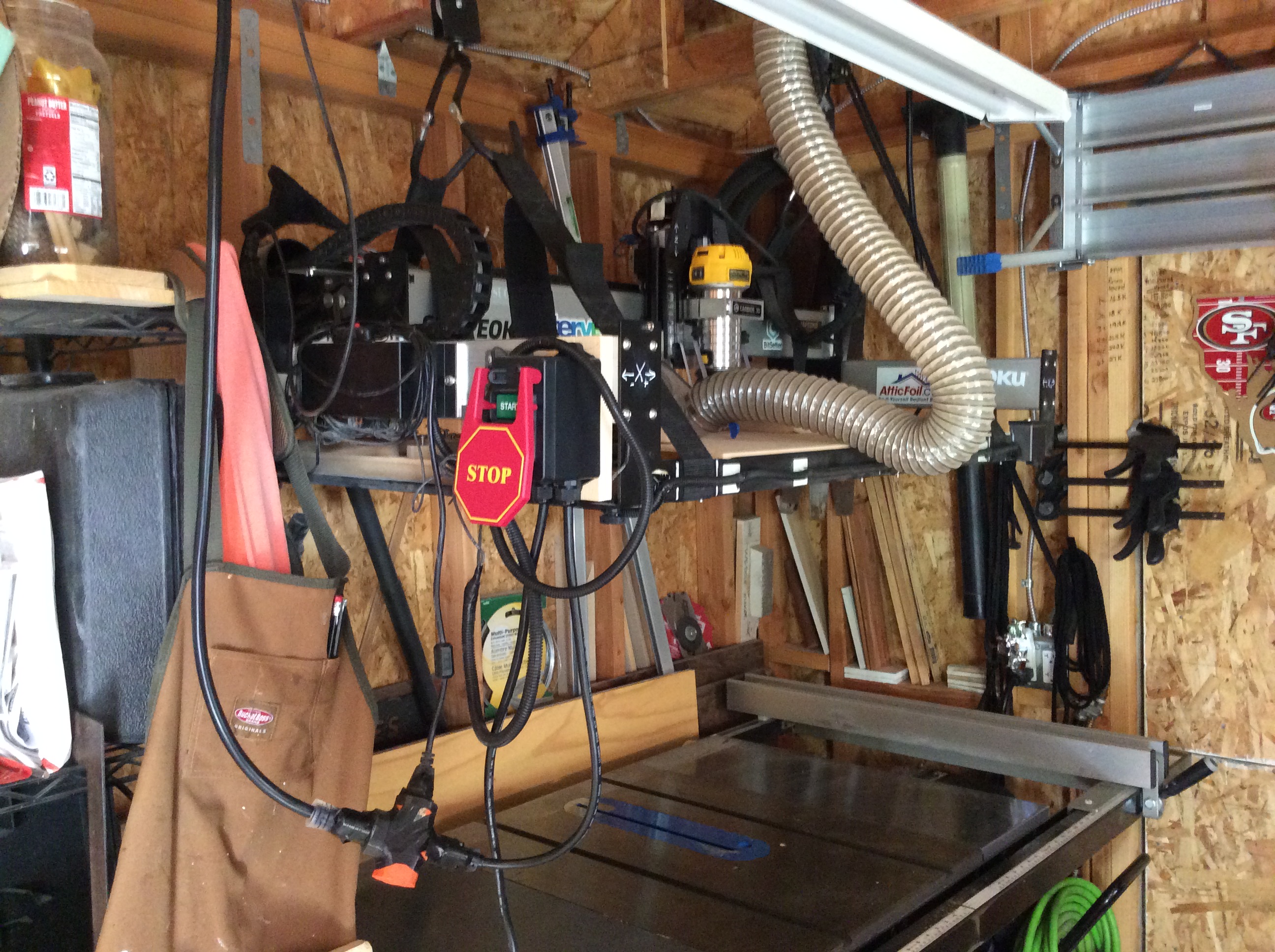

My shop is only 12x10 so I use every square inch. This is canoe hoist for my xl size. Everything is dual purpose.
@Robojeeper brilliant! is the rope coil below the quickclamps from both pulleys?
Yes, that is rope from pulleys. Good eye!
