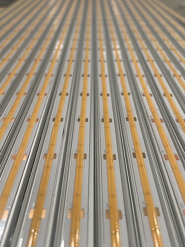

Lights strips:
High density fcob analog strips
These are incredibly high output lights with exceptionally even distribution even without a diffusion layer.

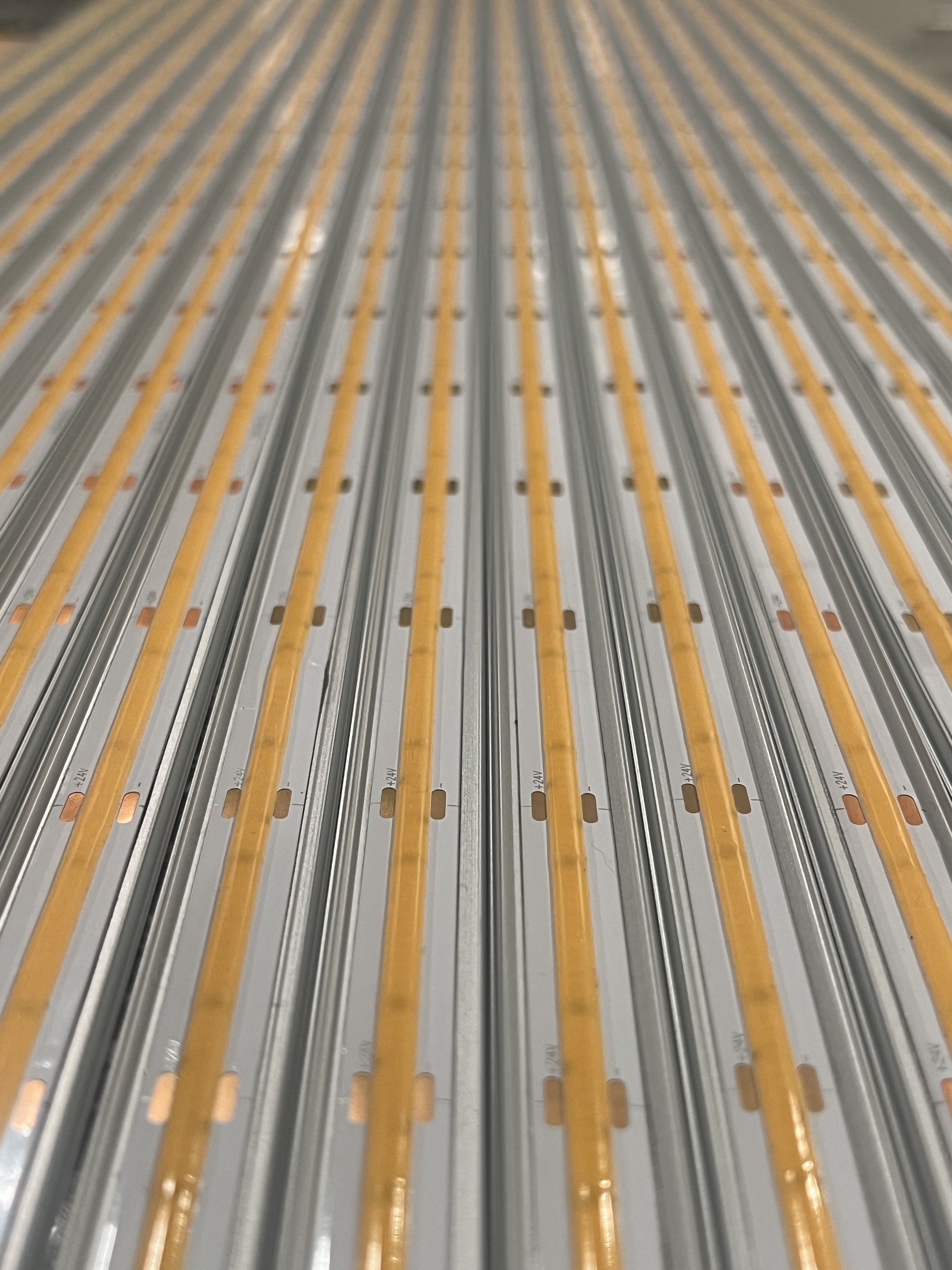

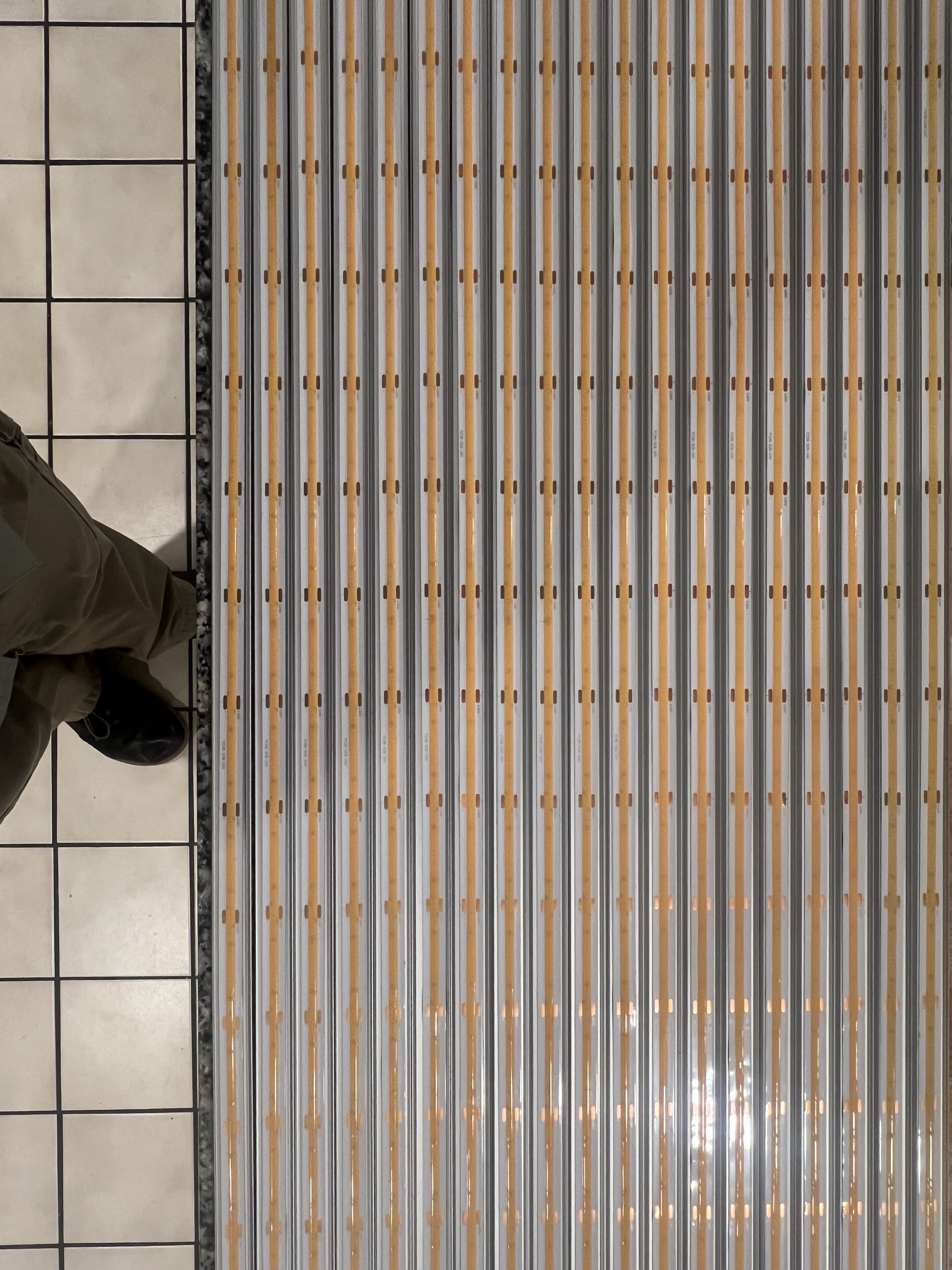

Measure out your led strips. These channels are all 100 centimeters for some reason.
Make sure to cut at the pre marked cut points.
After about an hour you should end up with something like this:

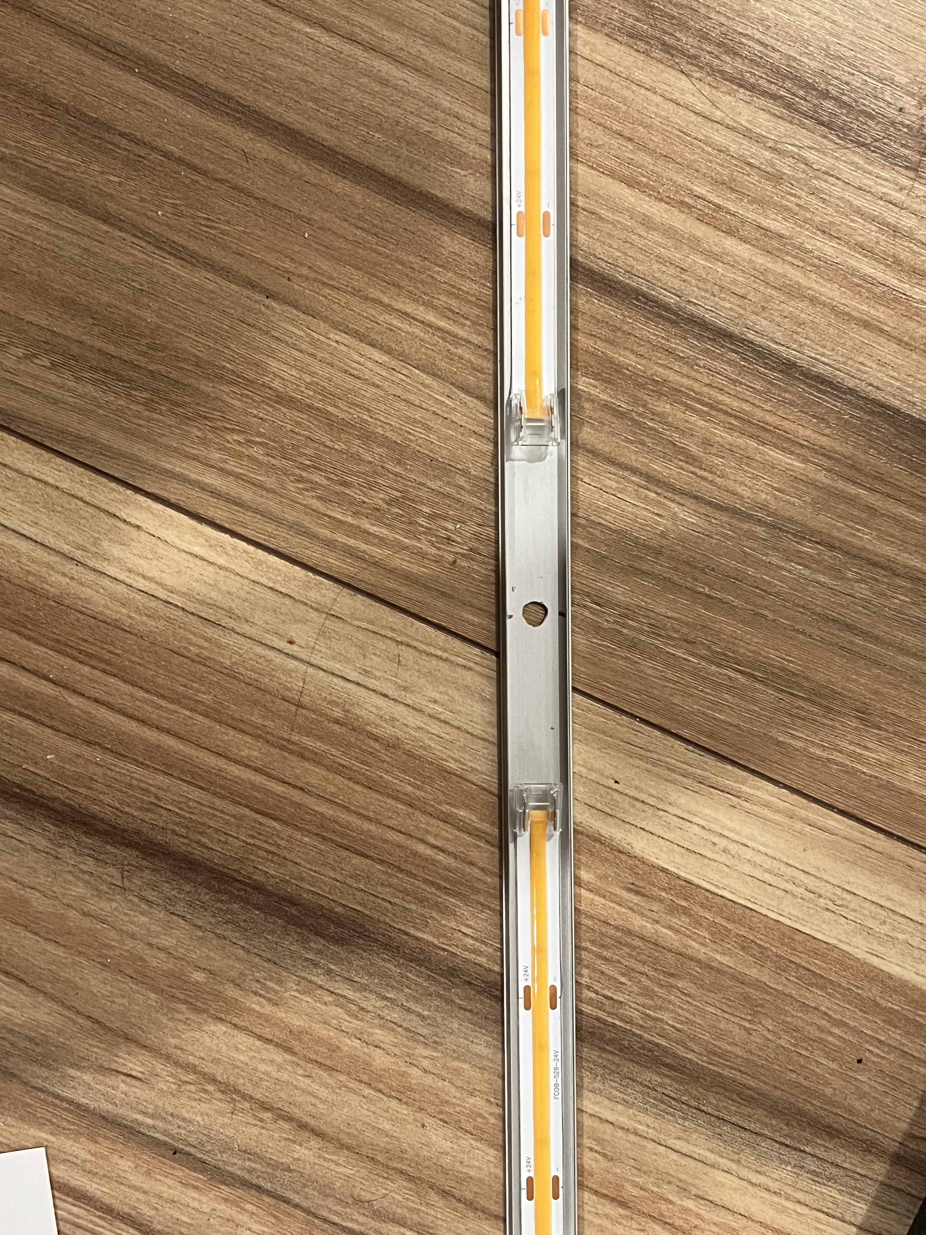

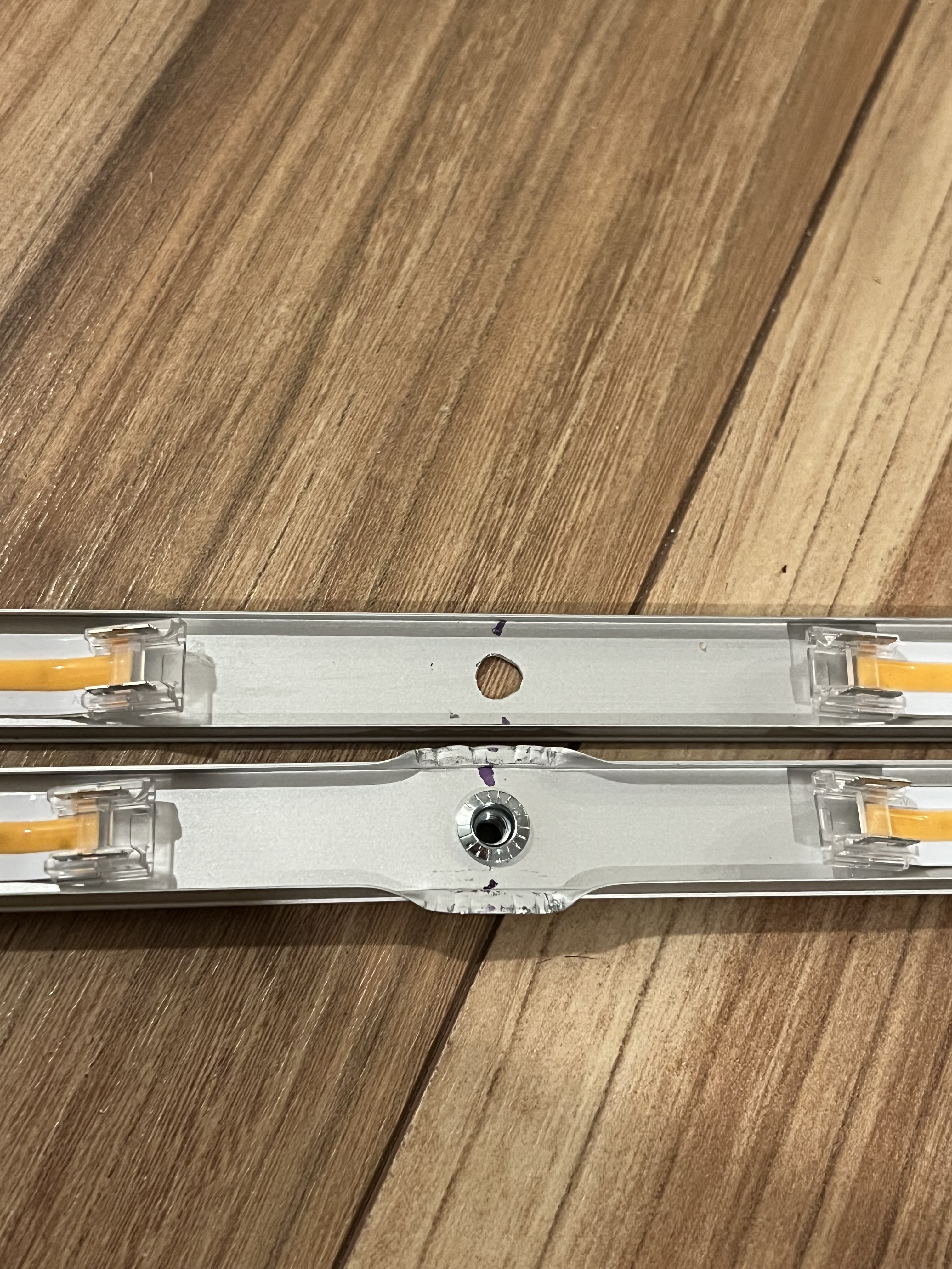

Cool, now let’s change plans because I had the bright idea to rivnut the center of my strips and control each half independently to better light specific areas. That means cutting out the center led segment:
And let’s pop that rivnut in…oh the head of the tool doesn’t quite fit. That’s gonna take some time to bend away ~cleanly:

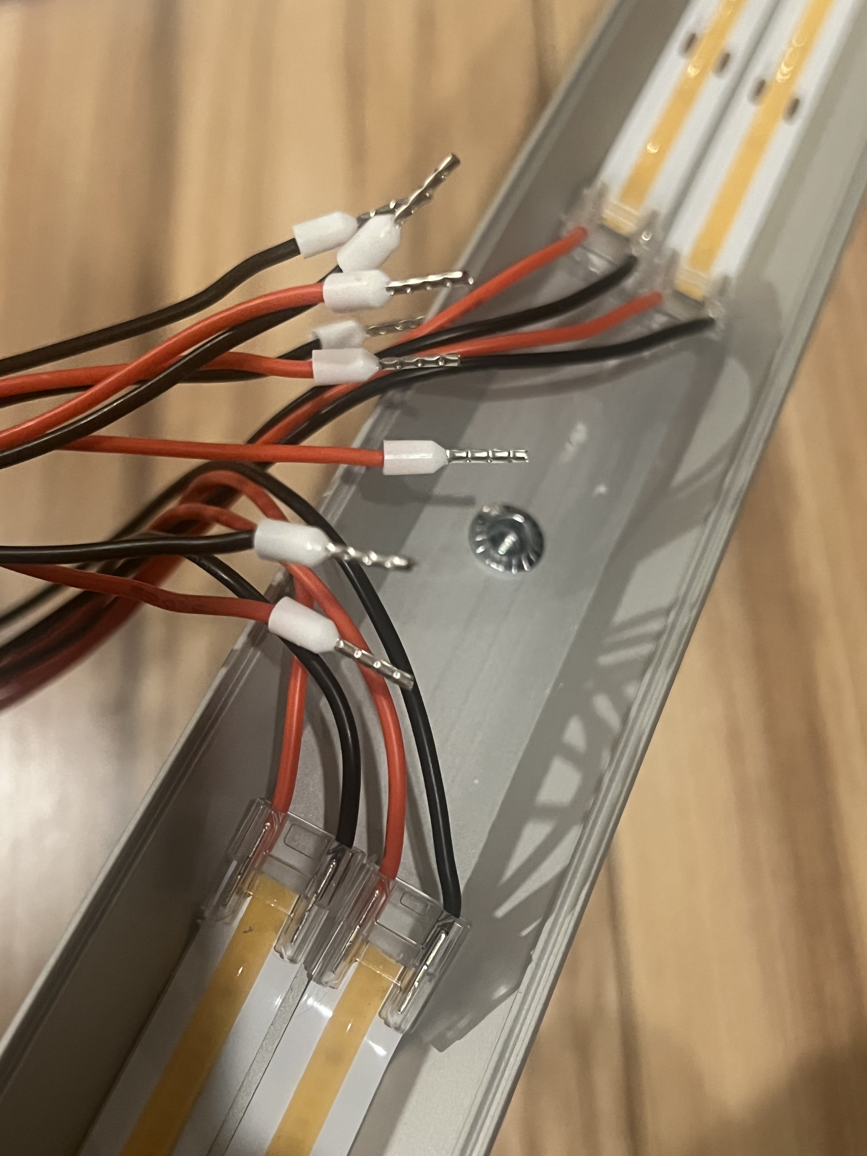

Oh you may have noticed those snake bite clips on the strips. A few come with most strips. They just puncture the copper clad on the strip and your wire providing a decent ~permanent connection.

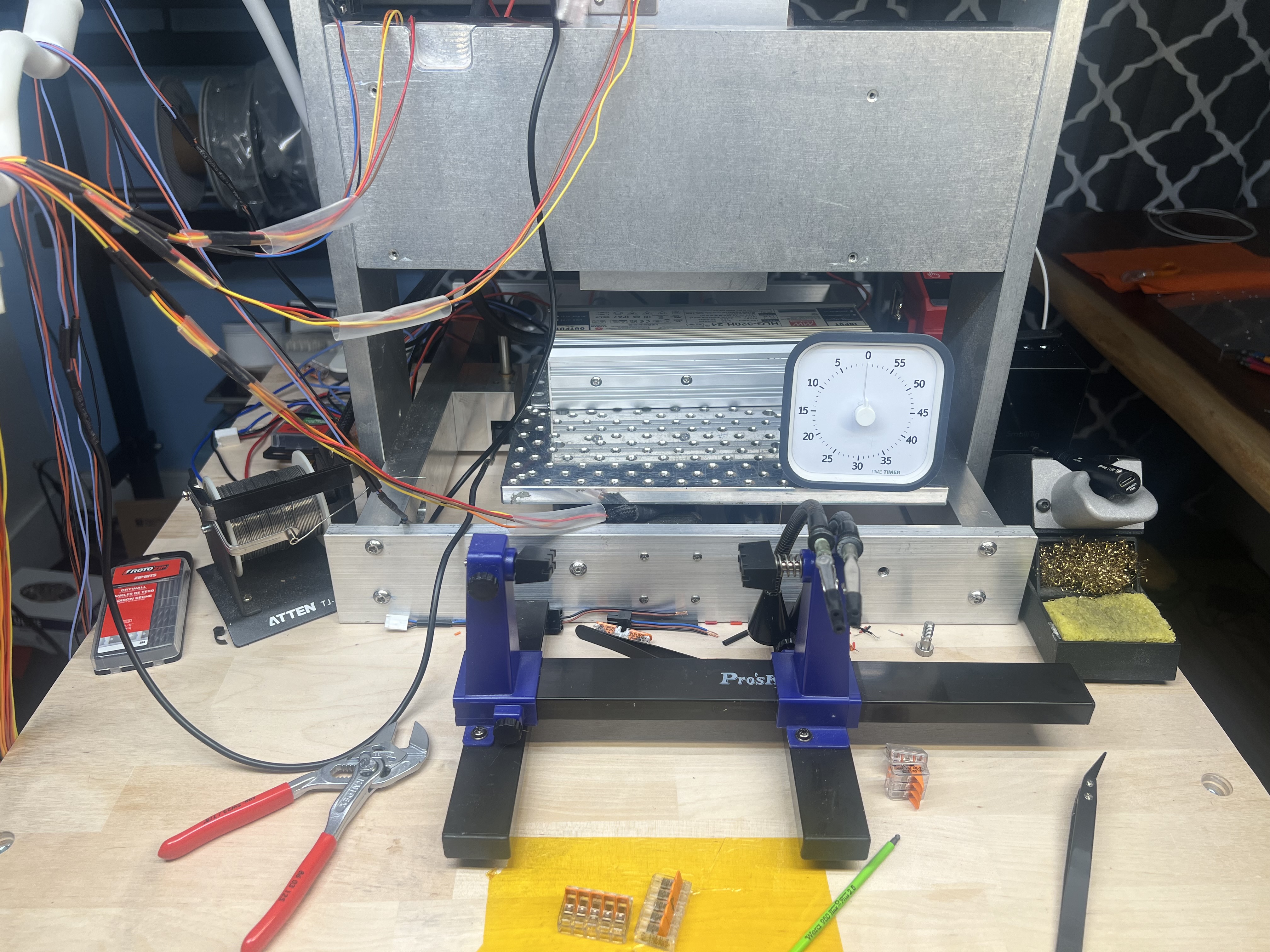

Anyway, let’s ferrule these pig tails:
Did I mention I love ferrules…so good :hugs:

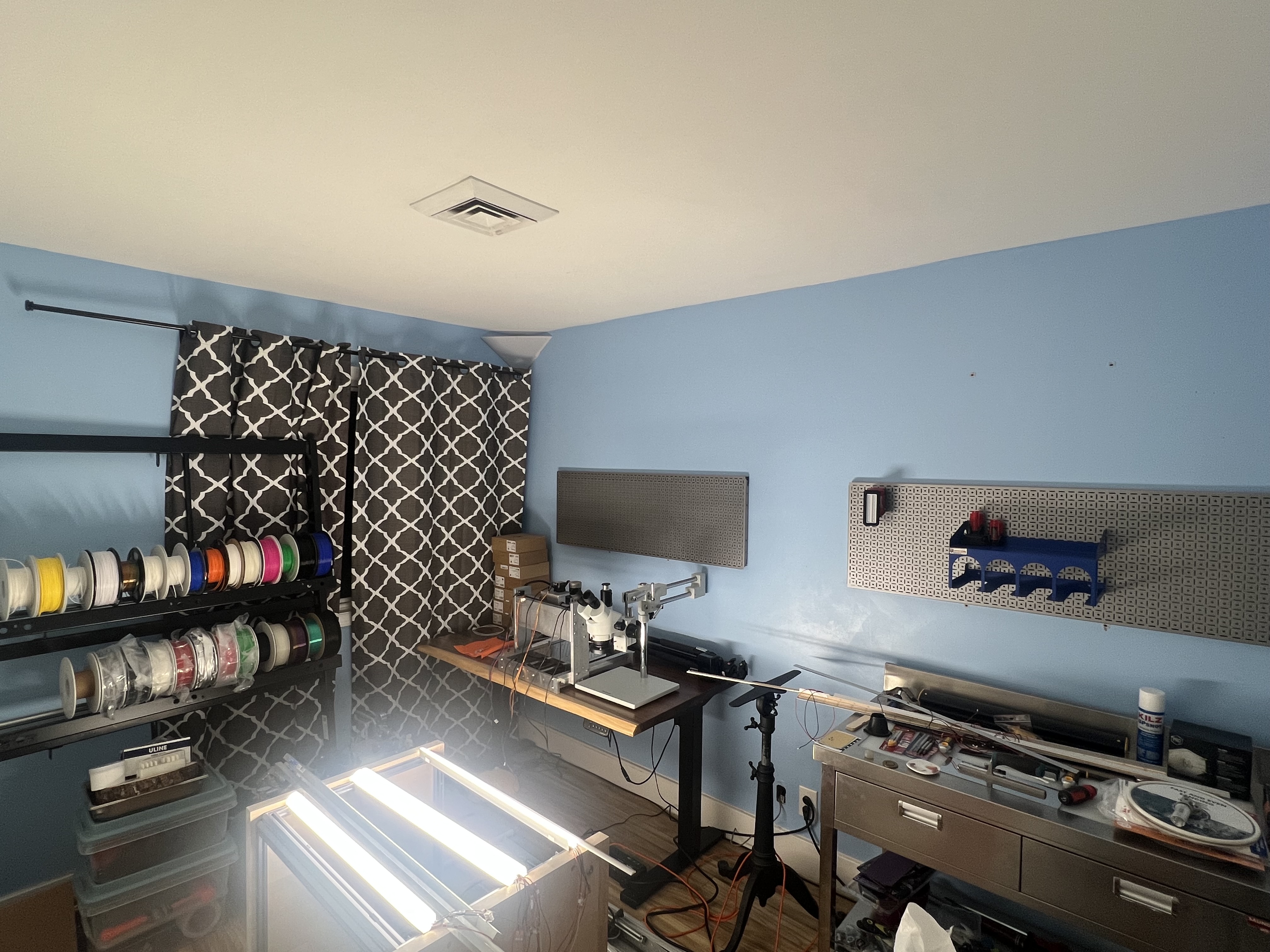

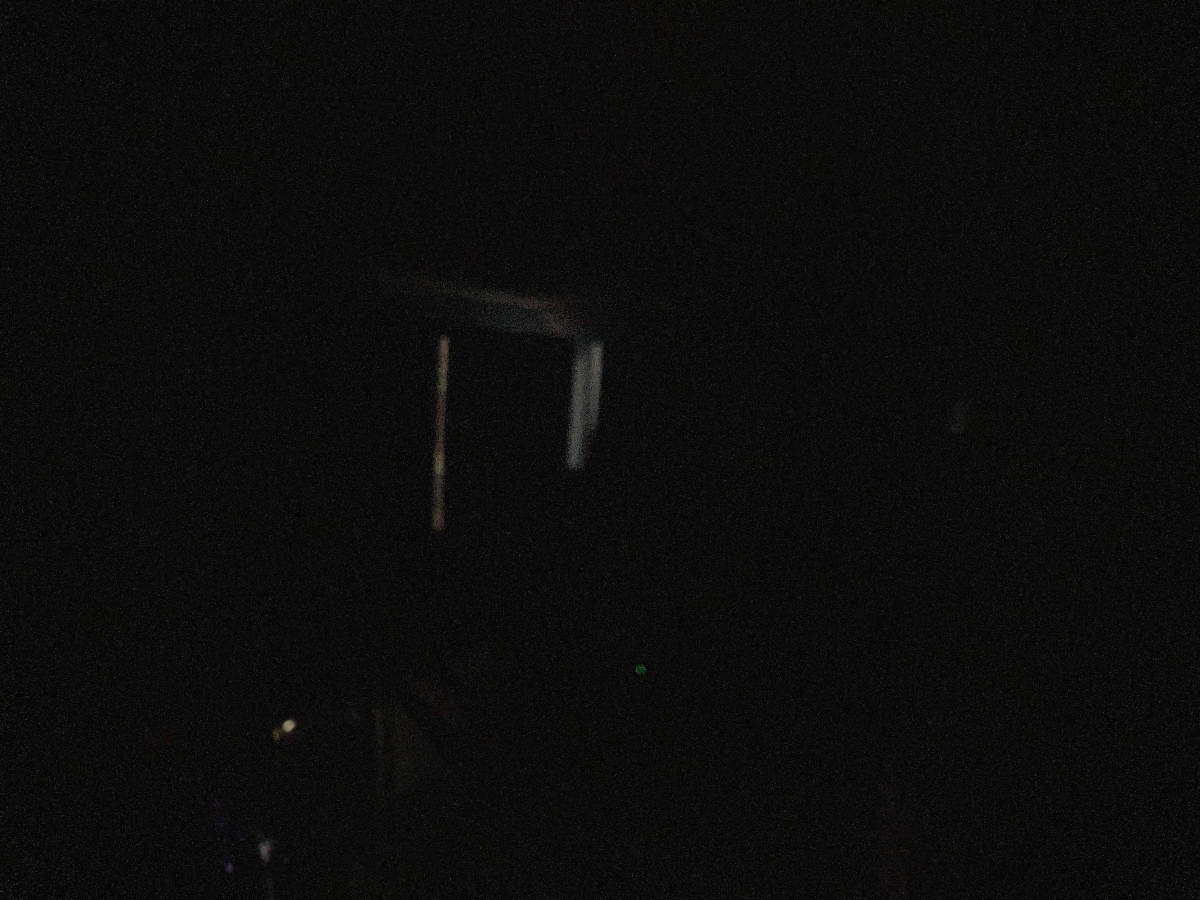

There’s a bunch of detail I skipped over regarding power draw, sizing of power supplies, necessary wire gauge, and where/why we are injecting power into these strips. It’s late though so let’s just get a decent example of my dark room with no strips, one strip, and a handful of strips, then pick back up tomorrow.
Dark:
One strip: a nice dim room, decent for evening work. Soft shadows and a relative glow.

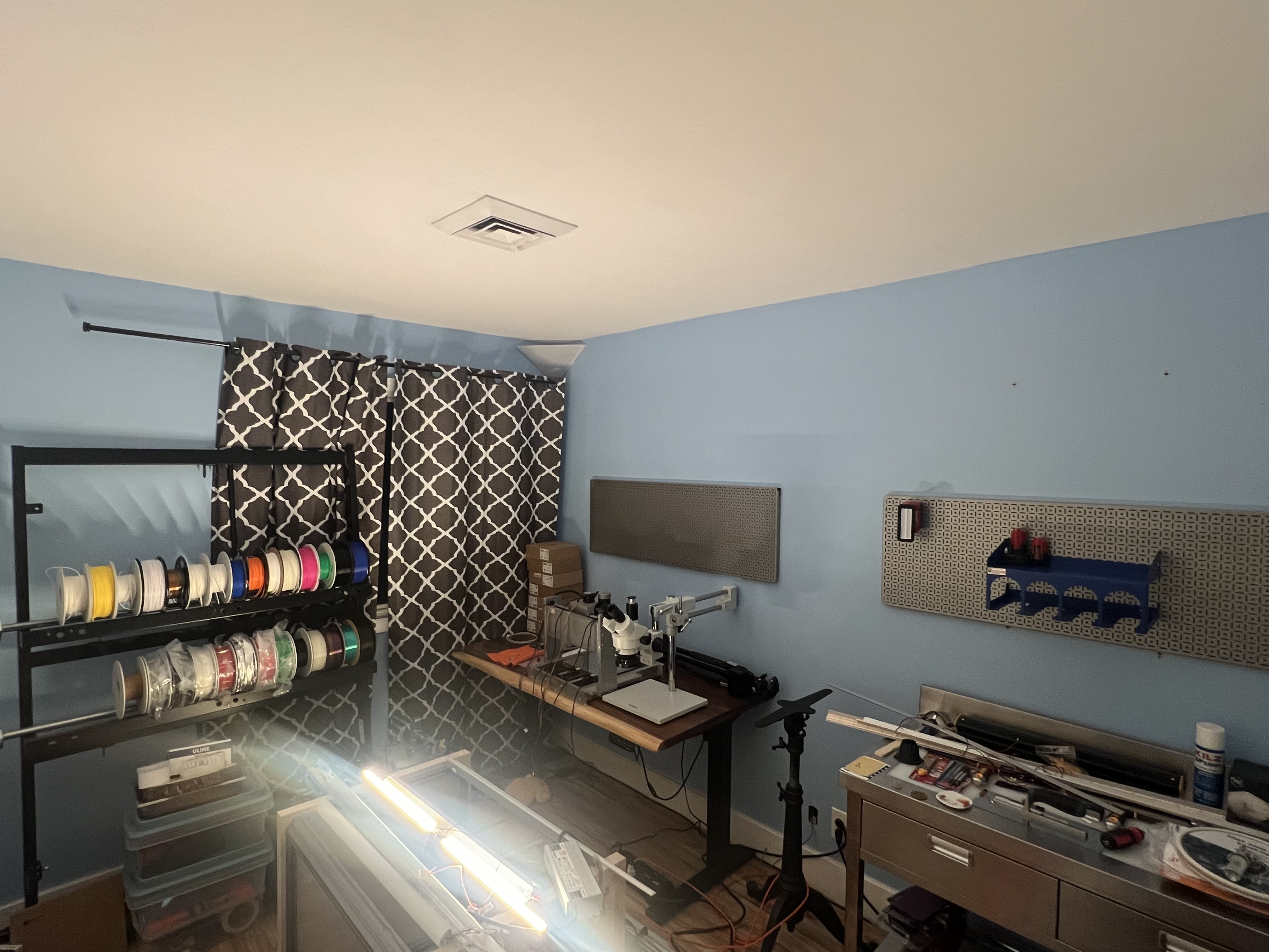

Eight strips (4 corner channels):
Harsh shadows, vivid colors, this much light needs actual direction to be comfortable. Think operating room levels of light…the wife calls this general level of brightness “Tyler Time”
I’ll be getting an an-penta-plus to handle lighting the entire office and these four dinky little corner channels will be relegated to the CNC enclosure.
Also don’t make fun of the state of my office, I’m just moving in :sweat_smile:…and don’t mind the naked Nomad 3, it’ll get a new outfit just as soon as I finish the wiring harness for the enclosure.

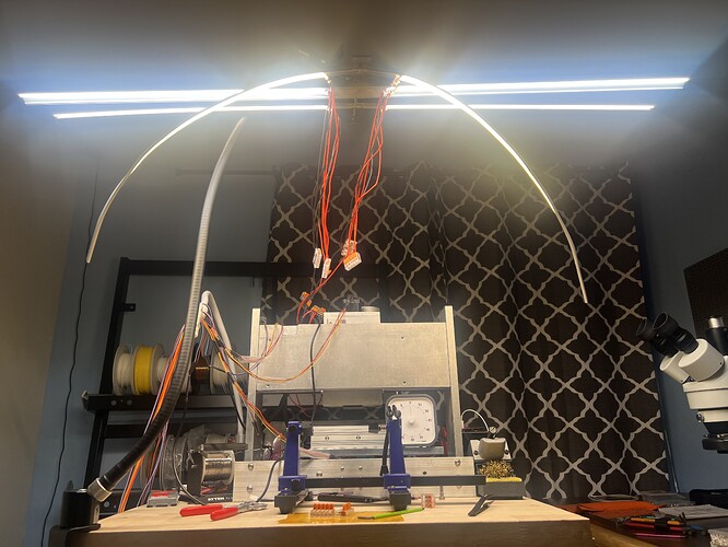

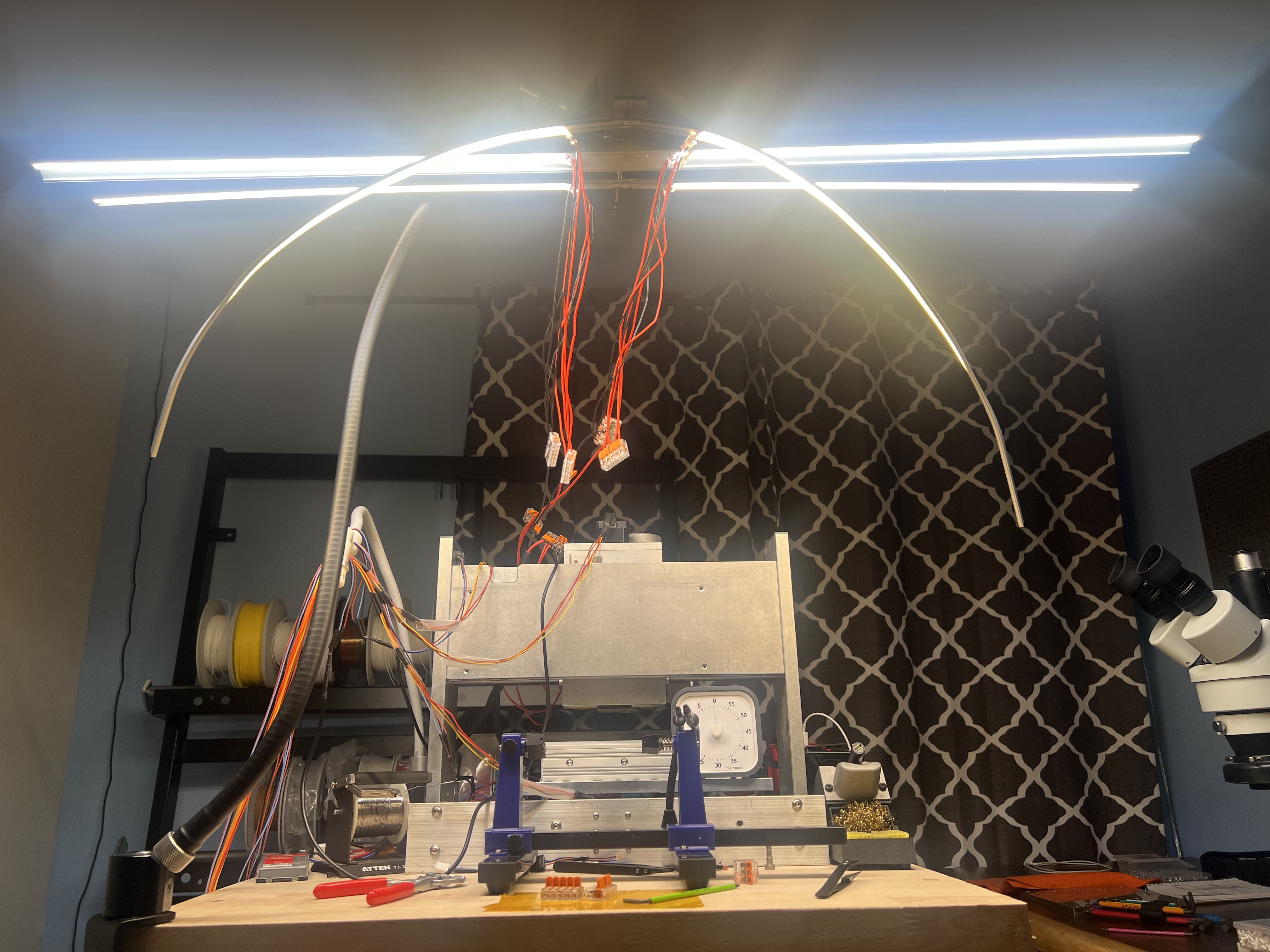

The beauty of flexible strip channel is that you can put the light where you want it.
Shadows cast by your hands from overhead lighting is really annoying, especially when doing fiddly electronics work.
The solution? A halo of light enveloping the work space, all while keeping any direct source out of line of sight.
Just bend the strip around you and twist the point source away from your face.
These hacky strips will probably be converted to battery power once I’m done with office setup. Throw on some magnets and they’ll be super convenient to just move around the shop.
Again, these are just getting the job done for now. Nothing more than a stop gap to let me work after sundown (I know, they’re ugly :sweat_smile: )
