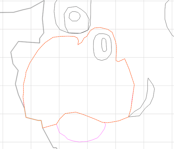

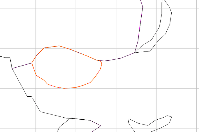

Join Vectors will only join the end of one vector to the end of another vector, or itself. And the 2 ends need to be really close. (0.001" - 0.025mm??). If they don’t join, zoom in on the ends & move them closer together.
You can’t join the end of one vector to the middle of another vector.
You can also use the “create poly line” and just trace over the areas you want to make a vector.
CC will automatically snap the new poly line to a node. Just take your time and hover over the existing vectors as you do your tracing. It will snap to the nearest node. When it snaps to the node just left-click and CC will place a new node on your poly line to match the vector you are hovering over.
