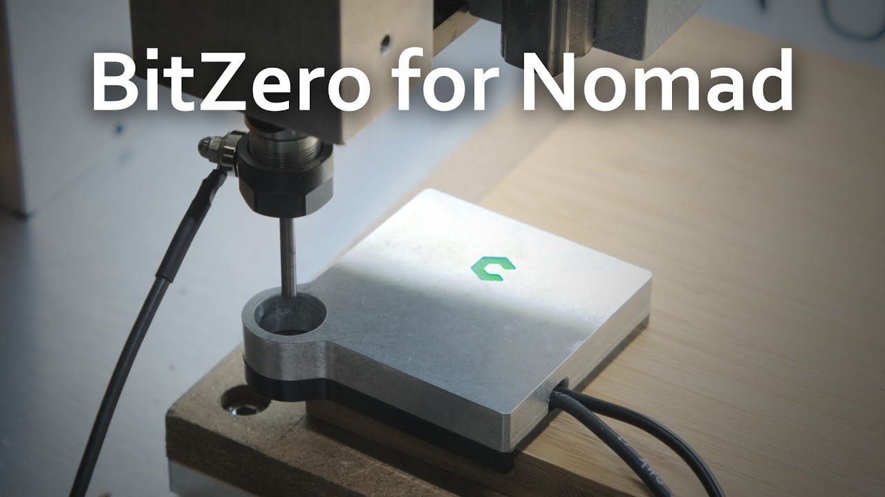

Ah ok thanks, that does indeed help a lot and clarifies what the other guys had described.
One thing you mentioned though, the Carbide 3D Zero Tool - is that just a tool within the software, or do you mean the physical BitZero product that they sell? I saw that but noticed it only mentioned the shapeoko and not the nomad so I assumed either the nomad already had something similar built in or its just not compatible
I’m a Shapeoko user so my Nomad knowledge is limited, this video by Winston Moy suggests that the bitzero works with the current Nomad machines however.
oh nice, it sounds like its included with the nomad now anyway :slight_smile:
But yeah like you said, it probably won’t work directly with this particular workpiece due to the shape so I guess I’ll either go with the dial indicator method or just machine an L shape to push the part against and then use the bitzero on that.
