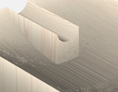

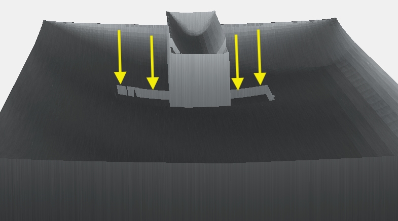

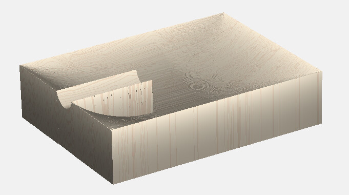

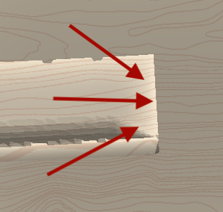

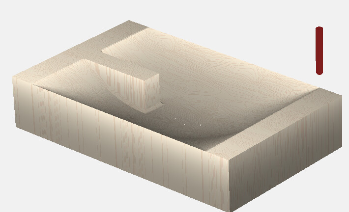

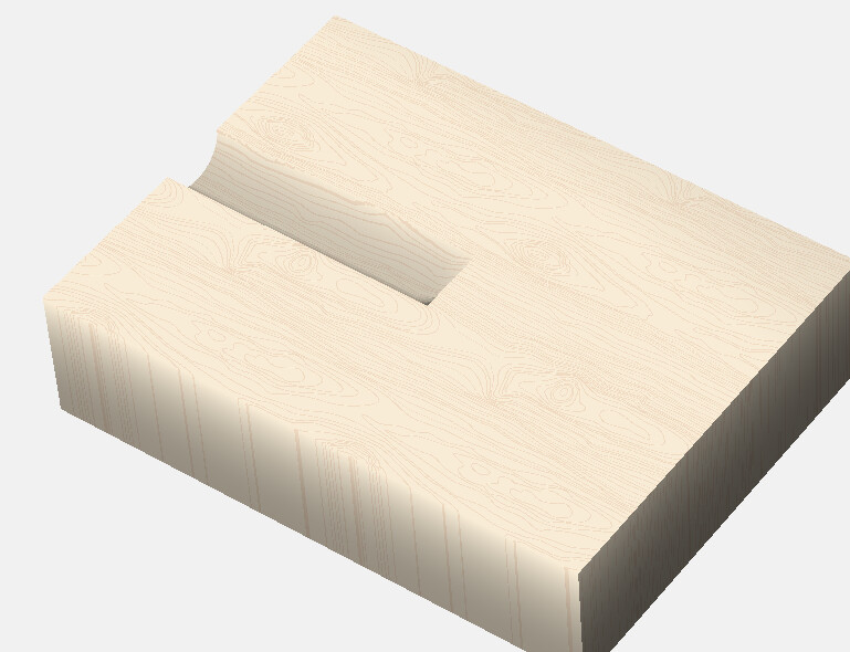

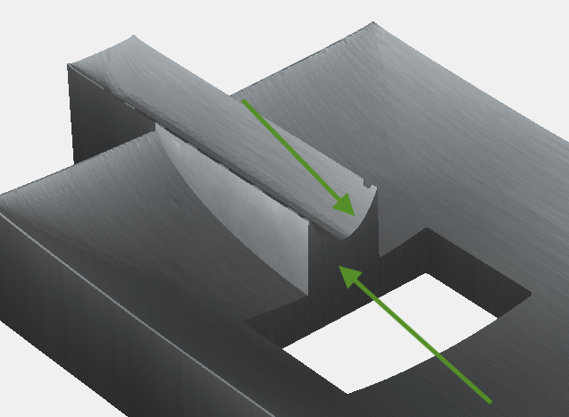

when making a 3d round (tube for example), you need to go beyond the length you want, then ‘cut off’ the ends to keep the round geometry consistent (remove the end lip). I cant figure out how to ‘cut off’ or remove the end correctly. Hopefully the 3 pictures I attached will help explain. I am trying to remove the round tubes end (lip) but keep the stock base at its original curved shape. Any ideas what I am doing wrong?
‘junk lip’ picture shows the ends that need to be removed
‘flush cut’ picture shows how I want the end to look
‘floor curve’ picture shows the curve in the stock floor I am trying to keep

Equal dont seem to help, it looks like ‘add’ and ‘subtract’ are the only merge types that will keep the curvature of the stocks floor… but it also keeps the unwanted end of the shape I am trying to cut away
If the rectangular center hole is supposed to be there, You can let the base of your smaller round groove extend into that hole, subtract the groove, then trim the end off with a subtract.
If you’re trying to maintain the ‘bowl’ shape throughout, I think you will have to make 2 separate parts. One that cuts the bowl shape & leaves the base of the groove, then another that cuts the groove in that base.

one part (on the machine). 2 separate CC files, so you can model and cut the features separately.
Because you have one subtraction over the other, that final shape can only be modeled separately.
another option would be to model the bowl & save as an image, then model the base & groove & then import the image using a “max” merge type.

Yes, in either example the bowl shape is maintained below the cigar rest.
