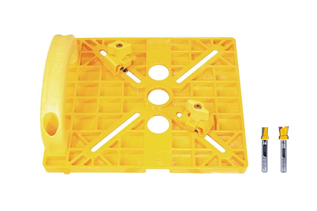

I have the MatchFit system in my shop. I bought the jig they sell to manually router the clearance slots and follow up with the dovetail bit.
The jig requires you have a router that can use Porter Cable style bushings. I think you could use a router without the PC bushings but if your router moves it messes up the whole operation. I use a Dewalt palm router. You first hog out the grooves and then follow up with the dovetail bit. You could just use the dovetail but but you are removing a lot of material at once for a palm router. Plus you get a cleaner result if you plow out the grooves first and then the dovetail bit.

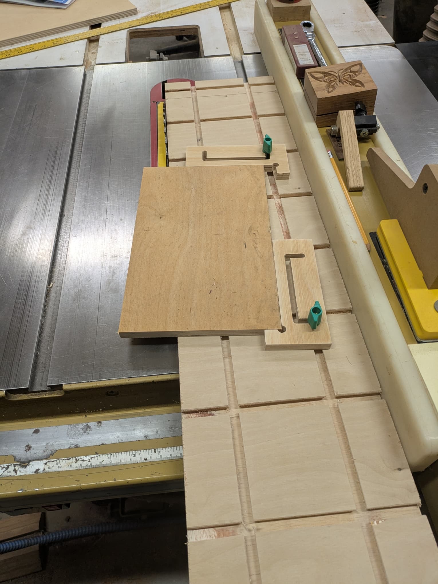

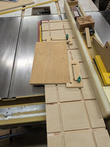

I know this is not a Shapeoko solution but you can use the system for other things round the shop. I made a piece of mdf up to cut straight edges on irregular stock. It can also be used as a tapering jig.
I did use my Shapeoko to make the tapering jigs.
I also have a Jessem Pocket Mill Pro and Master Doweling jig that has its own workstation for the Jessem that uses the MatchFit clamps.
If you dont have a jointer it cuts a very nice straight edge. You are limited in length but for making small table top glue ups it works great.

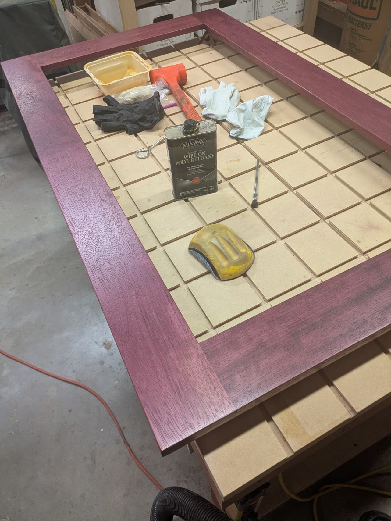

I made a new assembly bench that has the MatchFit system and it works great.
