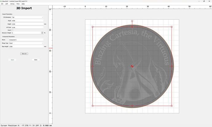

first, i imprt my 3d stl file.
i thought that looks cool.
i try rough 3d and
did finish 3d.
but expect result is very bad.
It’s a completely different result compared to when I saw the imported image in advance.
Is there a tutorial or video that I can get help with on this? I’m at a loss.

The red indicates that you are raising the model up above the Stock thickness.
I suspect you may want to invert the image.
Could you post your files? Both .c2d and .stl? (send them to projects@carbide3d.com if not suited for sharing)

The file seems quite physically small, and does not seem to have much in the way of Z variation:
Checking on Amazon most coin blanks seem to be 40mm in diameter and 2.5mm thick, so we set up the file for that:
We then draw in a circle for the blank:
Model the stock:
and import the STL:
We then apply 3D roughing and finishing toolpaths using suitable small tools:
If you create an impossibly small tool you can get:
Subtracting the STL we instead get:
which previews as:
Adding more 3D Finishing toolpaths and increasing stepover gets us to:

hi! i did modeling with ur screen shot. but simulated result is very different. can i know the problem? // i find ur third toolpath. what is that?

I posted the screen grabs above with my specific settings — please try those.
The disabled toolpath was a test w/ an impossibly small tool to see how the initial 3D model would cut.

I believe I had better luck subtracting the STL from the design — see the screen grabs in my post above.

I made a simulation with subtracting. It’s better than before, but it’s not clear, what do you think

This may become clearer with smaller tooling which can cut better details.
Or, perhaps you could get, or make a better 3D model.
Or, perhaps you could re-draw some of the design in Carbide Create so as to better cut the details.

Cutting a design into a surface (incised) and cutting a design away from a surface (bas relief) are quite different things, and the same tool used for each may have different results depending on the specifics of the details.

Yes, I posted screen grabs of every step I went through in making the file which I sent to you — one thing which I would suggest is to copy into the component name all of the settings used for a given component — that should allow experimentation, and evaluation of how one setting differs from another.
