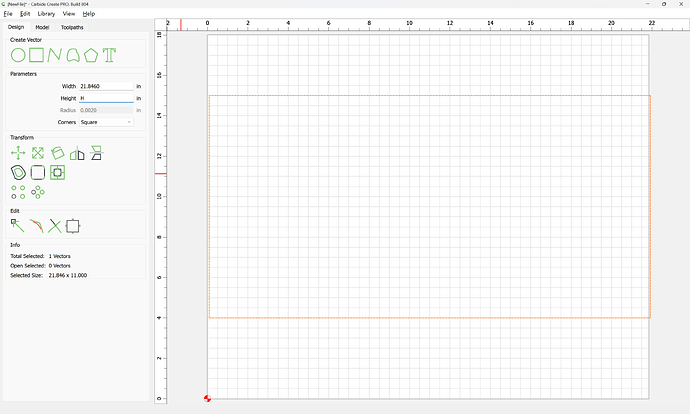

If one wants to make drawers which are:
21.846" wide, 18" deep, 10" high
out of:
1/2" Baltic Birch
using a:
1/4 compression bit
One approach would be:
which gives us the overall dimensions along X and Y.

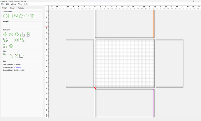

We then draw in the sides, front, and back as seen from overhead:
and then select the original geometry:
and subtract the Stock Thickness from the Width and Height:
which gives us the dimensions of the bottom.

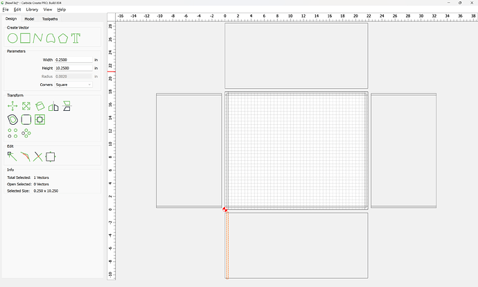

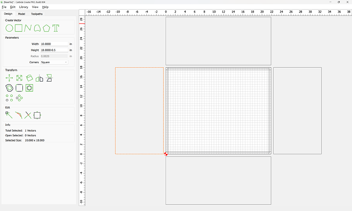

Then, draw in the profiles of the sides, front, and back:
and draw in a vertical view of the joinery:
and adjust the size of the sides to match that size:
Dupe the sides and re-size them to match the extent of the material left behind by the rabbet:
