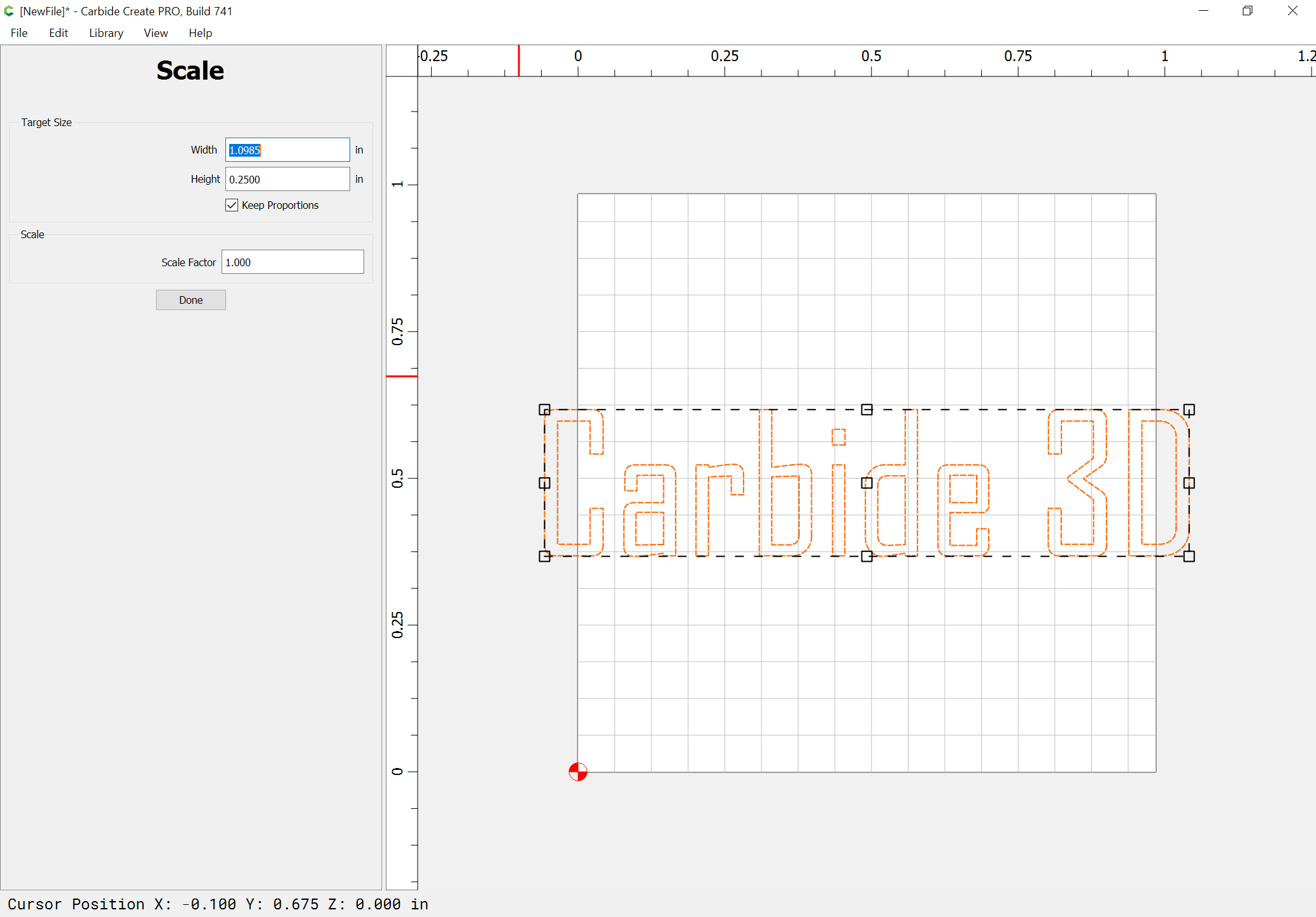

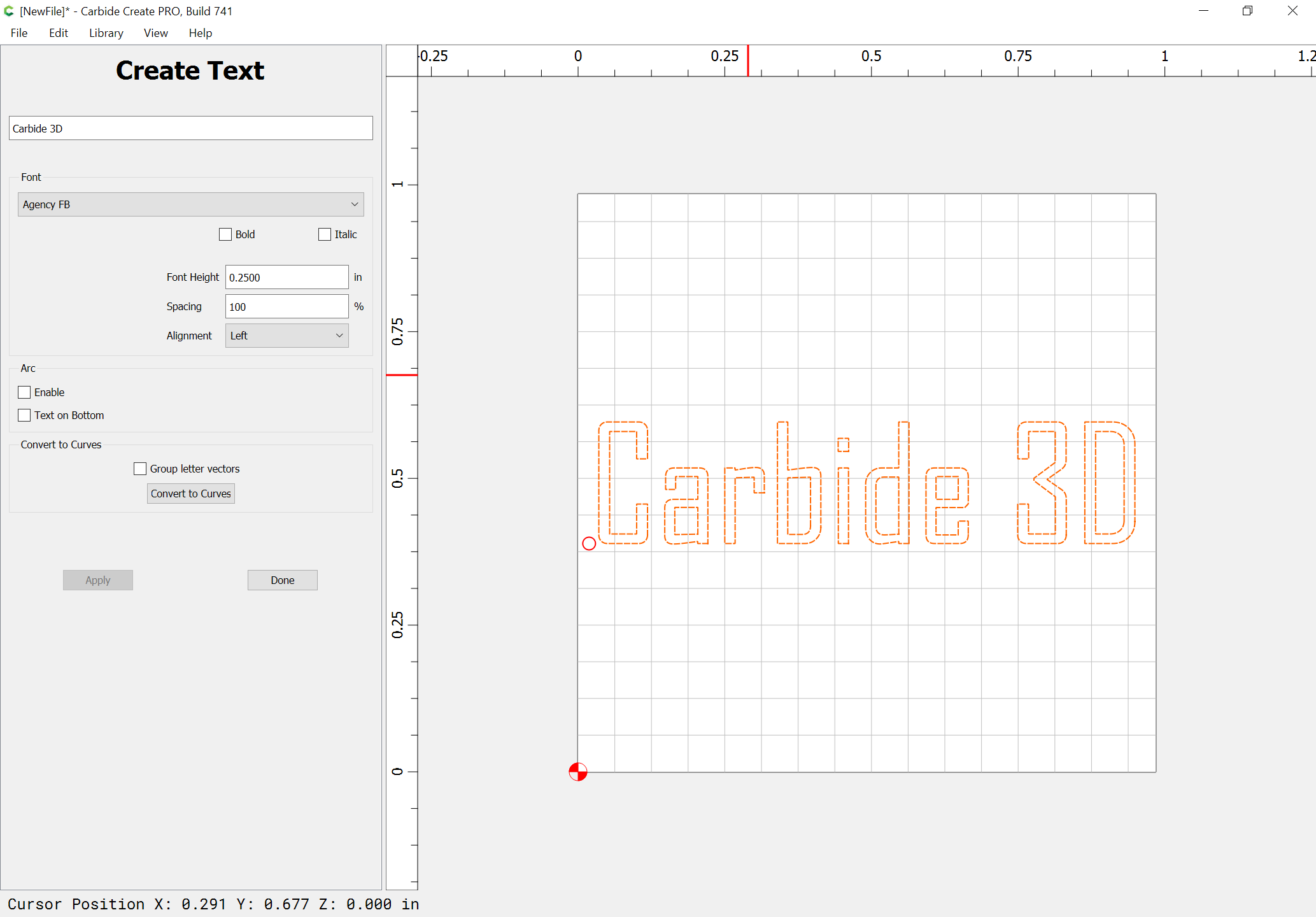

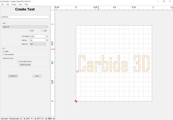

Set the text:

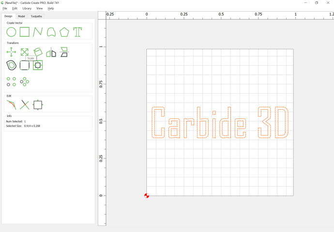

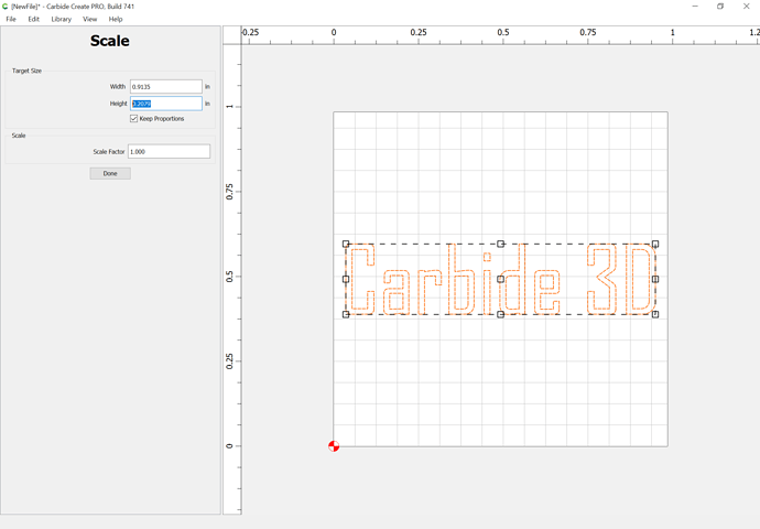

Then select it:
Then use the Scale tool:
to set it to a desired size:

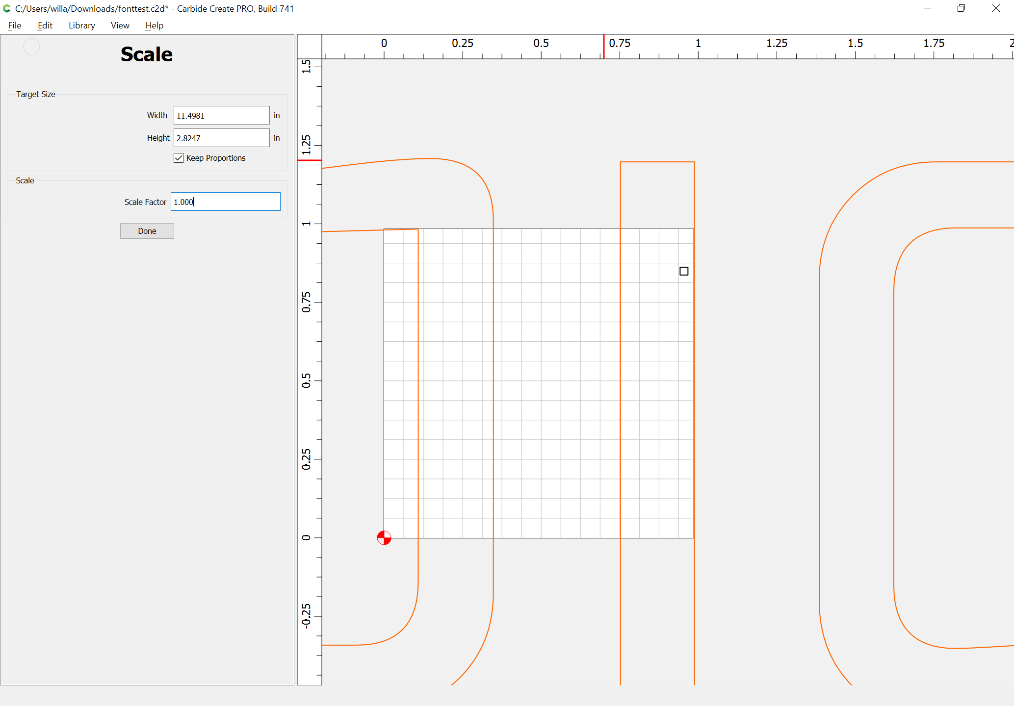

From what I can tell this just moves the text around. I need the actual text lines to be a specific size at any size i make the text.
Please post the file which resizing doesn’t work on.
I need the text lines to be exactly 1/4 inch wide.

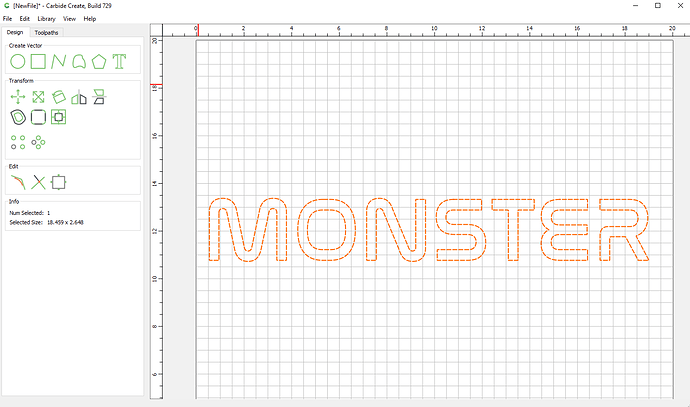

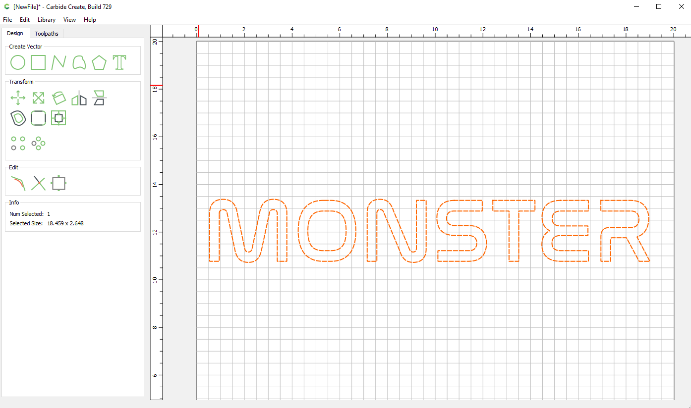

MONSTER.c2d (84 KB)

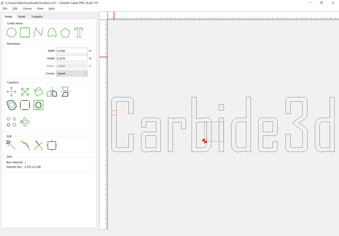

Do you mean that you want the width of the lines of the text to be 1/4" so as to accommodate the LED strips?

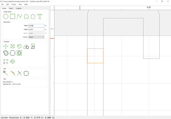

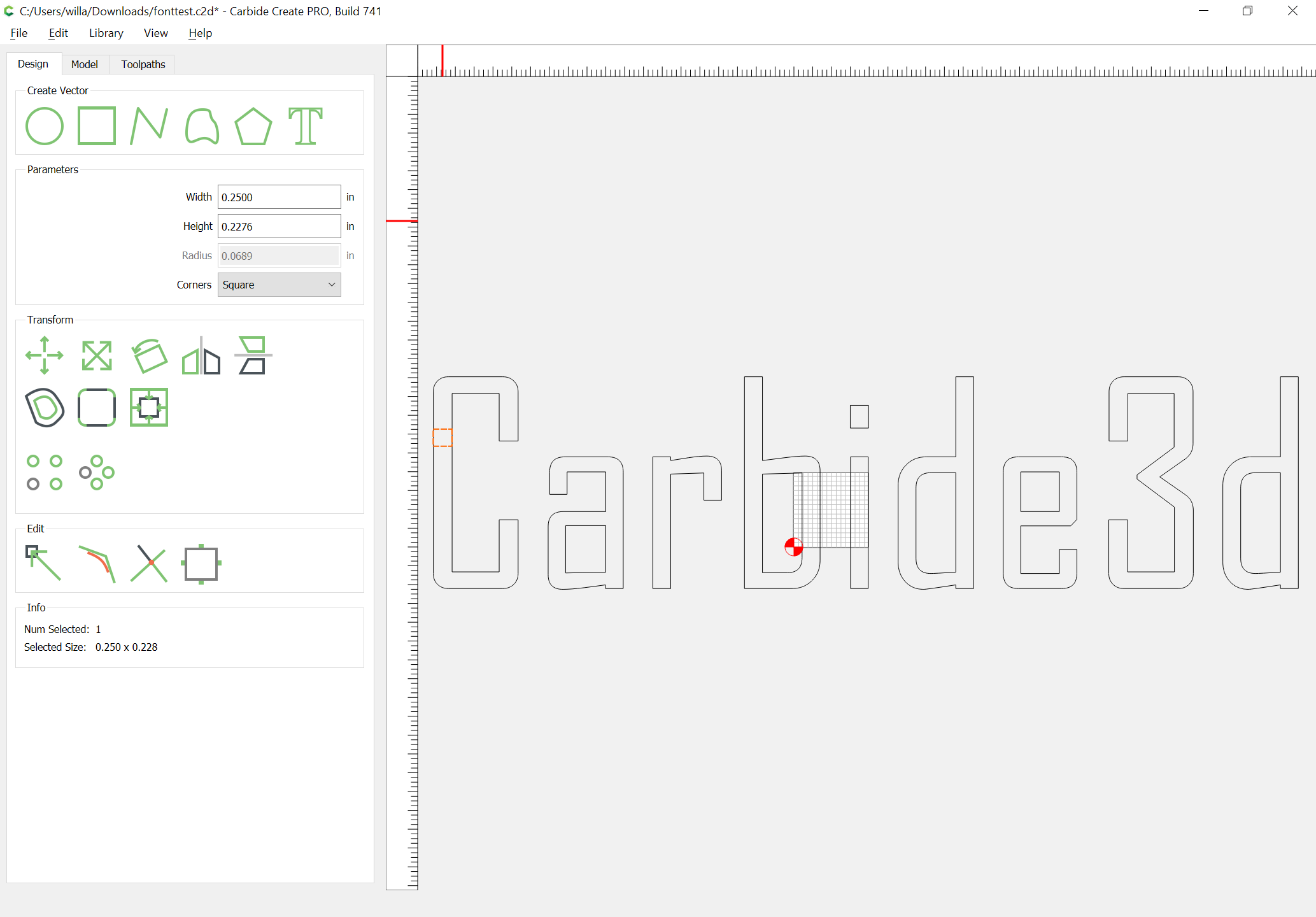

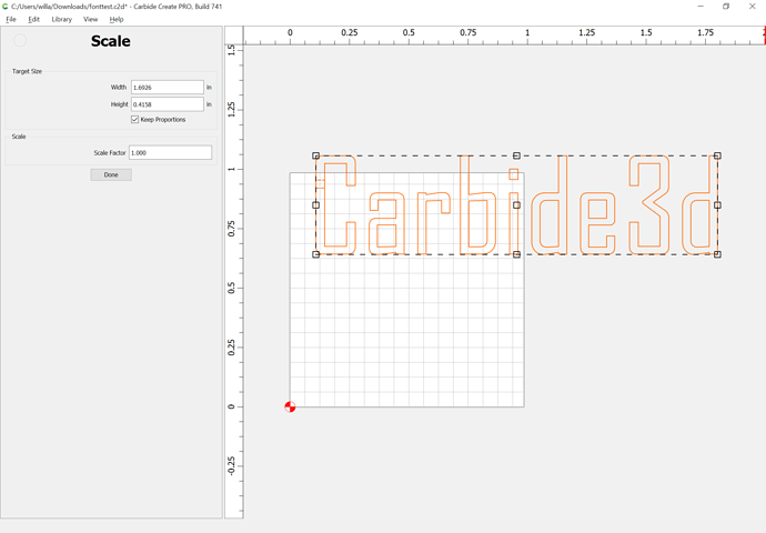

Draw geometry to measure the current width:

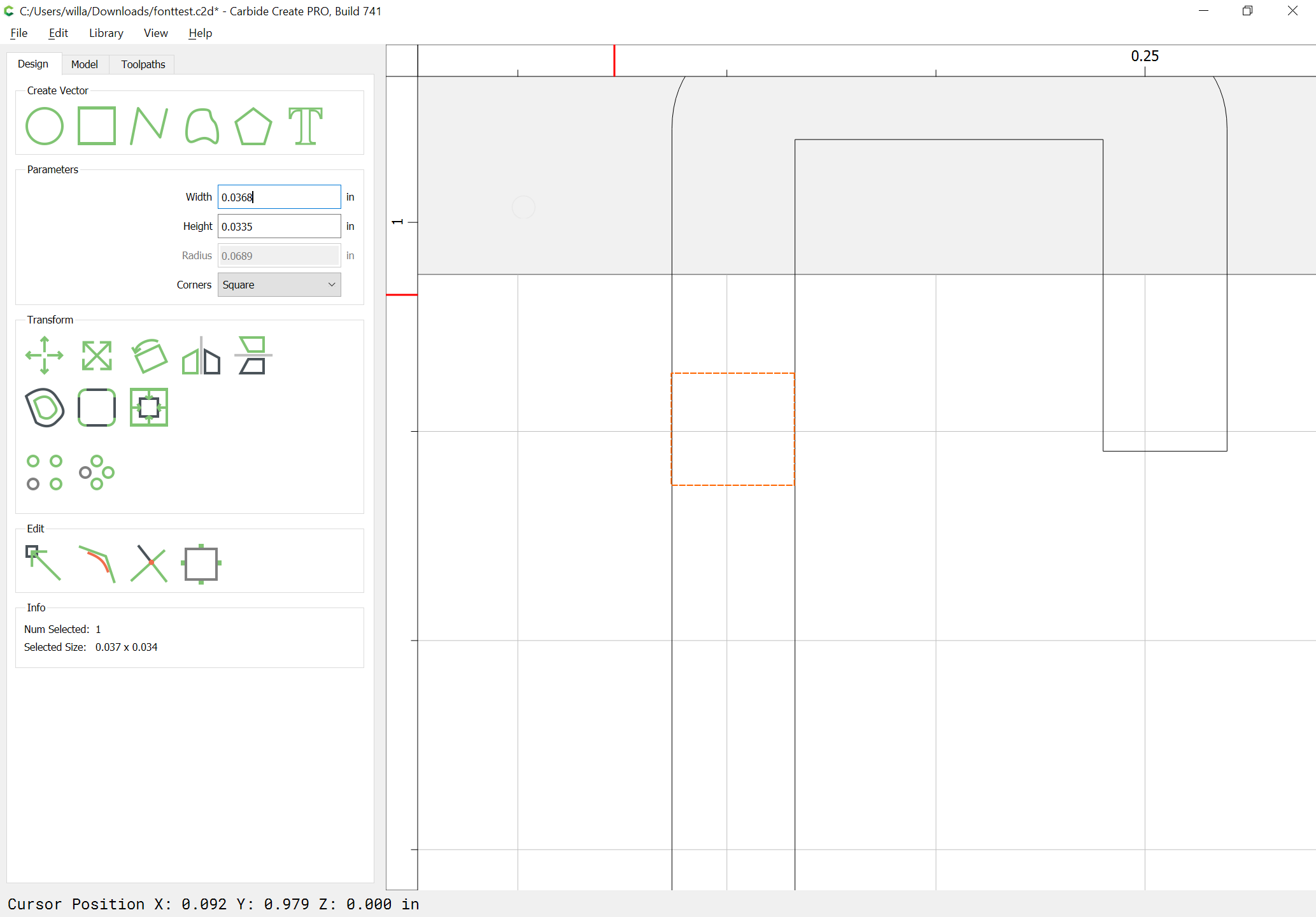

Then do the math to scale that up to the desired dimension —
0.25 / 0.0368 == 6.79347826

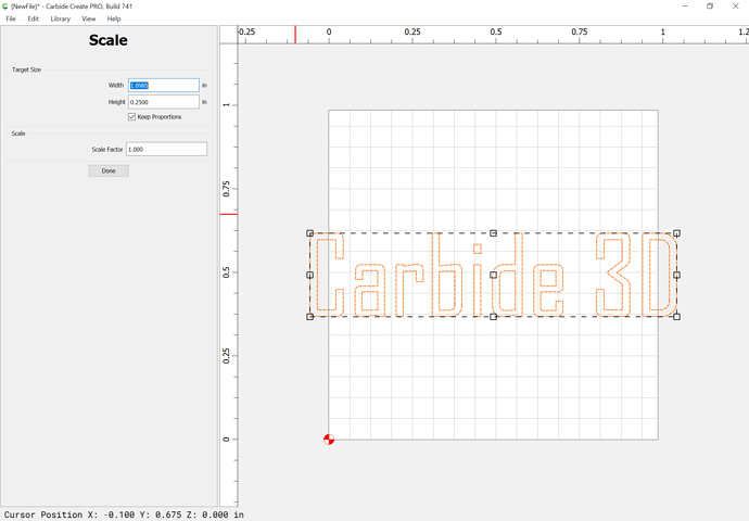

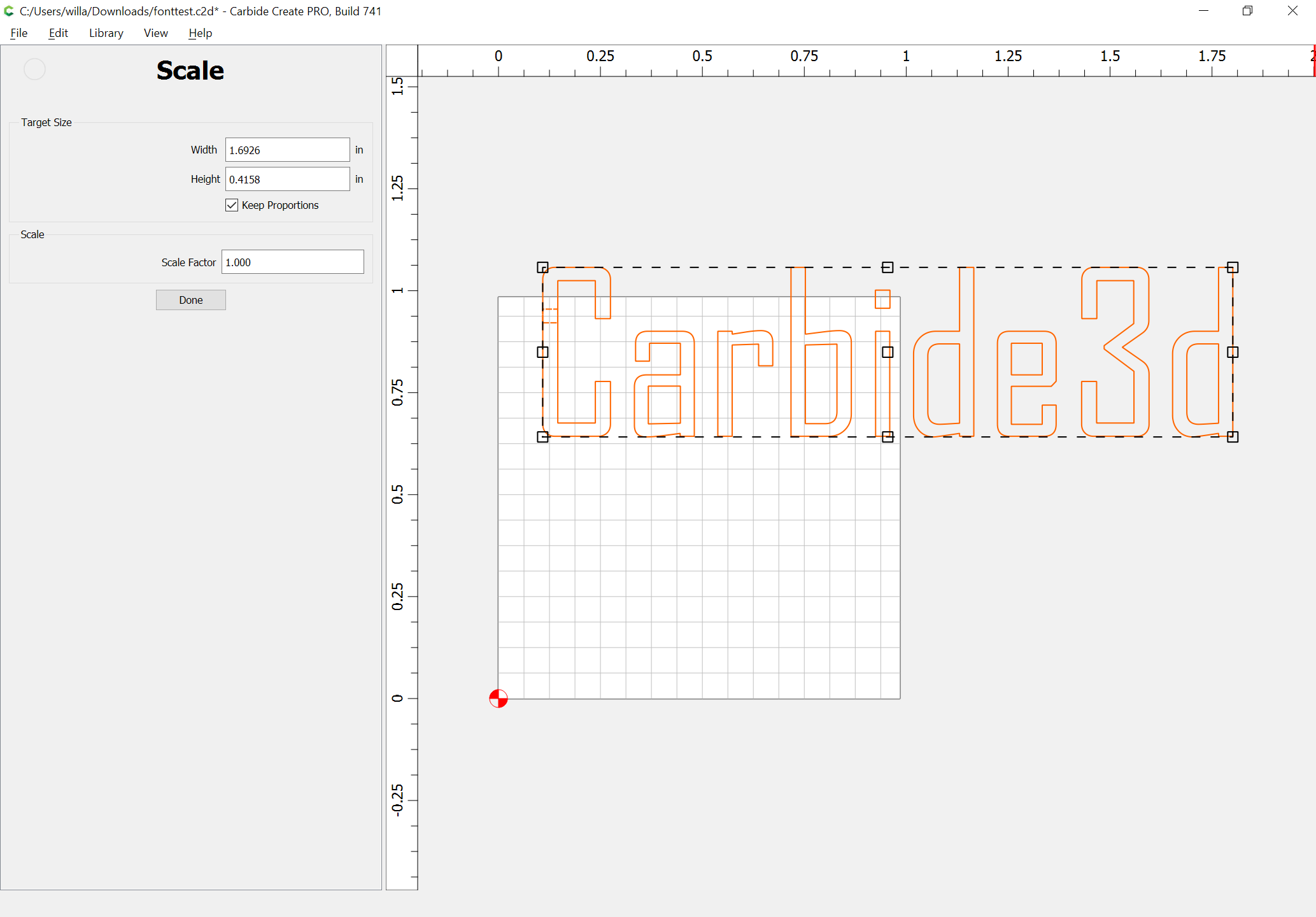

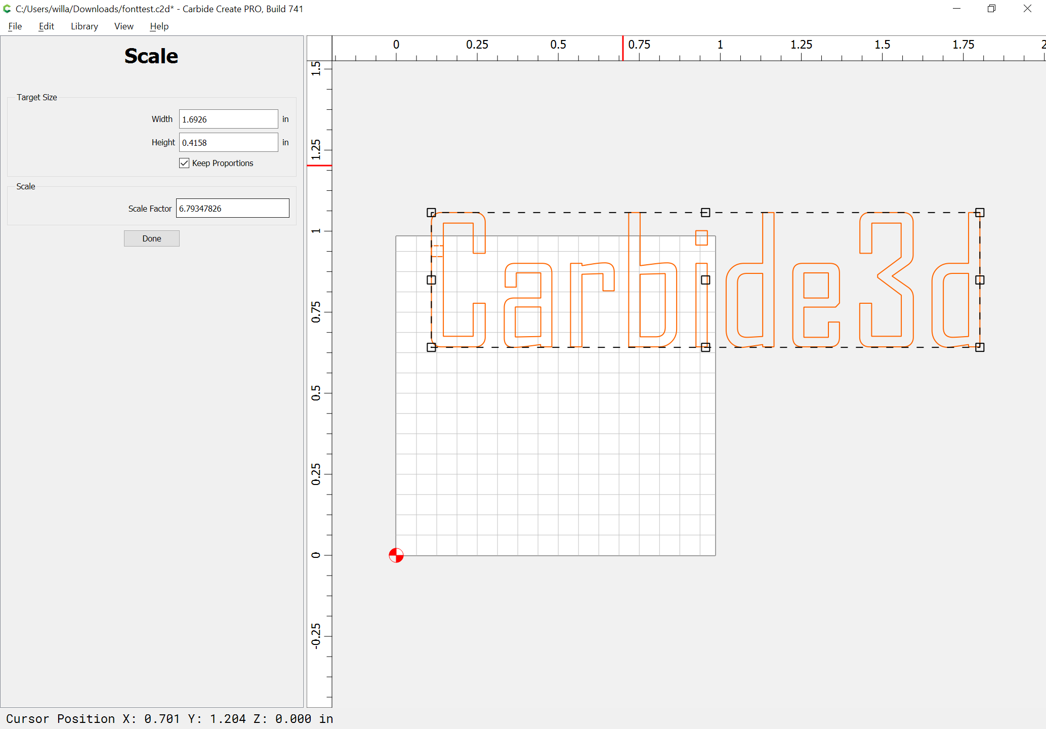

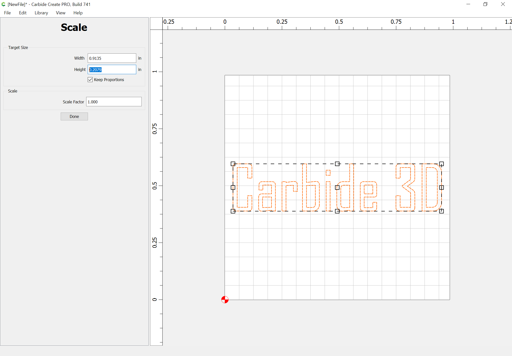

Then select the text and use the Scale tool:
to scale to the desired size:
I did a similar experiment, but without math.
More like trial and error.
I drew a circle with a .25 diameter and then scaled the text until it was just a little bit bigger than the circle.
MONSTER.c2d (76 KB)
